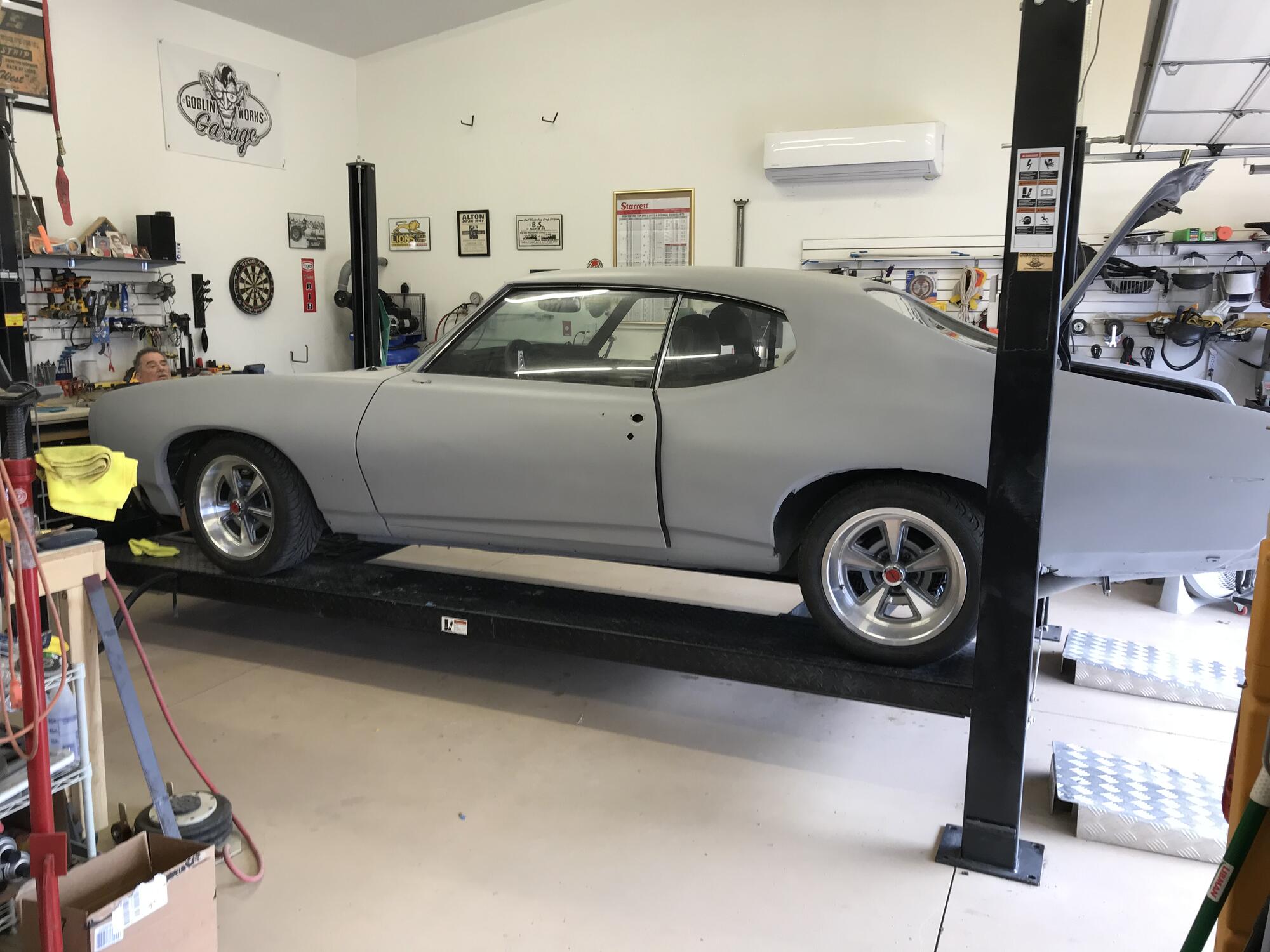

      Fenders Mounted

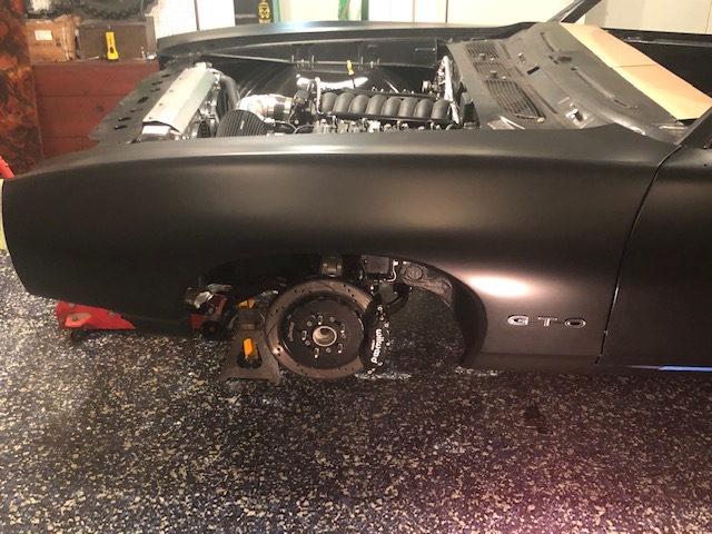

      A week late but a couple old friends came over yesterday and helped me get the fenders on.
      We are not as productive as we used to be! Spent most of the day bench racing and telling old stories instead of working.

      Progress is progress. Looking good
    5. #505
      Sep 2009
      2,997

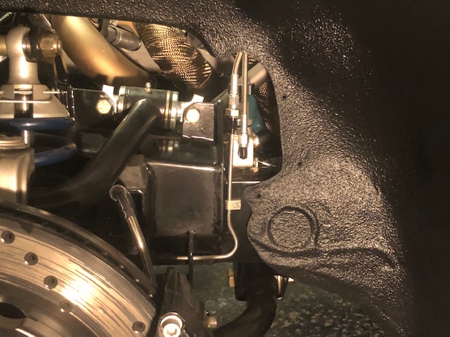

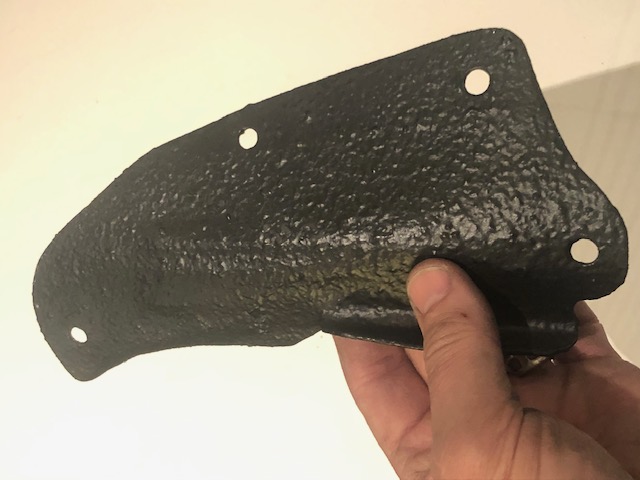

      I really like that proportional valve wheel well cover.

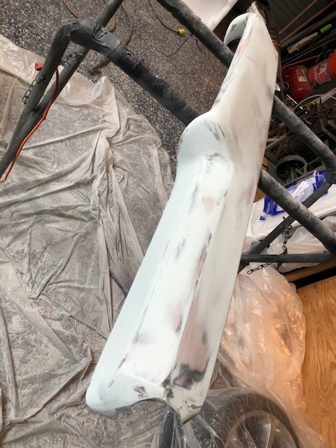

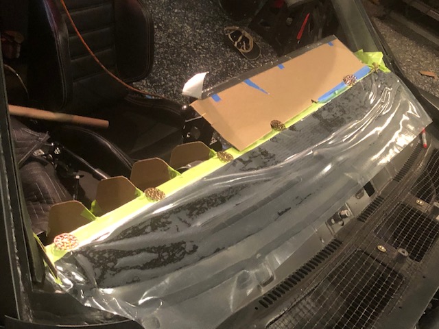

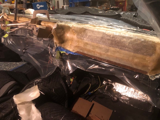

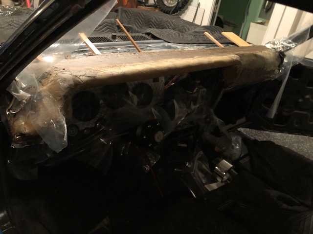

      Custom Dash
      Thanks guys,

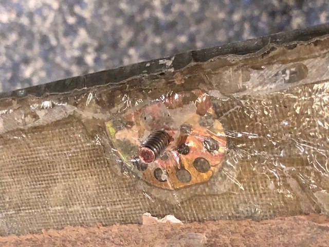

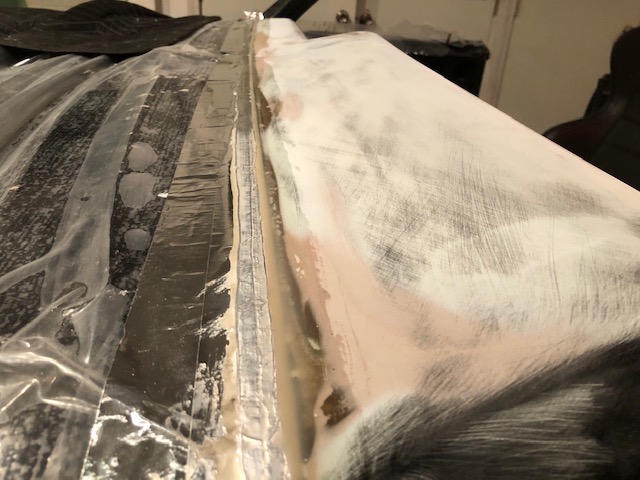

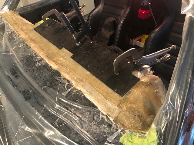

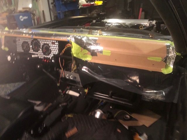

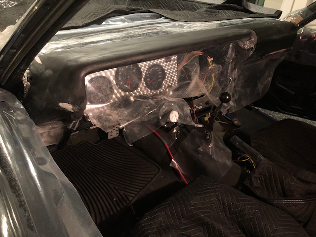

      I was able to make a fiberglass dash over the holidays that I plan on getting upholstered someday, although I might test out some flocking on it and see how it looks.
      http://www.flockit.com/index.php/pro...cker-kits.html
      Probably the worst time of year to take on a fiberglass project, with the cold temps outside I had to keep the doors closed and suffer for a while behind a respirator.
      Fiberglassed around all the hardware on the first pass to embed 1/4-20 elevator bolt studs for mounting.
      After the first layer set up I was able to break it free of the car and remove the cardboard and tape forms.
      Then it was re mounted and tightened down to get all the gaps figured out.
      Used the bondo glass for bigger gaps and epoxy for the final smaller ones.
      Lots of sanding (with the dash out of the car) and lots of fiberglass splinters! Now I need to rent an industrial leaf blower to get the garage clean again

      That dash turned out really nice!

      Would have been cooler if it was 3D printed but I would probably still be working on fine tuning the CAD files.
      I wanted to get the dash done before glass goes in.
      Focused on getting things off the list.

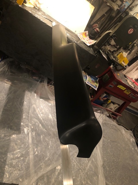

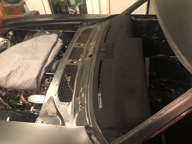

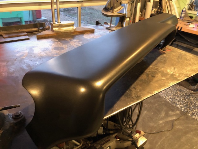

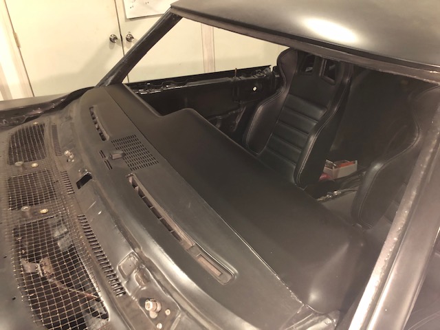

      Dash Flocking

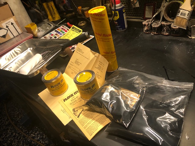

      Thanks for all the kind words guys,

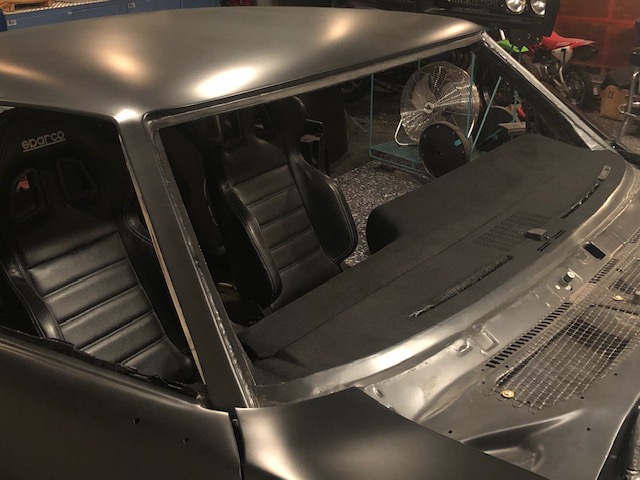

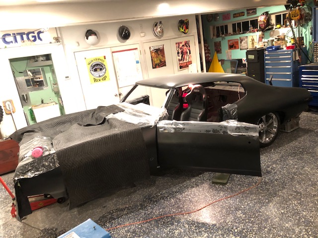

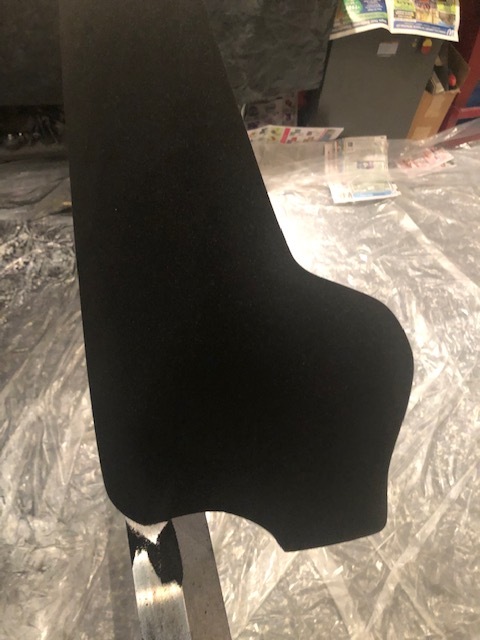

      Went with the black flocking kit on the dash for now and will upgrade to upholstery someday.
      Made sure the dash unbolts fairly easily.
      It looks pretty good and the spots that I don't like are hardly noticeable, but I don't think it will be super durable.
      Originally thought about making a mold for the dash, but since this was a 1 of 1 and not many other 68-72 A bodies running the metal 69 Impala dash out there I dont think it would be worth it.

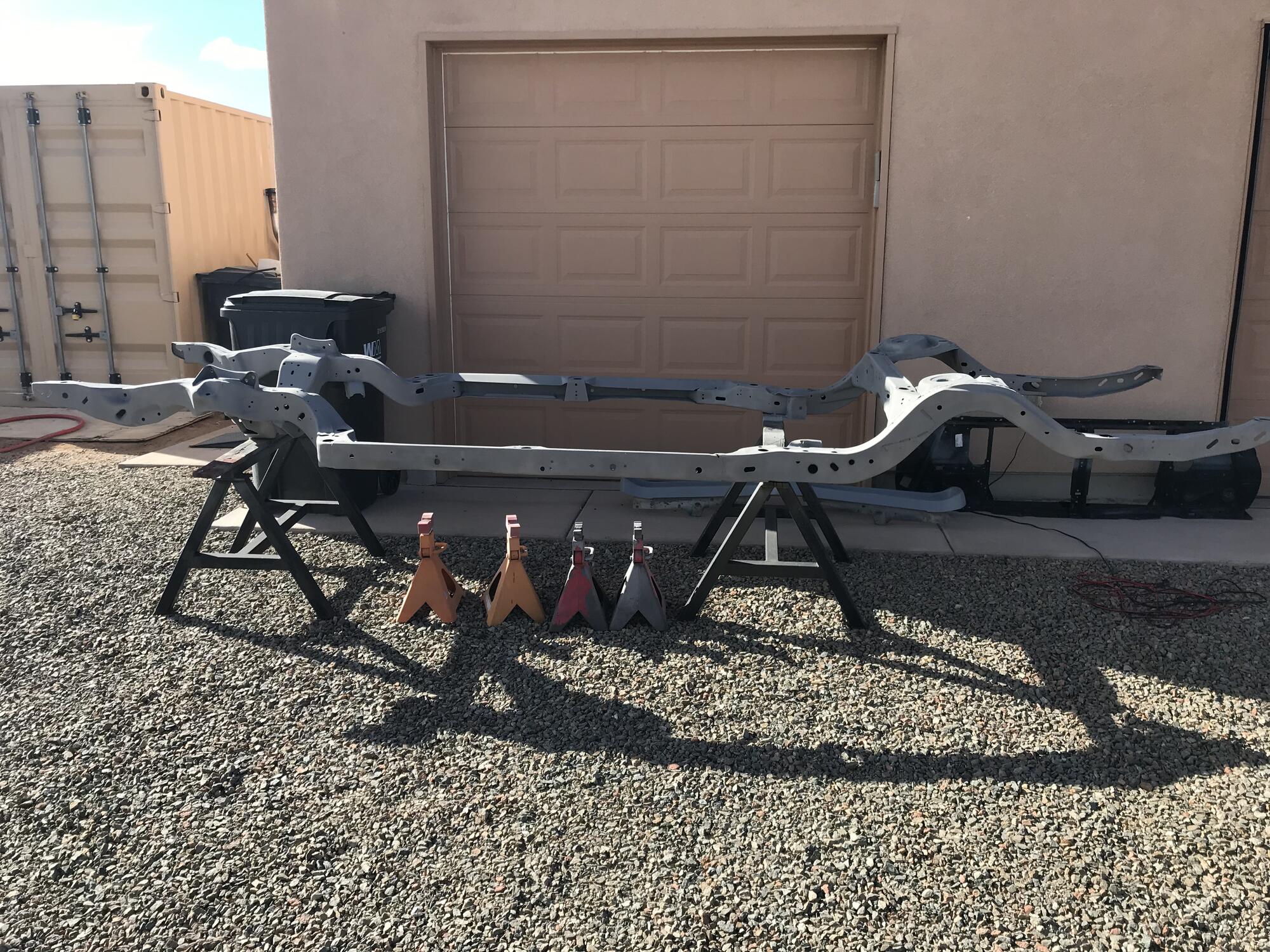

      Had I found this thread earlier, I would have asked for a copy of your dash setup. Would rather have paid you than the $2500 it's costing me with Just Dashes to build mine. I won't see the dash again till around Aug/Sep...I am removing the center air vent and climate controls to put in a touch screen switch panel from Altronics. I picked up the matching Dakota Digital climate control for my gauges, and moving it to the new center console from Modern Classics Interiors.
      This is the stage mine is at. Just finished blasting the frame last week.
