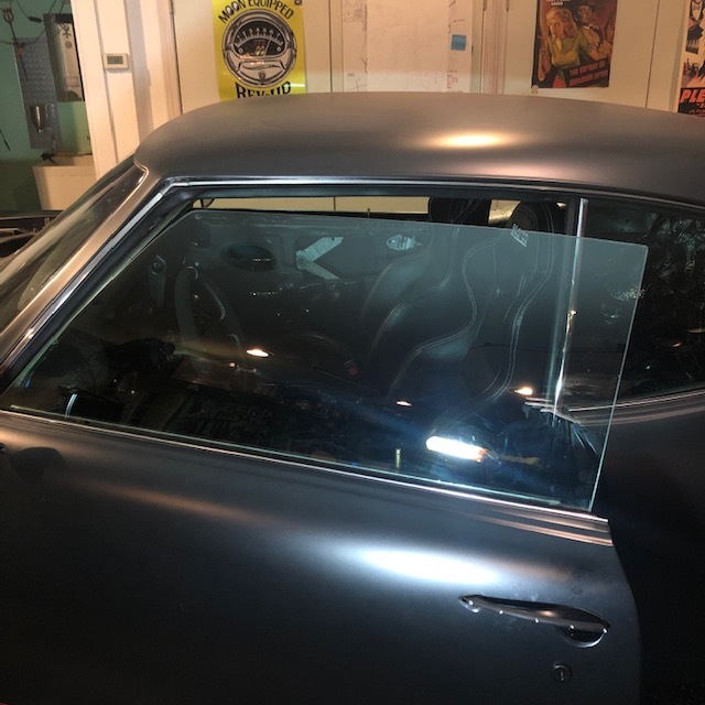

      Was able to finish installing the door glass, the Ebay glass from India will do for now.
      Maybe someday I will get lucky and find nice original green tint glass.

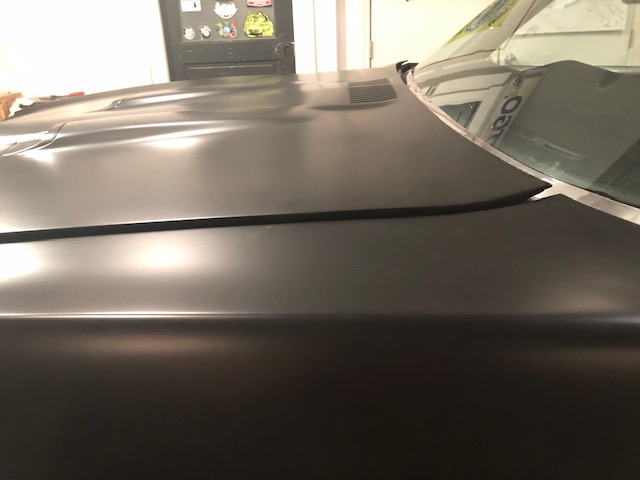

      Hood quickly installed over the weekend. I am so used to working alone it felt strange to have the extra help.
      Once the car is back on the ground I can finish aligning the front clip.

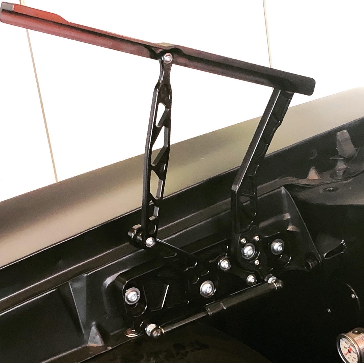

      Jun 2012
      N. Shore, Ma
      346
      Ring Brothers Hinges
      Hey guys,
      Hinges are from Ring Brothers, they are made really well, no slop in the movement with the bearings at every pivot point.
      I will let you know how it goes adjusting them down far enough.
      Hinge is hitting the lip of the fender right at the bolt for inner fender, and need to drop it another 1/4" or more (see pencil)
      Got an email in to them to see if I am missing something.

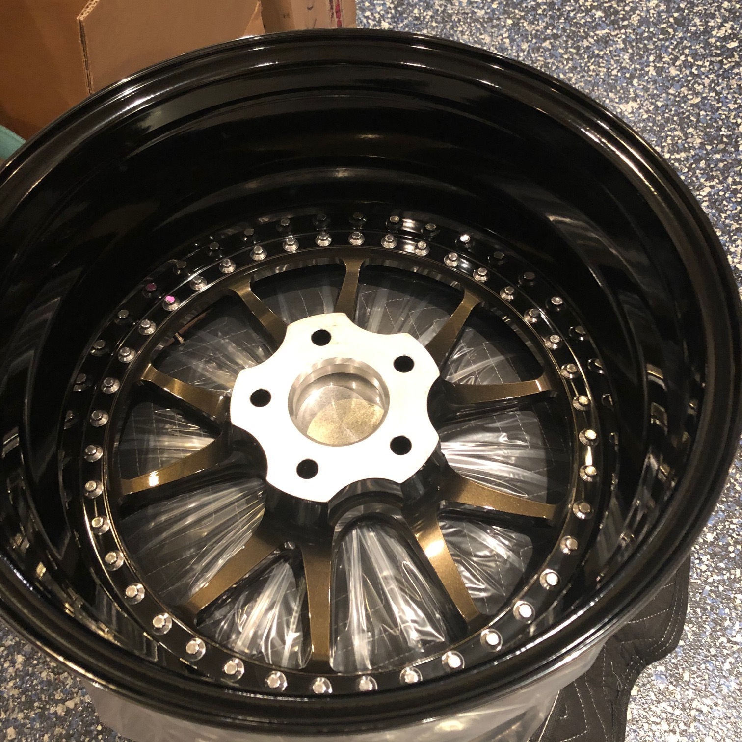

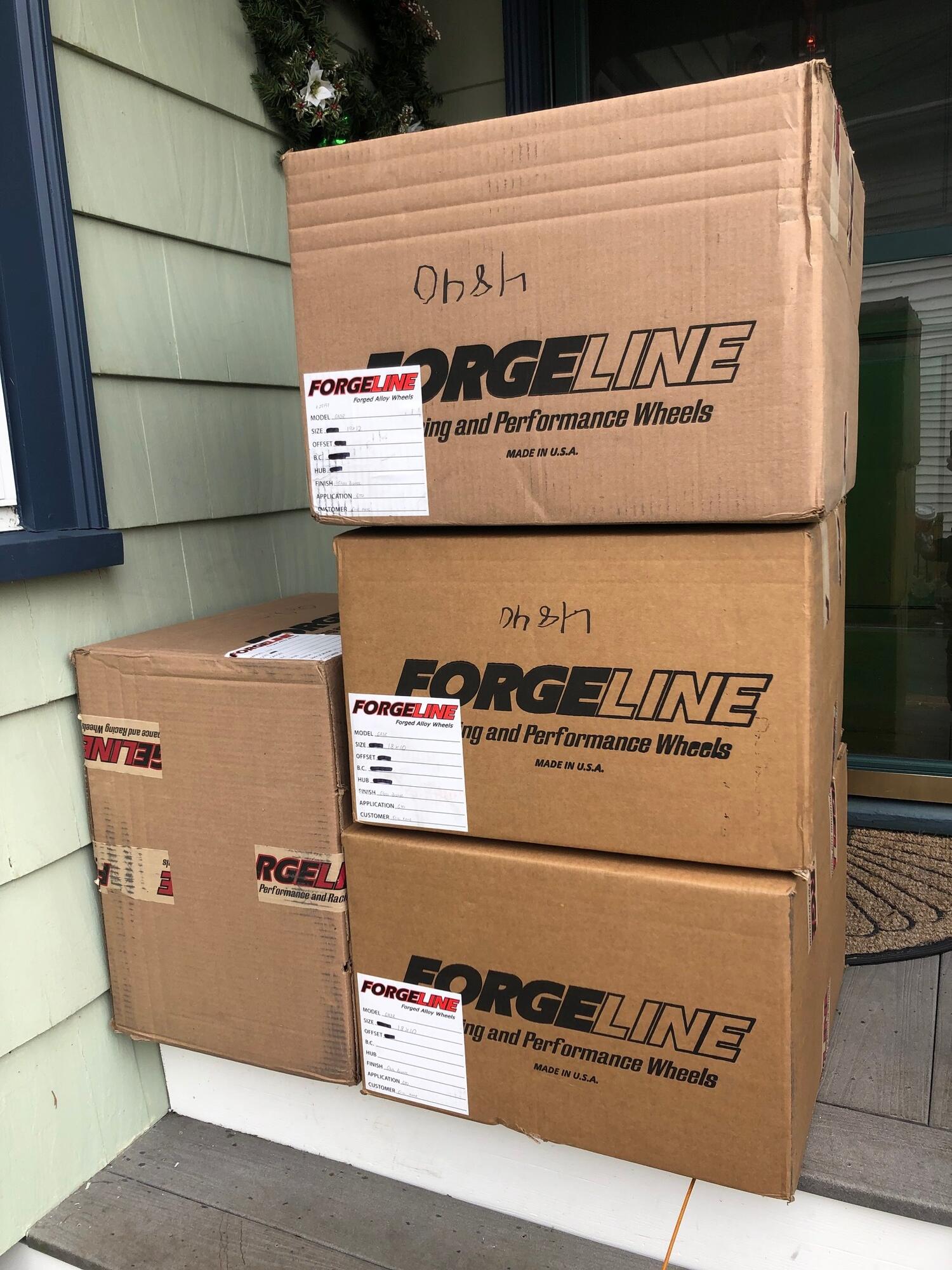

      Forgeline Wheels
      Thanks Wayne, still making progress.
      Went in to work this morning and came home to a surprise on the front steps!
      Luckily the porch pirates missed grabbing these, that would have been sad.
Size:  349.5 KB Name:  IMG_0589.jpg
      Nice to see that Forgeline has figured out a good way to protect them in transit. Nothing worse than unboxing something and to see damage on your shiny new parts.
Size:  771.4 KB Name:  IMG_0595.jpg
Size:  675.3 KB Name:  IMG_0596.jpg
      Super happy with how they look, was second guessing my color choices before and after I placed the order.
Size:  686.2 KB Name:  IMG_0598.jpg
      Hope to get the tires mounted soon!
      https://forgeline.com/wheel/ga3r

    9. #549
      Oct 2011
      721
      Eric, I don’t have the ring brothers hinges, but mine also touch in that spot on my 69 Camaro. I put button head bolt and grinder the hinges in that spot a little bit to get them to come down a little more.
    10. #550

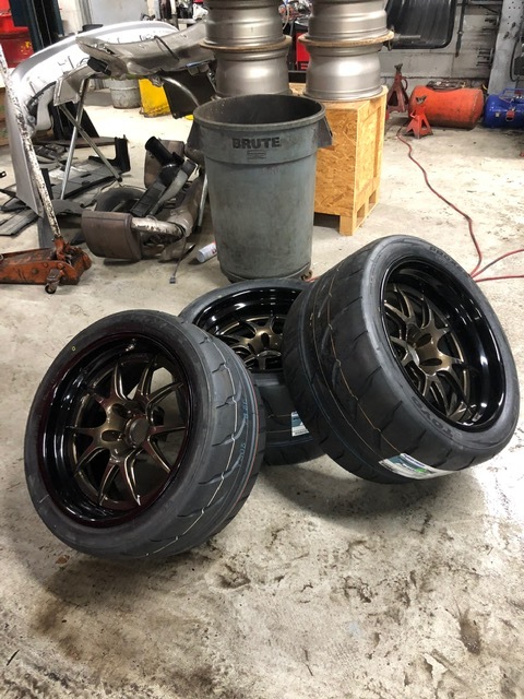

      Tires Mounted
      Brought the wheels and tires into buddies shop the other day.
      They fit the car great, happy with the offset and I am hoping once I fully adjust the fenders and square things up I wont need to bend in the front bottom corner that barely touches when turning right to left.
      Hope everyone has a Merry Christmas!

      This lighting makes it look like the tire is on the lip of the rear quarter but I have 1/2" of clearance.

      Thanks.
      Thank you,
      Yeah they told me to try and push down on the rear of the hinge more! I would have expected a better answer, its sad the R+D department at Ring Brothers missed this issue.
      I think they will have to be modified, it doesn't seem right cutting into such a good looking part but I cant see another way.
      Will chop off the aluminum for the front gas spring mount and try to make a less bulky 11 Gage sheet metal bracket to take its place that I can bolt onto the bottom side of the hinge.
      Once it is all together and mounted on the fender I don't think it will be noticeable.
      Hey if it works I will make a bunch and get rich selling them to you guys!
