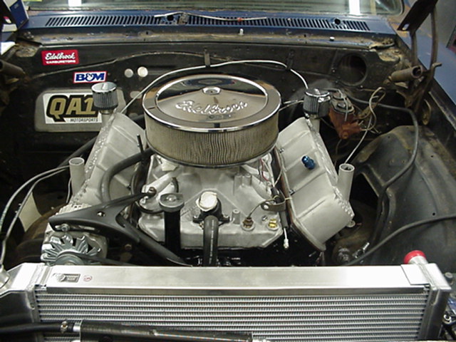

      Guys,
      Hope all is well... Car is rolling, and I've taken it to a couple outings already. Eric... do you recognize the old guy below? Gus, congrats on finally pulling the trigger on something... ha, ha... I remember struggling with the same decisions.
      Talk soon, Mike

      Hey Mike,
      Is that Jim Wangers looking happy that you got your Goat back out on the road again!? Must feel great with the extra power now! Might be a little jealous!
      The March accessory drive kit looks good too.

      Congrats on getting your baby back on the road. She's looking great. That engine bay is pristine dude!! Must be a blast to drive her with that new power plant. Very Kewl!
      And I agree with Eric, is that Jim W., the GTO father? Such a great photo op! Ah to live in CA.... Oh well, Eric and I will have to make do in NE. Enjoy your time with your gorgeous GTO Mike. You earned it!!

      Eric,
      Great to hear you're sanding... I don't miss that. Yeah, that's Jim Wanger, I actually met him a couple weeks earlier at his 89 birthday party. Dude is sharp as a tack. It was my second "reliability test" that day, and of course, it rained. That's where the below picture was shot...
      Gus, awesome renderings! That'll be one bad ass cruiser.
      I'll be struggling with putting the wipers and wiper motor in this weekend. Of course the wiper motor hits the valve cover, so I have to re-engineer the mounting bracket. I wish I would've known that would happen, when I was doing the smoothly plate... I would've tried to relocate the wiper motor to underneath the passenger fender... Gus, take note.
      Mike

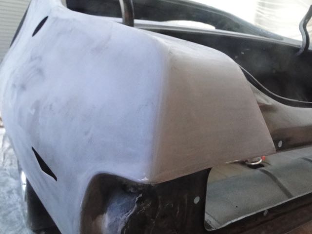

      Almost finished sanding
      Thanks Gus,
      Lots of sanding over the last week!
      Block sanded the epoxy primer with 220 on the high spots and 320 everywhere else.
      Another coat of High Build 2K that I sanded the top off with my DA and 150, then block sanded with 150 to get level.
      One last coat of epoxy as a sealer that I block sanded with 320.
      Now ready to mask off and spray some 2K primer / sealer.

      Quickly fit doors and fenders
Size:  62.8 KBName:  DSC02535 - Version 2.jpg
      Happy with improved door gaps, this section always bothered me with its big space from the factory. Don't ask how many hours I have into them.
      Eric

      Eric,
      Congrats on getting out of paint Jail! That flat black looks awesome! I will be going back into paint jail soon, to correct some tiger stripping on the hood and deck lid. Which can only be seen in bright sun light... so, I went to my first car show last weekend and won "Best GTO", because it was overcast ) There were about 20 really nice goats there... including Jim Wangers' Judge...
      But, the absolute sickest car I've ever seen, was a 69 Charger. Check out the motor... CRAZY!
      Talk soon...
      Name:  PowWow showII 2015.jpg
Size:  422.5 KBName:  PowWow show 2015.jpg
Size:  400.4 KBName:  Pow Wow Charger.jpg
Size:  312.9 KBName:  Pow Wow Charger Interior.jpg
Size:  247.6 KBName:  Pow Wow Charger Engine.jpg
    19. #419
      16,129
      What's that thin little bar over the engine supposed to do? It is the size of a toothpick...LOL
