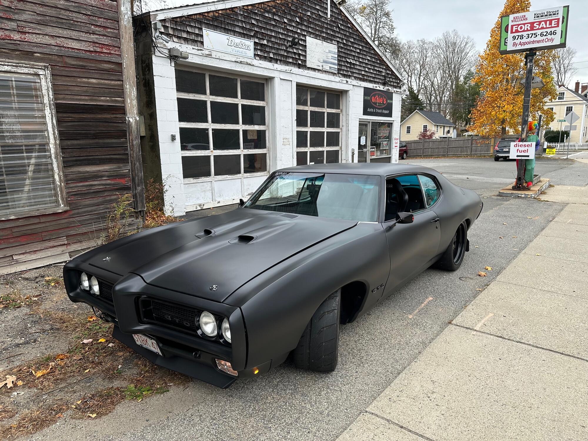

      First Highway Drive
      Made it safely to the dyno shop!
      The GTO was so fun to drive on the highway, it handles like a big go kart! No surprise!
      The Roadstershop Fast Track chassis felt amazing, very responsive and light feeling for a big car.
      The Bowler prepped T56 Magnum shifted super smooth. Wilwood manual breaks felt good, looking forward to a track day next year to really test them out.
      Was a little chilly this morning here, 34 degrees! Turned on the heat for the first time and it worked.

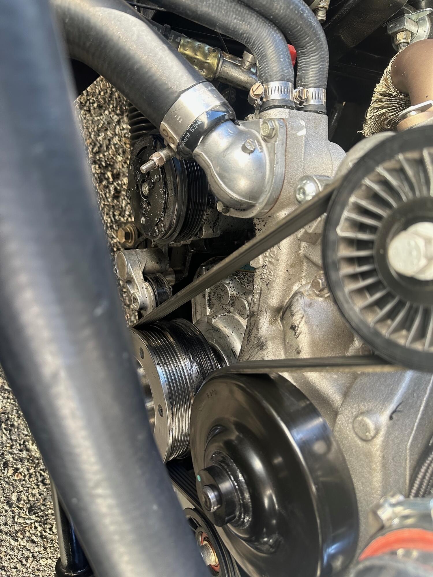

      The only thing that didnt work was the AC belt, it decided to jump off and self destruct about half way there.
      Other than that pit stop and a few close calls with bad drivers things went well.
      Looking forward to dyno results and hope everything stays together.

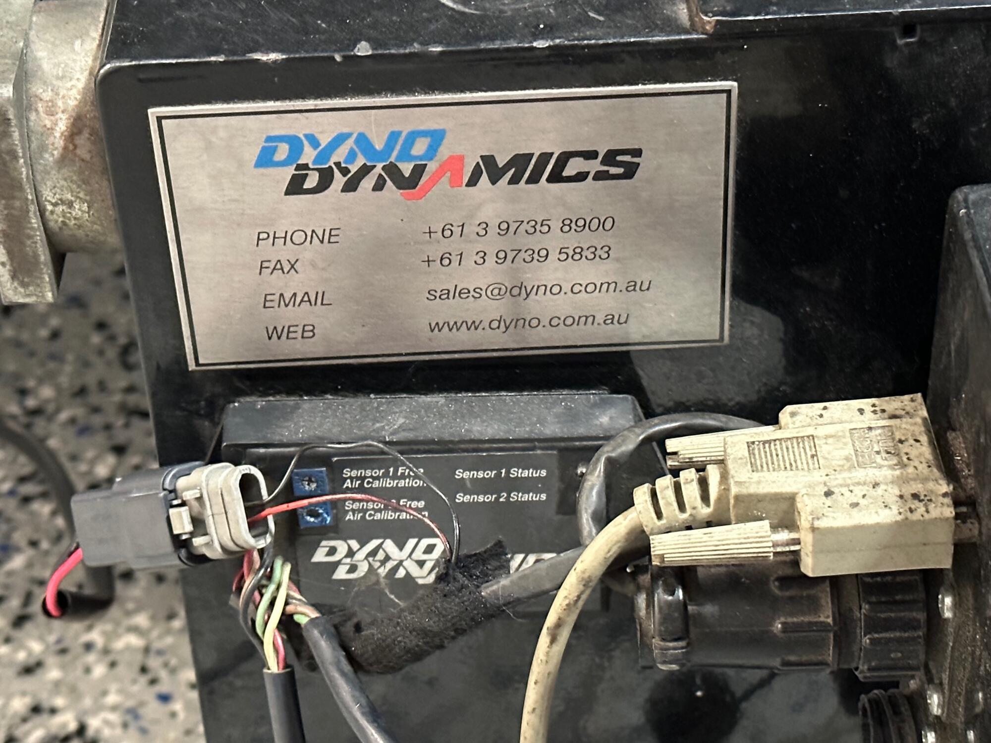

      Runs on the dyno went well. At least mechanically, still have a couple gremlins to chase down in the harness.
      Lost a ground somewhere so the O2 sensors, knock and MAF sensors started acting up.
      Charlie put a safe tune on it because of that, so we ended up with 405HP at the wheel, converts to about 480HP at the crank.
      Looking forward to the next time on the dyno.
      Will most likely be swapping out things for a Holley or Haltech engine management.

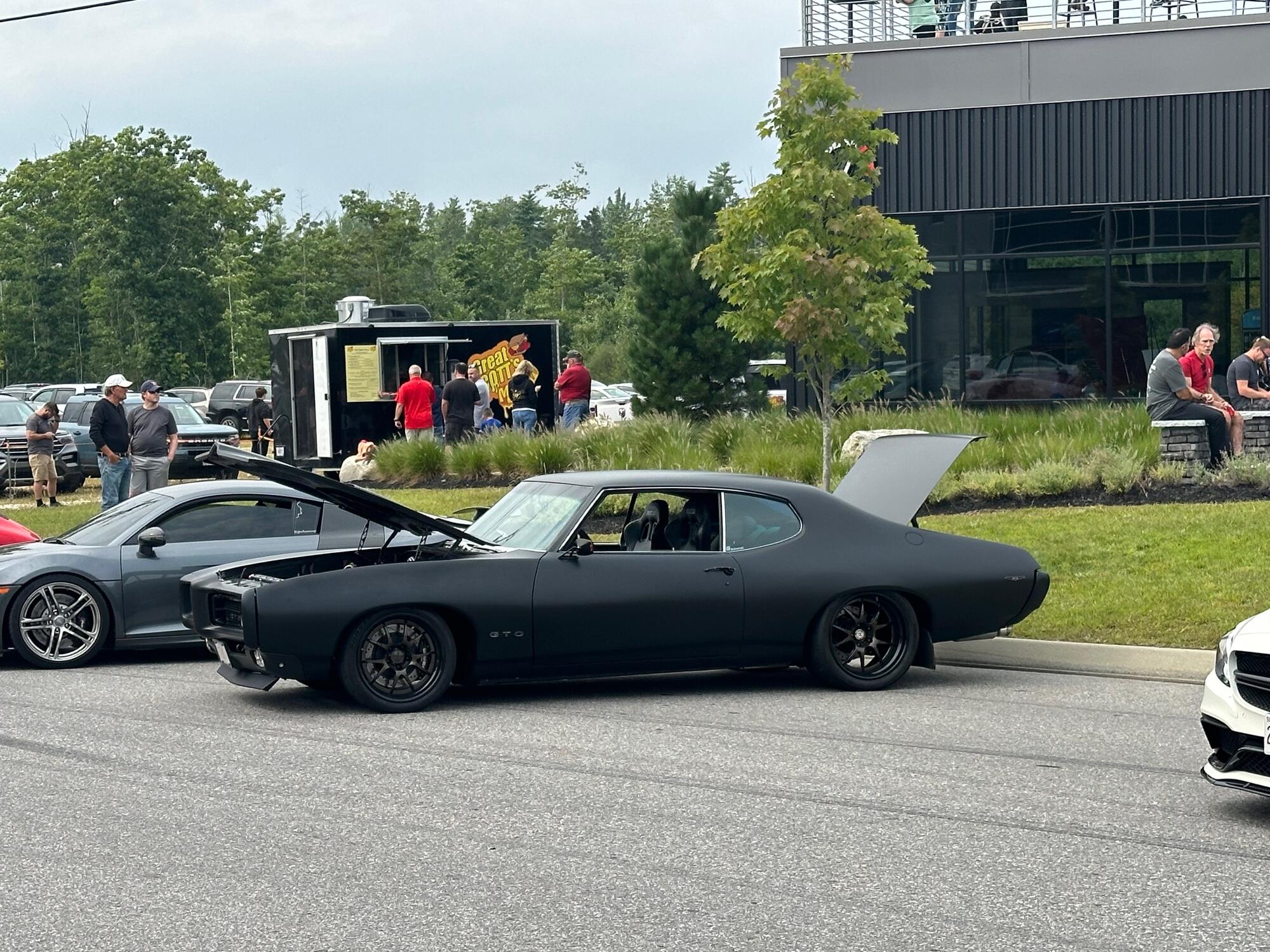

      1st Cars and Coffee
      Thanks Josh,

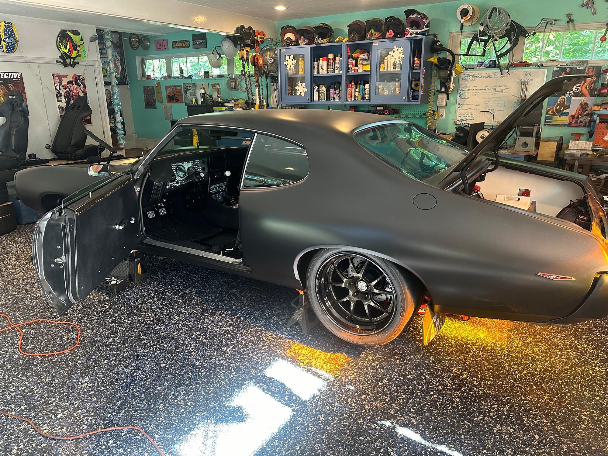

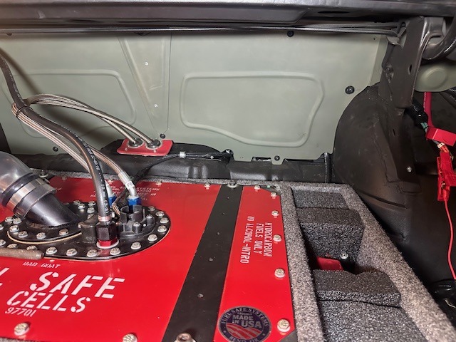

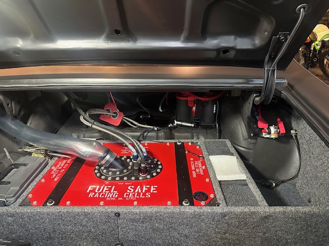

      Had a good weekend, finished up some aluminum trunk panels to clean things up.
      Was able to drive down to my Moms retirement complex that was having a Cars and Coffee even last weekend.
      First time for the wife in the passenger seat too. She kept me reigned in when I started to go a bit too fast.
      Parked next to a real 1966 427 Shelby Cobra.

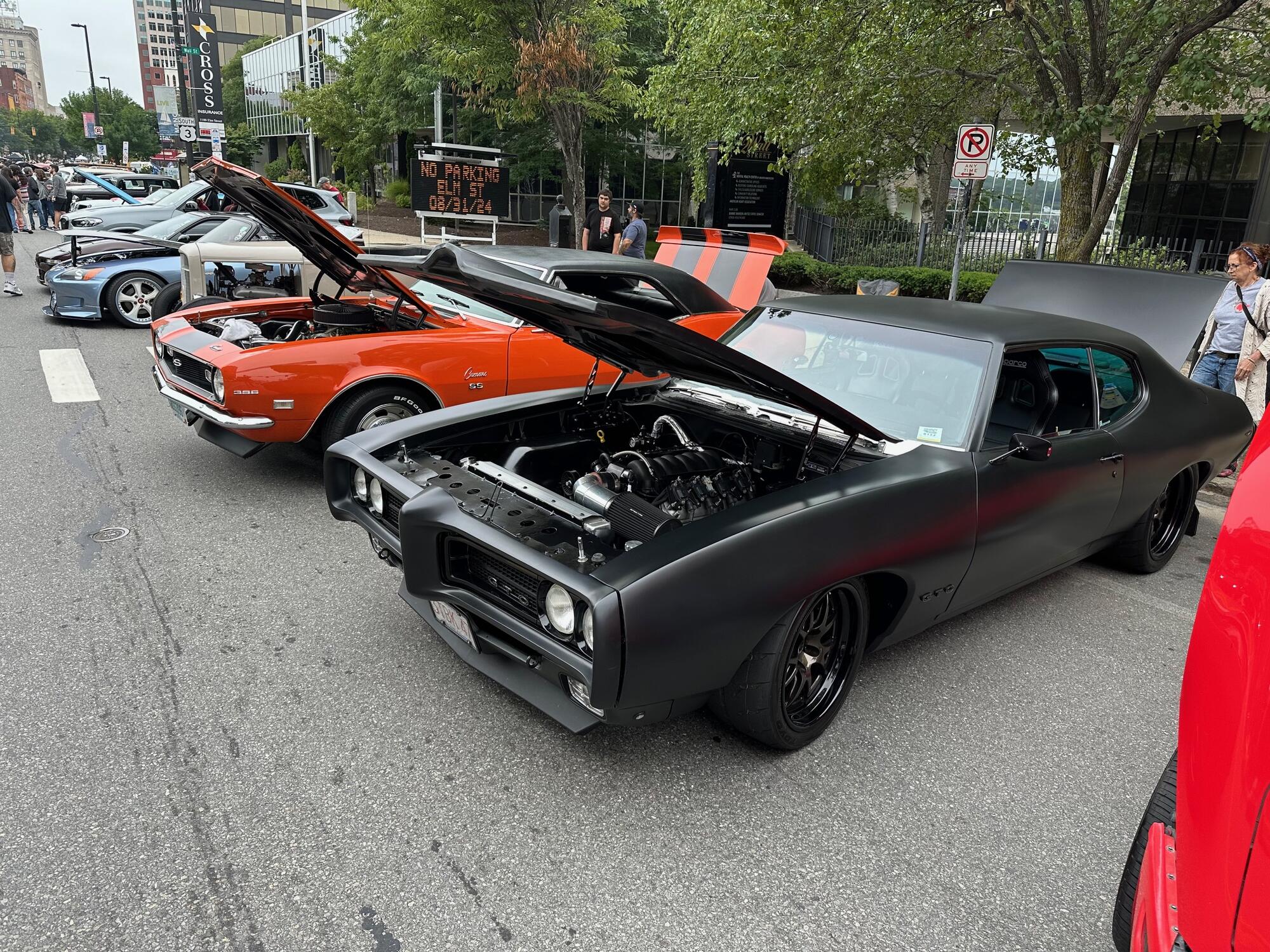

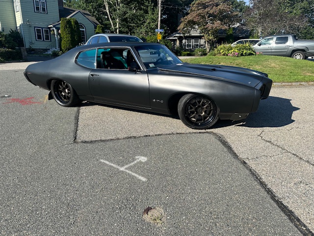

      2024 Car Shows
      Happy New Year!
      2024 was a great year for me, putting some miles on the GTO after years of work!

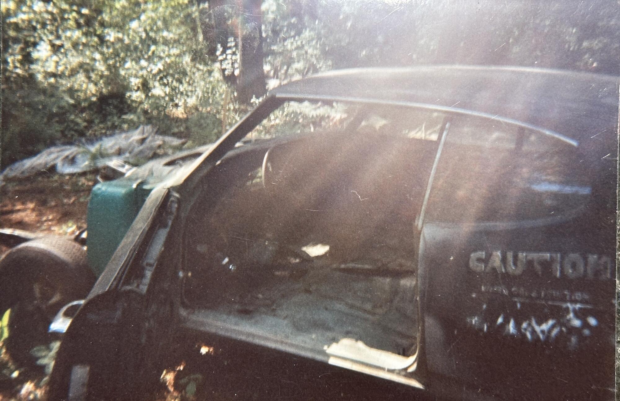

      For those of you that don't want to read from the beginning of the thread, I bought my dream car just after I graduated high school in 1983!
      I tore it apart, started fixing what I could afford with a college students budget.
      Boxed up the parts and pushed it out in the woods for 29 years.
      Bought the Roadster Shop chassis in 2012 and slowly picked away at it.
      Being my first Pro-Touring build I struggled at times.
      Just want to say thanks to everyone who has given me encouragement and support, you all have been really helpful!
      And to all of you that are still working away, don't get discouraged, keep at it and keep checking those things off your lists!
      My lists had separate lists!
      Seemed like the closer I got to driving it, the longer that list became.
      Looking forward to going to more shows with the two grandsons in 2025
      Oh and I got back on the Dyno to tune in the Holley Terminator X in October and was able to get 432 rear wheel HP, so about 500 at the crank

      Plus the coolest thing, was teaching my youngest daughter how to drive it! Here first time driving a stick shift too, she only stalled once.
      Now she wants a GTO she said!
      Eric
