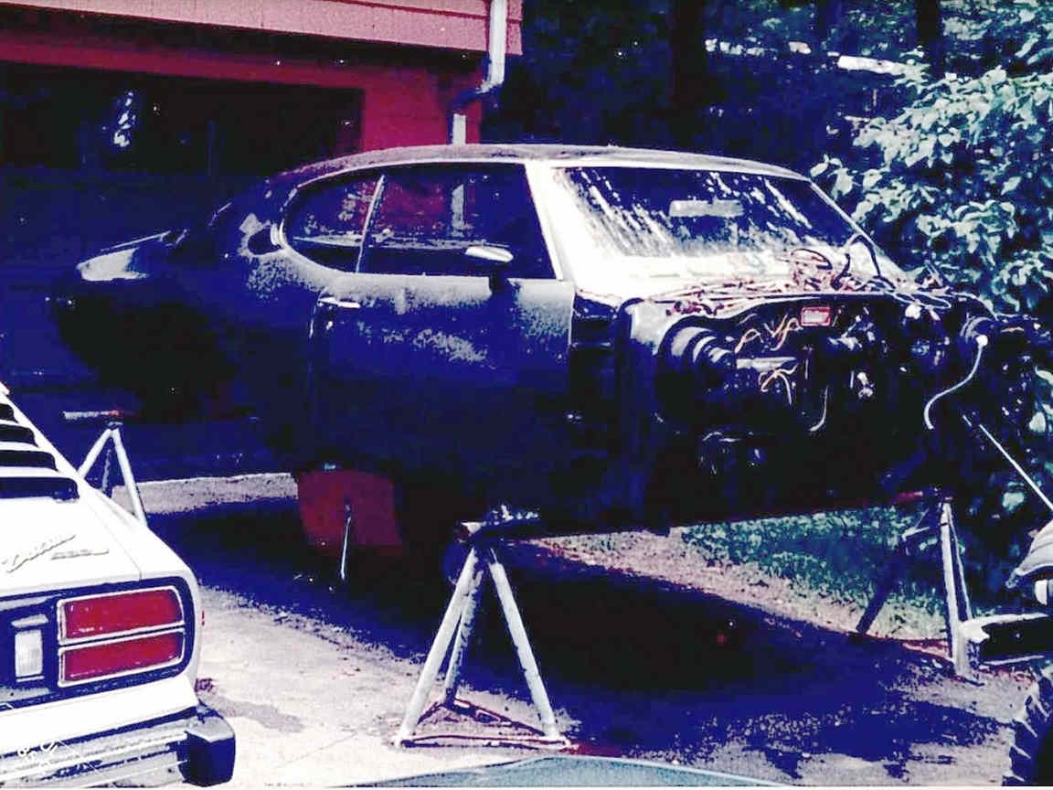

      To Do List...
      It would be an honor to have you down sometime and help get me inspired. I am on the North Shore so pretty far from Taunton, looks like they do nice work there.
      Feels like there is so much to do and the list never ends. I am sure when I hear it fire up for the first time it will make me want to finish to get it out on the road again.

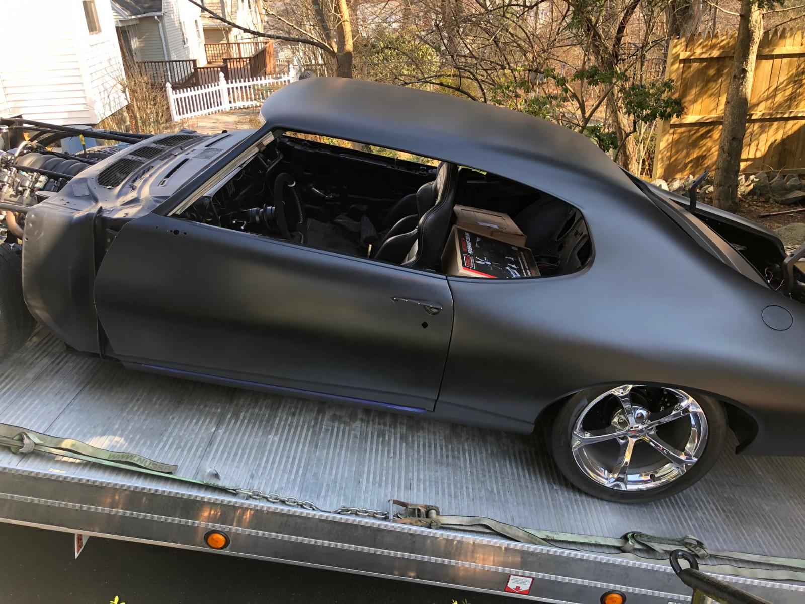

      Every so often I need to remind myself how far the GTO has come from when I bought it 33 years ago.

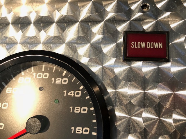

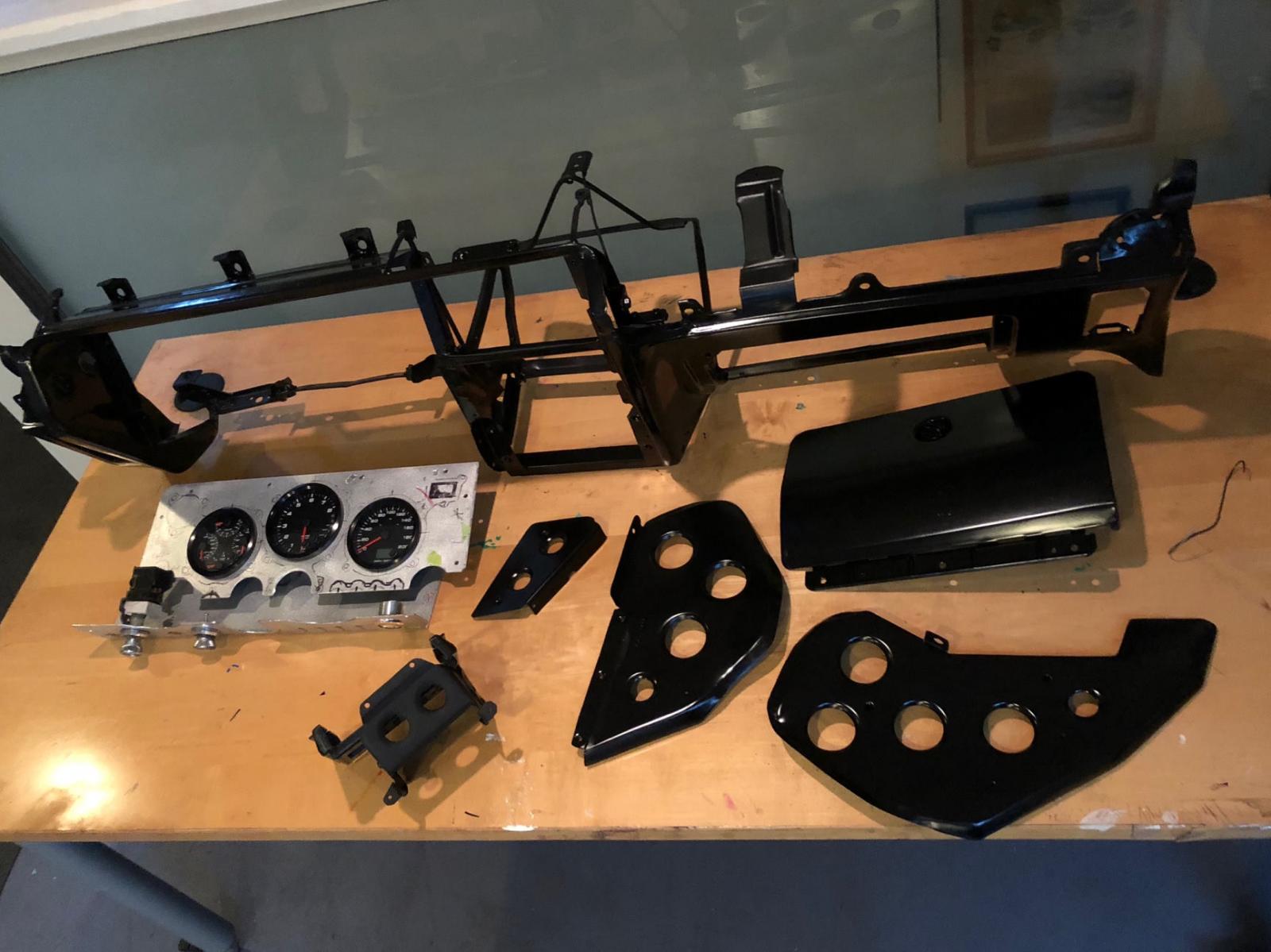

      Custom Dash

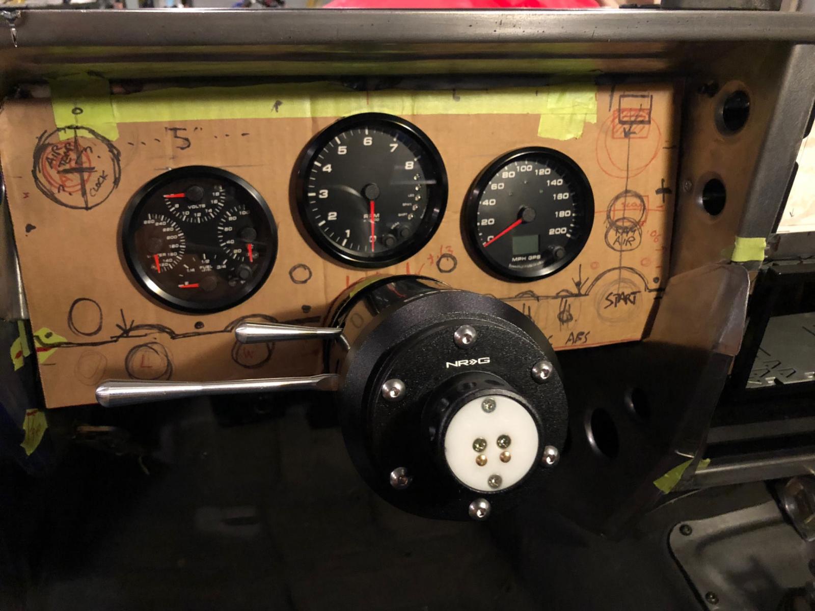

      Ok this took a while but I made some progress on dash, so many little custom brackets.
      Speedhut gauges installed, new Flaming River tilt column, Ron Francis key-less ignition (RFW-IS10)
      Still lots to do but happy to be working on it again!

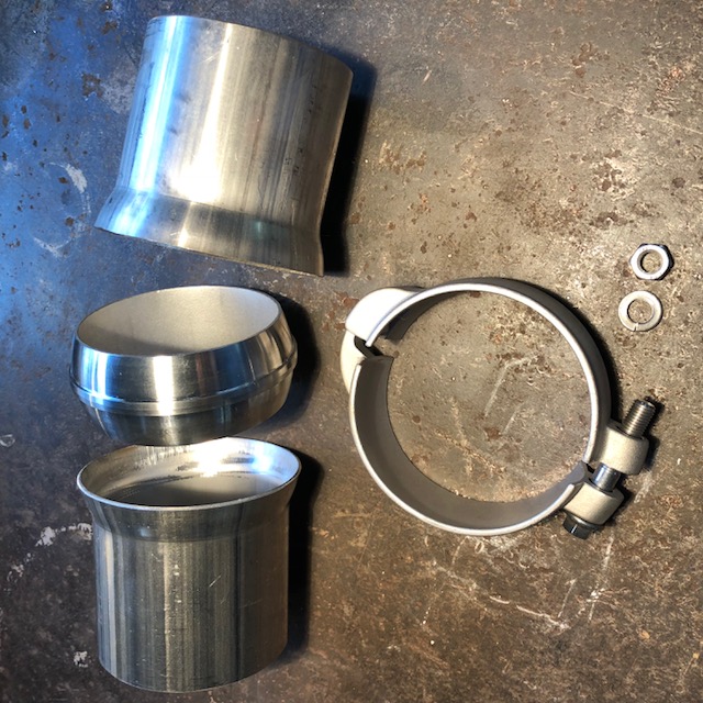

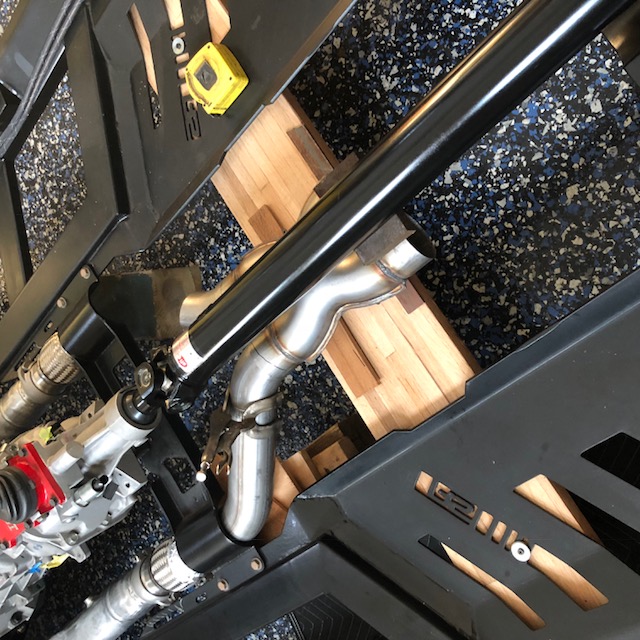

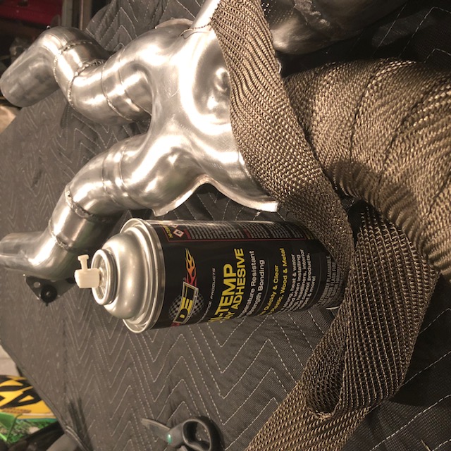

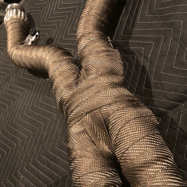

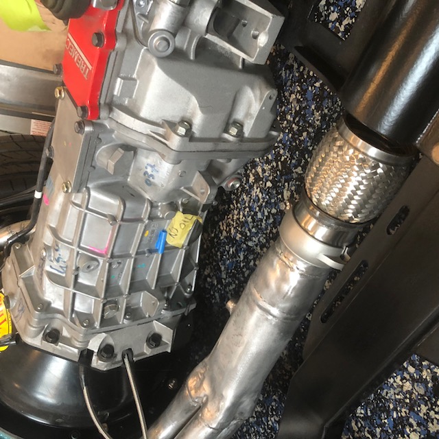

      3in Exhaust
      Quick update,
      I finished welding the the exhaust up to the mufflers, going to do tailpipes under rear end later.
      Went with the black Speedway bushings for the mount brackets close to pipe since they have a higher temp rating.
      PN 91000118
Size:  136.4 KBName:  IMG_0676.jpg
      Rear mount bracket before fully welded.
Size:  101.4 KBName:  IMG_0823.jpg

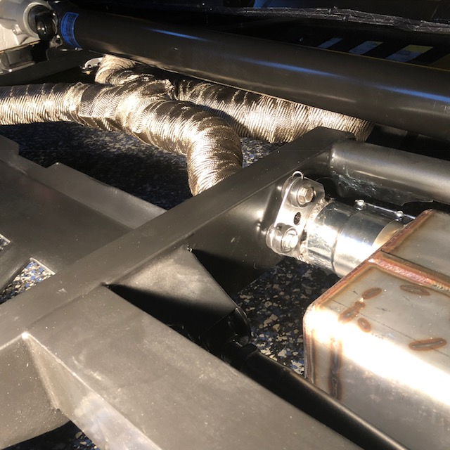

      DEI Titanium wrap 2" x 100' roll
      Used the adhesive spray on the exhaust to help wrap it tight, I am sure it will burn off. Will be adding more stainless zip ties.
Size:  168.0 KBName:  IMG_0848.jpg
Size:  116.1 KBName:  IMG_0863.jpg
      Ball flange from Summit PN JBC-997301

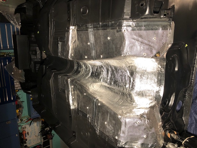

      Still checking things off the list, heat shields, fuel lines, AC, gauges and lots of wiring.

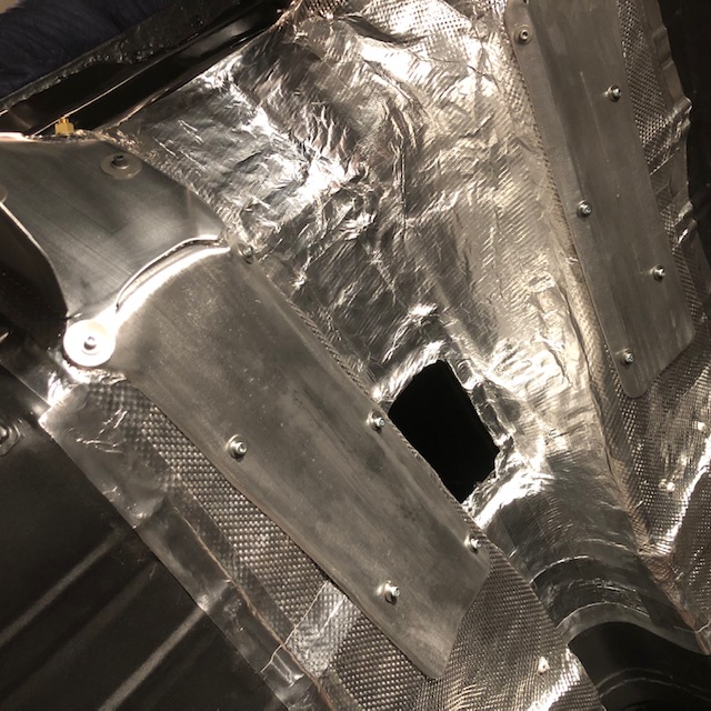

      What product are you using for the heat shield under the car?
    7. #487
      Jun 2012
      N. Shore, Ma
      346
      Hey Andrew,
      For the trans tunnel I went with a sheet of Speedway Motors, Aluminized Heat Barrier, 40 x 36 Inch PN 70414001 and I used silicone to adhere.
      For the bottom of the floors I used DEI adhesive backed Floor and Tunnel Shield, with the DEI tape perimeter.

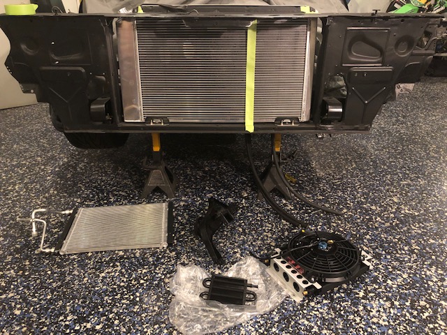

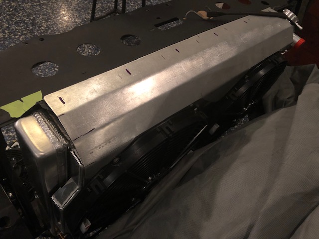

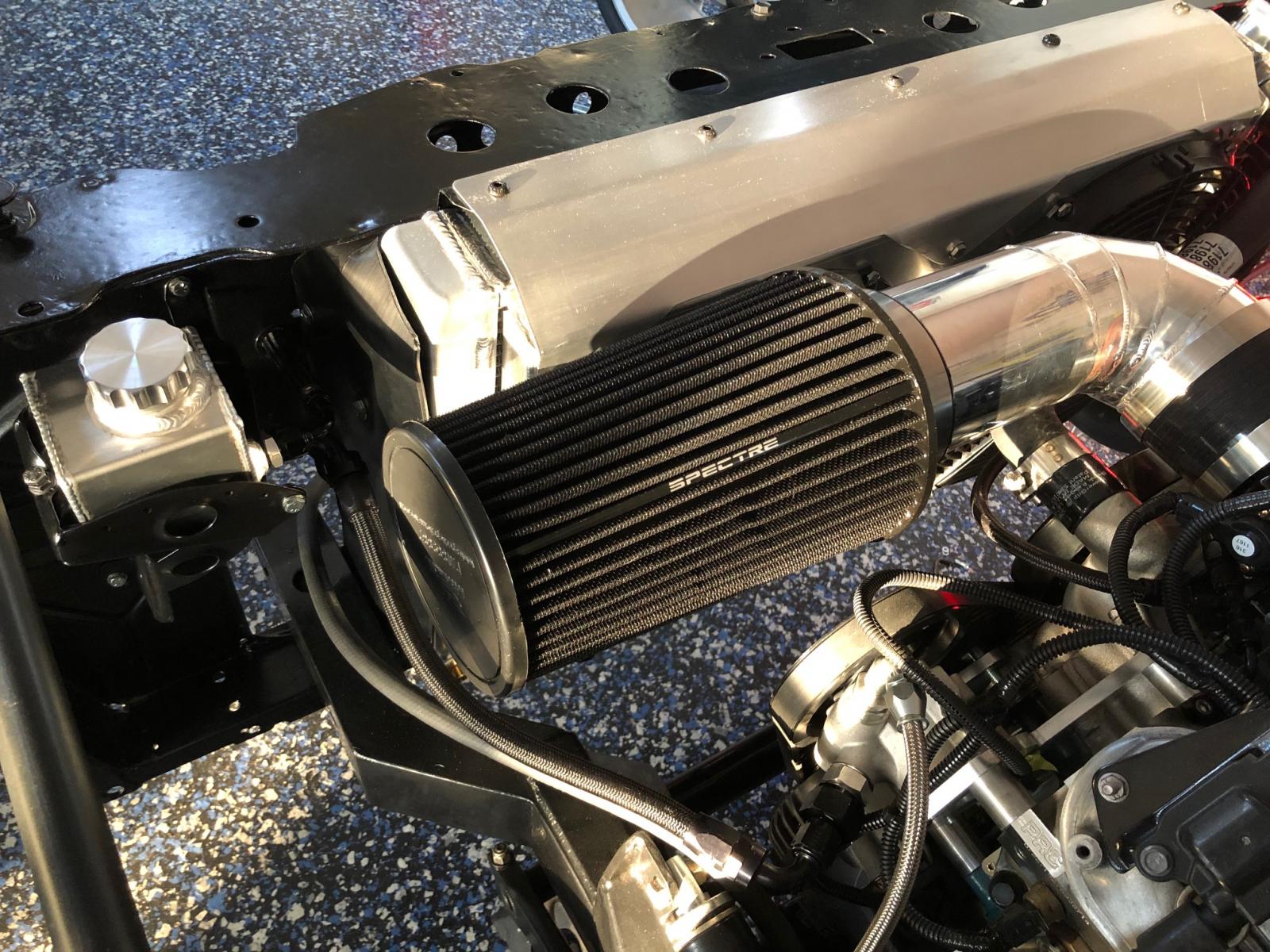

      Radiator
      Sorry for the lack of updates, still getting things off the list.
Size:  155.8 KBName:  IMG_4040.jpg
Size:  146.7 KBName:  IMG_4104.jpg
Size:  140.7 KBName:  IMG_4201.jpg

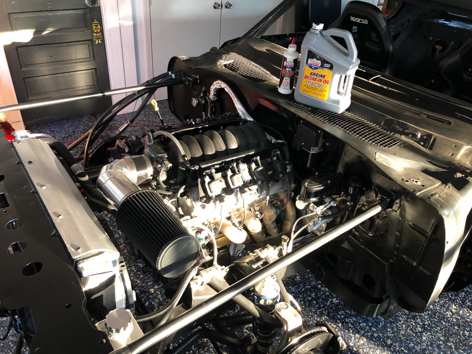

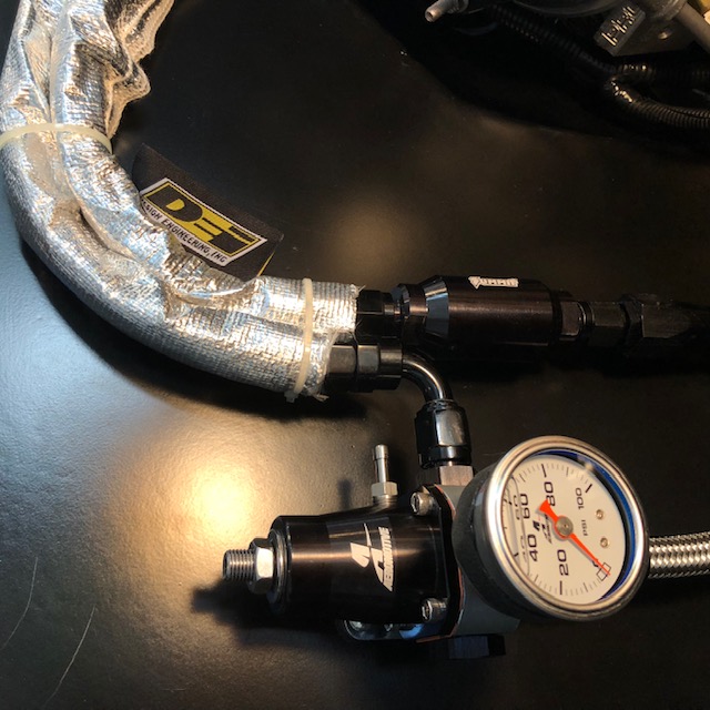

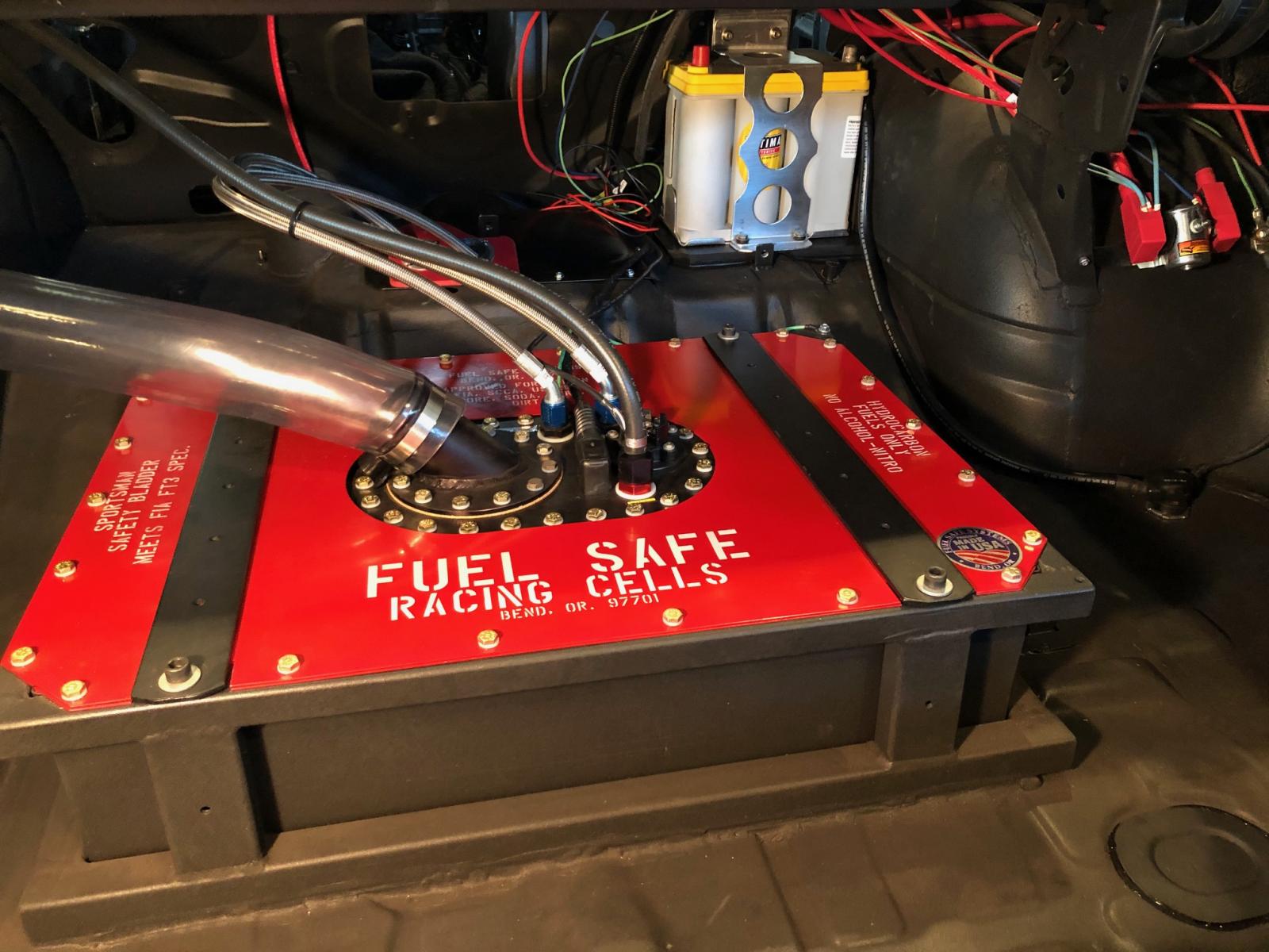

      Fuel
      I have been picking away at all the details for a while now, but it will be a big boost for my motivation to push hard and get things done once I hear it run.
      Excited that my buddy who owns a well established Porsche speed shop will soon be sorting out the wiring and helping me finally get it fired up.
      http://autobahnperformance.com/
      Hoping to drop it off in a week or so.
      Looking for tips on what type of gas to dump into the fuel cell?
      Was thinking the Sunoco 260 GTX 98 Octane Race Fuel?
      I really dont want to have an ethanol fuel sitting in the lines for months while car is still being worked on.
      Crossing my fingers that all goes well.
      Will be filling, bleeding, priming fluids this week.

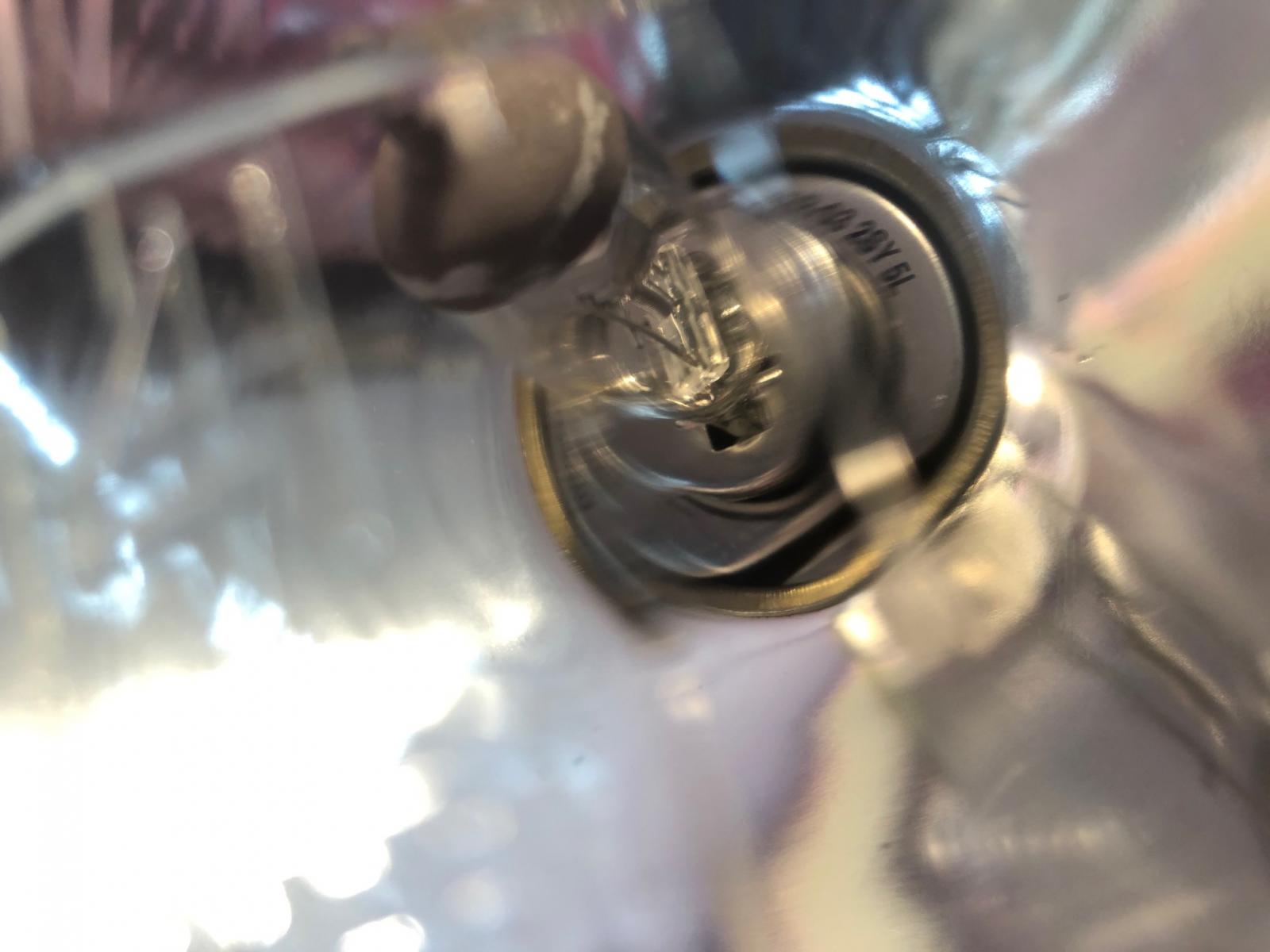

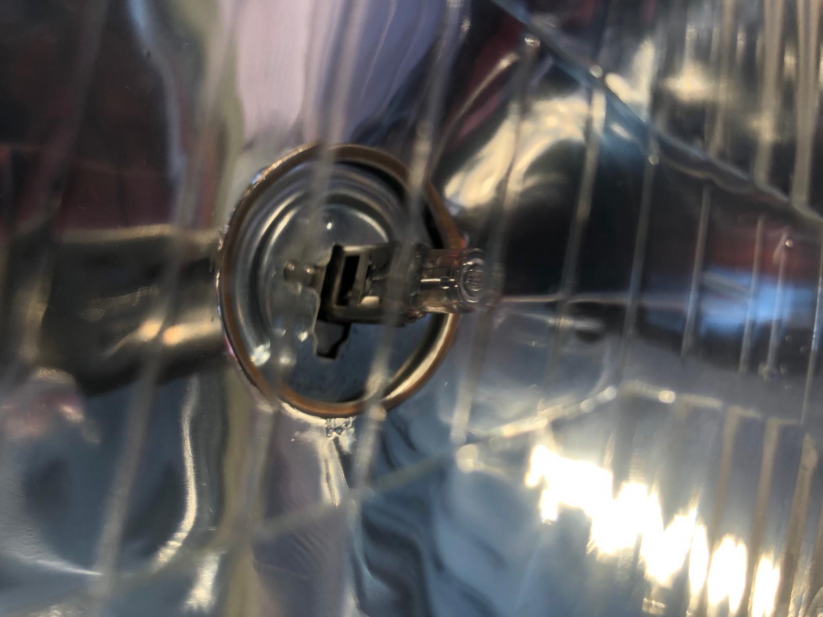

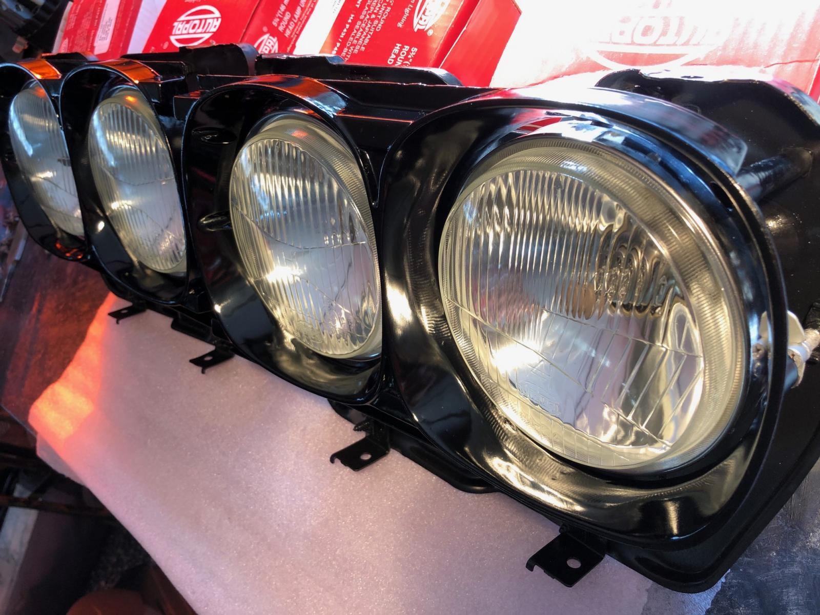

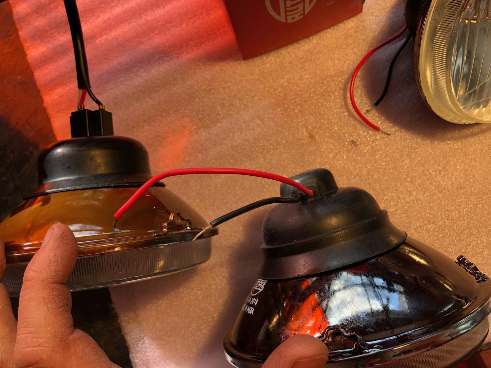

      Halogen Headlight Conversion
      Getting some of the little things done while the wiring is getting finished.
      After searching most of the posts here on headlights I went with a set of the Autopal Halogens.
      http://rimiusa.com/index.php?main_page=index&cPath=12
      Blacked out headlight trim and grills since the chrome was pretty rough.
Size:  201.3 KB Name:  IMG_4656.jpg
Size:  102.0 KB Name:  IMG_4658.jpg

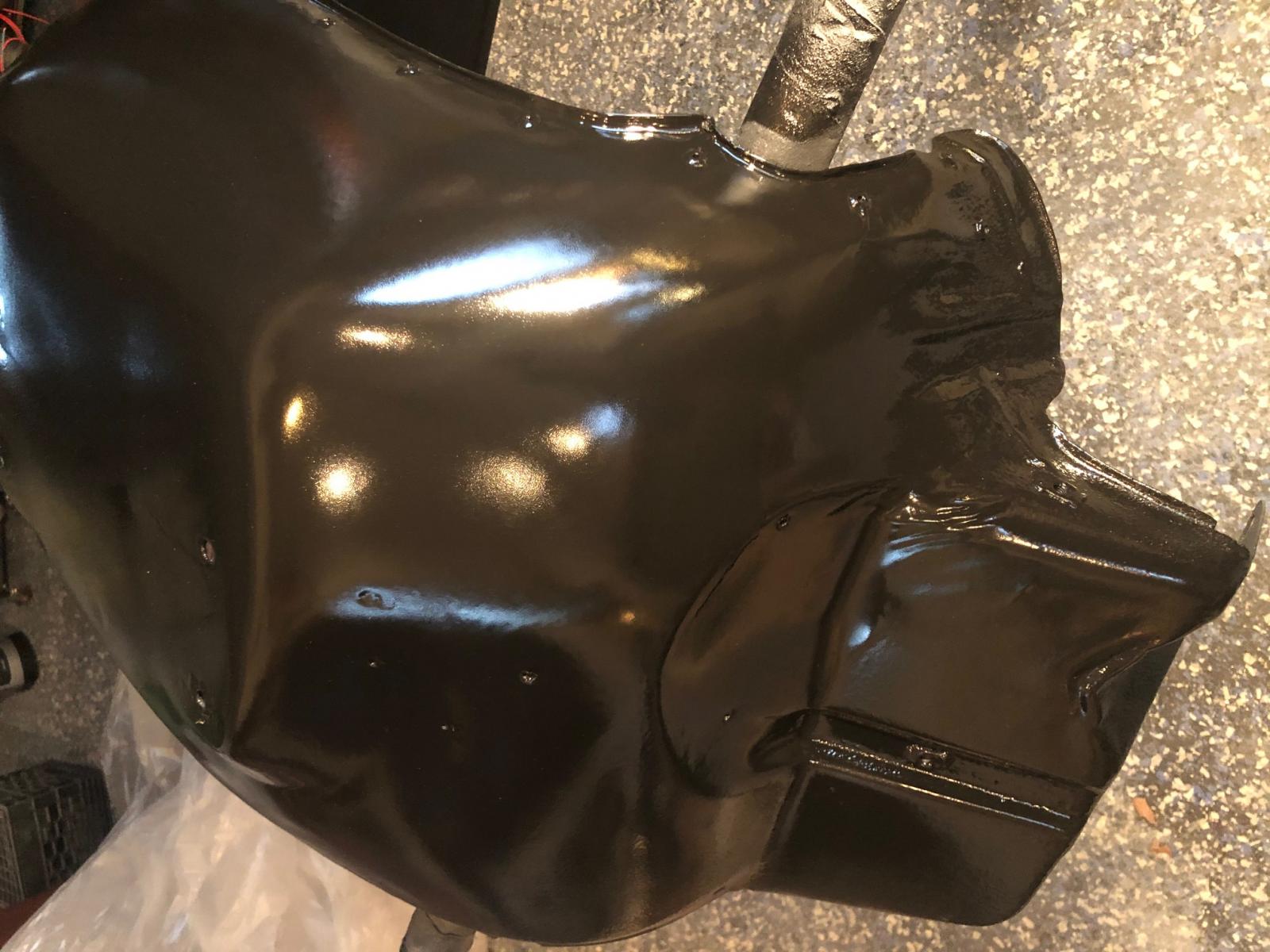

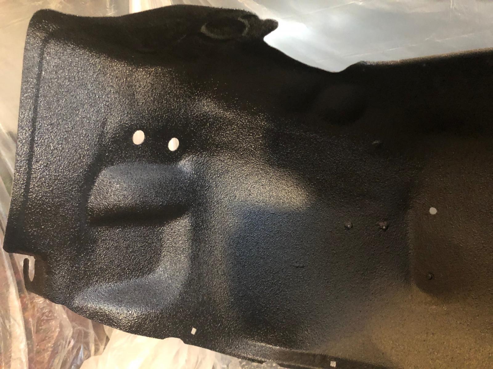

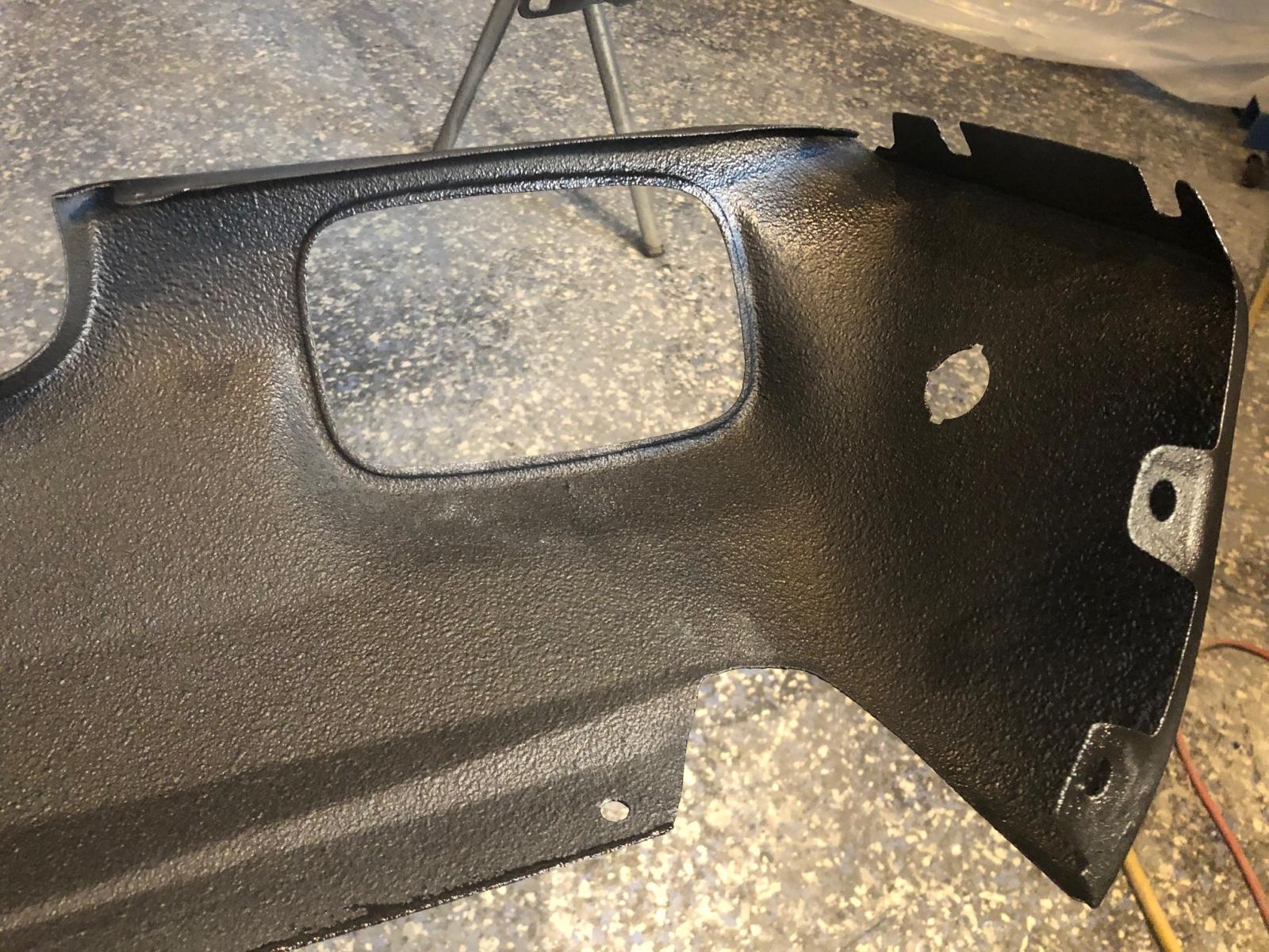

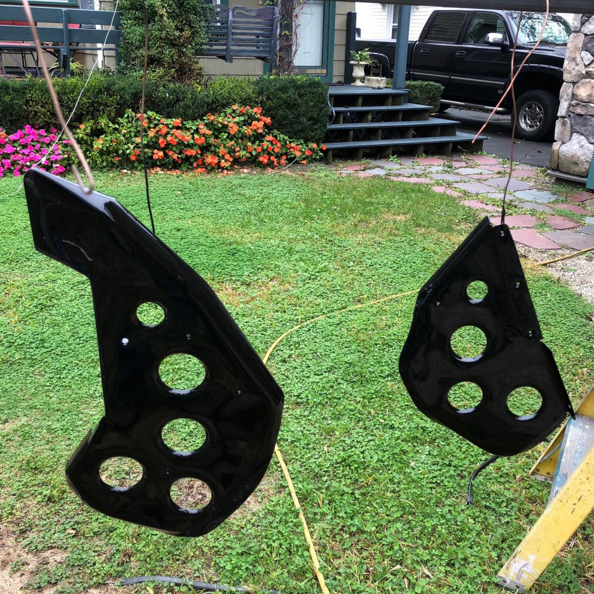

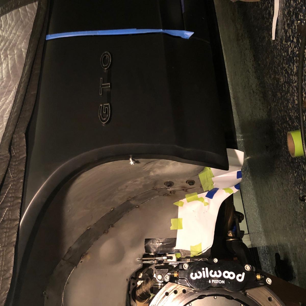

      Still making slow progress, this year has been tough.
      I was finally able to widen the inner fenderwells last week.
      Raptor lined the insides.
      Hope to bolt the fenders on tomorrow.
      Attachment 181745
      [ ATTACH=CONFIG]181748[/ATTACH]
