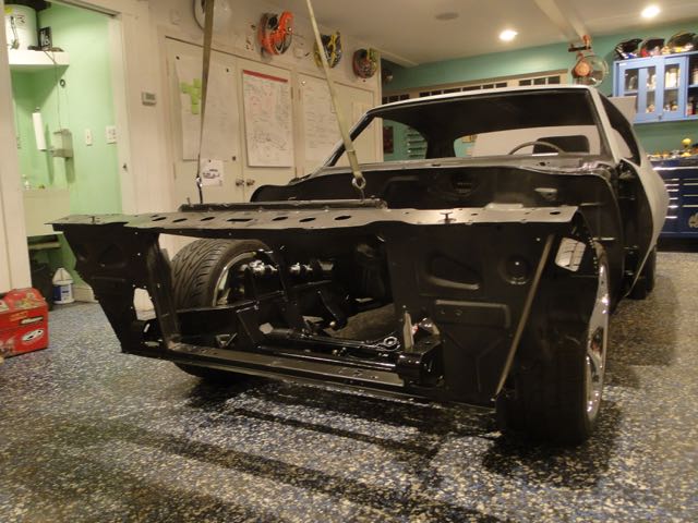

      Hey Andrew,
      The fronts are 275/35ZR18 and I think I can go wider but I need to check.
      The rear tires are 345/30ZR19 and I have almost 3/4" clearance on both sides of the tubs.
      The Vette rims are for mock up, I won't feel comfortable driving it with the 1" spacers.
      Eric

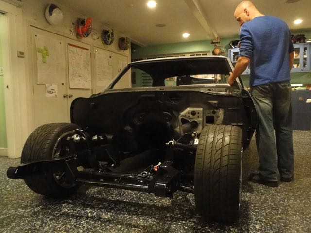

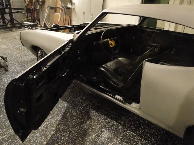

      Hey Gus I am sure the body will be off again soon, I need to install the fuel cell, run fuel lines still and I didn't get the brake lines installed yet either.
      I just want to keep the progress going on the body and get all the gaps worked out.
      Watched a Christmas movie with the family tonight so I had to rush getting the fenders and nose on, only put a couple bolts in just to keep parts from falling off.
      Cool to see it on the ground again! I like how low it sits and it will be a bit lower once it has all the rest of its parts

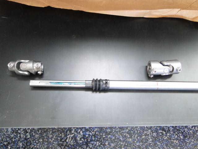

      Not much of an update but Santa dropped off a few new parts.
      Steering Shaft has a good 5" of travel to help keep the steering wheel from crushing your ribcage when really bad things happen.

      Borgeson Universal Telescoping Steering Shaft BRG-450024, Steel Alloy,
      (Mfr. #: 450024)

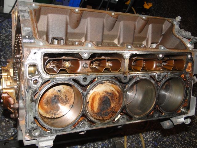

      Mike any news to report on the engine damage done to the 400? Put up a Youtube video link if you haven't torn it apart yet so that people can hear it, I am sure people can give you some feedback if you still need it.
      Merry Christmas to you too Eric. I can see Santa was good to you also.
      Nice Piece. Very safe. Good thinking.

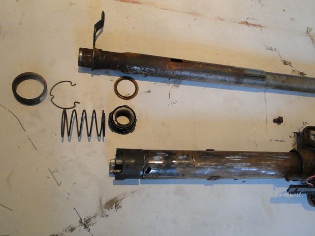

      Steering Column Mods
      Happy New Year!
      Good luck with all of your driveway drainage Gus. I have been busy working on my house the last couple weeks too.

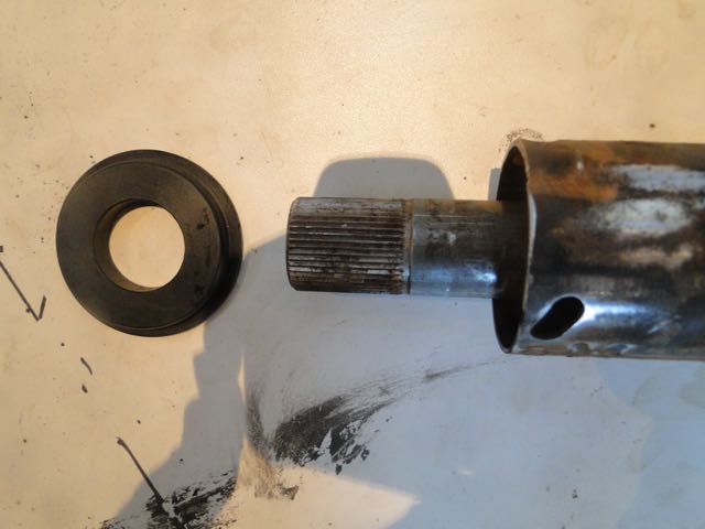

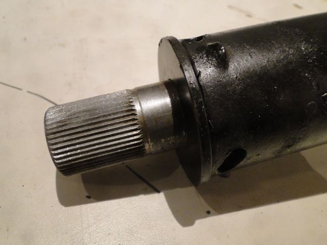

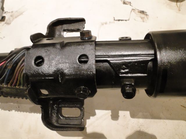

      Was able to cut back the stock steering column, made up a Delrin bushing to replace the sloppy old bearing
Size:  37.1 KBName:  DSC01537.jpg
      Moved the mount bracket down then slotted out one side so I could move the column back (inside the car) almost 2"

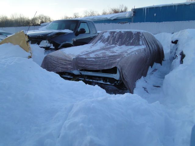

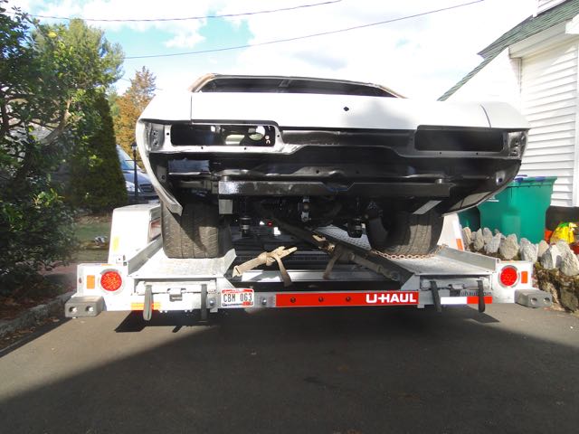

      Outside!
      Having a little separation anxiety!

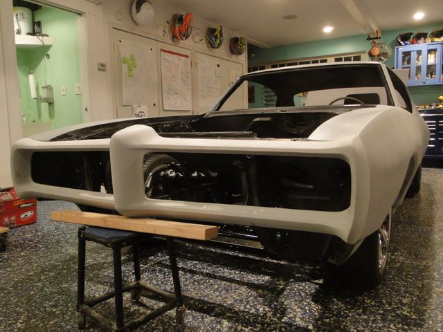

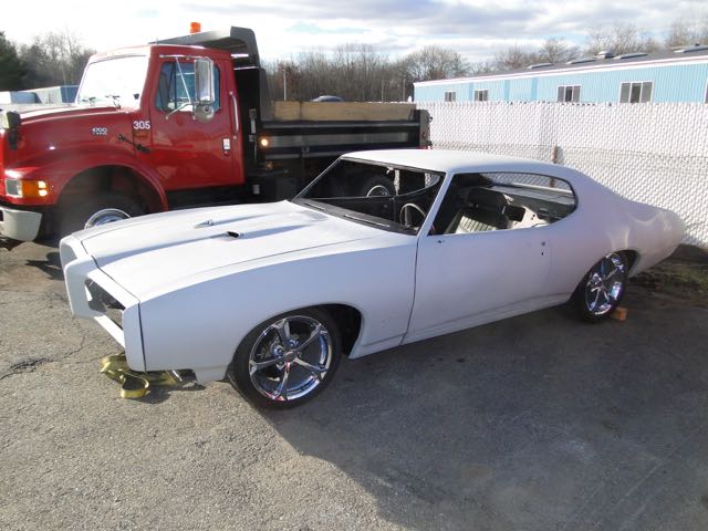

      Dropped off the GTO at the frame shop for some help squaring up the quarters at the door jamb, drivers side was still a little in from the accident. Cool to see most of the body together again, first time in 30 years. I hope the tarp stays on so it won't fill up with snow.
      I have plenty of work to do on the LQ9 but once again the old house projects are stealing my time. So Gus I would think at least another year before I am driving it, unless Chip Foose and his crew want to help out.

      She looks great Eric! It's such a shame that as nice as the body is and is gonna be, that beautiful chassis is hidden underneath. Sorry to hear she's off to the frame shop but at least you know what needs to be done and that you need a hand to get it done right. Another year? I might just catch up with you yet.... NOT!

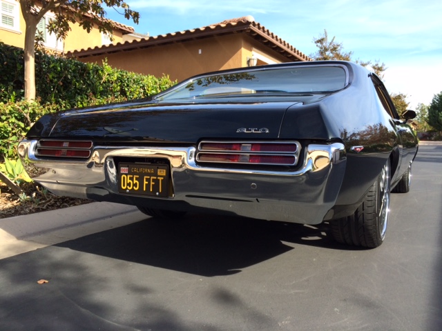

      Just popping in... I really wish this site would notify me when there's a post. Anyway, let's see... the motor noise, which was clicking, went away. Which tells me the lifters were collapsed. I had removed all of the push rods, and did a compression test, as well as a cylinder load test. Nothing! The motor still has a nasty vibration, with and without power... sooooo, today I ordered my custom heads from Jim Butler himself. I will be using my 400 block, but converting it over to a stroker... hmmm about 467ci. 550+ hp and over 550 ft lbs. of torque. Should be fun. I'm waiting for my cherry picker to be delivered, then I'll start tearing it down. I suspect I pulled a rod bolt, and spun a bearing. Place your wagers...
      Gus, I saw you asked about tire fitment. I have 285's. BUT, 295's will fit when I order tires again. I suggest getting a Wheel Rite tool. It's around $60, but helped select my wheel offsets, etc... I think it looks great, but the test will be when 600 ftlbs gets laid down. Ha, ha....
      I'll keep you guys posted...
      MikeName:  Right Rear.jpg

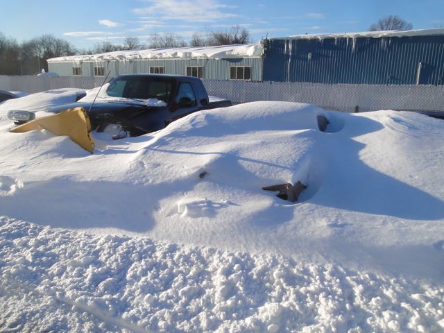

    17. #357
      Jun 2012
      N. Shore, Ma
      346
      Out in the Blizzard
      I keep asking myself why I live here.
      An hour later.
      On the bright side the tarp was still on.
      Eric

      Hi Mike,
      Glad to hear your motor is coming along, I have started to tear into the LQ9 and I am surprised at how clean it looks for having over 100,000 miles.
      Unfortunately that is all I have had time for between all the shoveling around here! So sick of it!
      The Frame shop hasn't made any progress either, maybe when the snow melts they can get to it. (I hope)
      I have been thinking about going with a lighter flywheel as well, and have been reading up on them but I would love to hear from others with experience.
      The reduced drivability wouldn't bother me since I won't be using this car as a daily driver in traffic.
Size:  34.4 KBName:  DSC01626.jpg
      Eric
