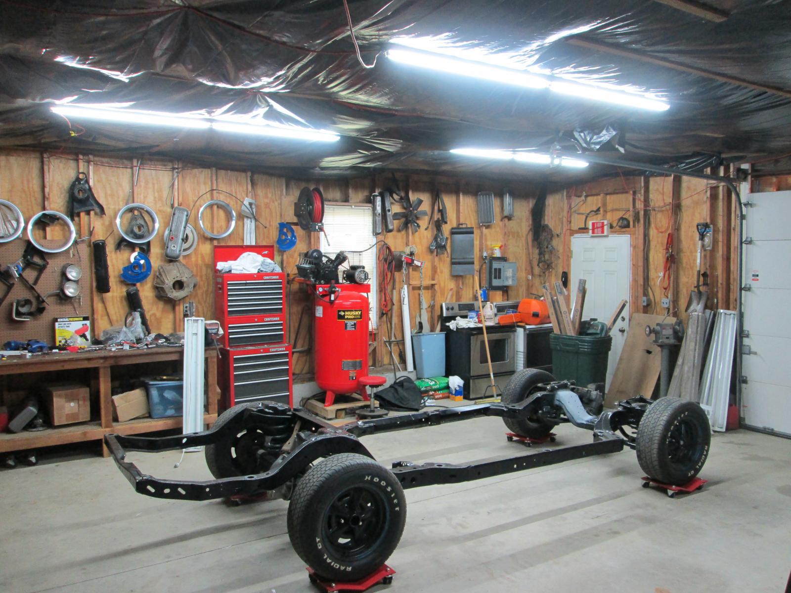

      Thanks for the detailed response and the contact name at Global west. I appreciate it. The point about oxidation is a good one. Yeah, I can imagine how the baer's look as the holes oxidize. And there's no easy way to clean 'em up either. Going with the black was very smart on your part. However, my spindle situation is a bit different... The tall spindle setup from SC&C have oversized ZR1 corvette ready bearings as part of a promotion I fell into when I placed my order with Mark. So hopefully Wilwood sells a big brake setup like yours that's compatible with the Corvette's caliper bolt pattern and tall spindle setup that have been engineered into my components. It will be a while before funds are available or the need for the brakes to be installed will be a necessity, but thank you so much for the food for thought. Great ideas!
      I am finding that as time goes by, more and more great ideas and innovations are popping up for our a-bodies. But then I think that maybe I should wait a while longer to see what else comes down the pike... but then nothing gets done. Such a conundrum, eh?
      btw: The light setup I'm using is this one, if anyone is still interested.
      http://www.homedepot.com/p/Lithonia-...10PS/202516724
      Will post pics during the weekend of lights and my cutting progress on the 442.
      Enjoy your weekend Mike. Good luck on getting some project work done AND some sleep!

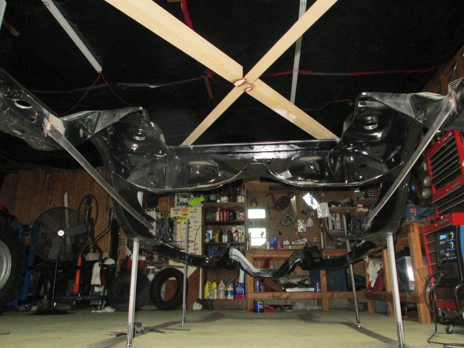

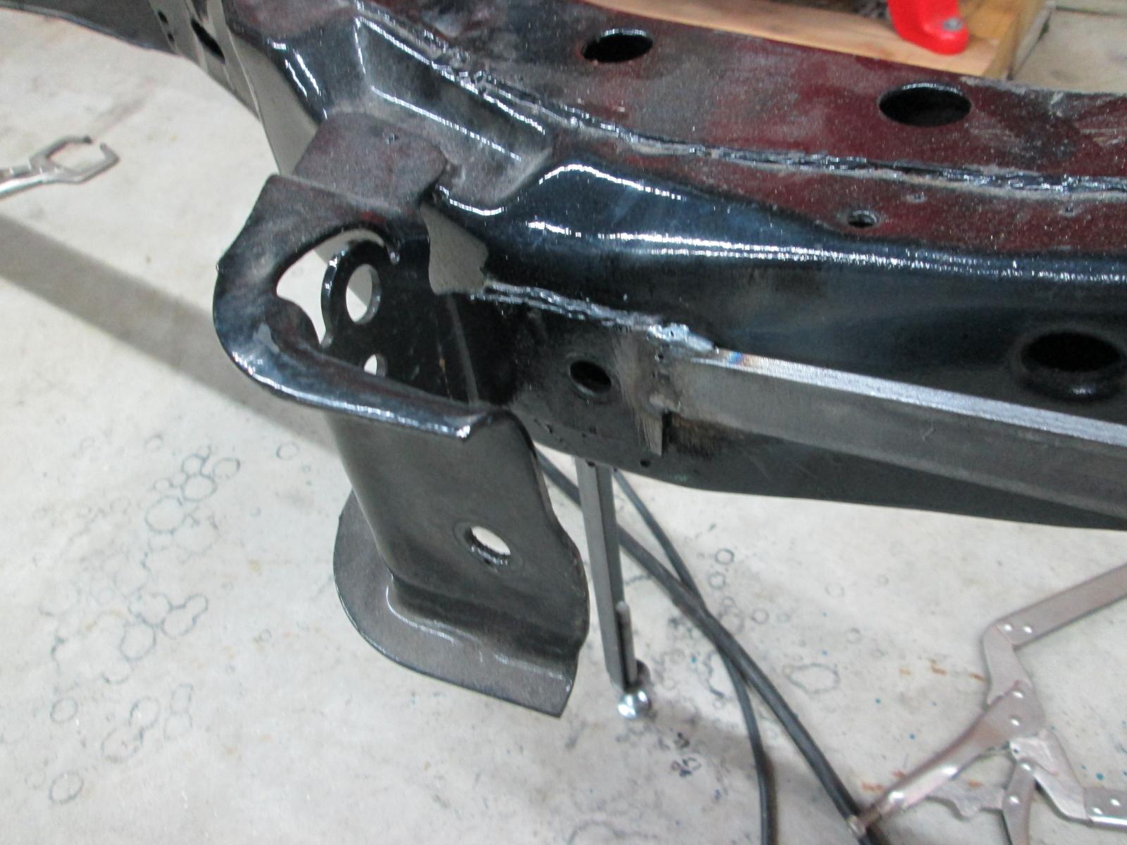

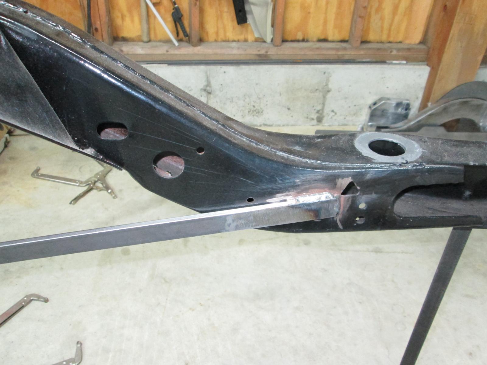

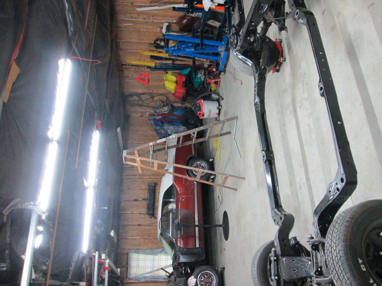

      Hey guys, finally got the light's mostly done. Only the end bay needs more but it's used mainly for parking the tractor or the beat up 'vert. Why does it ALWAYS take 4 times longer than I expect?? Attached some after pics. Should have taken some before pics... the improvement is dramatic. If I make a mistake now, can only blame myself since I can really see what I'm doing now. Sorry about the one pic that's tilted 90 degrees. Not sure why that happened but can't seem to post it right side up

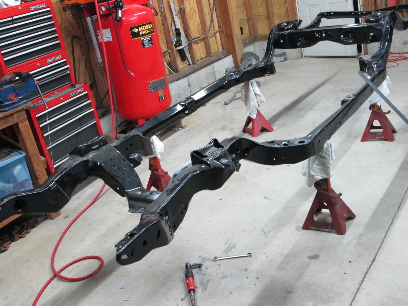

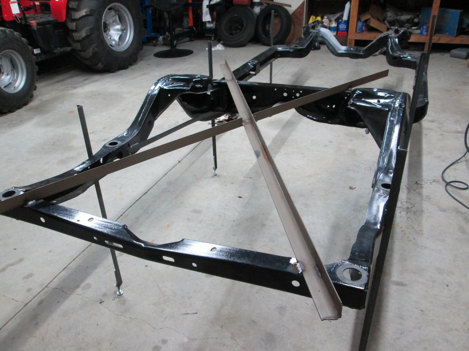

      Looking at the ABC performance frame narrowing kit instructions, I was reminded this is NOT just a "put the frame on some jackstands and start cutting" deal. Tony has very specific setup instructions, including welding on bracing and the fabrication of adjustable levelers so the frame is properly supported on all critical points, so now that the lights are done, I'll be fabricating leveler's (found I had purchased all needed bolts and washers, and had cut up an old angle iron bed frame to use for the levelers! ) and welding on bracing before the plasma cutting starts. I'll post pics of my progress. But I'm fairly sure this part of the progress won't get too far during my vacation.. I may start the mintubs since the heat and humidity is coming back tomorrow and the a/c in the attached garage sure takes some suffering out of the equation.
      I'll post what I've done as I do it. Hope you guys are getting some stuff done this weekend. Mike, you're in sunny CA so hopefully you don't get the heat and humidity Eric and I get here in new england. But of course, you guys are younger than me so you can take the heat...
      Oldest daughter and husband coming over this afternoon for a swim and to show us the wedding pictures that just arrived so gotta get out there and start welding.

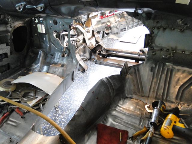

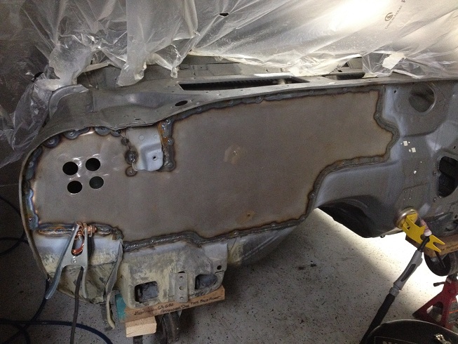

      Firewall patches

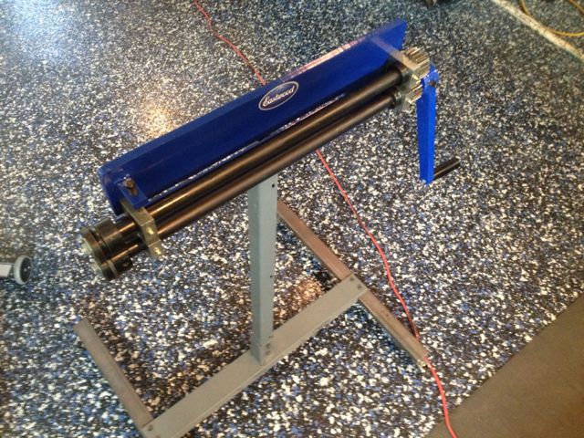

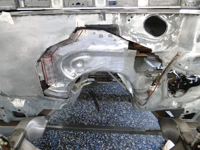

      Busy making patches to the firewall and testing out my new bead roller, having fun with it so far but would love to stick a motor on it someday for better control.
Size:  110.1 KBName:  DSC09699.jpg

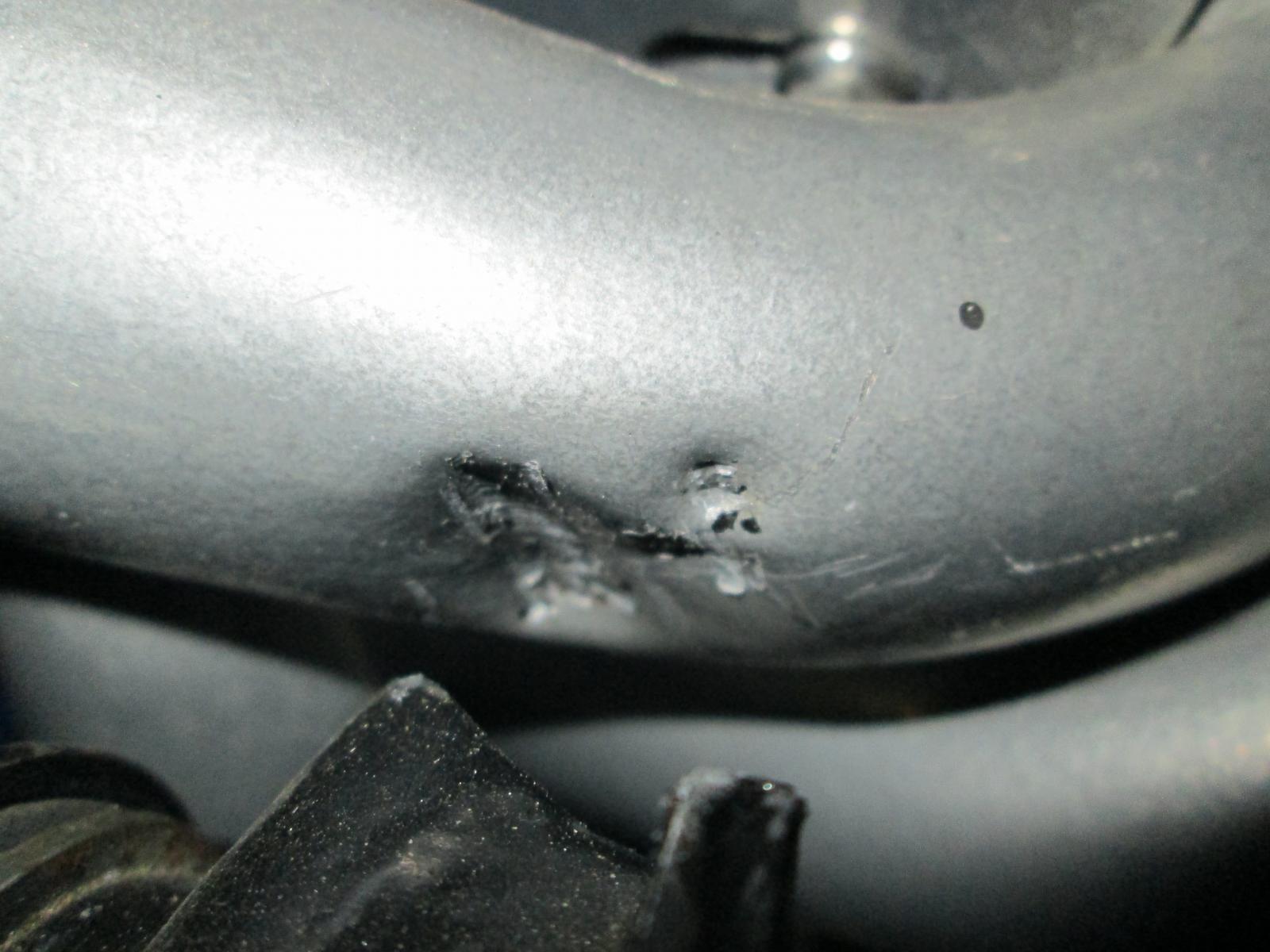

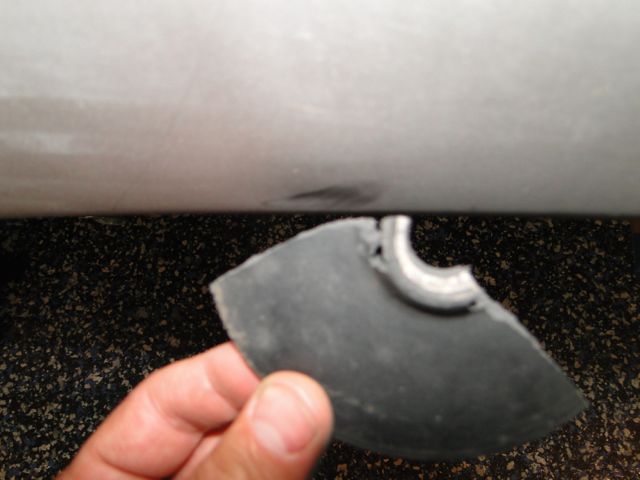

      Crappy rubber sanding disc backer blew up on me today and shot across the garage putting a dent in the new rear quarter!
      Gus I am running the same brakes that Mike is using, 14" and 13" Wilwood's.
      Your earlier question about how to get the undercarriage so clean, after it was media blasted I could still see some rust on the surface so I sprayed Eastwoods After Blast on it. Then I used everything from an 80 grit flap disc on a 4 1/2" grinder on the high spots of the welds, (be really careful not to take off good metal with this, it will burn through and you will have more holes than when you started) to then a Die Grinder with 2" Roloc discs ranging from 36 grit up to scotchbrite, then my DA Sander with 80 grit, and then after sanding all the corners by hand I used a 4 1/2" grinder quick strip disc (like a big scotchbrite wheel) to really clean it. Then smaller scotchbrite wheels on drills. Don't keep track of the hours either, I don't want to know how many hours I spent doing it! I have the same problem where things take at least 4 times as long as you expect them to.
      Oh and don't use a regular hard grinder wheel if you are trying to clean up you welds on the sheet metal, no matter how hard you try you WILL either grind too far though or not notice that you have been grinding on a spot that you were unaware of.
      Once I have all the welding finished I will be spraying everything with an epoxy primer, then on the underside of the floor a truck bed liner, on the top side of the floor LizardSkin Ceramic Insulation.
      Eric

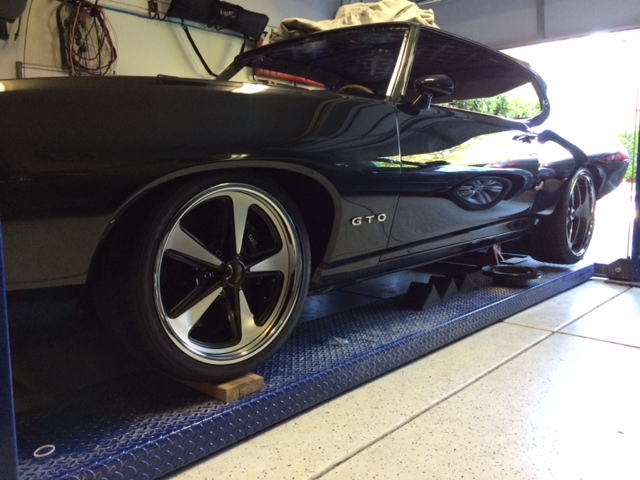

      On other news, I got my tires mounted. Unfortunately, I didn't anticipate the tire crown on the outside edge. For some stupid reason, I modeled squared off edges, formed to the section width of the tire. So, the bad news is I could've easily fit 10.5" wheels in the rear. The good news is, 295's will fit no problem for my next tire order... have yet to fit up the fronts. But, if it's the same story, I can go with 255's, instead of my current 245's. Oh well.
      Name:  Rear Wheel with Tire.jpg
      Name:  Front End Assembly.jpg

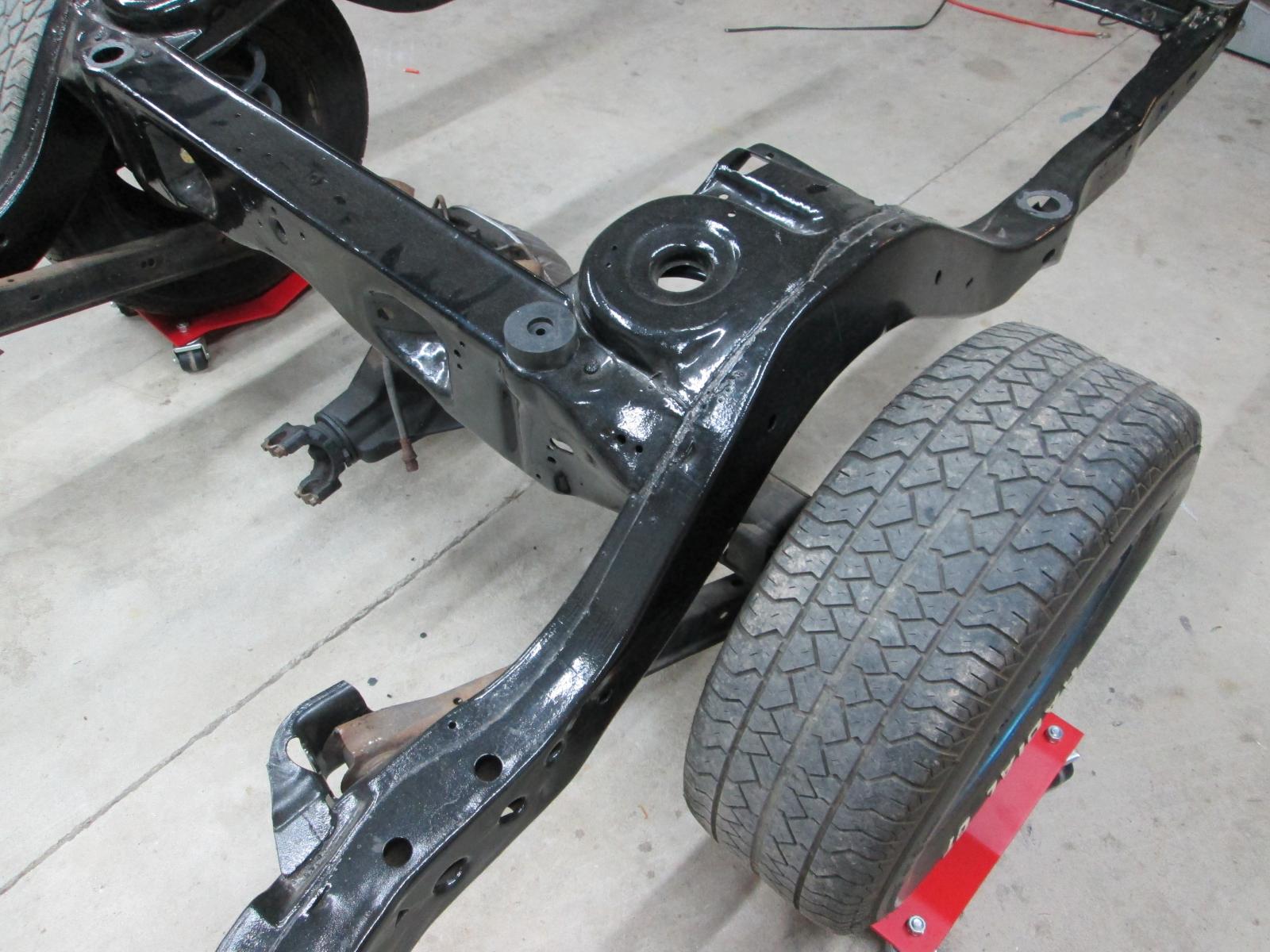

      Well got the youngest daughter moved in yesterday... miserable, hot and humid, but did get some angle iron cut up for the vertical support for leveling before I start the frame mods. Frame is stripped of body and suspension, raised on jack stands in prep for welding the levelers on. Hope to do so this afternoon. Not much to see but attached pic anyway.
      btw: Yes, ABC did include the coil over shock mount components with the mini tub frame mod kit. Discovered when I finally opened everything in the box. Everything looks nicely made and the instructions are very good, but slow and steady will be the rule with plenty of time to allow the frame to cool as I go.
      Thanks again Mike. btw: Nice of you to stay up with the little guy so the Mrs. can sleep... I'm sure she appreciates it. Mine did!
      Name:  ready for vertical adjusters.jpg
      You have a good week also.
      gus

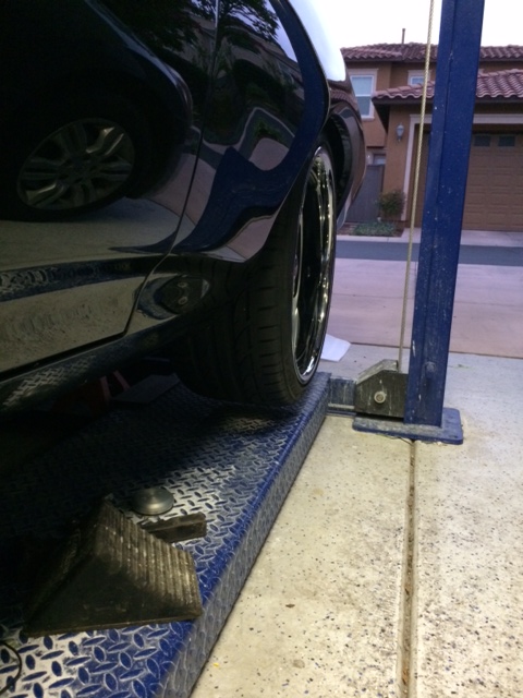

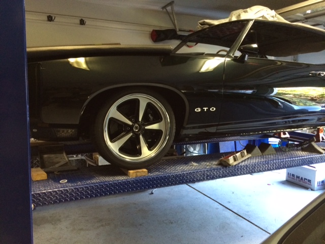

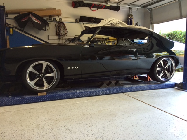

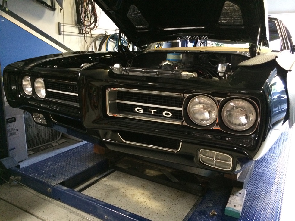

      Guys... some exciting news yesterday. Two things. One, I finally got the engine to fire. For those of you installing a HEI distributor, with a Painless Performance Wiring Harness, the Pontiac column ignition switch is NOT compatible! You have to change it to a GM switch. Gus... I think you're ok with an Olds switch. My understanding is that only Pontiac switches have a built in ballast/resistor, which kills power to the distributor while cranking. Completely lame. I was pulling my hair out for days... but, it now sounds freakin awesome!!!
      The other good news is... well... see for yourself... I still have room to lower another 1 or 1.5" inches! Which is awesome! Hope to start on the interior this weekend... windows, door hardware, carpet, etc...
      Talk soon, Mike
Size:  120.1 KBName:  SideView1.jpg

      The bead roller is cool. We DO love our specialty tools, don't we? But obviously, you have the skill to use it. If it ain't preformed, I'd be lost but once you know what you're doing, it's a valuable skill worthy of putting the time in to learn. Like Mike and his stellar paint job, you guys have the time and the guts to try. And that's very very

      DUDE! That is soooooo AWESOME! What a thrill to hear the engine to start up for the first time. Right? I remember it well! Man what a hair puller. Ignition switch ballast resister? Sheesh. But glad you found it. All part of car crafting I guess. Thanks for the Olds heads up. I plan on using painless also and that is Definitely good to know.
      And those WHEELS!! I wish they made an Olds 442 themed wheel (They don't, I checked the website with the link you left earlier in the thread). That look is just KILLER! Hey Mike, how about a quick little vid so we can see and hear your pride and joy run? Do you have a youtube account? If not, make one and make a vid for us (if you're getting enough sleep of course)
      We feel your joy my friend. Enjoy the moment. Betcha can't wait to get her on the road now, eh? Hope the interior goes quickly for you.

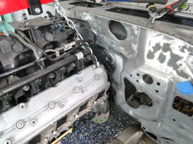

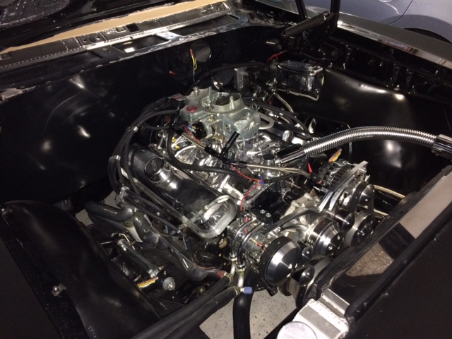

      Pardon the rats nest... haven't completed the wire looms yet. Almost there!!!
      Name:  Engine Left View.jpg
Size:  134.8 KBName:  Engine Right View.jpg

      Well, I finally welded up the angle iron frame supports/levels. Funny how my mig welding skills go to hell after a mere 8 months of non-use. But the grapes got smaller as I worked through the job. Good practice for the important stuff. attached a few pics for anyone else considering the ABC kit. Quite a lot to do before the actual mods take place, but it's all important to prevent twisting and misalignment during the cutting and welding process.
      Well the Mrs. has made me lunch, which means, as usual, I have spent waaay too much time on email and forums and half the day is gone, so sandwich then out to move my mig welder to the detached garage in the rain so I can weld the levelers on.

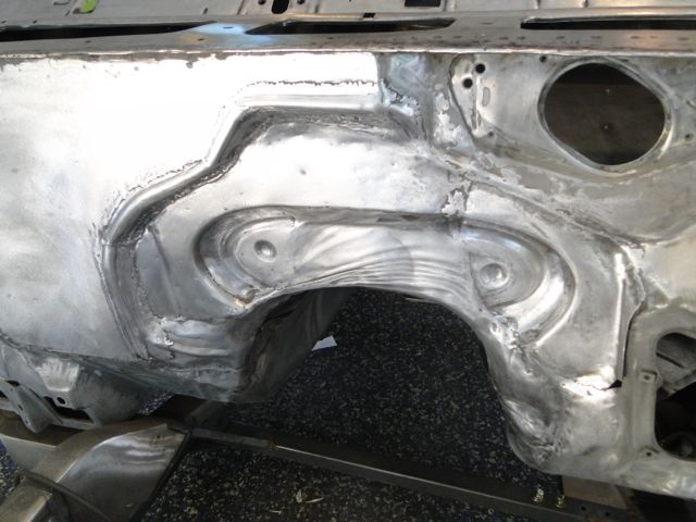

      Name:  header damage.jpg
Size:  151.1 KBName:  IMG_0808.jpg
Size:  250.2 KBName:  IMG_0807.jpg
Size:  188.5 KBName:  IMG_0806.jpg
Size:  128.0 KBName:  IMG_0802.jpg

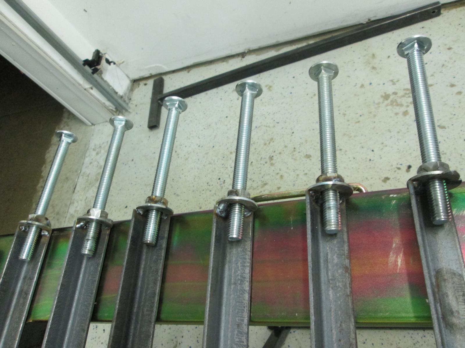

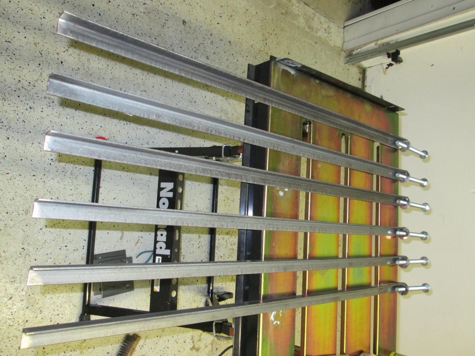

      Less words, more pics! Finally, eh guys?
      Made some serious progress Friday, thanks to the rain and cooler temps (and really bright lights). Vertical supports/adjusters tacked on as well as one wheel arch frame brace. It really killed me to grind off the nice eastwood chassis black, especially when I saw the primer, reminding me I had taken the time to primer the whole thing after I blasted it. Oh well, it's only paint, right? Hope to do more later today... yesterday was shot installing my younger daughters washer/dryer in her new rental house in N. Providence.
      Enjoy the holiday weekend.
      Name:  arch brace detail 2.jpg
Size:  173.4 KBName:  arch brack detail 1.jpg
Size:  174.4 KBName:  first wheel arch brace installed.jpg
Size:  185.1 KBName:  vertical supports & adjusters welded on.jpg

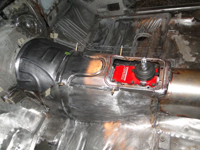

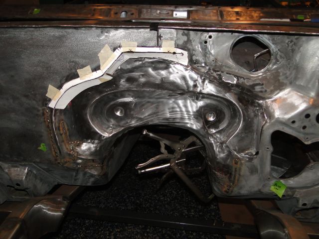

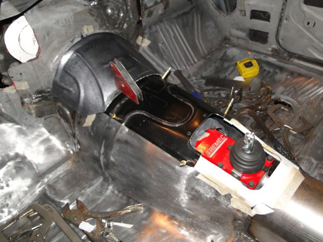

      Firewall 2.0
      Hey Gus, nice job on the levelers! Yeah 4 1/2" cutoff wheel on the grinder, Air Body Saw and the 3" Air cutoff tool for most of my body cuts.
      They say the trick to the epoxy floor paint is the prep (like anything else) I let the floor cure for a year after it was poured, then etched it with diluted Muriatic acid, I think this really helped, no peeling after 7 years. The only problem with having a nice floor is that sometimes it holds you back from using it like a garage floor!
      It has been so hot with the almost 100 percent relative humidity last week, the welding jacket, hat and gloves really helped me loose a few pounds of water weight! Cant really have a fan on you while welding.
      I am going with manual brakes 7/8 Wilwood MC, (and it is what the Roadster Shop does) I am hoping to get better pedal feedback with that setup, big tires and big brakes during track time pushing the limits of the car I really don't want to be locking up and flat spotting the tires. Mike it will be nice to get your feedback on your Hydroboost / Wilwood setup when you get on the road.
      Nice job getting the motor fired up! I love the Butler 461 Stroker in the future thoughts!
      Finished welding the firewall (for now) gotta close up around steering column and I want to figure out a bolt down ECU door so I can mount it under the dash. Then to work out the mounting for future Vintage Air system as well (hint for a couple picts Mike)
      Need to weld trans tunnel still.
      Hope everyone had a nice 4th of July!
Size:  59.7 KBName:  DSC09743.jpg
Size:  55.9 KBName:  DSC09730.jpg

      Hey Eric,
      Thanks for the kudo's on the levelers. They seem kinda flimsy for the work that is to be done, but they are only supports intended for leveling and I would also guess to get the frame high enough to reach the underside cuts. Tony and his son have done several of these before making his kit available to the public so I intend to follow his instructions to the letter which will hopefully ensure good results. Hope to get all the bracing done today.
      Great timing.. I was just working my way through your thread and saw you responded to my post. I'm up to page 4.. quite a bit of history you have with your Goat. Glad you shared.
      Seeing how much you have accomplished in that time frame really helps to motivate me and get me out to the garage to keep it going, even if it's only a bit at a time.
      I see how you started the smoothie panel and what a nice job it does on getting rid of the dents and holes. Some guys weld and use filler to get the same effect but the extra ridgigity
      it adds to the cowl and firewall makes sense, so I think I will go that route.
      I do, in fact, have the wilwood 7/8" MC on my vert' and was going to use it for konekilr. I too would like to get Mike's input on the hydro Boost. Good point about flatting the tires on the track. I hear that setup makes for a some easy wheel lockups since there's no ABS and it may be difficult for a less experienced driver like myself to keep from ruining a set of big, expensive tires. Looking forward to your report Mike!
      Yup, floor only cured for a month.. I did use muriatic acid, but I guess the curing time is critical. Oh well, had no choice at the time. Wanted it done before bringing in the blast cabinet, workbench and such. Live and learn, but it's better than a bare floor.
      Hey, that's one way to lose weight! Yeah, a fan kinda screws up the weld, especially if you use the argon gas coverage like I do. Man it was miserable here in NE last week but yesterday and today are warm and dry. Perfect welding weather. Vacation almost over.. back to the grind tomorrow. I think the HHH is coming back mon-tues so lets enjoy it while we can.
      Off to the garage for more welding. Enjoy what's left of the weekend Eric.

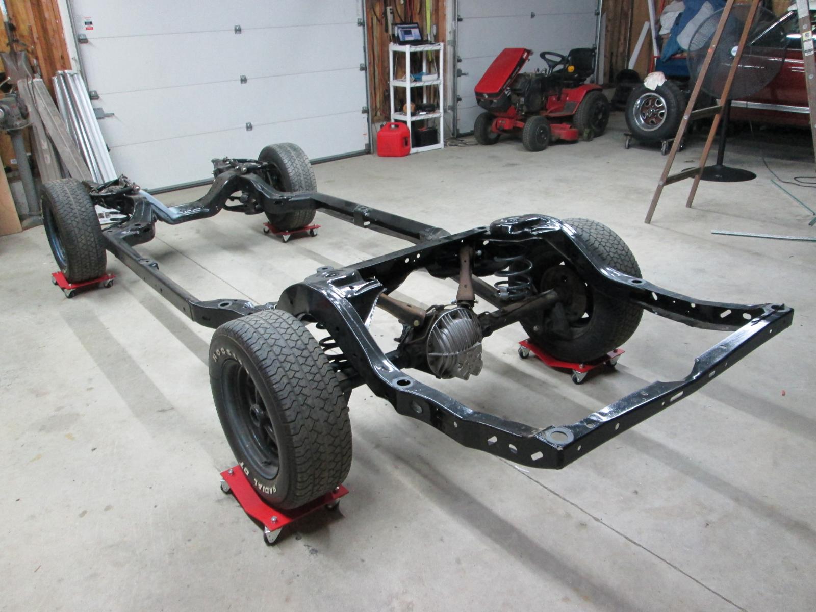

      Gentlemen,
      I attached another motivational picture. Enjoy. Looks like some great work was accomplished last weekend by Eric and Gus. Great job... Manual brakes for Eric... So, I'm eating my words, eh? I drove a manual brake NASCAR, it was the scariest braking experience I've ever had. They probably weren't warmed up properly. Obviously I'm going for more reliability and safety, than track performance. Of course, I'm just as anxious to get you guys some feedback on the Hydroboost too...
      Eric, the Vintage Air system I got is for a Chevelle, and I had to do some significant modifications, which I'm sure you're ok with. I ran all of the hoses under the fender and through the existing fan duct hole. You'll also need to mount some studs on the inside of the firewall to mount the unit. I chose to weld bolts through the fire wall, shown here as well... there are two.
      Gus, I got the smoothie panel from ... http://www.abcperformance.net/firewa...%20panels.html I liked it because it also had 1/8" diameter holes pre-drilled along the perimeter, for Cleco fasteners. It wasn't that heavy, maybe 16 guage?
      So, now I need some help... I'm installing the side windows, and spent most of the weekend cleaning the old ones. Two of them have wear scratches from years of use... any idea how I can remove those scratches? I assume there's some way to sand them down?
      Thanks guys... Mike

      and thanks for the input on the smoothie panel. Looks like thats the way to go for me too. And we look forward to your hydroboost review! I'm all for it if I can modulate it. As I get older, I may need that extra Ooomph. But I thought the idea of the "Big Brake" kits was to get all the stopping power needed with a manual pedal.... I look forward to getting your seat-of-the-pants impressions.
      This is a rare occasion that I may be able to offer some help here rather than asking questions and posting pics, sooooo, I'll jump in and hope this helps...
      Regarding your glass situation Mike, I'm in the same boat as the two rear quarter windows on my hardtop have sanding scratches from a previous paint job.
      I actually bought a kit from eastwood years ago but haven't used it yet so can't say if it works or not but this kit should be able to handle some deep scratches. I have similar scratches on my front windows but they are hardly noticeable so if your's aren't gouge too deeply, perhaps this will work for you.
      http://www.eastwood.com/glass-polish...hes-5771.html#
      I hope it works for you. It would sure make me happy if I was finally able to contribute something here besides questions and pictures! If you go for it, please let us know if it works for you. Kinda pricey at $70 but cheaper than new glass I would imagine.
      Here's a few more pics of my progress yesterday. Back to work today though... I actually got a sun burn on my left arm from all the welding I did. Mrs. Noticed it. doesn't hurt but should have worn my half jacket.... was a bit warm... not too bright on my part... lots more welding to do so will start wearing the jacket... Name:  IMG_0824.jpg
Size:  194.3 KBName:  IMG_0826.jpg
      Still need to wire up an extra outlet so I can run both the plasma cutter and compressor together so I can trip the overhanging angle iron. Cut off wheel works but I bought the stupid thing so I might as well use it... plus, it's fun to blast metal away and make sparks!
      Have a great week Mike. btw: Still hoping for a vid of your beast rumbling..
