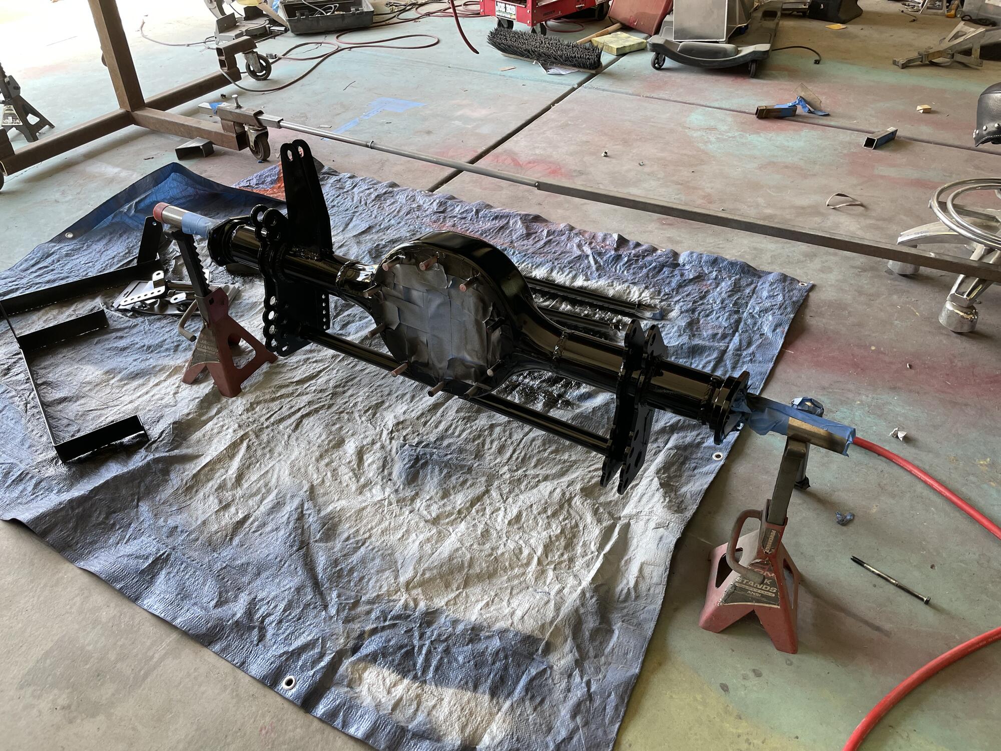

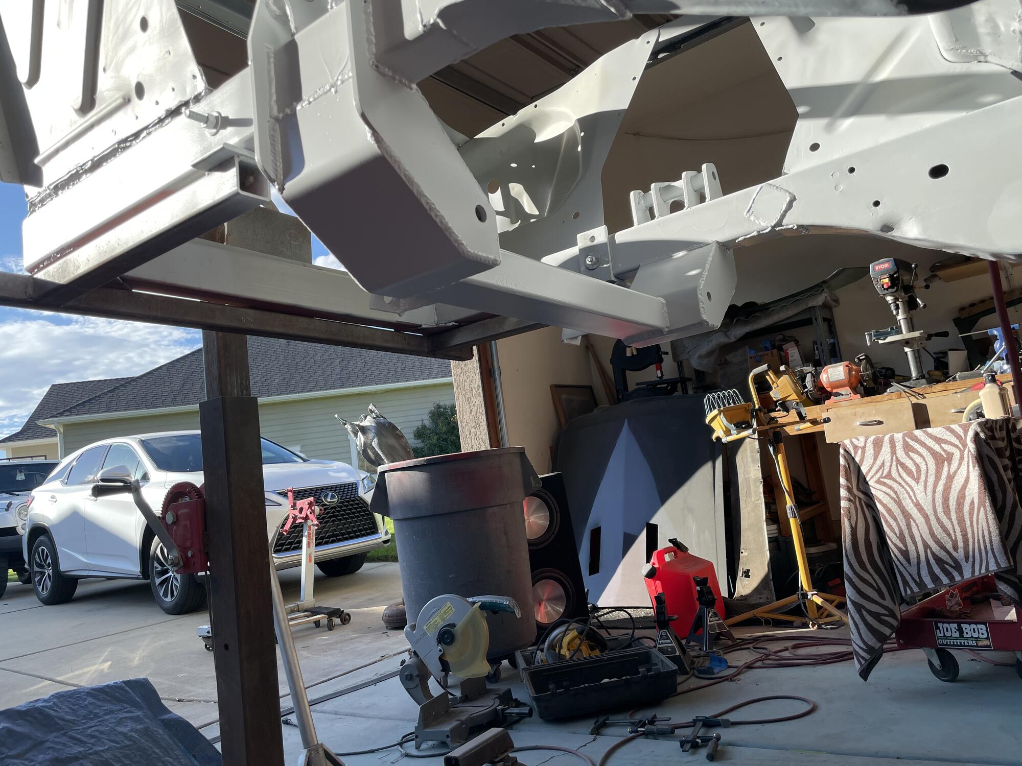

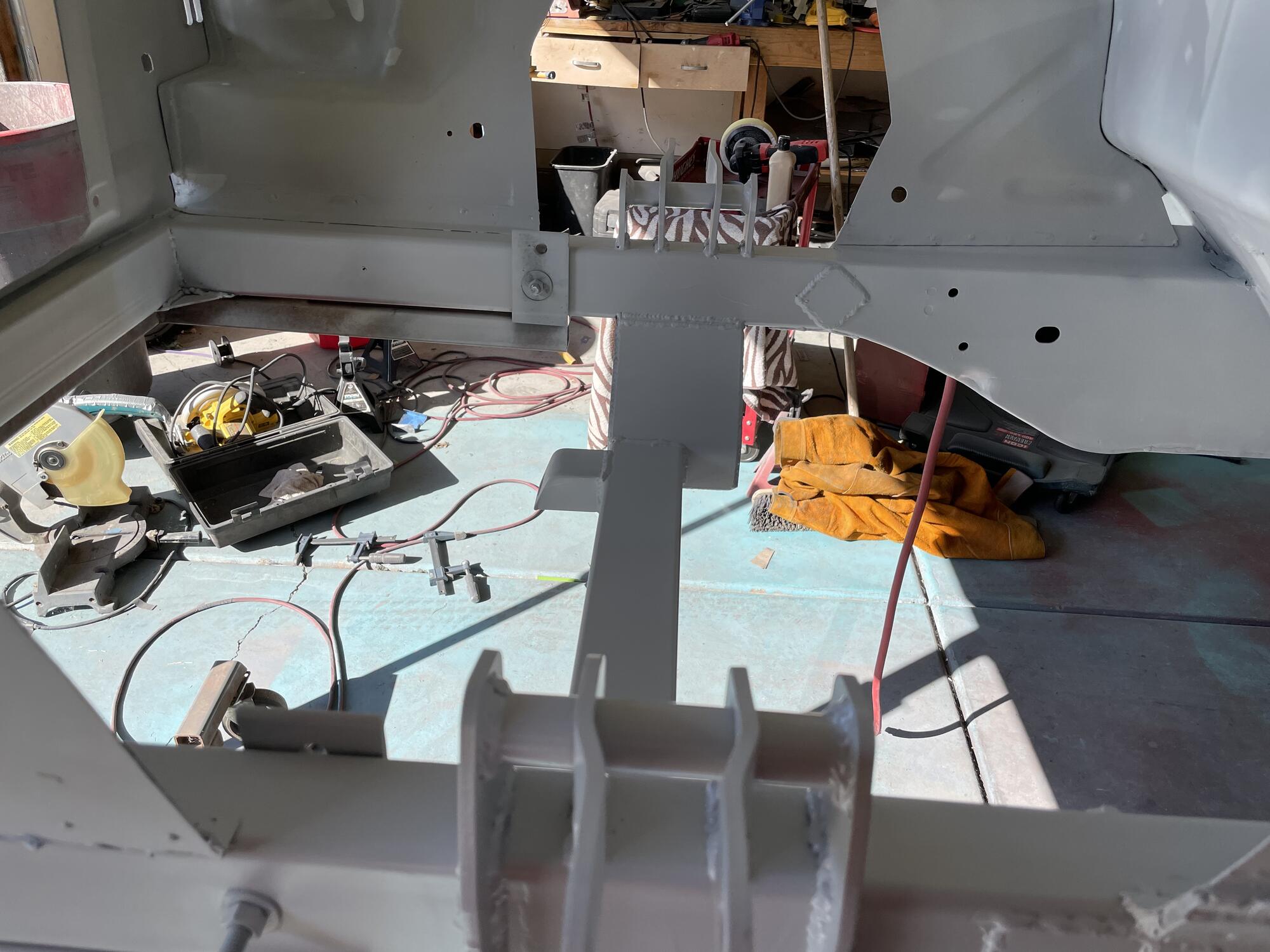

      The front suspension should arrive Friday so I have a big weekend ahead. I put the rearend back in so I can get the measurements I need to make sure it’s square. Also ran wiring to the rear for taillights, fuel pump and battery relocation. I wanted those routed above the wheel wells and that’s much easier before I mount the wells. I mounted a little 300 amp blade fuse in the box with the battery.

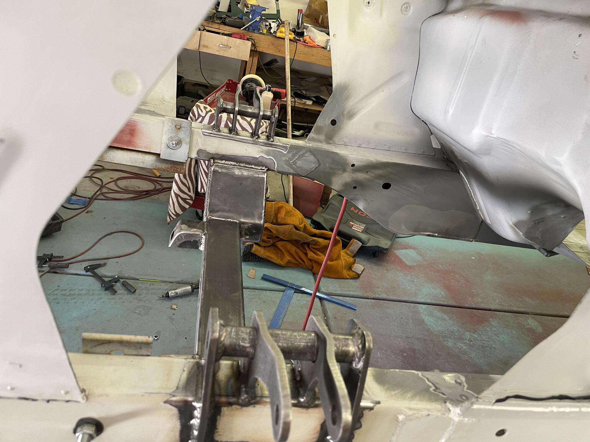

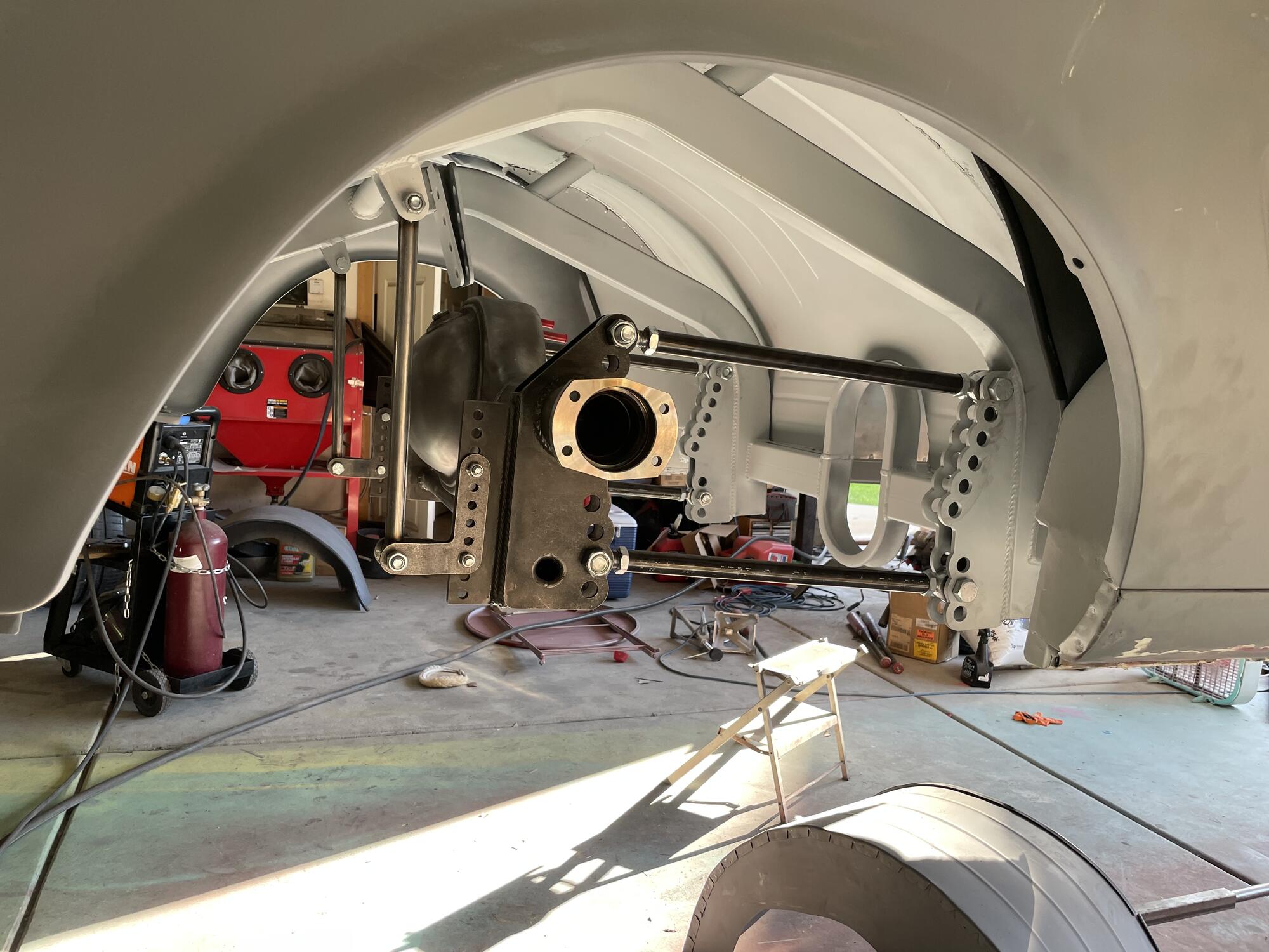

      Trying to decide where the exhaust will go. I don’t have the space available to go up and over the rear axle so I may need to terminate somewhere earlier. The panhard bar is in the way.

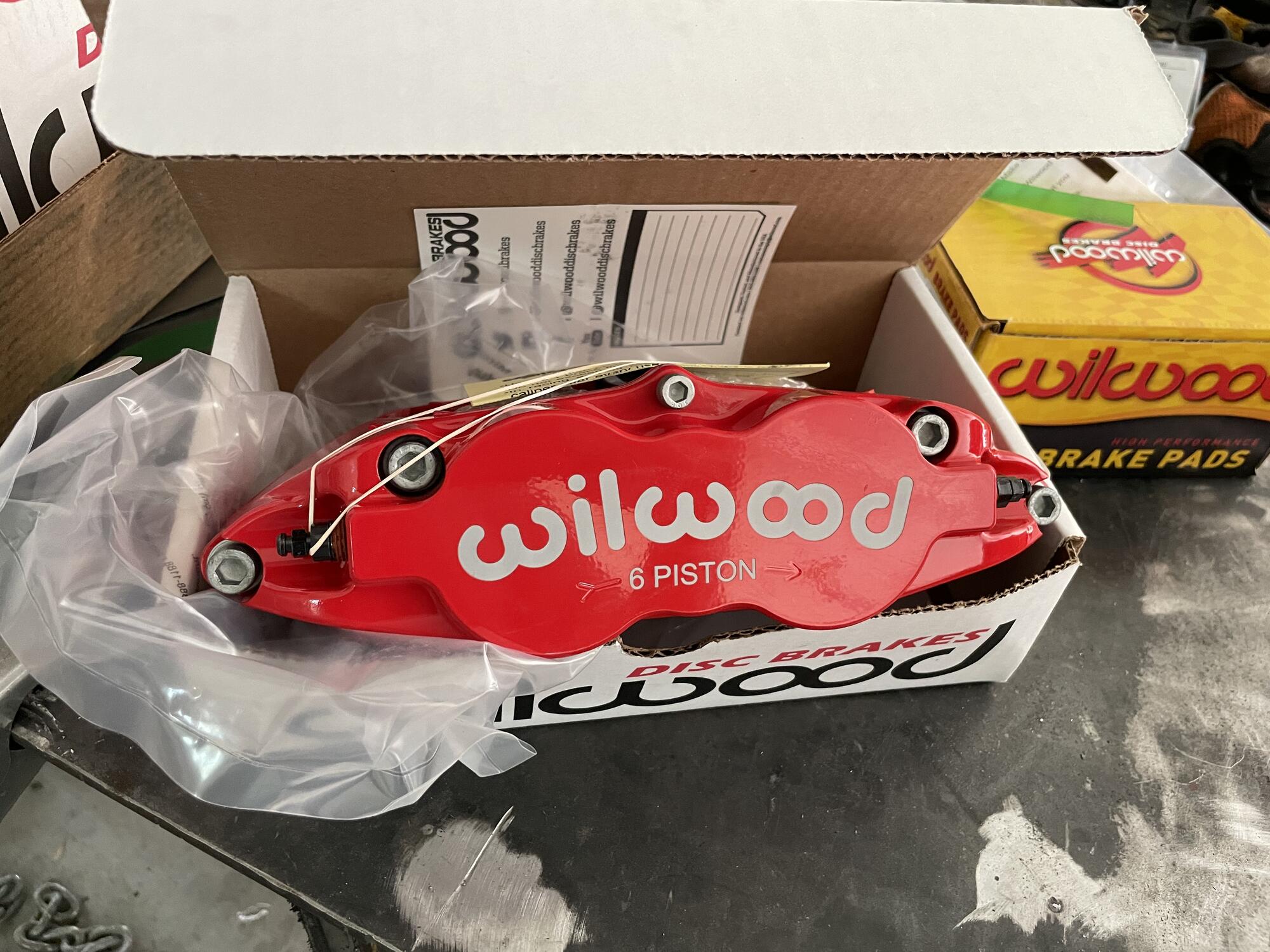

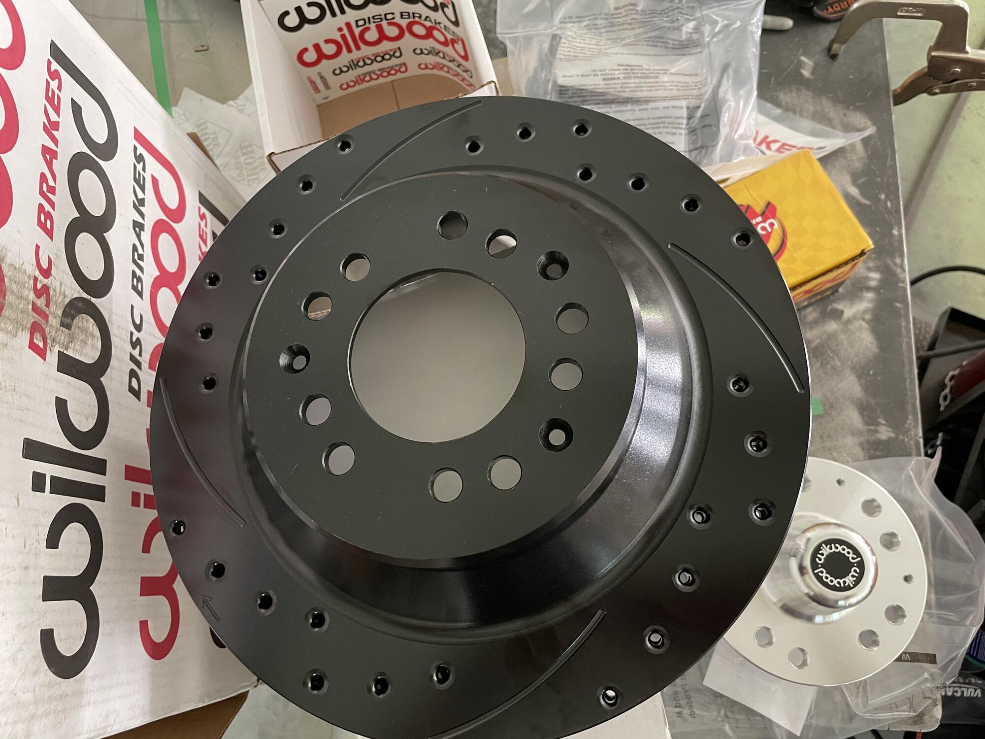

      Avert your eyes if you’re squeamish- Wilwood brake porn ahead. I opted for a set of 13”, ;6 piston up front. These should slow down a pony pretty good.

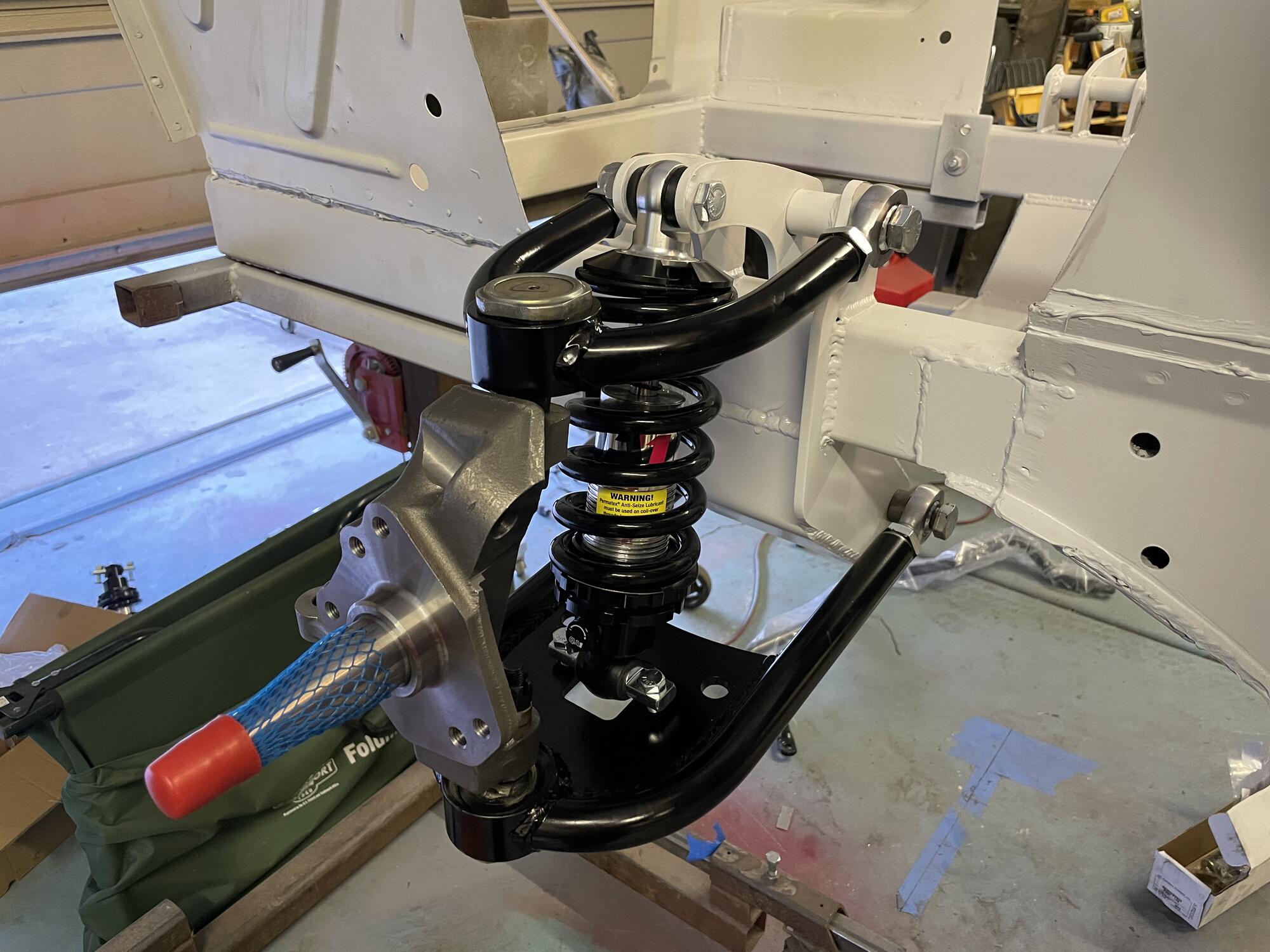

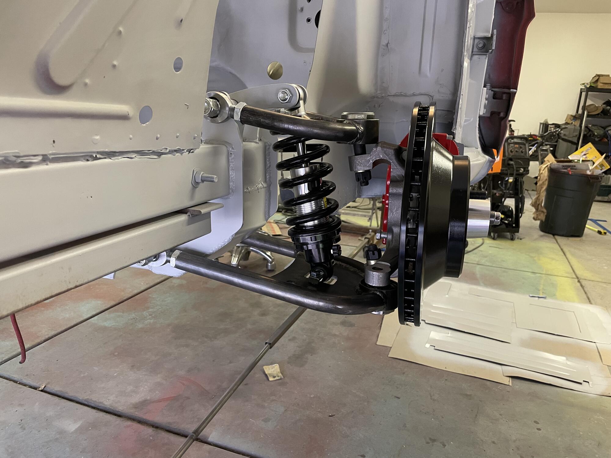

      I got my front end. Like the back half, it is from Checkered Racing. This is their version of a Mustang II. It came with a power rack, 2” drop spindles, QA1 sway bar and QA1 coil overs with 550# springs. Should be a stiff ride.

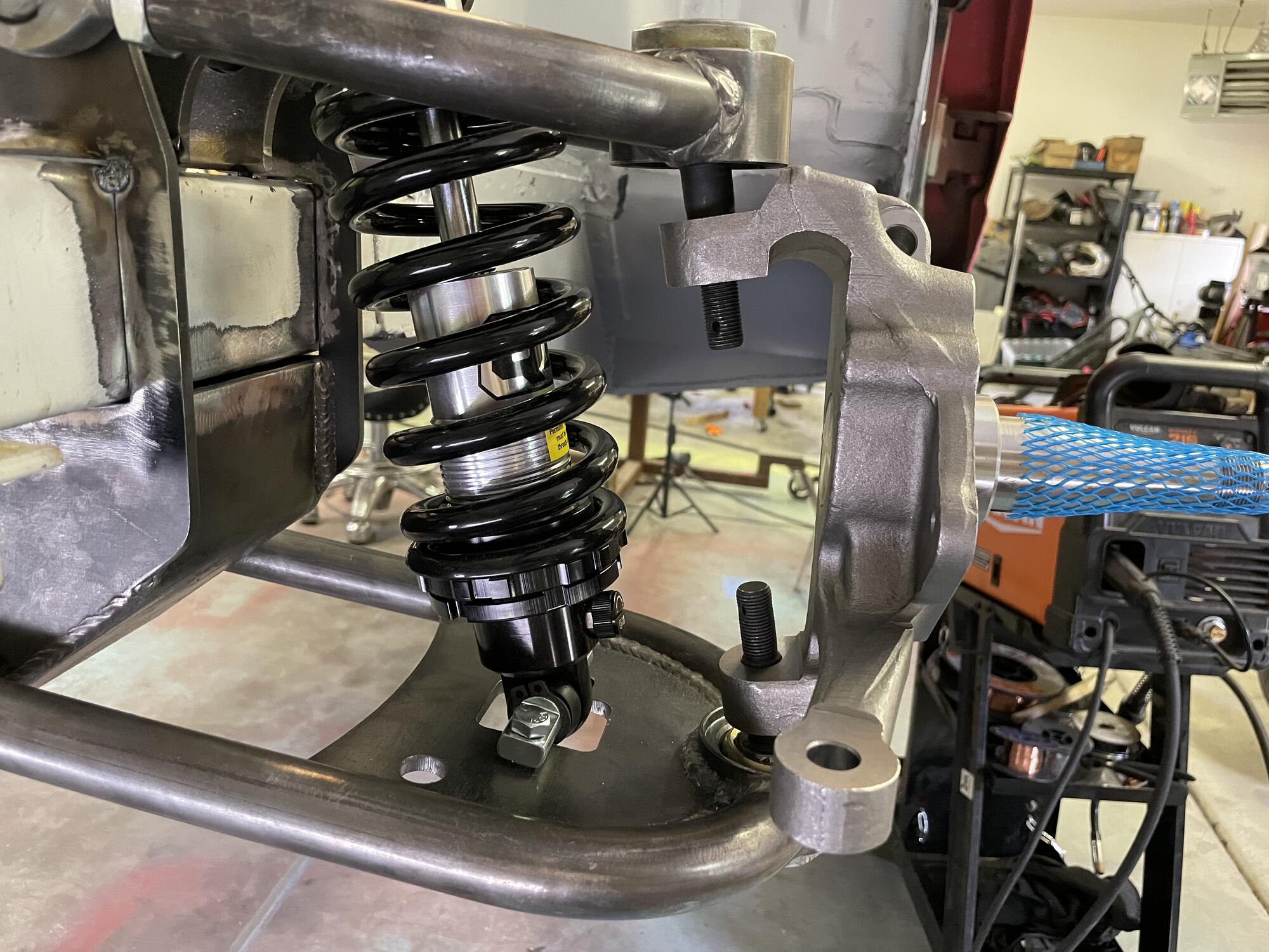

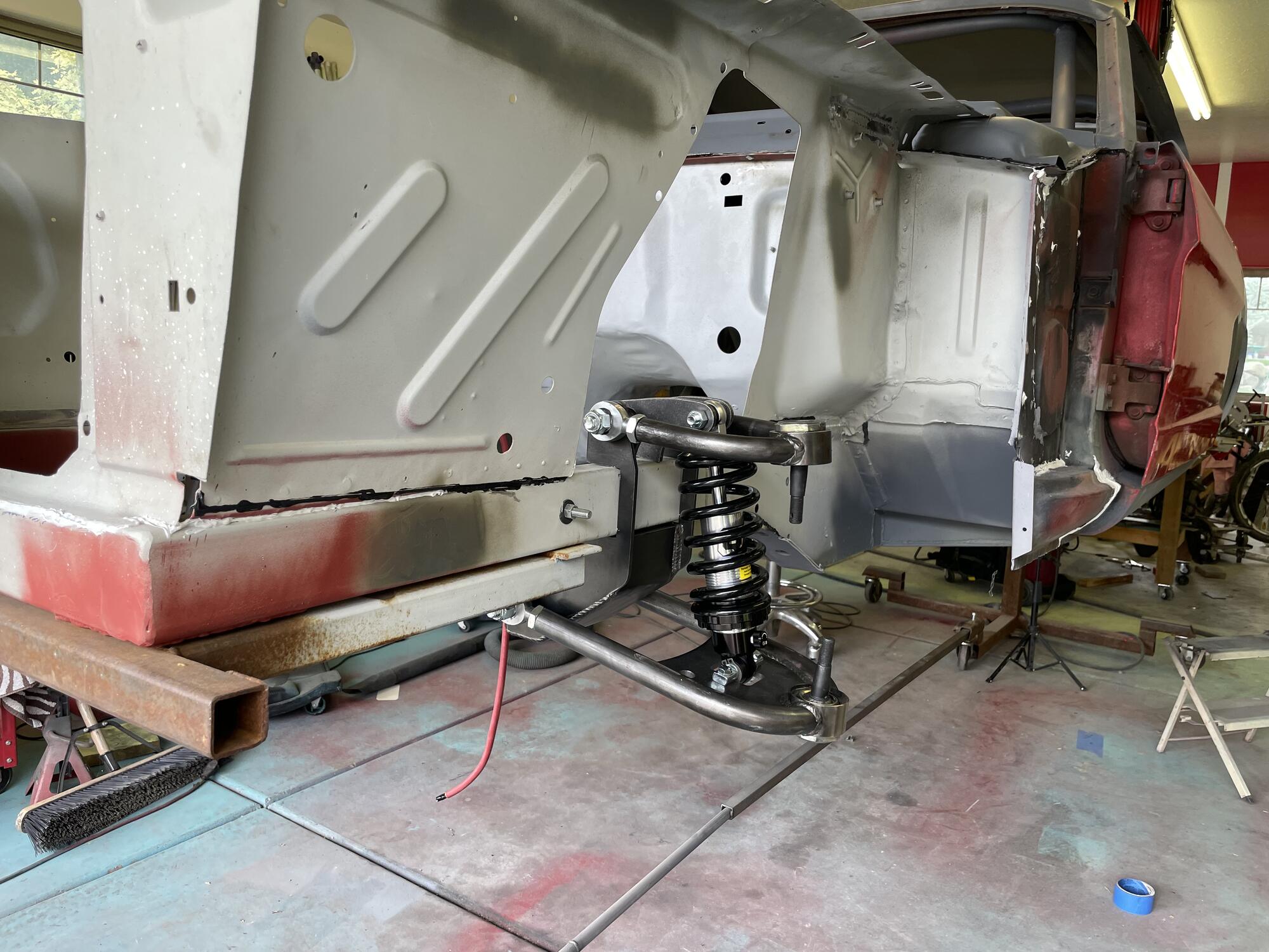

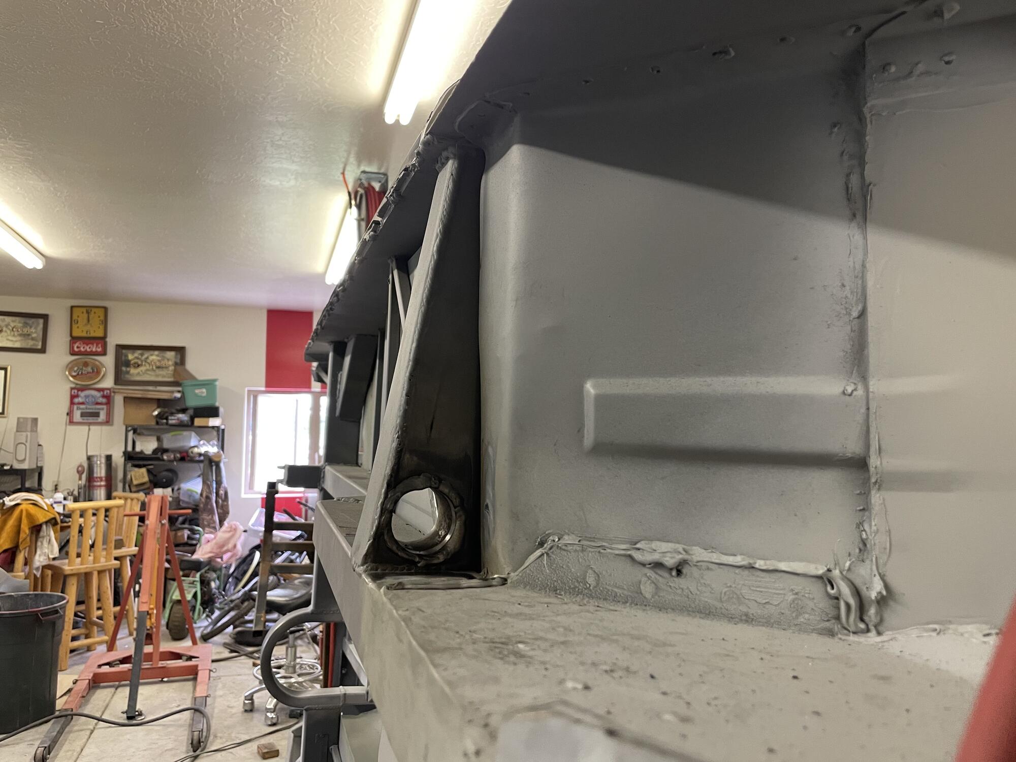

      Made some good progress on the front end. Got the K member welded and shot it with a coat of primer. The steering rack has been mounted and checked out. I took most of it back off because I am concerned with the weight on my homemade rotisserie. I want to paint underneath before I take it off. I have to finish the trunk and mount the fuel tank before that.

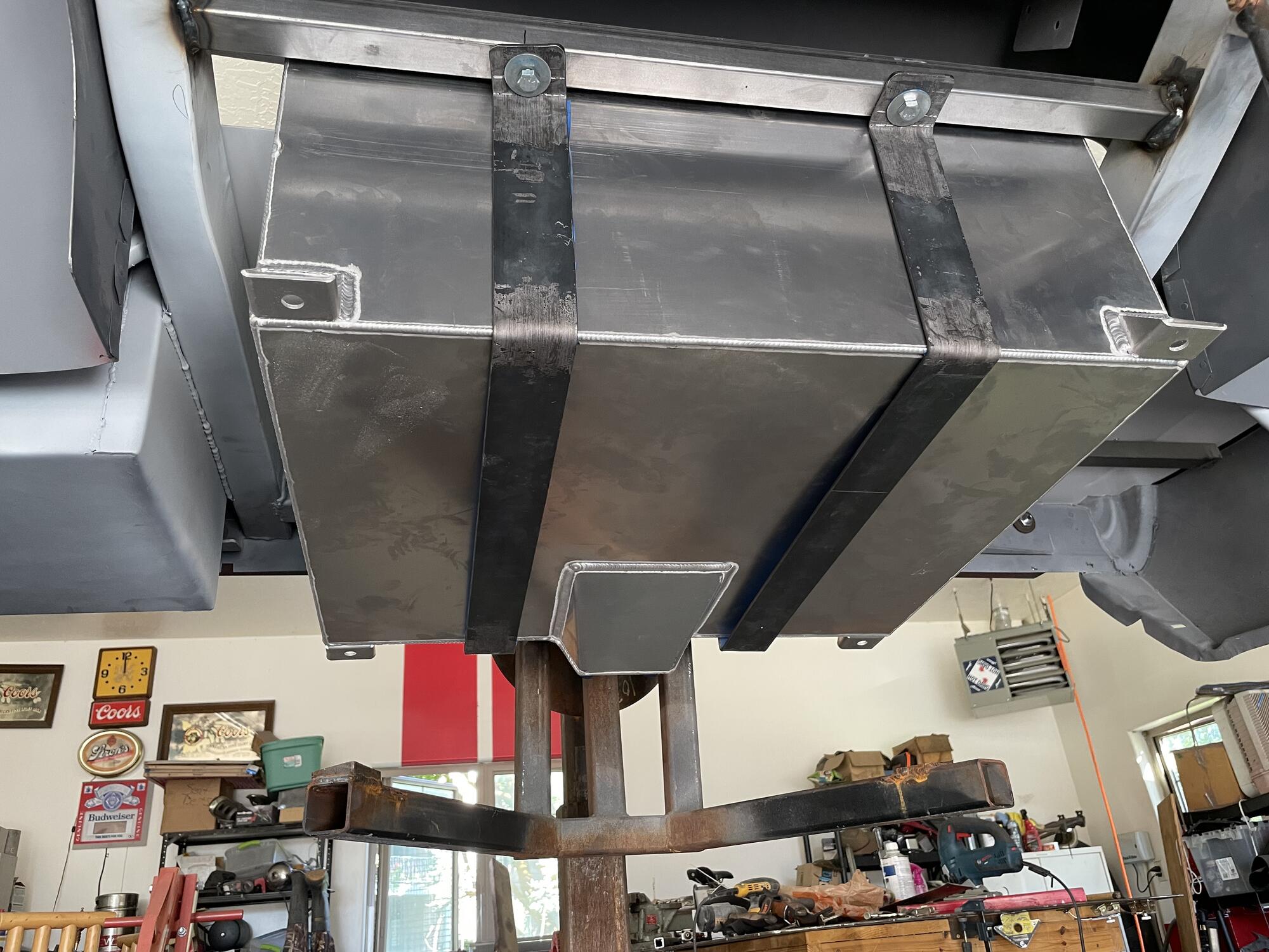

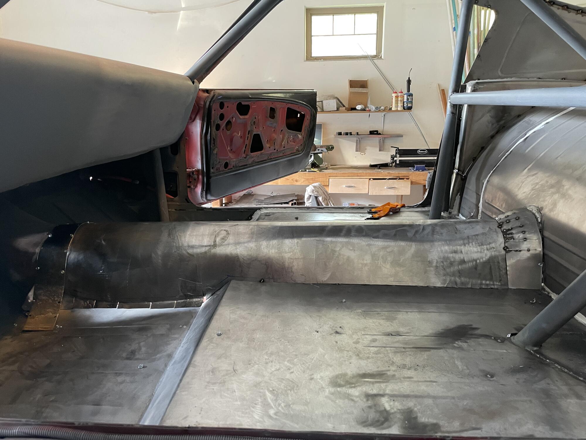

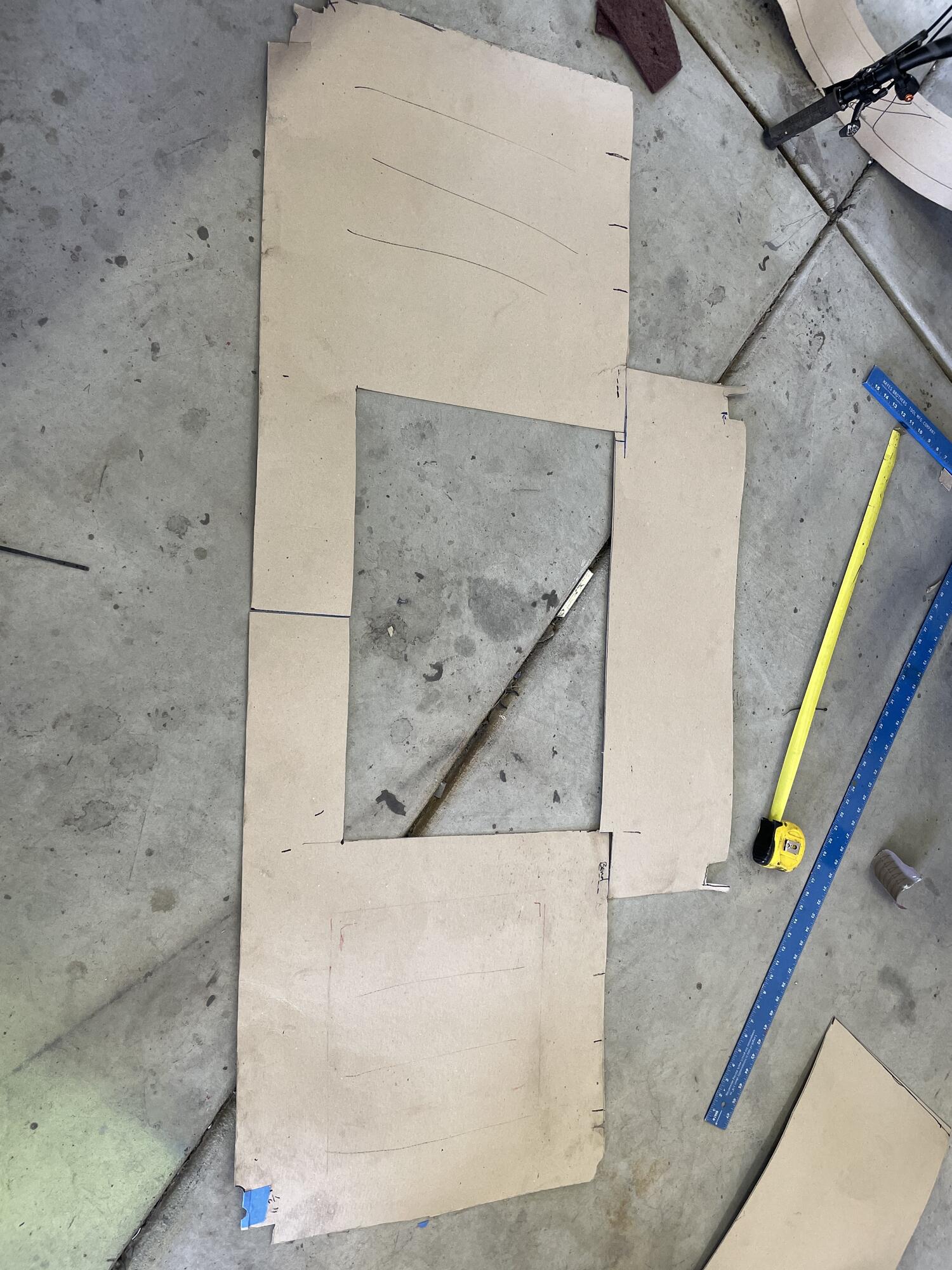

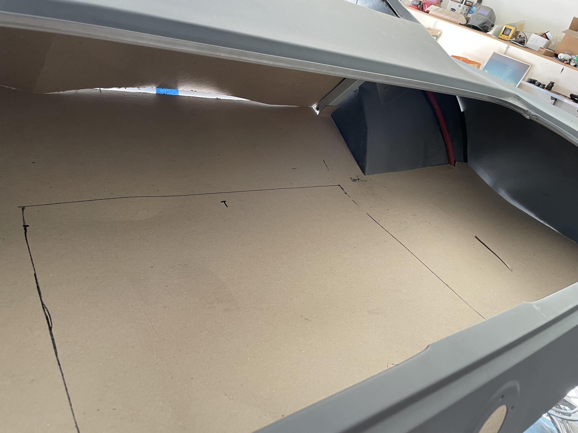

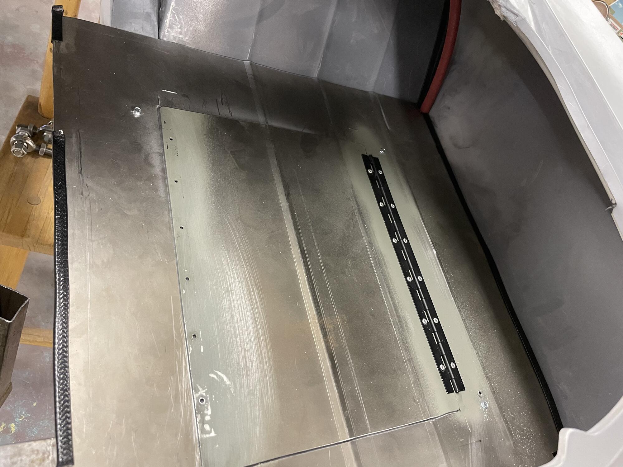

      Started working on the trunk floor. Fairly simple but I need a trap door for the battery well. The big opening is for the fuel cell that I plan to mount flush with the trunk floor.

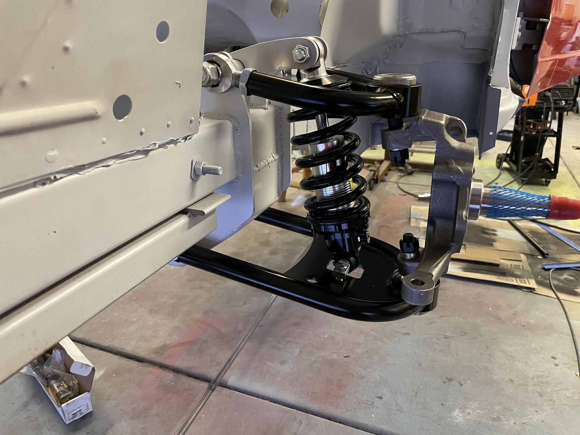

      240

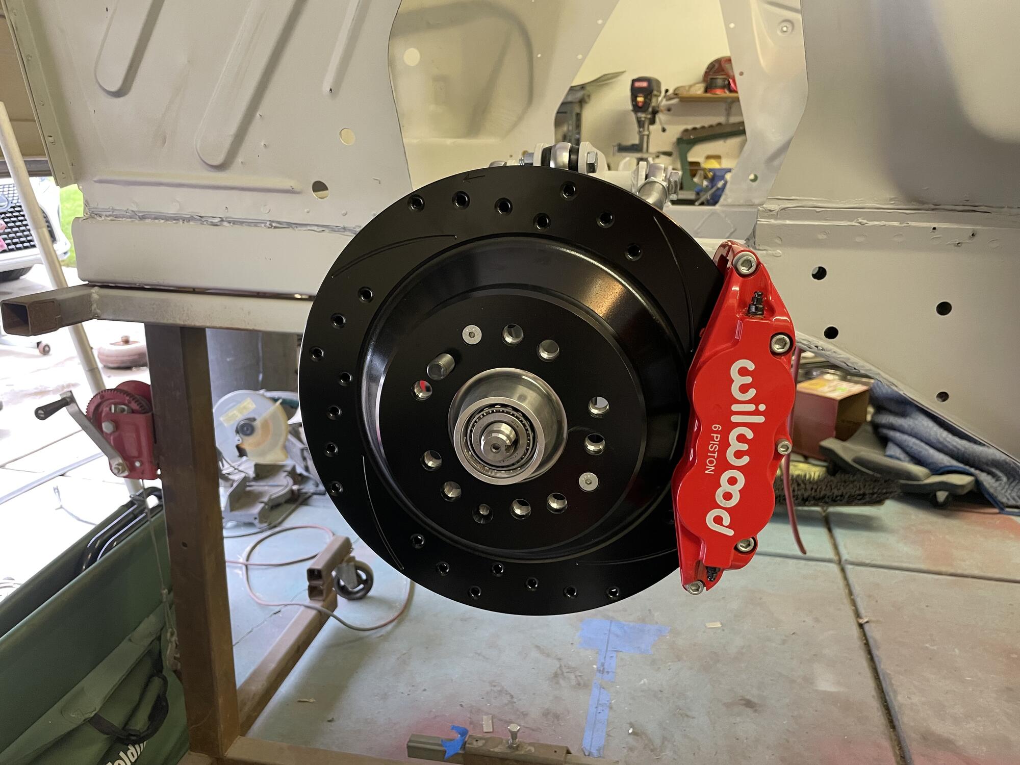

      I nstalled the front brakes to check clearances and make sure I had all the parts. I also mocked up the steering rack and the sway bar. Everything looks pretty good at this point. I’ll find all the real clearance issues when I put the Coyote in it.
Size:  278.7 KBName:  CA44D170-545F-48B9-8A8F-7181DDFFE82F.jpg
Size:  274.4 KBName:  D8048B55-0D0F-49DA-A30C-8B671224ACD1.jpg

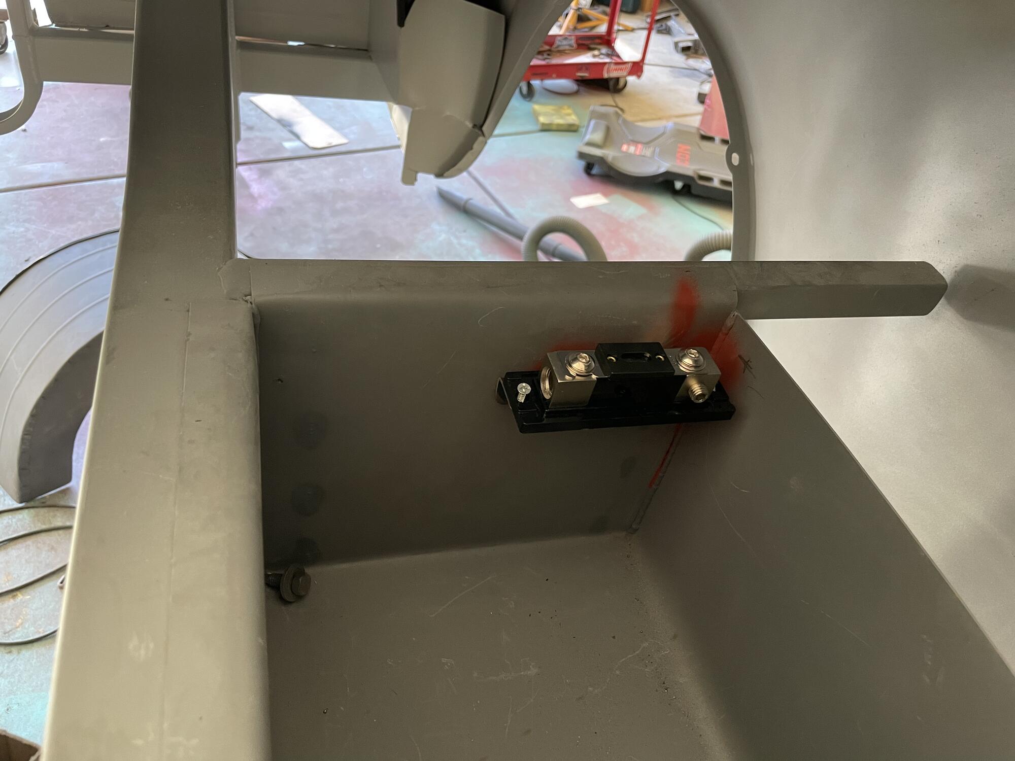

      I made the door for the battery well. Name:  A8A82D11-5CAF-4B8D-89D7-B650F02DD690.jpg
Size:  230.4 KBName:  85BC0B4C-407E-41A7-8870-CDEFA8D87F55.jpg
Size:  320.2 KBStarted fitting the fuel cell in place. The rotisserie interferes with the back of the tank so I’ll have to get back to this later. The intent is to mount it flush with the floor. Name:  53B35A37-F025-4013-8837-7B34AB9A7BE8.jpg

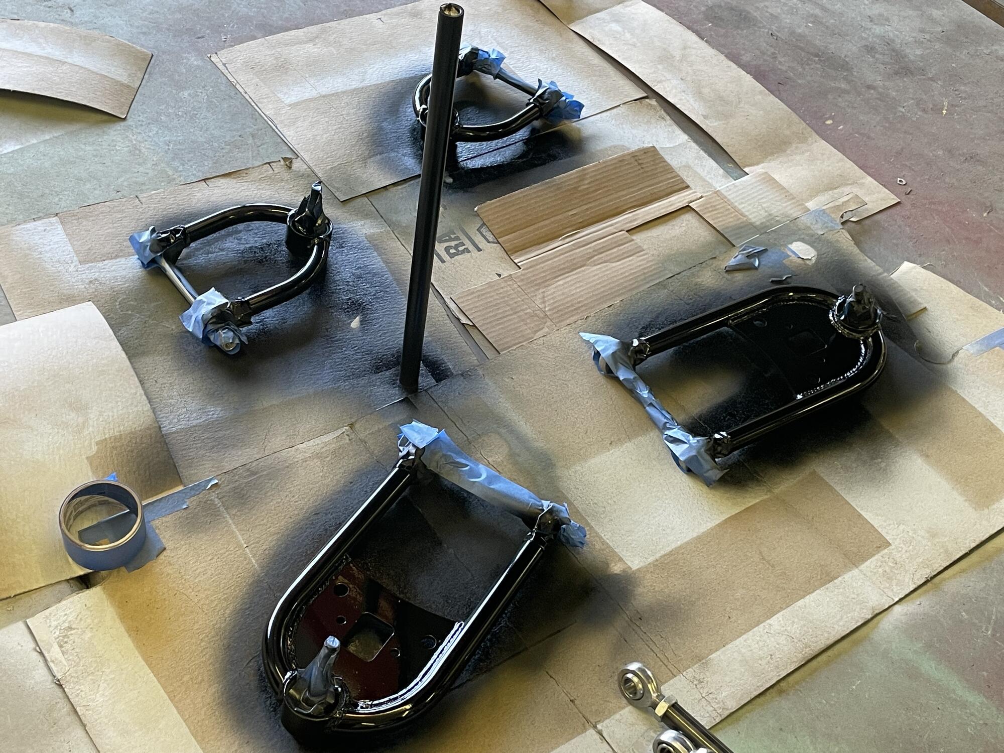

Size:  264.4 KBI painted the front suspension pieces to look nice and hopefully not rust. Name:  030A3A15-8066-44B3-8EEA-ECFF0600AEFE.jpg

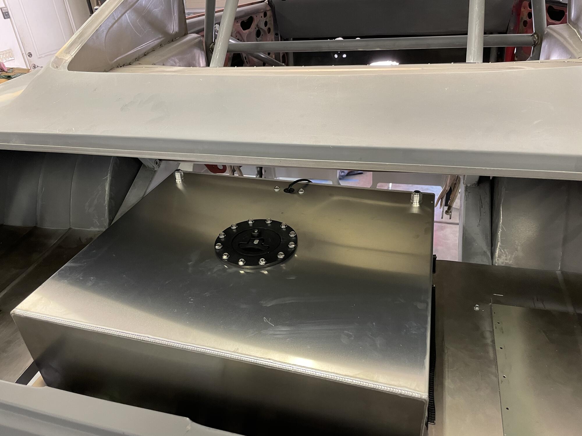

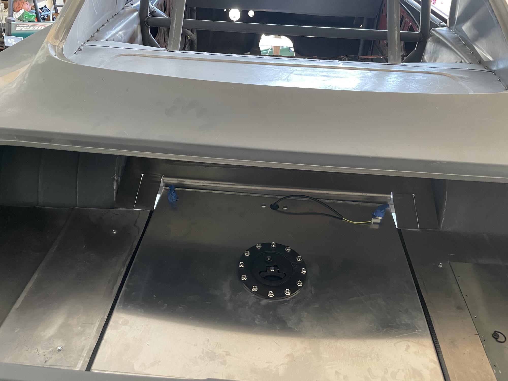

      I got the fuel cell mounted today. I mounted it flush with the trunk floor to give me useable trunk space. I have to make some modifications to the rear valence for the fuel lines but it will be below the license plate so it won’t show much.

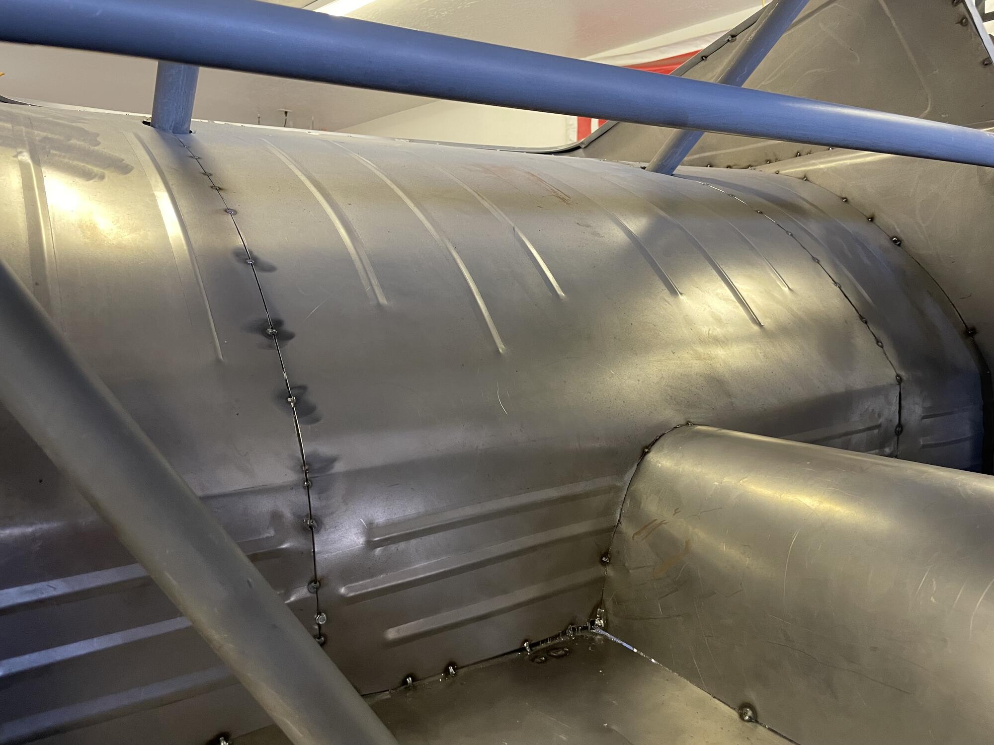

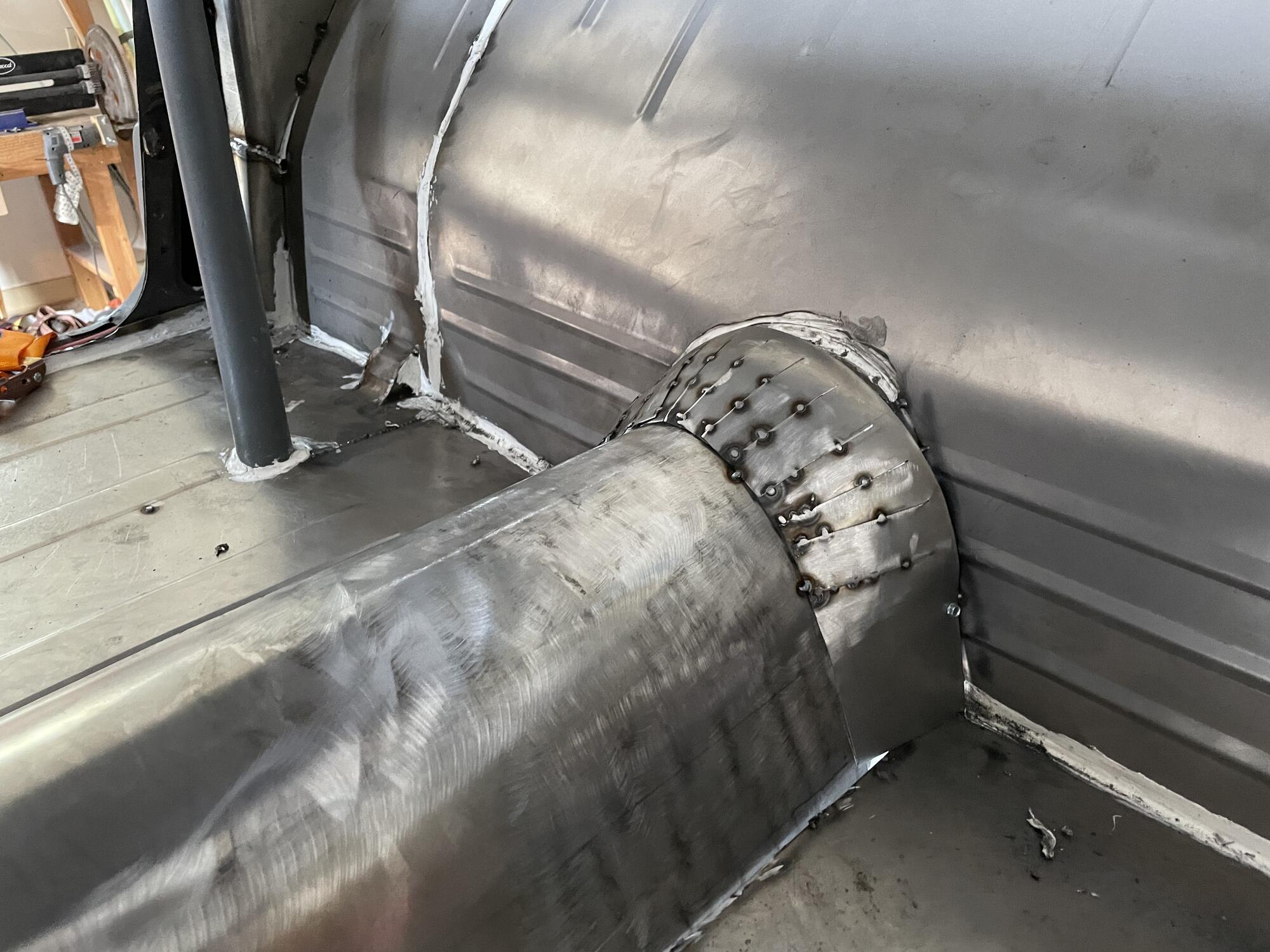

      I am running out of things I can do without an engine. I haven’t finished the front of the trans tunnel because I’m not sure if I will have to make mods to clear the Coyote. Without that piece, I can’t final paint underneath. A few small projects here and there to get ready. I made a little portal in the frame outrigger for the fuel lines. I can probably permanently mount the wheel tubs as well.

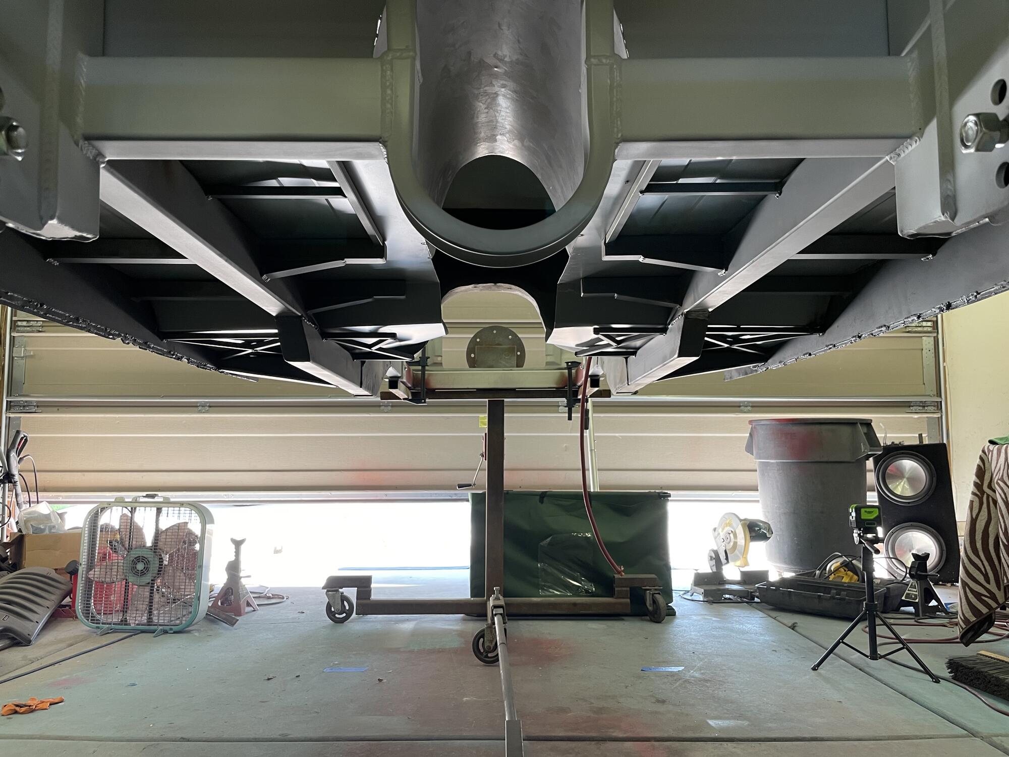

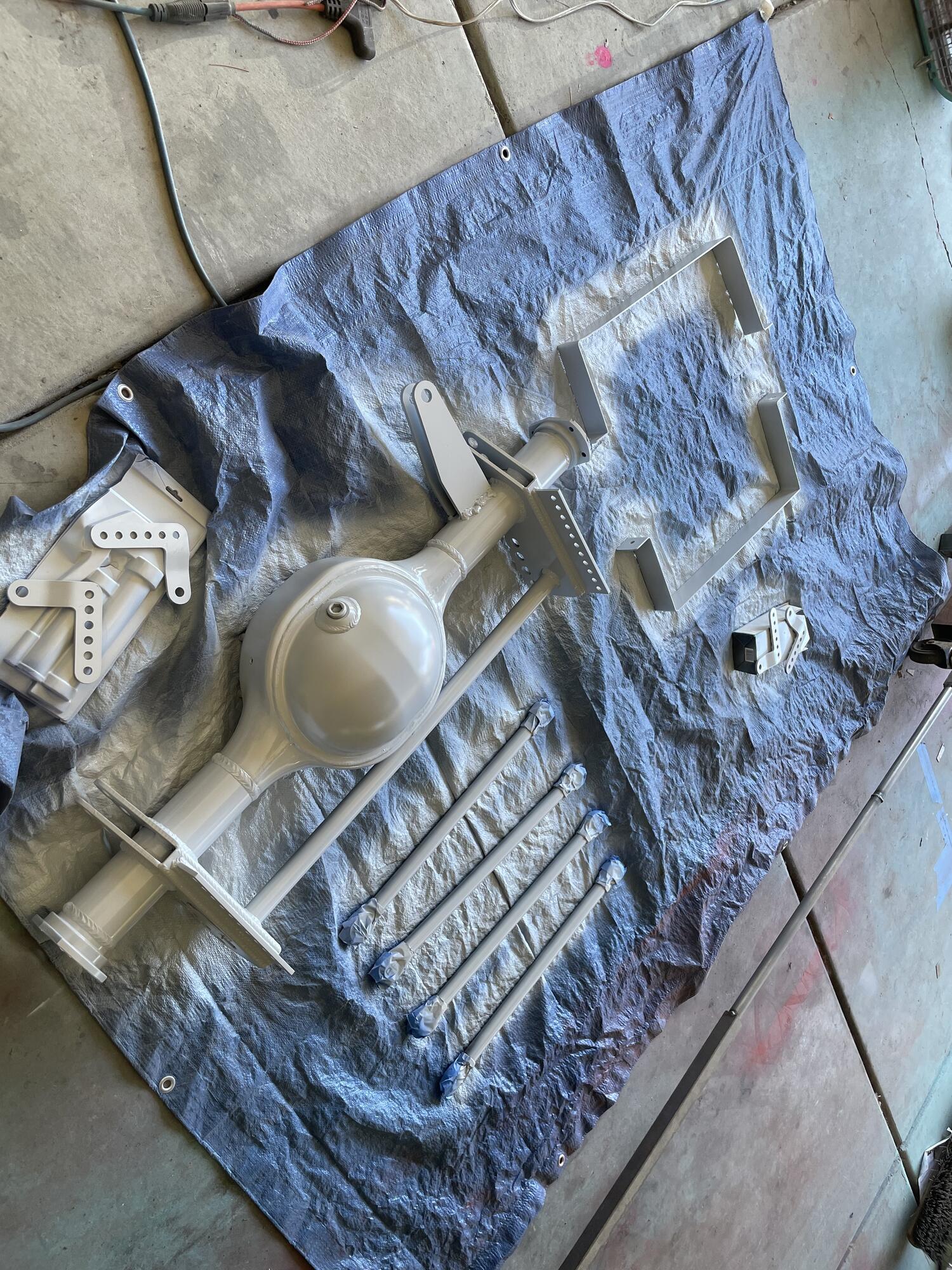

      I painted the rear end and suspension components. My Second Skin spray-on arrived so I am finishing up the inside so I can get ready to spray that on thick.

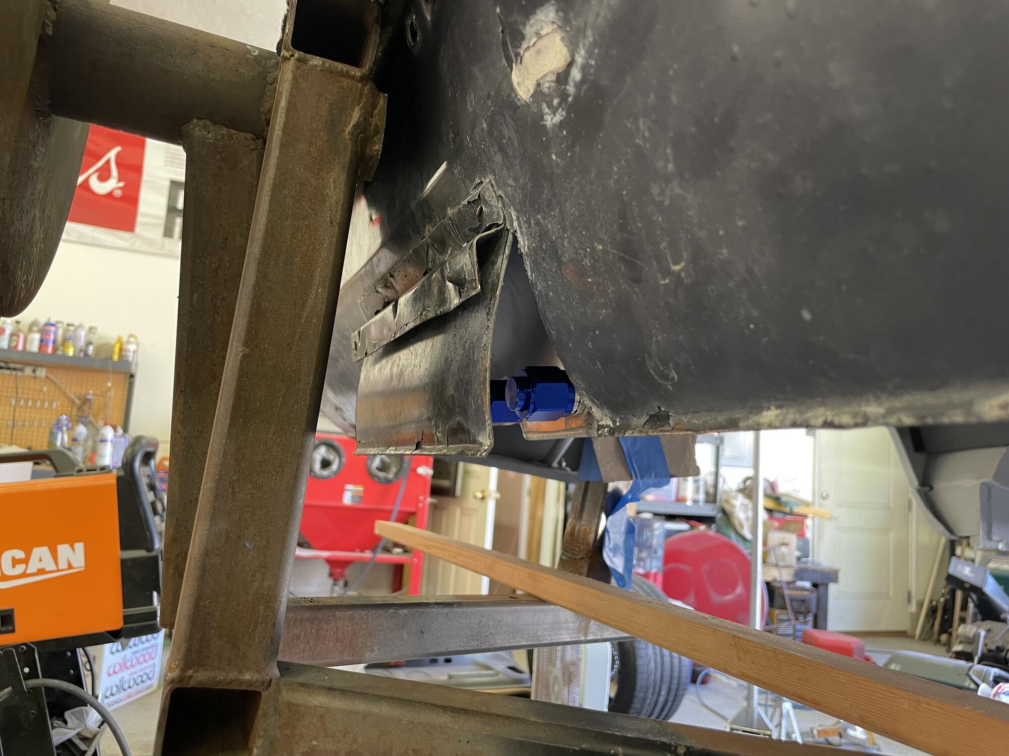

      Getting the trans tunnel fitted up. I had to make the jet exhaust nozzle looking thing to help lower the tunnel. My initial effort was too high.
Size:  317.0 KBName:  28617A65-90B2-42C9-89A1-509112DA95ED.jpg
    18. #198

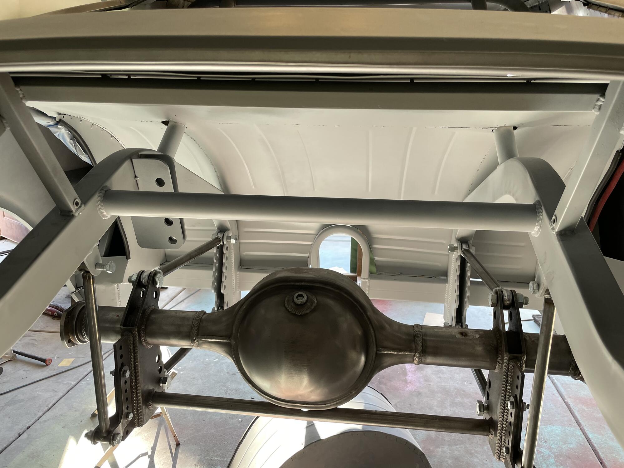

      240

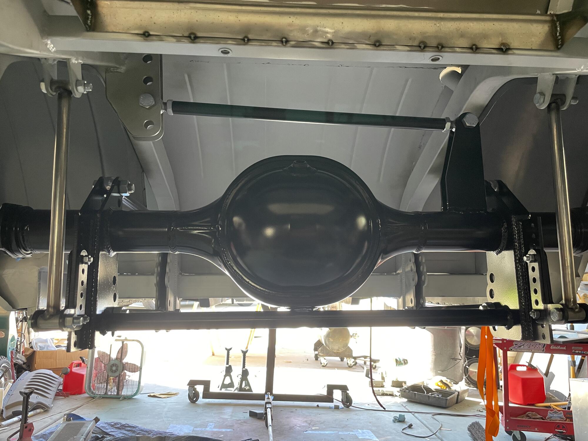

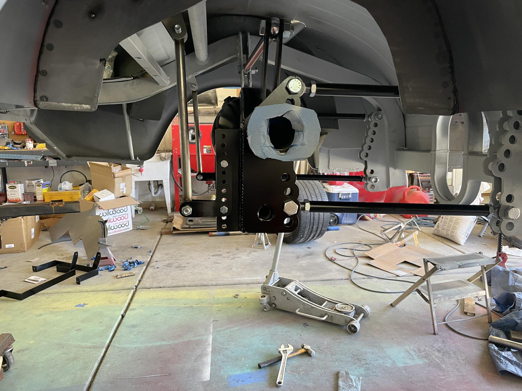

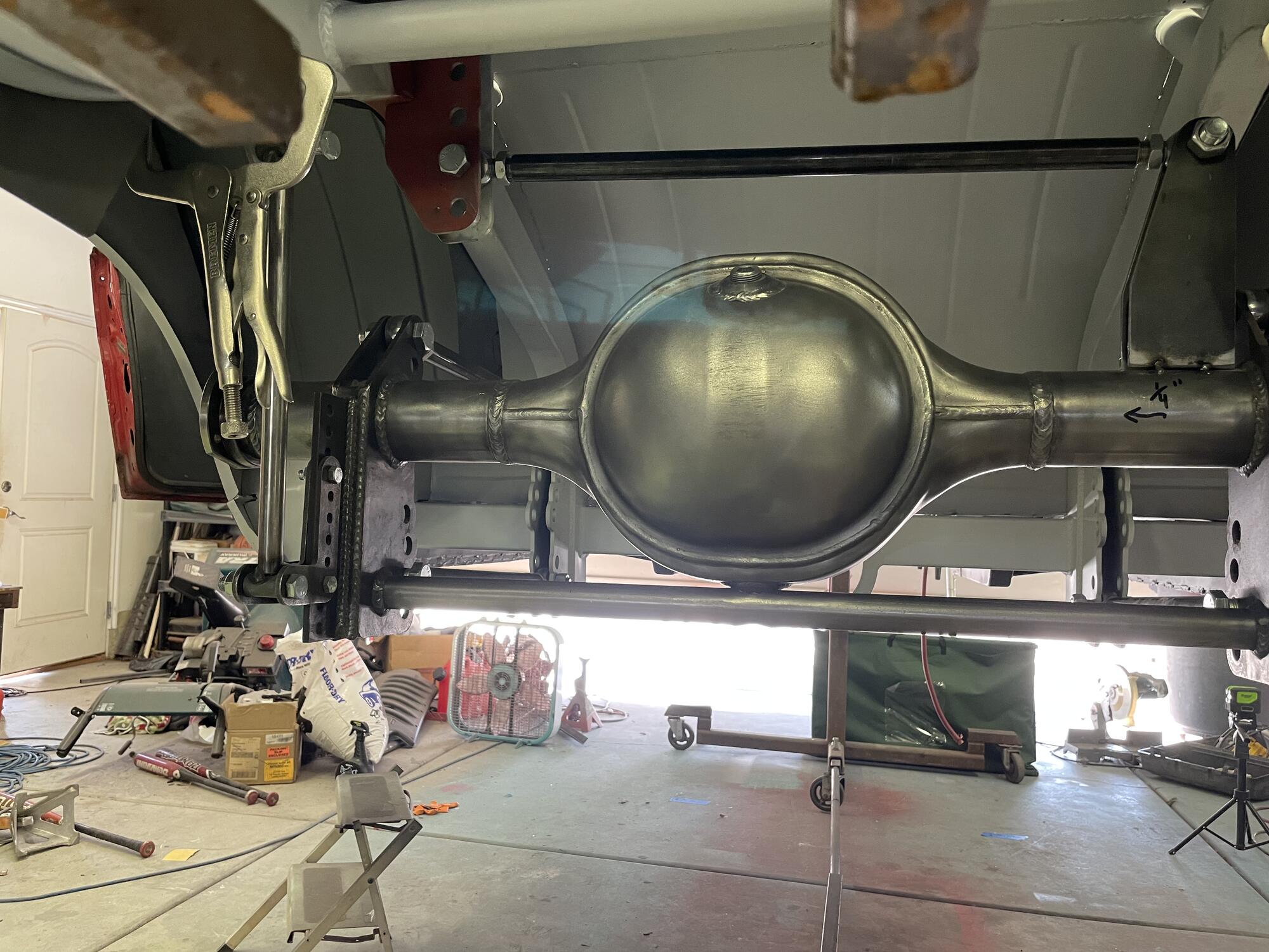

      I got my panhard bar welded and I put the resend back in to check the fit. Everything looks good. Name:  3E5EE49F-8334-4617-A9DD-A213597E6B6D.jpg
Size:  394.3 KBName:  999F3937-366A-4463-A514-BAB349782B99.jpg
Size:  334.7 KBName:  F19ADFA2-F6EF-45B5-BD5A-606106352E67.jpg
