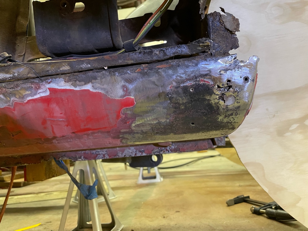

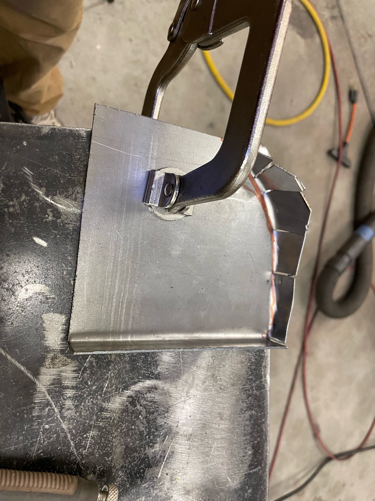

      I did some rocker repair.
    4. #84
      Jun 2017
      Utah
      241
      And it turned out ok. Name:  653C8957-B31A-4E12-8F70-3D0F58F0BCA0.jpg

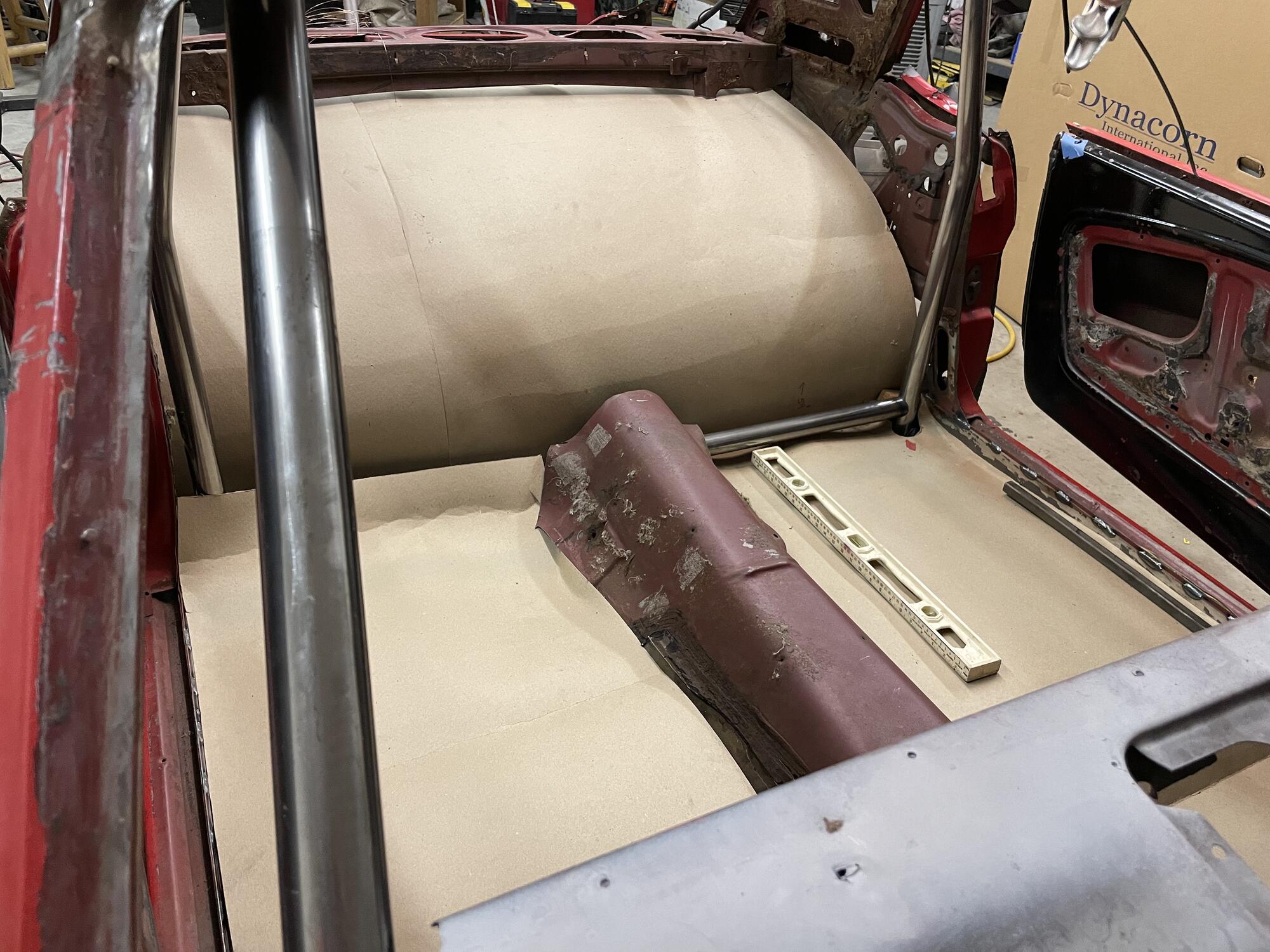

      I’m continuing the mock up of the roll bar and the floors. This is what I am thinking now. Name:  160E046F-CAA9-402C-9E8F-C36556FD64DE.jpg

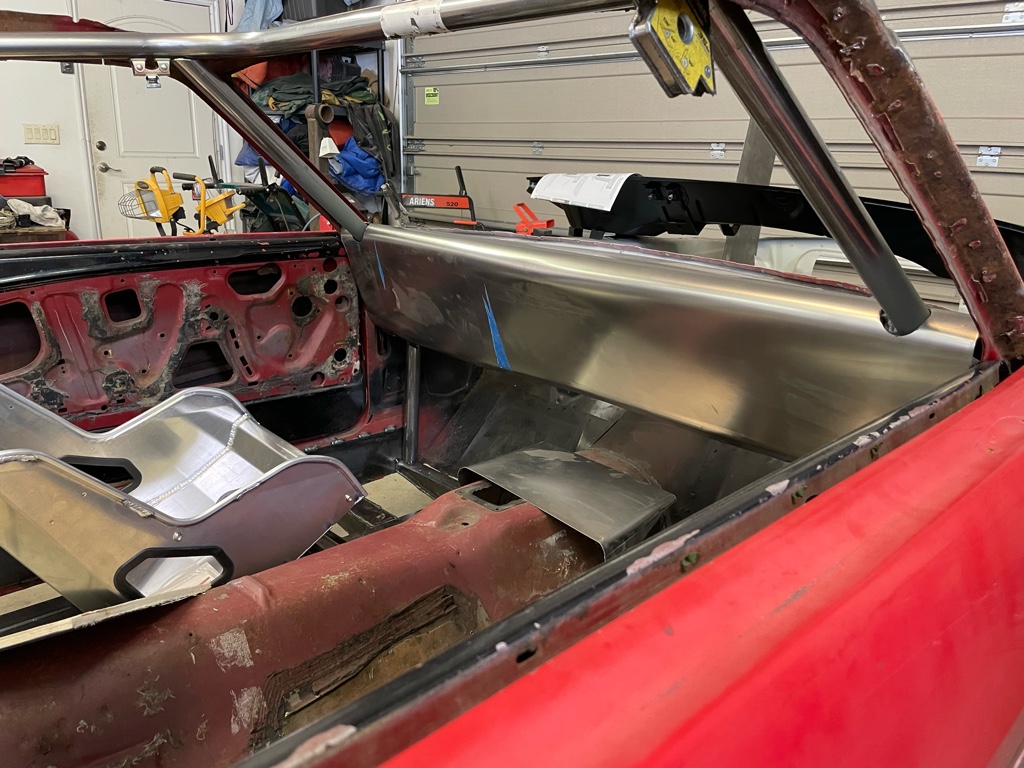

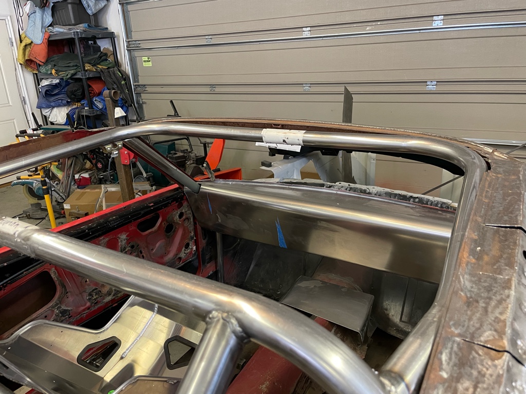

      Got the seat in so I can nail down a few of the final details of the roll bar. I am trying to meet NHRA 8.5 specs in case I ever take it to the track. Name:  IMG_1547.jpg

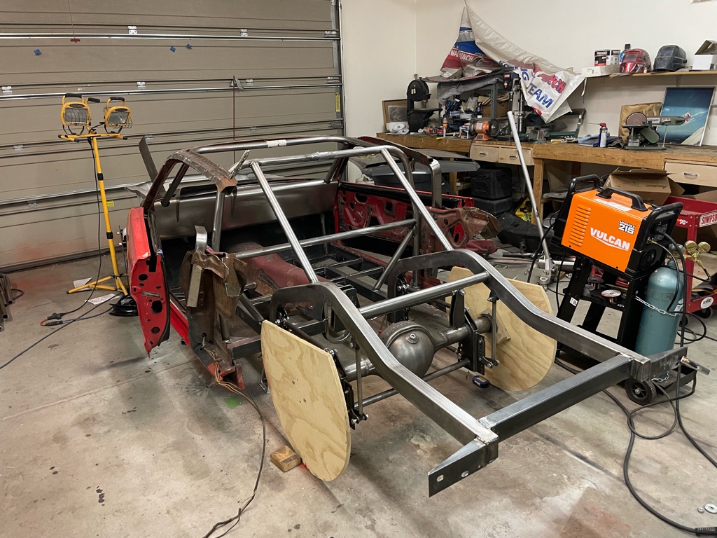

      Got the roll cage in and the dash back in place.

      Thank you. It’s starting to feel like I am making progress. So much of the project so far has just been cutting away rust and it is nice to be adding back on.

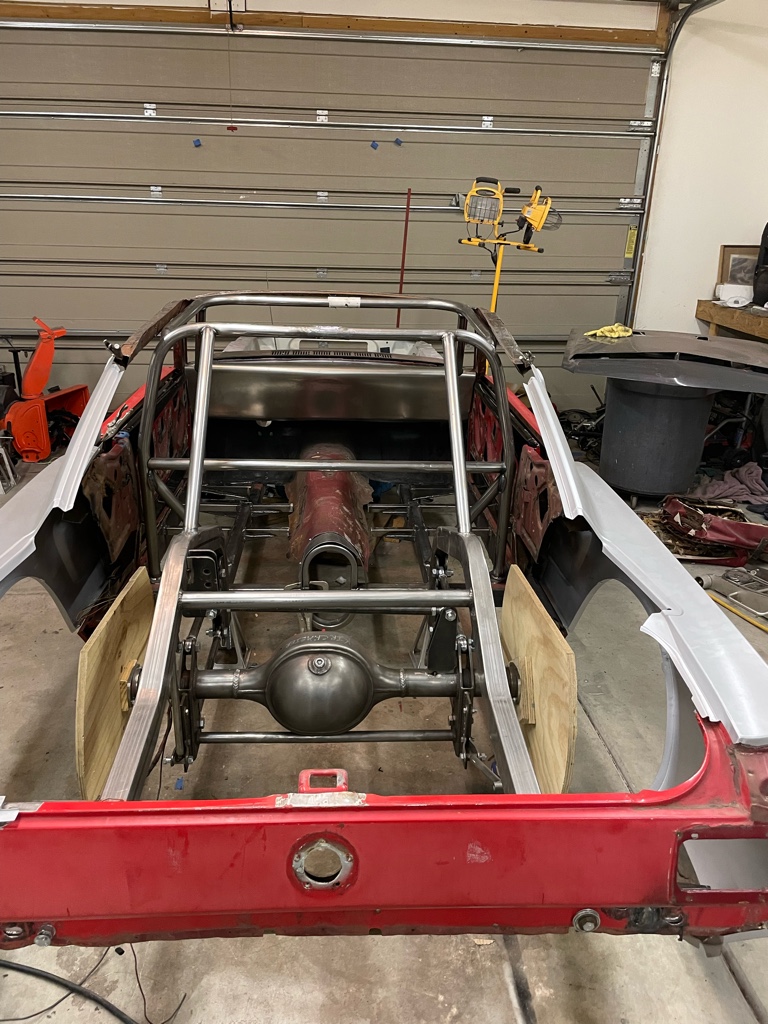

      Couple more pictures of the roll cage before I put the top on. Name:  IMG_1582.jpg

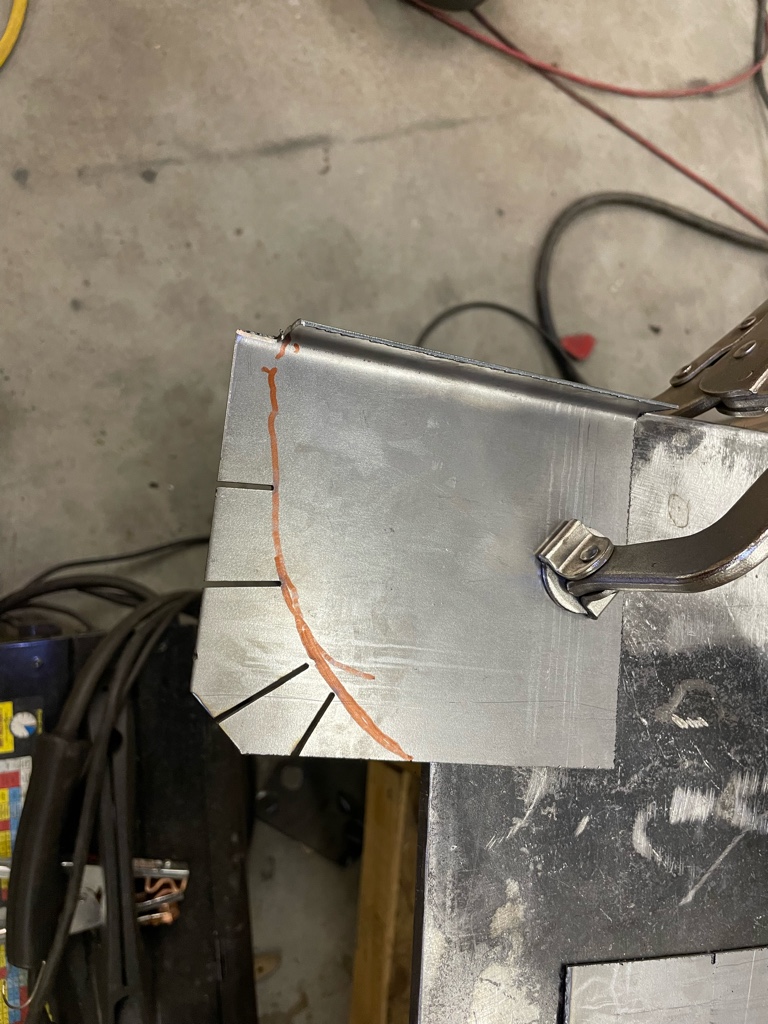

      Since I am using the coupe inner structure, I had to fab the back part where the window seals. Name:  IMG_1590.jpg
