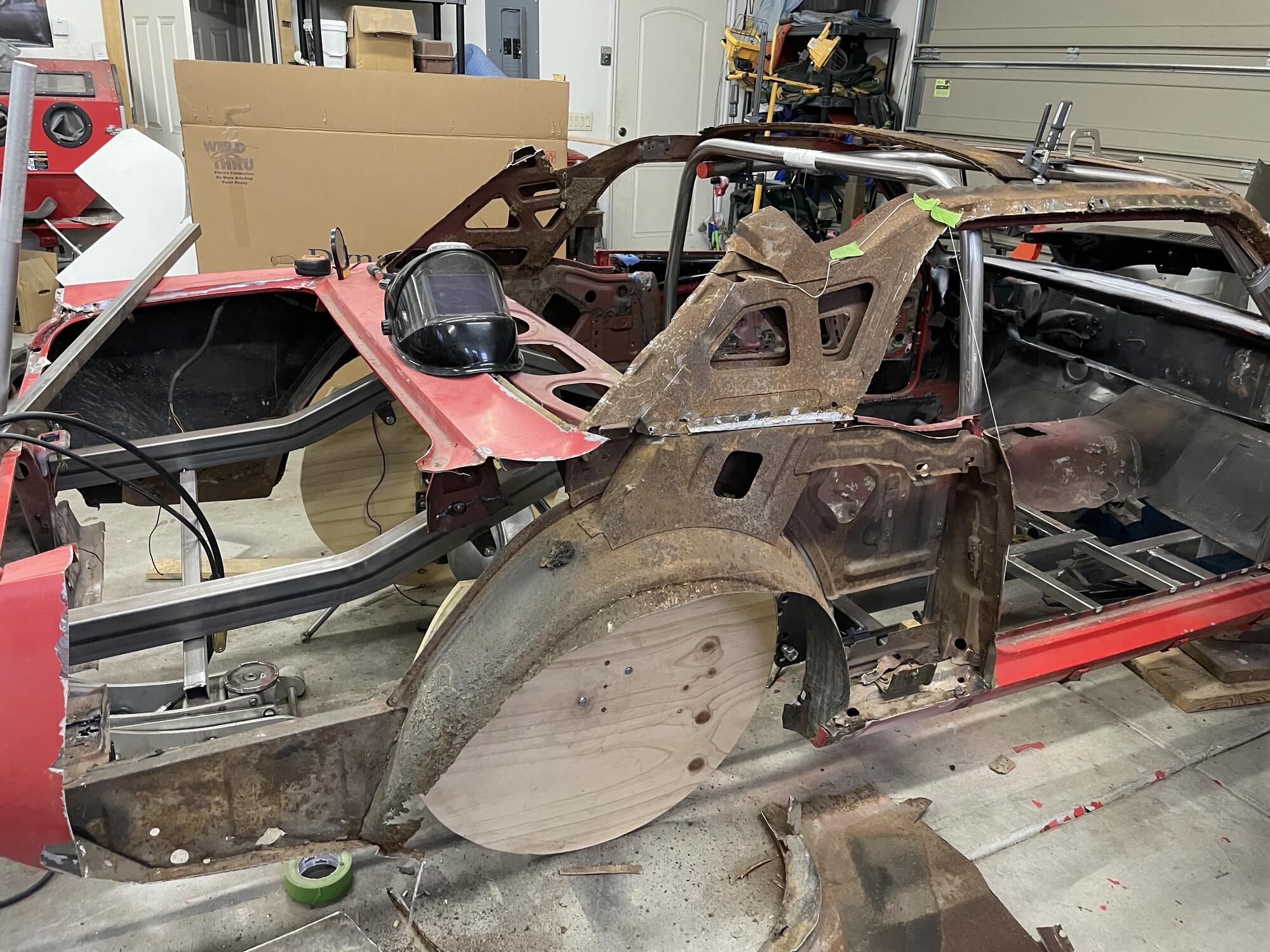

      I plan to turn this into a fastback, powered by a Coyote with some kind of power adder. I don't yet have the budget for all the things I want to do so this will take a while. I'll work on things as I can afford them. I plan to build it so that it looks pretty stock from the outside, aside from a few changes. I plan to run it lower than stock with larger wheels and tires that disappear up into the fender wells. The interior will not be stock at all. I won't have a back seat, that will be filled by the wheel tubs. The instrument cluster will be a digital display and the seats will be a modern bucket.
      I plan to install a 4 link rear and modern A arm front suspension. I'll extend frame rails to stiffen up the Unibody and will install a roll cage.
      The car I am starting with is not much more than a template. It is a good reference point for where all the new stuff goes. It is a rust bucket and I will ultimately end up replacing pretty much everything.
      So, now that I have stated my plan, I have no choice but to make it happen.

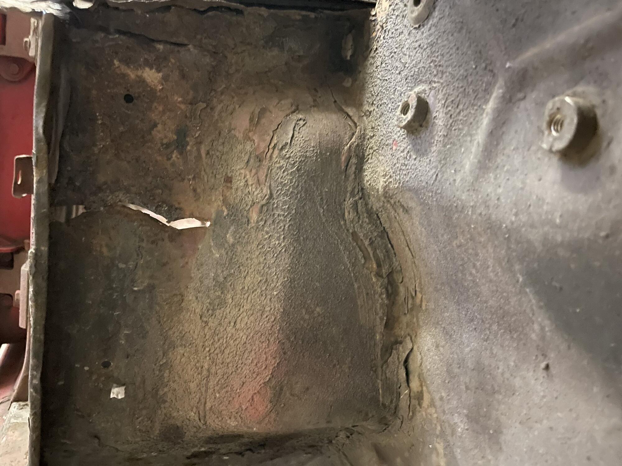

Size:  359.1 KBHere is what I am starting with. Rust, rust, and more rust.
      Apr 2010
      95
      You have your work cut out for you. Is that booger welds on the metal that’s all rusted? I’m glad to see you’re converting it to a fastback. Have you priced out the sheet metal needed yet?
      This looks like a good build. Best of luck

      A lot of that was some kind of resin goop. Somebody poured it over every hole they could find.

      I found the kits priced around $6k. I would like to keep the A pillars but with as much rust as I have seen, they probably have to go too.

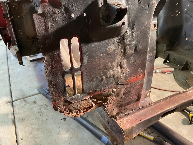

      Time to start rebuilding the front end.

      Making some progress on the front. The whole front was kind of a mess so it all has to go. The shock towers are not coming back since I am going with a modern front suspension.

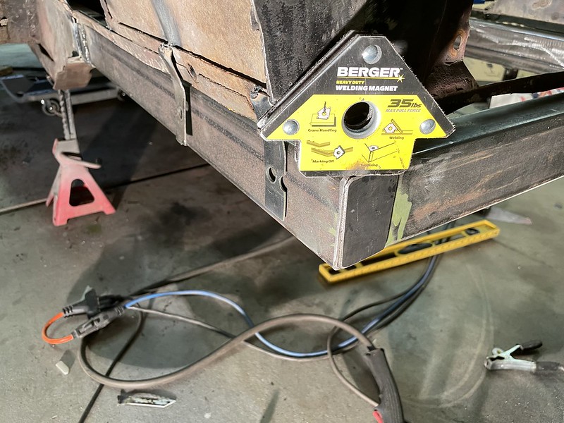

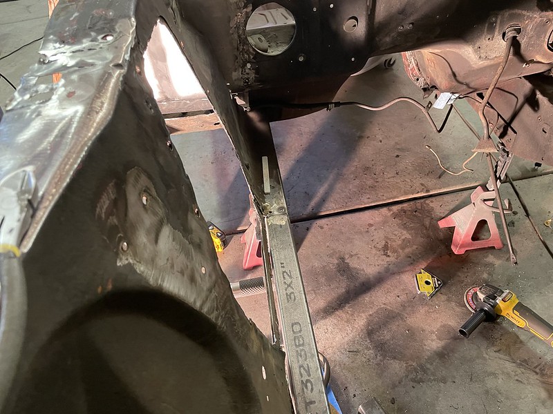

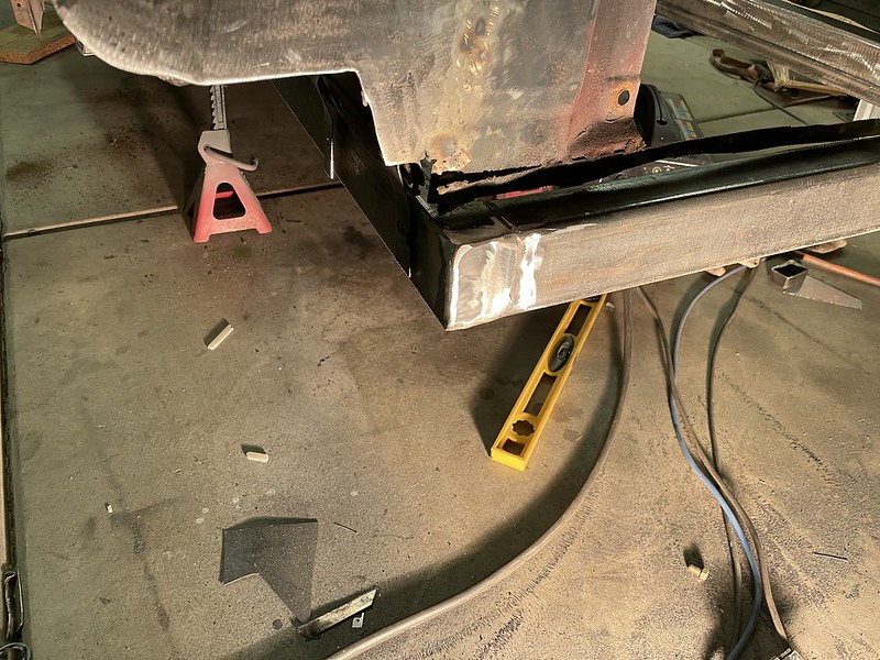

      Made some progress in getting her ready for her new skin. Name:  70D92F1F-77FC-4FC4-8E59-26F6A8727B92.jpg

      I ordered the rear end for my my project finally. I am going with a 4 link and panhard bar. My thought is that I want to be able to set it up for drag racing but return it to parallel for the street. My first live was drag racing so I want to drive to the strip, lay down a low ET, and drive it home. I built a Factory Five Cobra previously and I loved driving that car but every time I stepped on the loud pedal, it smoked the tires like crazy. That was fun but they wouldn’t hook up until I got to 3rd or sometimes 4th gear.
      Anyway, that drove me to the 4 link. I plan to weld the cross member to the rockers (which are in surprisingly good shape) and then put in 2x3 frame rails forward to tie in the front. I’ll put in time outriggers from the rails to the rockers for strength and for the roll cage mounting points.
      The rockers are good but I am considering adding 1/8” plate to the inside to strengthen them a bit.
