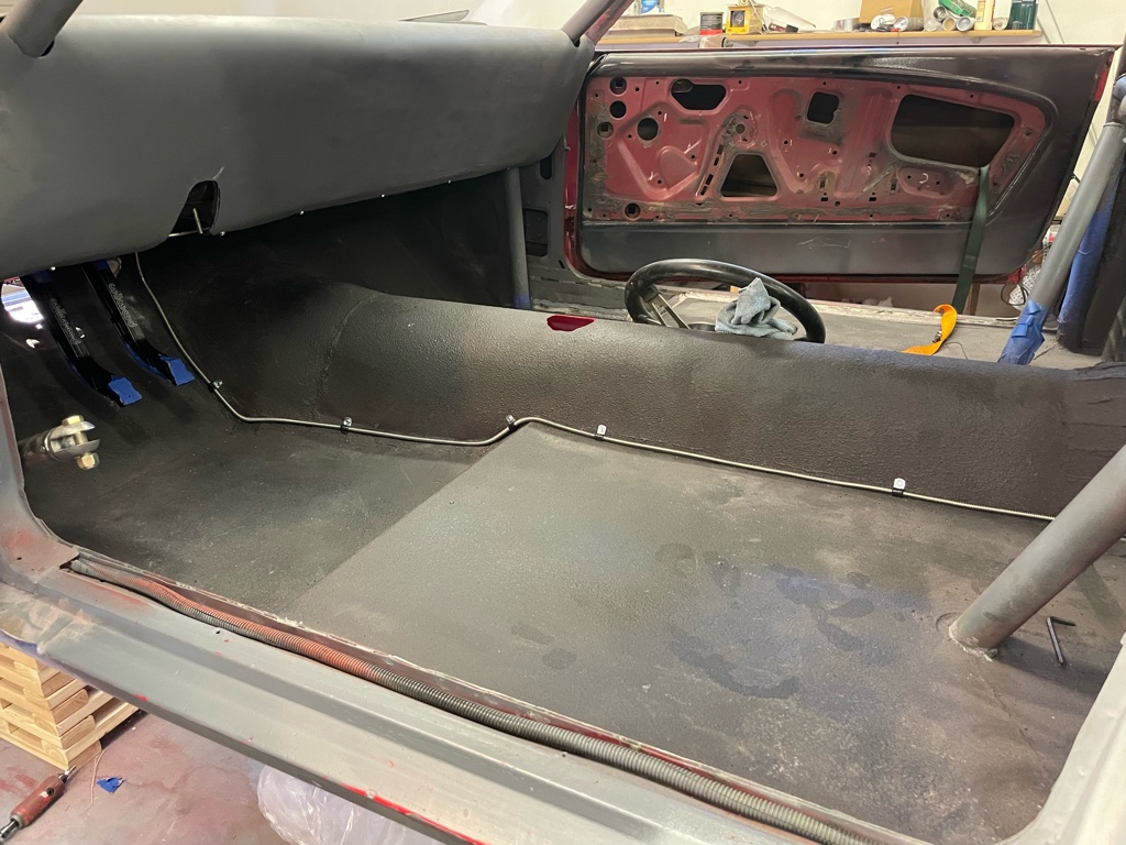

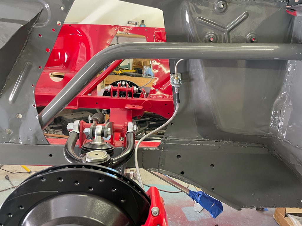

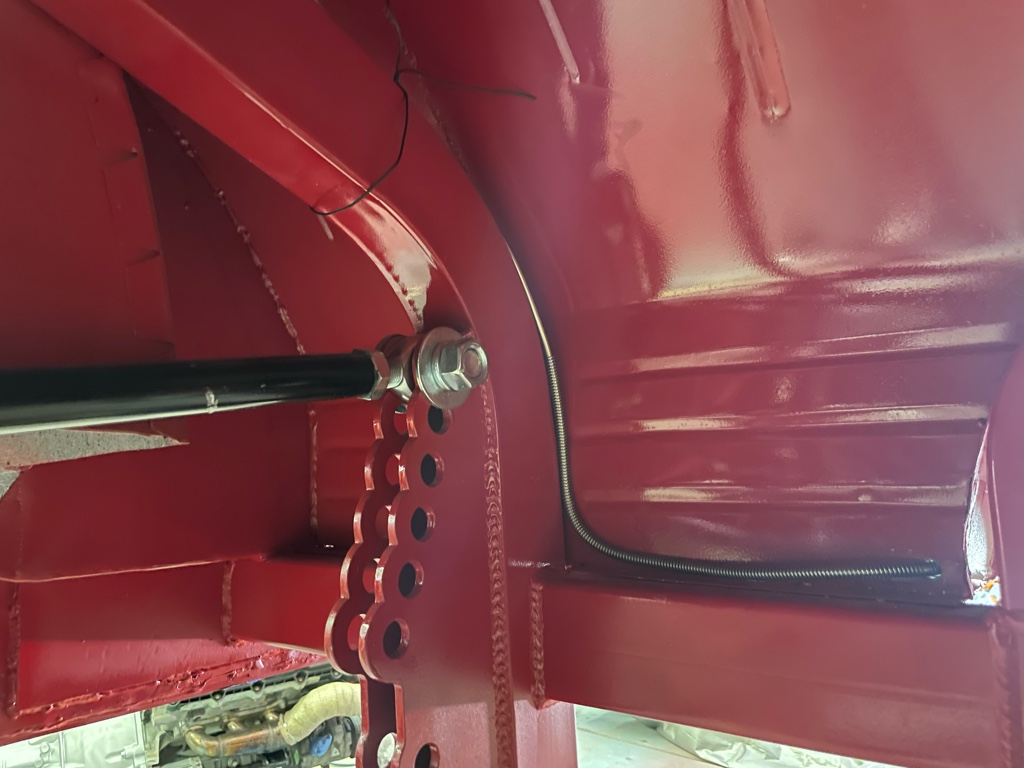

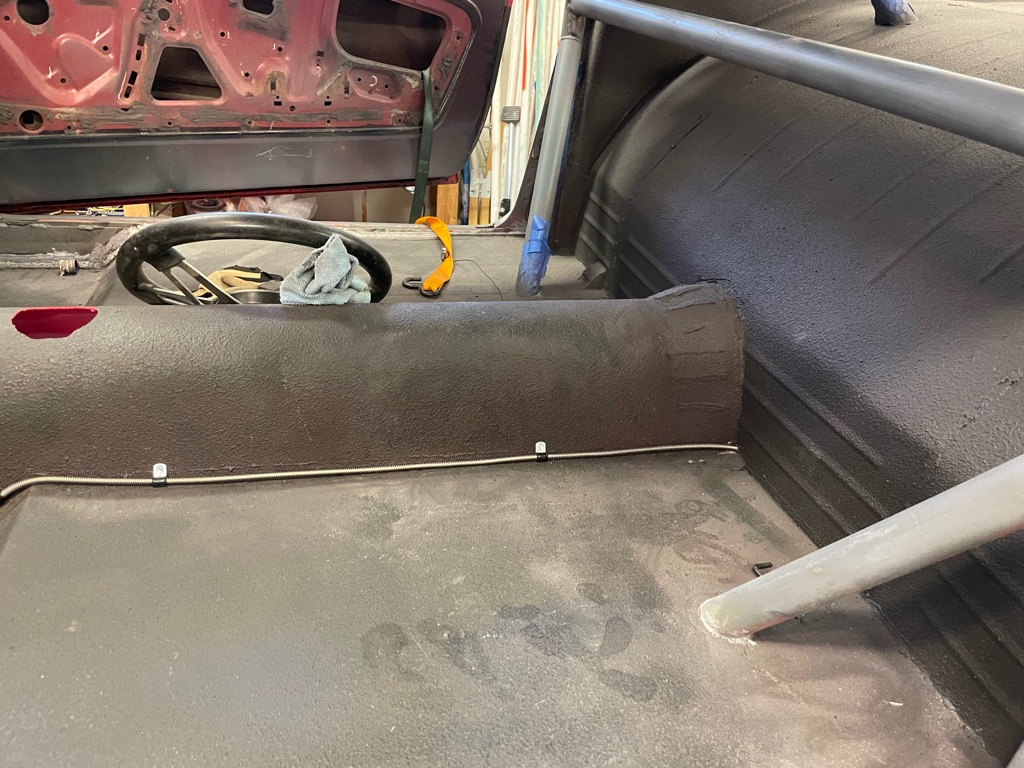

      I started routing the brake lines today. I decided to hide them as much as possible. Since the master cylinders are inside the cabin, it made hiding them easy. The fronts run along the inside of the firewall and out behind the roll bar. The rear line runs inside down the trans tunnel.

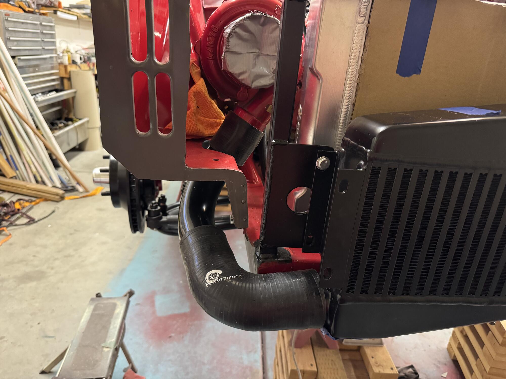

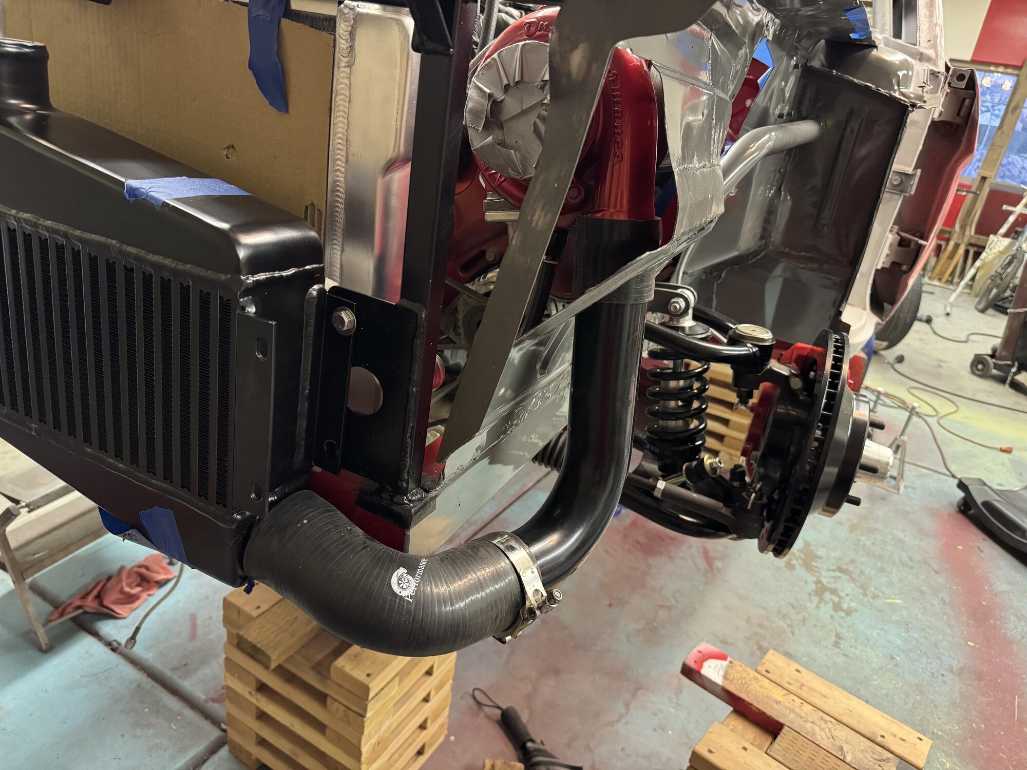

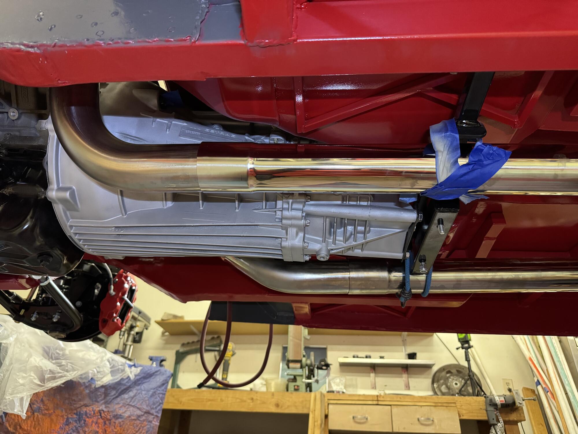

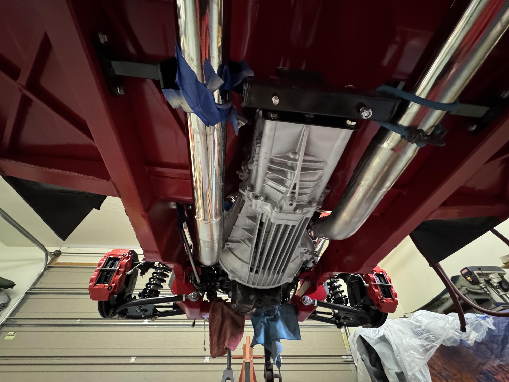

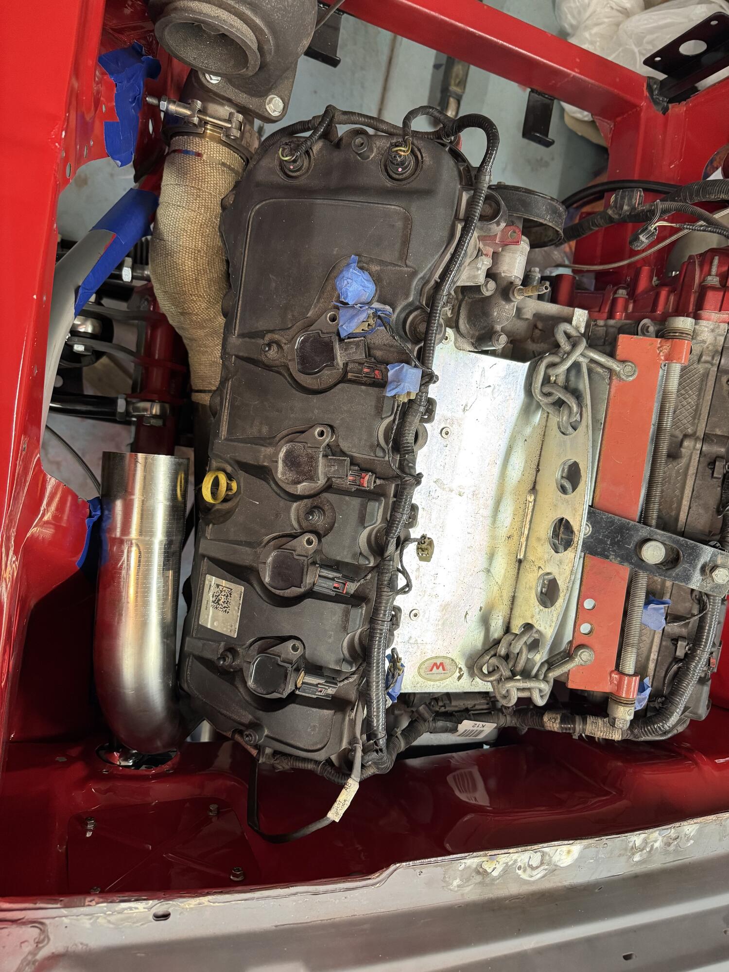

      I got the cold and hot sides plumbed.
