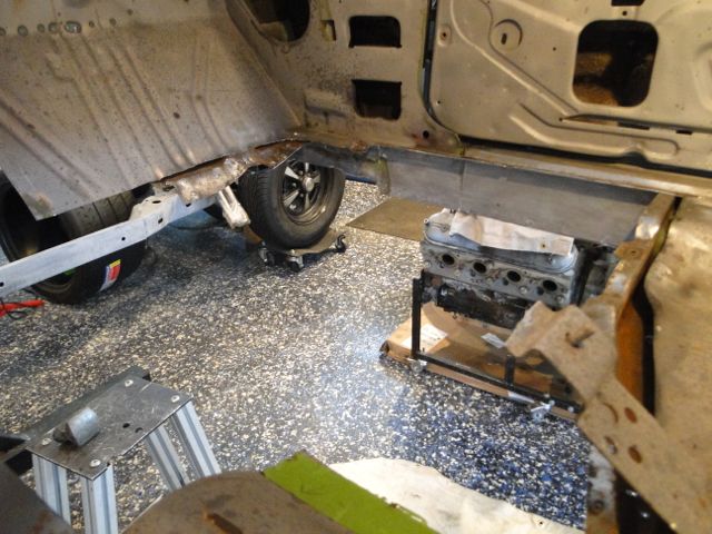

      Finished Trunk
      Trunk is done, besides figuring out new gas tank / fuel cell (any thoughts appreciated)!
      Moving on to front floors.

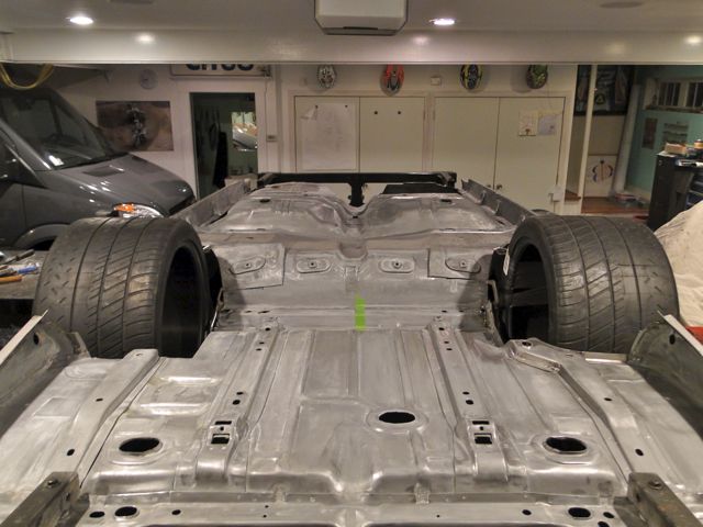

      Here is a fun shot, was able to rough out the passengers side tonight.
      I am going to take back my 39 1/2" dimension between the inner tubs. Going to adjust it and go slightly wider than the frame with 39 3/4" but who knows I might change that too!
      Will still have 3/4" of clearance on all four corners when the tire is bottomed in the wheelhouse. Figured that should be enough to keep it from rubbing while throwing it sideways!
      Attachment 86443
      Hey Eric. Man those meats look good!! Sounds like you've done your homework. Good Job! It's been so cold haven't even thought about going into the old garage and firing up the propane heater. But it's warmer now. You're efforts sure give me motivation. And I like the sketch you made in a later post. Nice work!

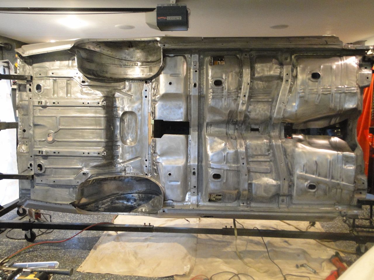

      Floors
      Thanks Mike,
      Got the floors done, need to do the trans and driveshaft tunnel once I get the body on the frame and buy a transmission.

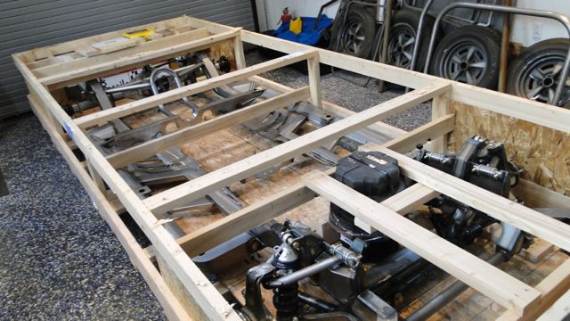

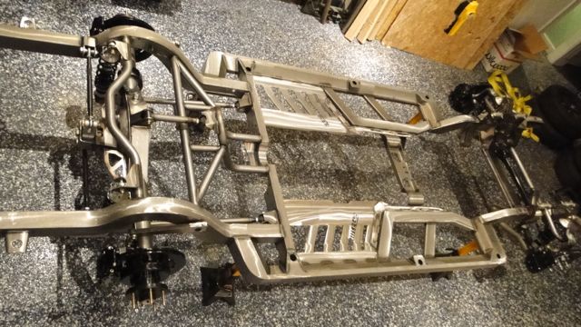

      Frame Delivered!
      Quote Originally Posted by 67speedfreak View Post
      Your project looks great can't wait to see the body on the chassis !
      Hey thanks, your GTO is getting there too!
      So excited to see the body sitting on it!
      Here are a few quick shots of the frame before my battery died, will post more tomorrow.
      My buddy Danny is the best for helping me get the frame off the truck and back home even though he was sick with the flu! He is a 69 GTO owner too!

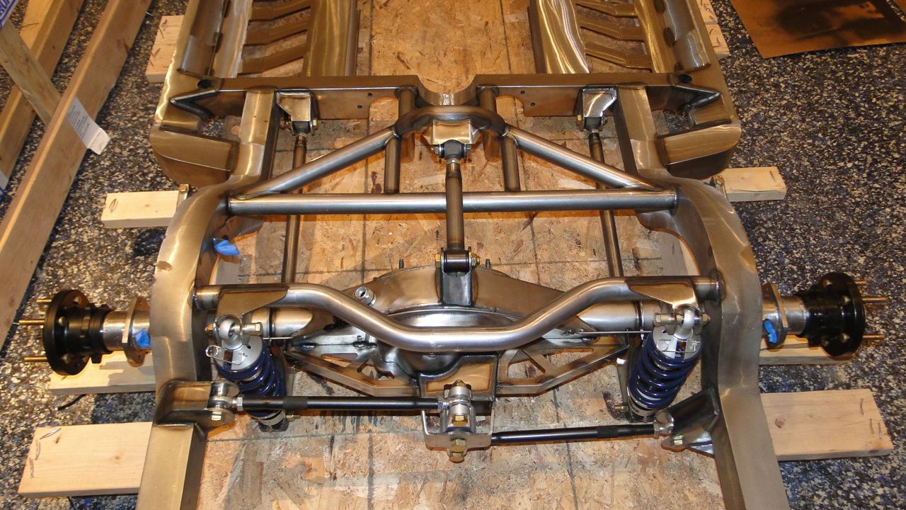

      Uncrated Frame
      Right on dude ! Going to be one bad ass GTO !
      Thanks!
      Hey any suggestions on a low cost set of wheels?
      I don't know my backspacing yet but would like to get something to move it around the garage with. Are the wheels on your GTO from a C6 Vette?
      So impressed with the quality on this frame, it really is a work of art!

      Love the bracing around the Watts link!

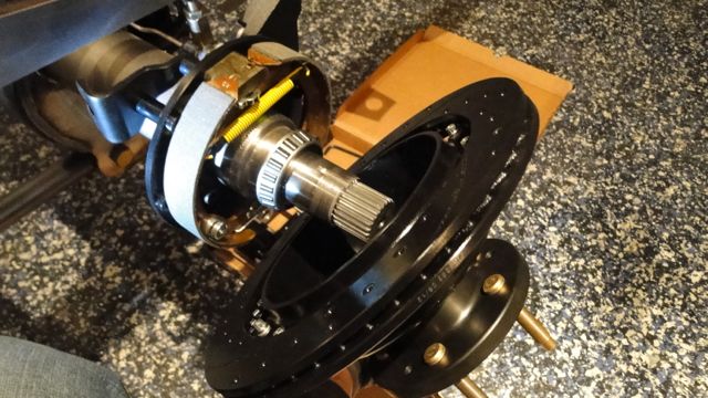

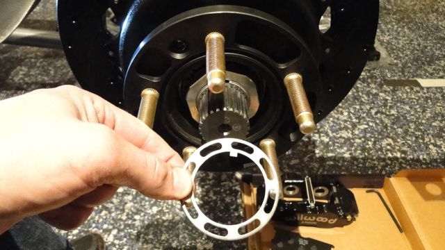

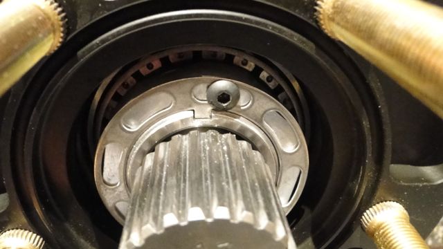

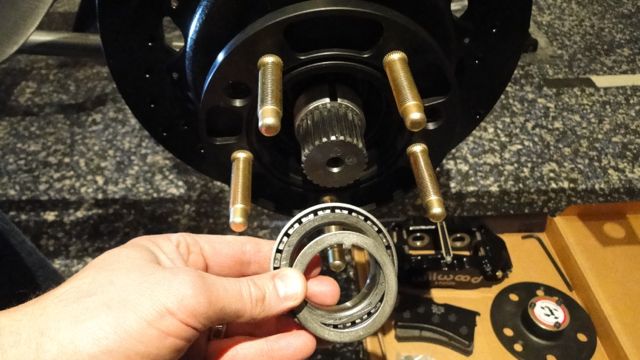

      Brakes
      My Dad and I had fun getting the brakes on for a test fit, everything looks good so far.
      I really like the Speedway Floater unit and the Wilwood kit was super nice .
      Was going to install the center section but I couldn't find my n.ts, haha.
      Tony I need my n.ts back please.
