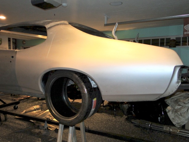

      I went with 18's all the way around. 18 x 8's in the front, and 18 x 10's in the back.
      I don't have any straight on side view pictures yet, this is the best I have. I had 13" of clearance in my rear wheel well, and with the offset of 6" it was fine. I had an offset of 4.50 in the front. At some point, I will be putting a wider wheel on the front.

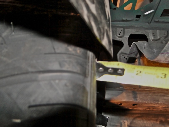

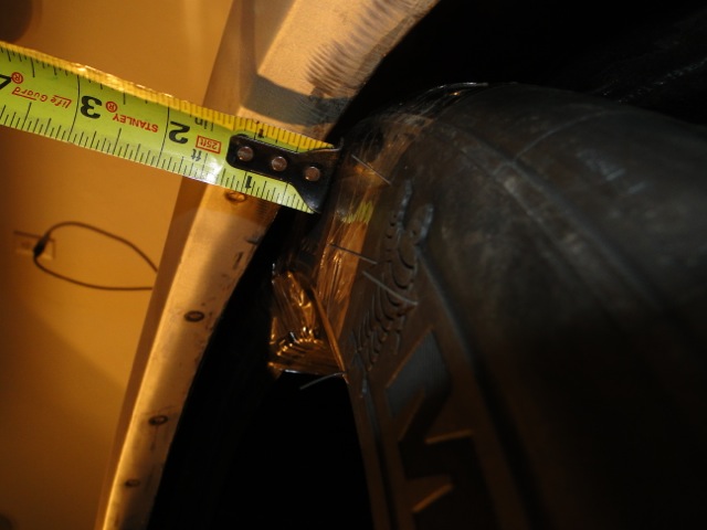

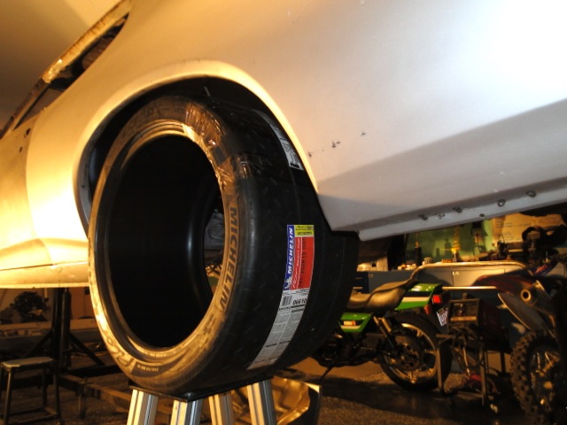

      345/30-19 test fit
      Hey nice to hear some encouragement for a change, most people just look at me funny and think I am crazy.
      Mike I am lucky to have friends with rotisseries, good luck with the paint. 69 Goat I like your Goat get together idea when they are done, jealous of your car looking so good, wish I still lived in Texas so I could have focused on fun stuff instead of rust.

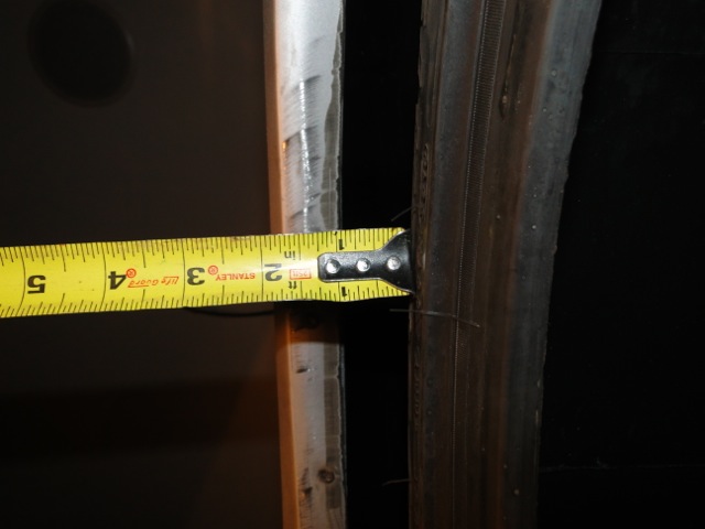

      Moved the inner wheel well in 2 3/4" and I think I should go more to be safe. When the tire is bottomed out I have around 1/4" clearance both sides. Could do some more rolling - trimming on outer lip.

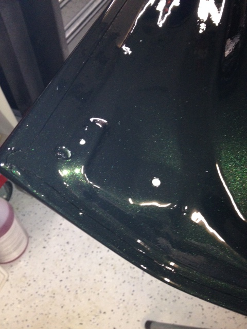

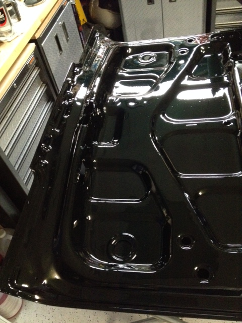

      Guys, as promised, I shot the under side of the deck lid. This is my first time doing a restoration, so I'm kind of excited about the "light at the end of the tunnel". Just need to finish wet sanding the primer, and I'll shoot the outside.
      Roger,
      Good to see you on this site. In all honesty, I came across your car online a few years ago and have used it (and your story) as motivation/inspiration/ and design ideas. The Goat I'm working on was purchased brand new, by my Dad. I learned to drive on it... when I went away for college, it sat and deteriorated to the point of becoming non-functional. I finally got possession a little over two years ago and doing all the work myself. Almost there!
