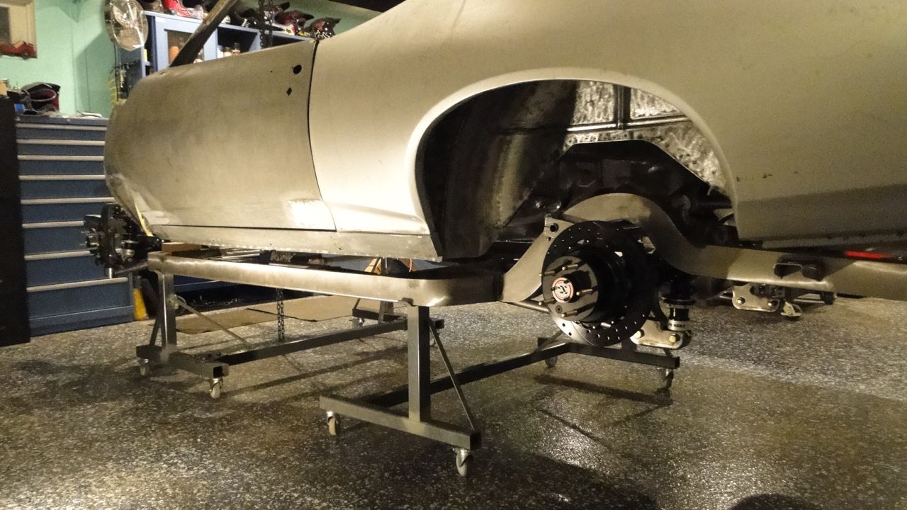

      Back to the GTO, the frame rails from RS are 39.5" wide over the rear end, so I ended up widening each tub 3.25" for 40" between the inner tubs. With the 345 bottomed out in the tub there was 3/4" clearance per side. You would probably be fine with 3" if you already got around to welding, but I just wanted that extra room.
Size:  57.1 KBName:  DSC08809.jpg

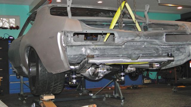

      Did some initial fitting of the body today, rear of the body is still an inch and a half off the body mounts. I need to make room in the trunk for the Watts Link, and top arm of the three link. No big surprises though.

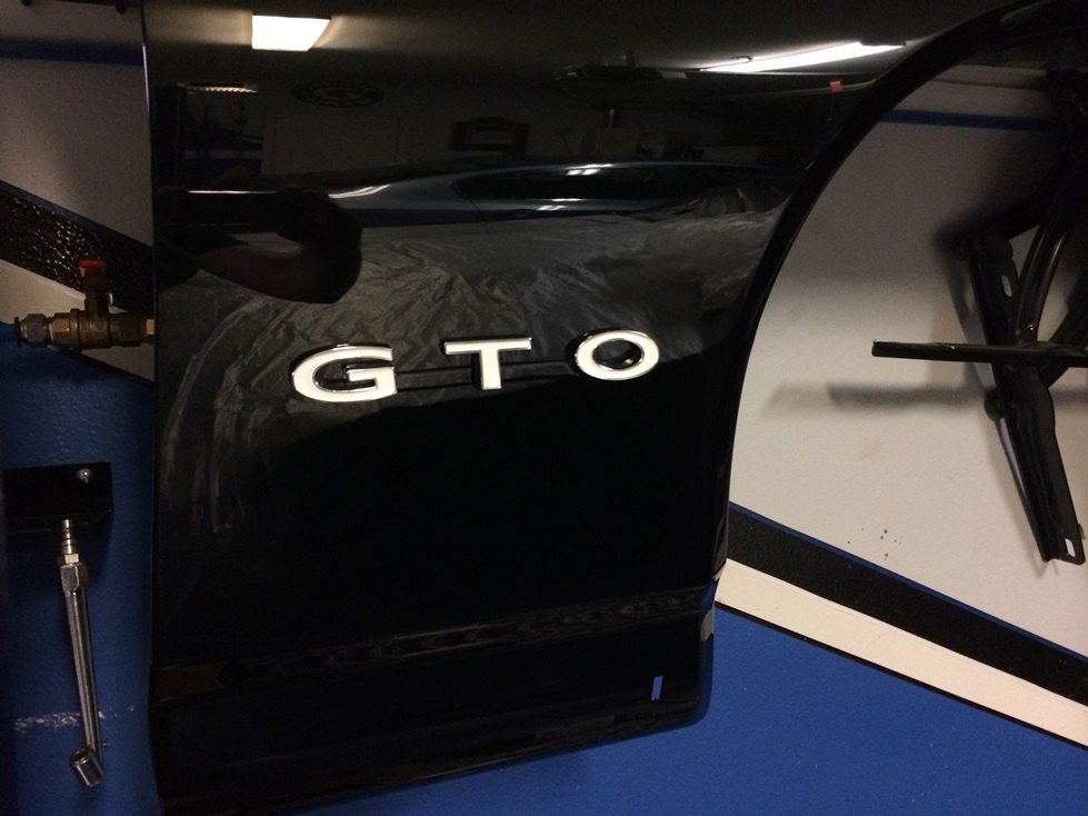

      Fender Emblem
      Guys, thanks for the bumper paint comments... I did something exciting last night and installed the first emblem. Check it out... It wasn't easy because the latest batch of emblems from Ames/OPG/YearOne do not fit the stock holes and I had to shave the pins. Anyway, it motivates me to pick up the pace too... Enjoy.

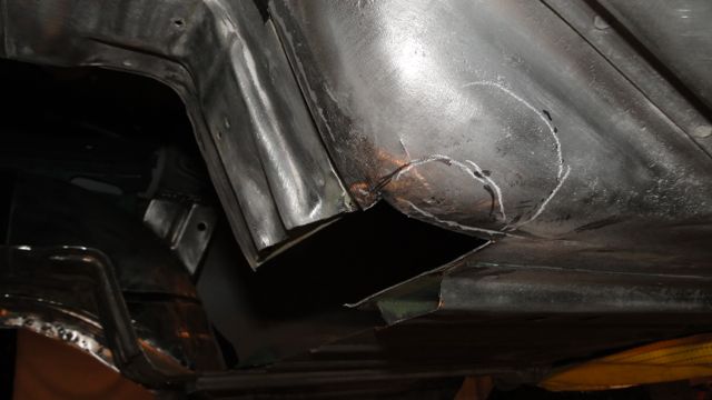

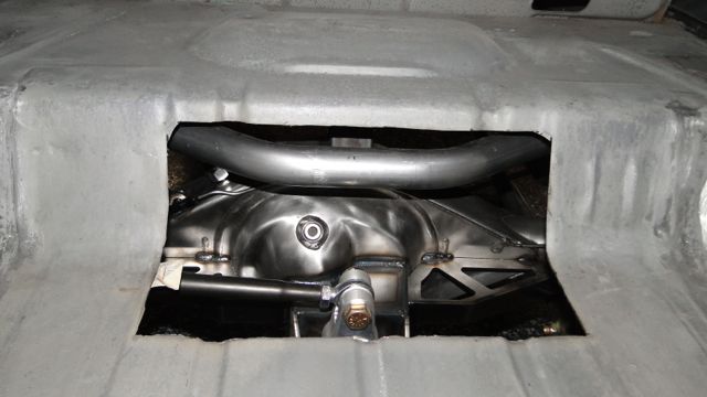

      I finally had some time to cut the trunk today.
      Still need to take the shocks off and cycle the rear end to figure out how much more I need to clearance.

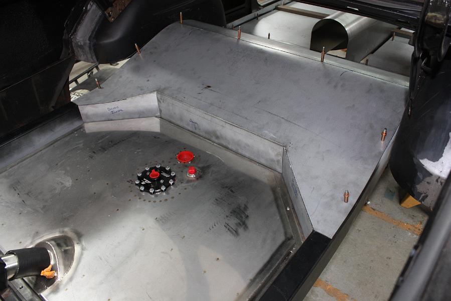

      Mike you are doing great, you could always paint cars on the side, but it is a lot of work that seems to take forever. Cant wait to see the finished product!
      Hey thanks HeadInTheClouds, it took me forever to be able to afford to build a garage at my house. Luckily my GTO didn't all turn into rust, just some of it!
      You have a very smart and cool lady there so keep her around and get her a GTO someday. Keep checking Craigslist you never know when a good deal might pop up.
      That WS6 is a fun daily driver.
      Little more cutting done today, moving slow.

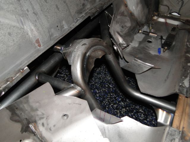

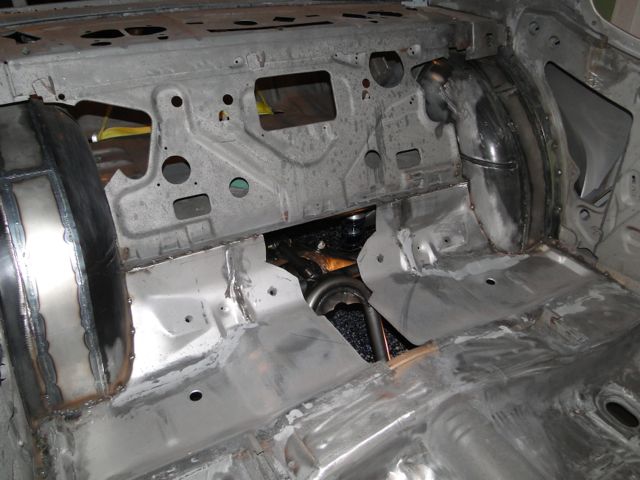

      The 3 link hump is off the list, recycled the center section from the old floor and built around it. I need to invest in some sheet metal tools to speed me up.
      Maybe I would miss the vise and bag of sand though...
