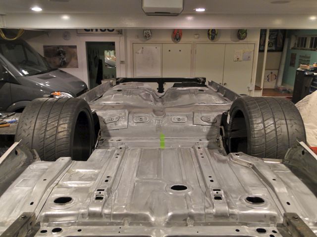

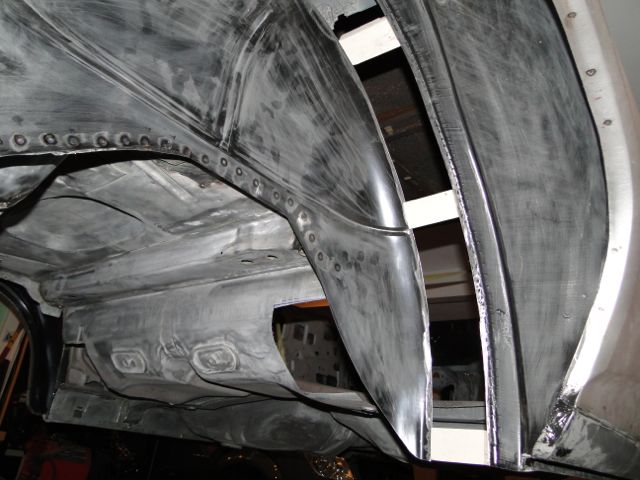

      Here is a fun shot, was able to rough out the passengers side tonight.
      I am going to take back my 39 1/2" dimension between the inner tubs. Going to adjust it and go slightly wider than the frame with 39 3/4" but who knows I might change that too!
      Will still have 3/4" of clearance on all four corners when the tire is bottomed in the wheelhouse. Figured that should be enough to keep it from rubbing while throwing it sideways!

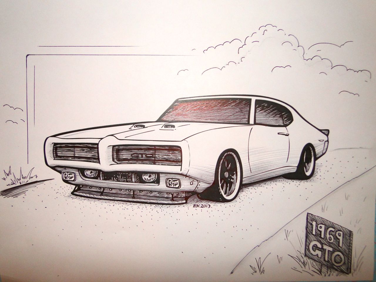

      Quick Sketch
      Quote Originally Posted by SShep71 View Post
      If your concerned about side to side you can always use a watts link to help the stability of the rear to remained centered
      Hi SShep,
      Yeah the RS frame will have a Watts Link on it, I am trusting they will do a good job with the set up based on all their past work.
      Have you had a chance to get any work done since you have been back?
      Did some sketching tonight to get some thoughts down, I want a super low NASCAR style air dam, was thinking it would be cool if it was double hinged so it could move up if hitting a speed bump but would be limited in its travel down.
      Open valance for oil cooler and driving lights.

      Hey Eric.
      Love your drawing! man, I Wish I could draw like that. .... heck, I have trouble drawing stick people!! Good thing I don't do it for a living... No progress on my project. too cold and not enough room to do the frame mods. It's going to be a long winter.
      Gus

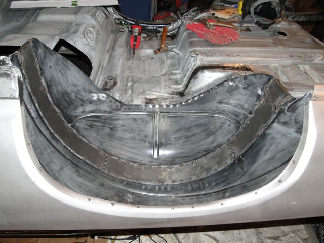

      Jun 2012
      N. Shore, Ma
      346
      Inner Tubs
      Hi Shep,
      Hope you heal up quick and they are taking good care of you! Enjoy the down time, you will be back at it soon I'm sure.
      I would have loved to do everything on my frame and be able to say "yeah I did that", but I also REALLY want to drive it someday soon. All of the guesswork on the chassis setup will be gone too so that will free me up to finish other things.

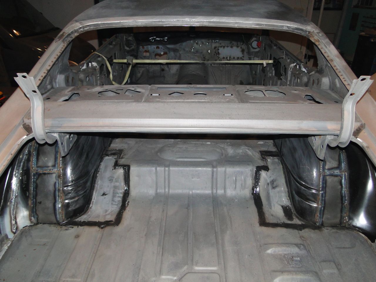

      Some progress, very time consuming building little brackets that no one will ever see! Then got the inner tubs spot welded in and the filler strips tacked in place over the weekend.
Size:  33.8 KBName:  DSC08060.jpg
Size:  42.6 KBName:  DSC08066.jpg
Size:  51.1 KBName:  DSC08064.jpg
Size:  47.8 KBName:  DSC08072.jpg
Size:  58.4 KBName:  DSC08105.jpg
      Thanks for the compliment Gus!
      I would love to put my drawing skills to use someday...

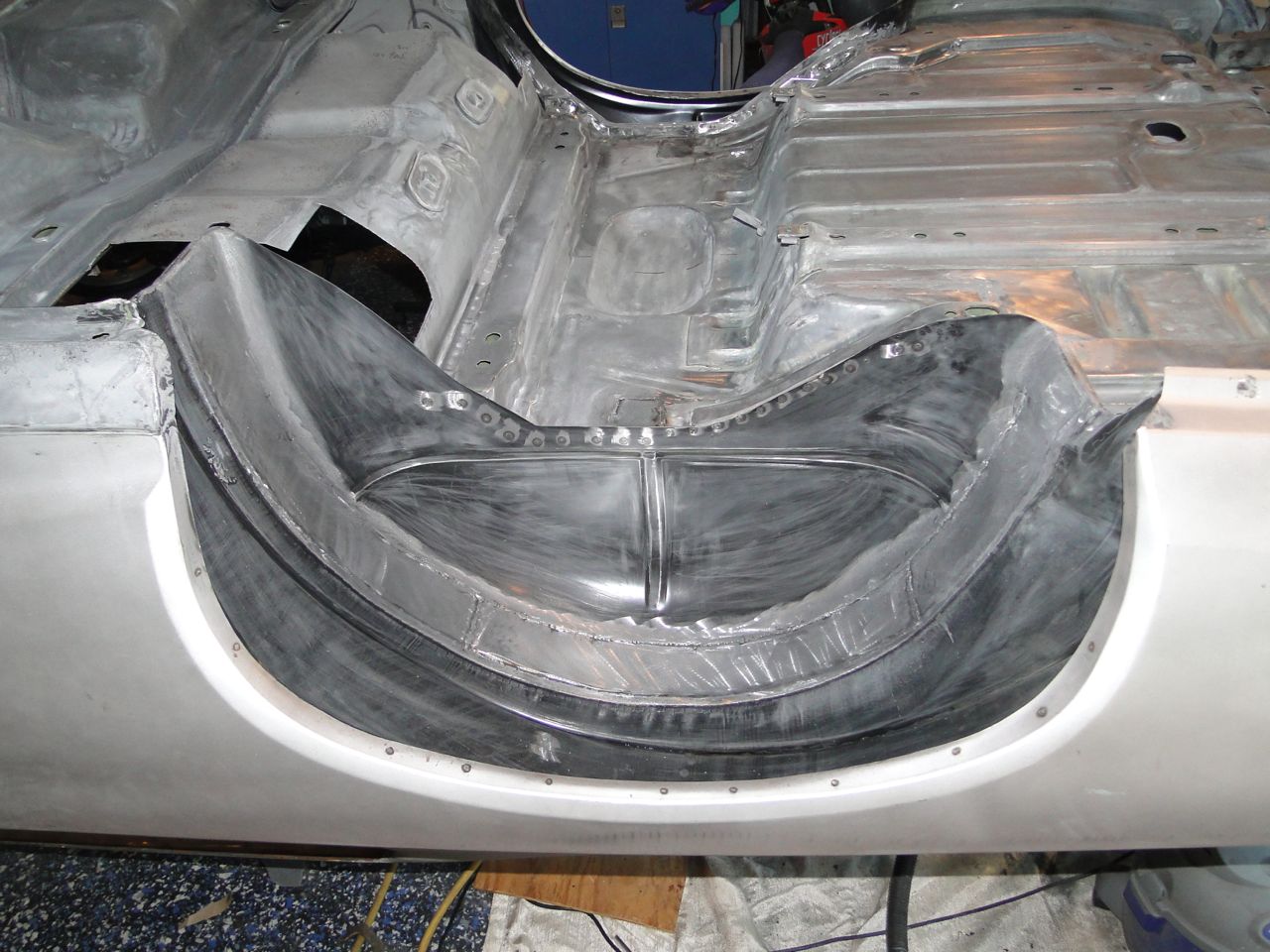

      Hi Gus and Jon,

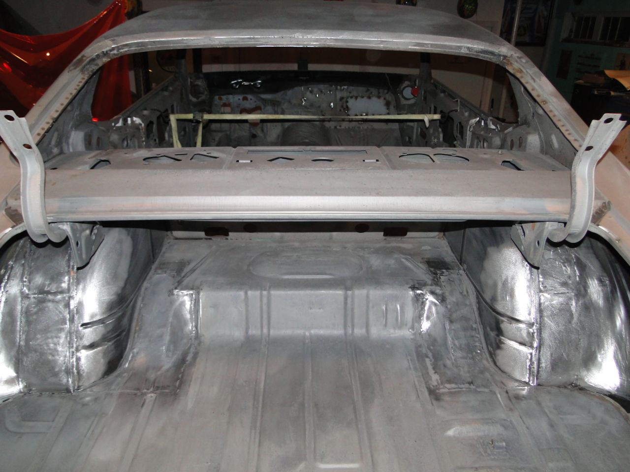

      I am enjoying the radiant floor heat in the garage, it helps keep me out there on those snowy days.
      Got a lot of welding and grinding done on the tubs. Will skim the low spots of the welds inside the trunk with Bondo and I will be using a truck bed liner inside the wheel house to hide my sins.
      Still need to fit the trunk braces.

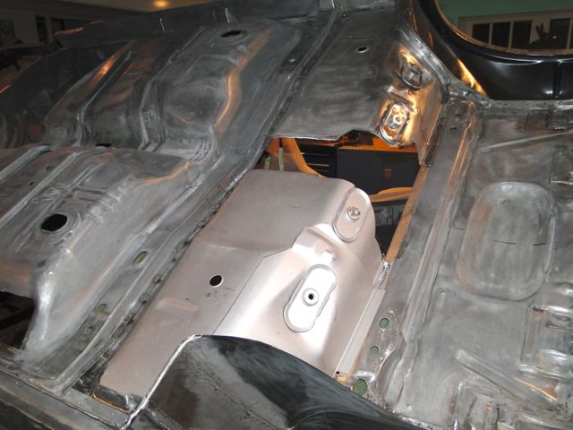

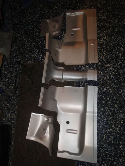

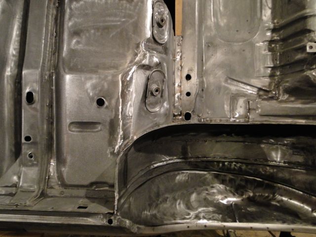

      Floor

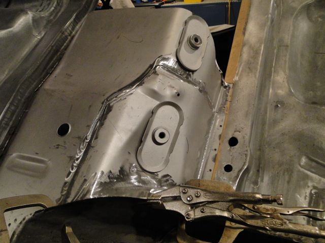

      Moved on to floors now, cut it up to bring sides in to mate to inner tubs, and center section for top 3 link mount and raised driveshaft.
Size:  71.5 KBName:  DSC08313.jpg

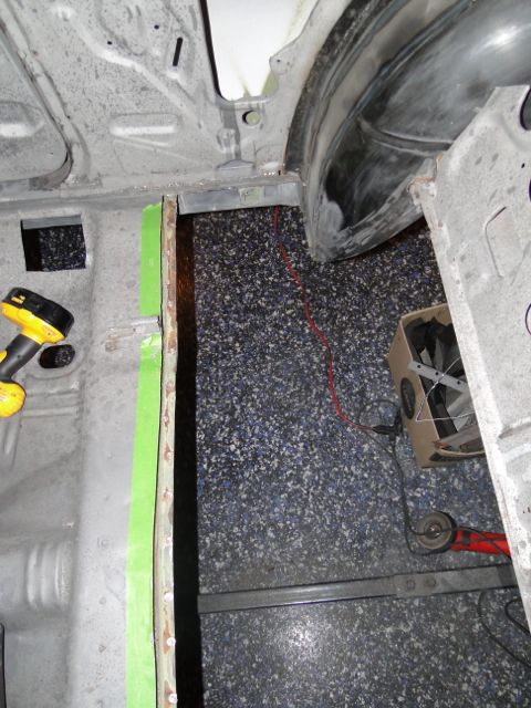

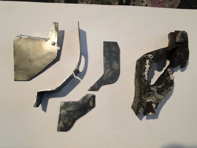

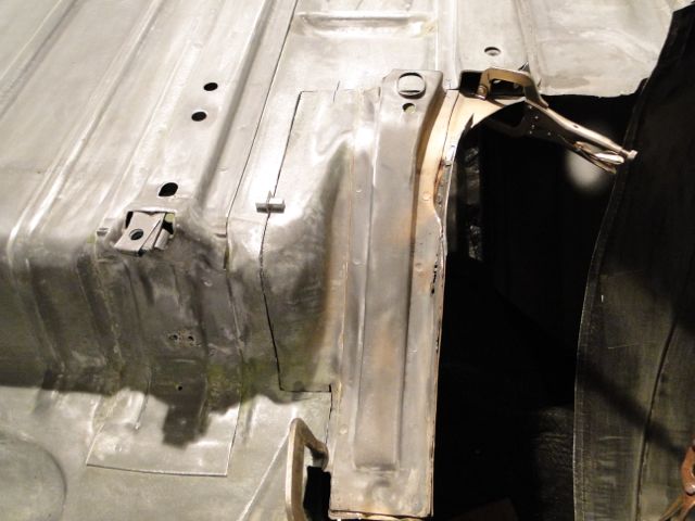

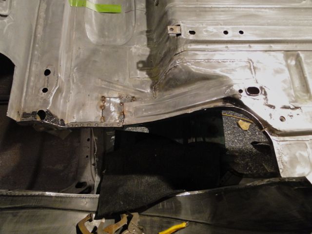

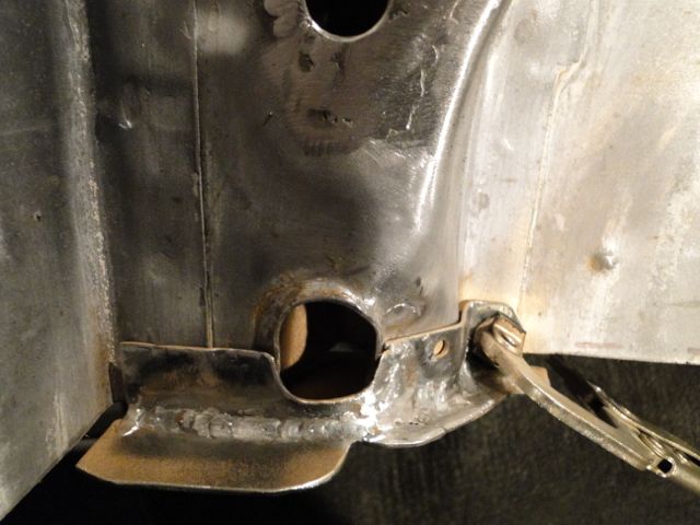

      Floor corner
      Quote Originally Posted by 67speedfreak View Post
      She is looking really good !
      Thanks! It is cool that we can inspire each other along the way.
      Got some floor welding done today.

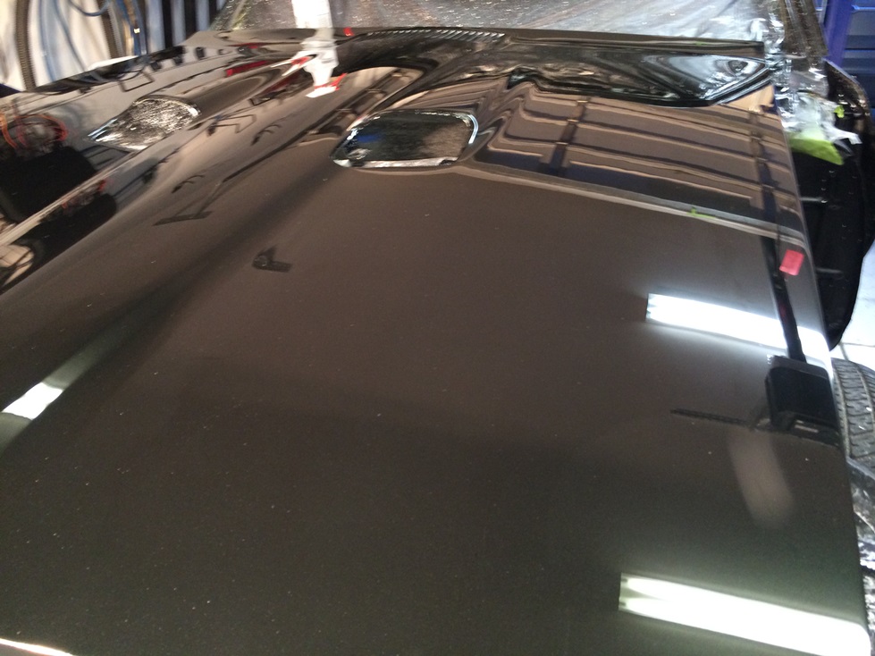

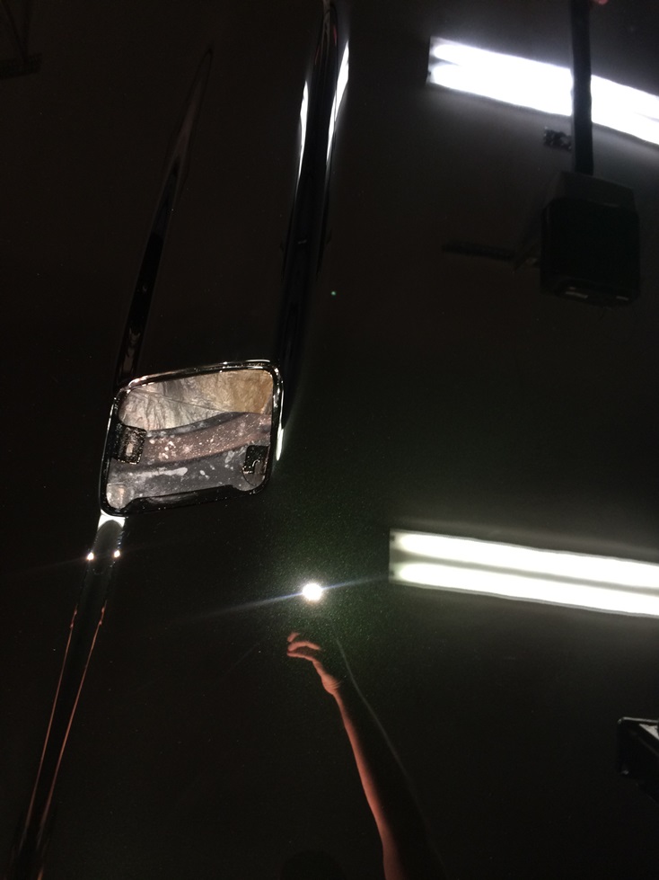

      Color Sanded Hood
      Guys... I hope everyone got some work done over the holidays... here's some more motivation, mostly for me, but, enjoy... I just finished color sanding and polishing the hood. Fenders are next... (the specs are just polishing dust, and/or polish sling I haven't cleaned off yet)
      Name:  Polished Hood 3.jpg
Size:  212.3 KBName:  Polished Hood 2.jpg
Size:  112.1 KBName:  Polished Hood 1.jpg

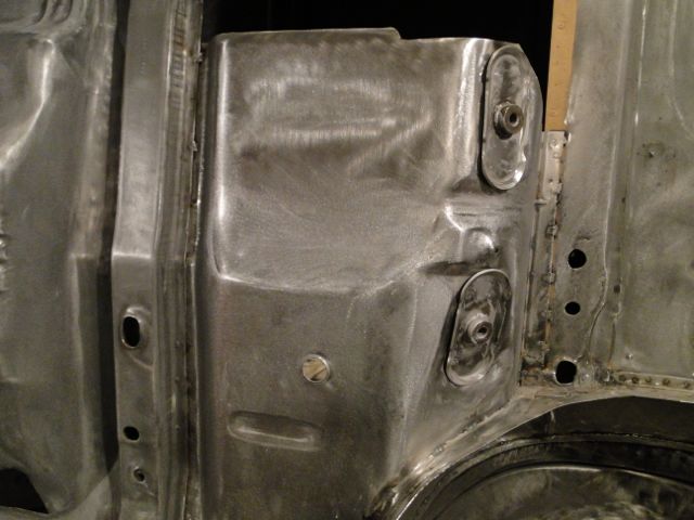

      Rear Floor
      Hey Mike,
      The paint looks great, looks like all that sanding paid off!

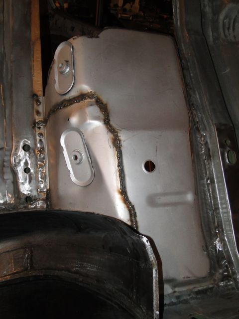

      Welded in the other floor section, now on to the front floor patches.
Size:  52.6 KBName:  DSC08503.jpg
Size:  56.0 KBName:  DSC08509.jpg

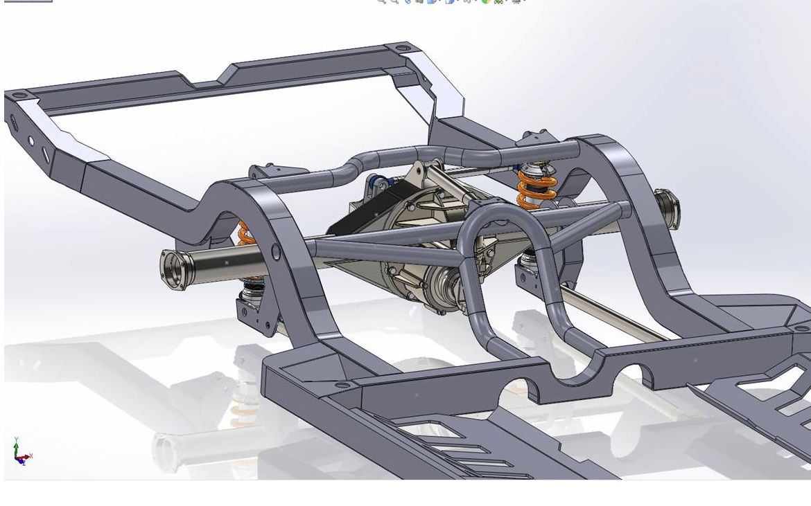

      Roadster Shop Frame
      Hi Mike,
      Thats the best way to learn is by messing up, I do it all the time, haha!
      Yeah I am a better grinder than welder too, it is tough to make a pretty weld with 18 Gage sheet metal.
      Here is a sneak peak on the RS Frame. Is there such a thing as frame p rn?
      (splined sway bar not shown)
      They say it is going together now, hope to get some picts of it soon.
      Name:  Screen Shot Frame.jpg
