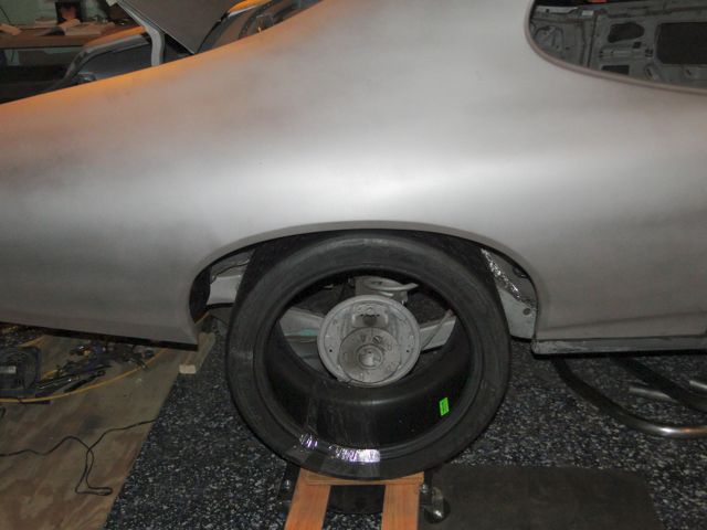

      Hi Cameron,
      Have you checked out the 70 Chevelle Tim is building, the Widowmaker? He did a nice job on the inner tubs, looks like a lot of work but worth the effort since the factory inners seem too close at the corners.
      A few weeks ago Tony at ABC said for the 68-72 that "The inner tubs are not ready yet, but we do offer a modified pair for $550.00 to fit with our frame mini tub kit."
      But you should double check and call him and let me know.
      I might look into these Alston Chassisworks steel tubs, they might be too big but I could cut them down. https://www.cachassisworks.com/p-433...x40-steel.aspx

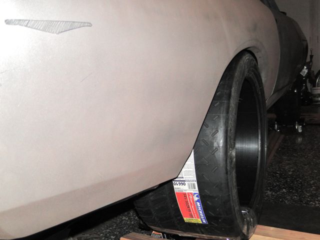

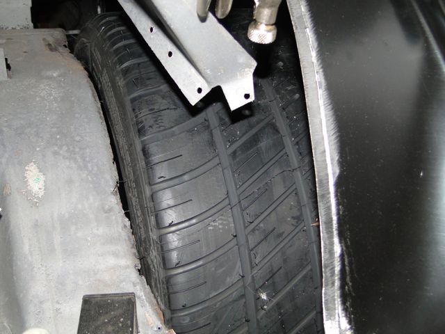

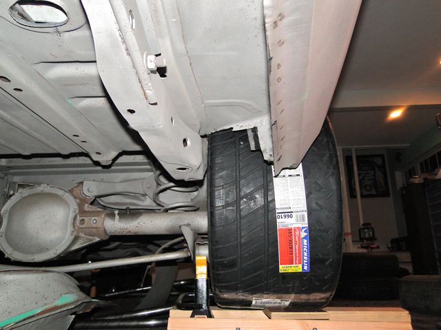

      I will be running the same size tire as you 345/30-19 (subscribed and been following you too) how much did you narrow the frame? I plan on rolling the outer lip as well.
      Plan on getting the body on the rotisserie, do the tubs and then make a frame jig to do the cutting of the rear frame rails.

      Eric,
      I talked to Tony yeasterday at ABC about the 68-72 mini tubs and got the same answer as you. The inners that he has currently would be reproductions inners that are cut, stretched, and welded up. He also said that he is getting tooled up to have the stetched inners stamped, but won't be available for a while. I'm considering ordering reproduction inners and outers and stretching them myself, but still not sure.
      On my frame, I built a 5' X 16' welding table and attached the frame to it. I haven't made the cuts yet but I am working with a machine shop here to have my frame rail cut out of 11ga. steel from a pattern made from the original frame rails. Then I will box them up and weld it to the frame with the factory rails still in place. I will have to brace them up real well to ensure nothing moves. Then I'll cut the factory rails out once the modified ones are in. The process will be a lot like a Buick GN on this site, heres a link to his build thread. https://www.pro-touring.com/showthre...built-Buick-GN

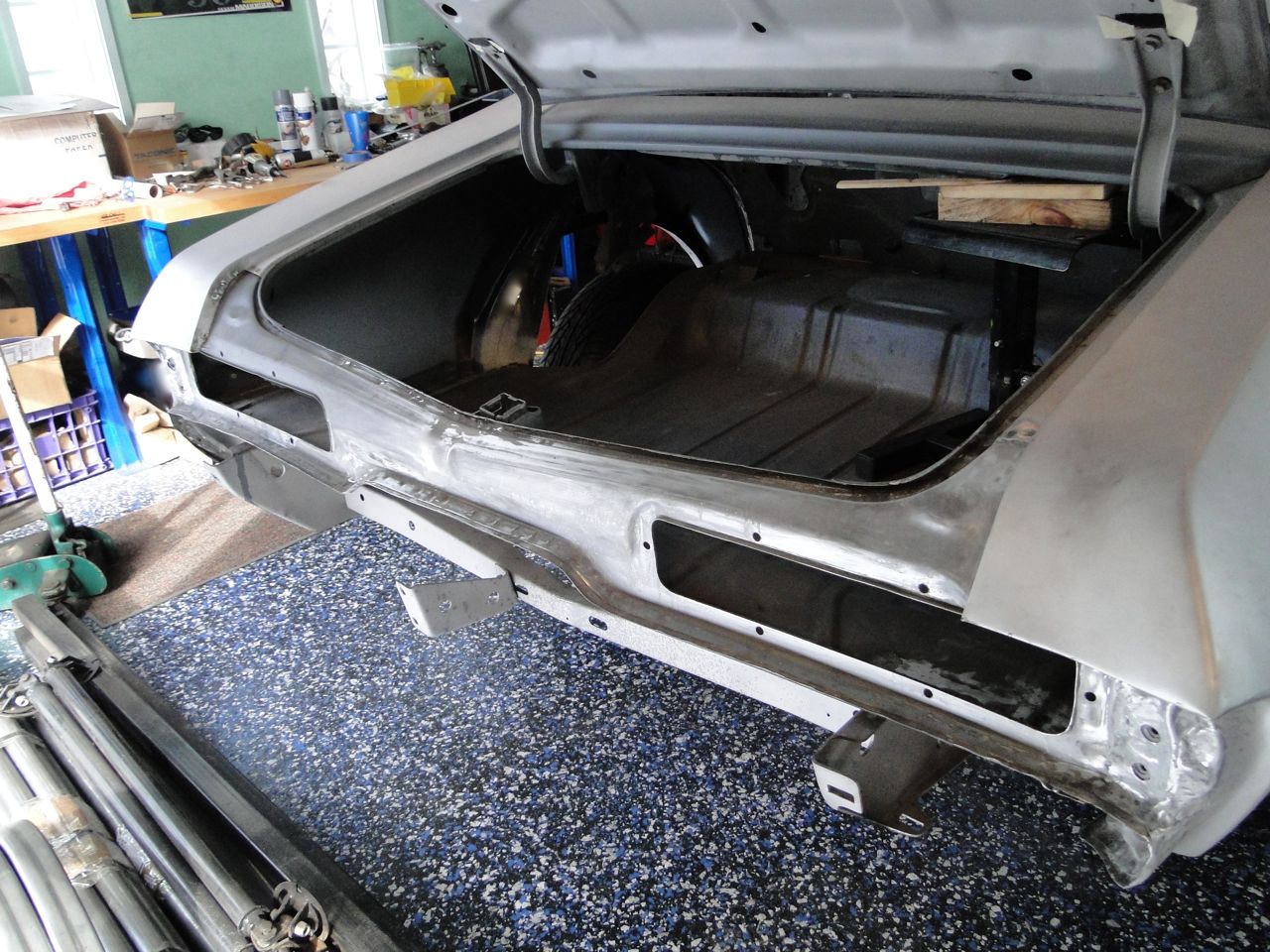

      Some Progress
      Super busy at work lately, wish I had more time to work on it.
      Tail Panel, both Cowl corners and Firewall off the list. Bunch of spots around the windshield and back glass need repair. Still looking into flush glass kits if someone has info?
      Almost ready to get the body on the rotisserie and start the Mini Tubs and Trans Tunnel.

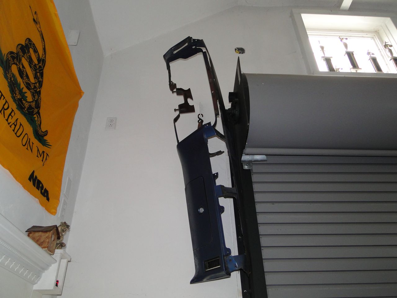

      Picked up a metal 69 Impala dash, hope to do something like this with the carbon fiber insert and all new gauges. Will need to shrink the width about three inches and do a custom dash pad.

      Check out roadbusters build, he has a 68 with 305's and he might have went to 315's without tubbing.
Size:  59.8 KBName:  DSC07804.jpg
Size:  55.5 KBName:  DSC07805.jpg

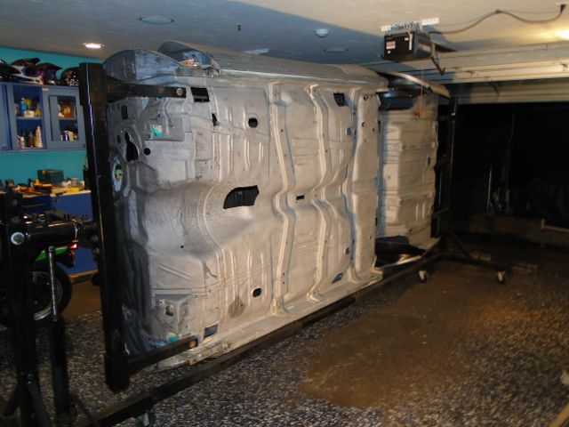

      Getting ready to attack the mini tub job. Planning out raising the trans tunnel and floor repair next, then it is time to make some frame mods. (Or convince the wife I need a Roadster Shop, or similar frame, haha)
