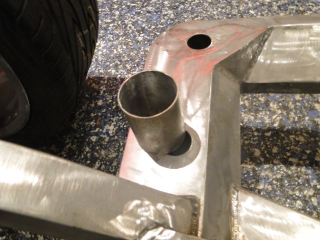

    3. #283
      Jun 2012
      N. Shore, Ma
      346
      Delrin Mounts
      New shorter Delrin body mounts.
      Eric

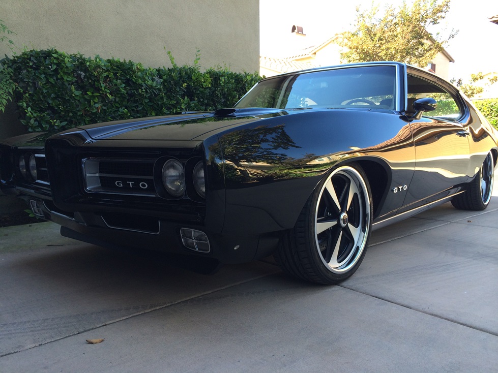

      Great progress, as usual. Sorry for being absent... been kind of crazy with growing the little human, work, etc... but, I was able to perform the first test drive and take project "Green Envy" to the gas station yesterday. I also unveiled it to my Dad for the first time. He teared up, which was the goal... ha, ha.. Below is a brief Youtube link of the start up, and backing out of the driveway. I still have some carb idle issues, alignment, and final polishing to do. But, it was awesome turning heads at the gas station. Which I wish I video'd too.. .because, when we pulled up, there were a few folks admiring a freshly washed yellow C7 Corvette Stingray. I ended that party. Ha, ha...
      http://youtu.be/rWDvi1H3ZSo

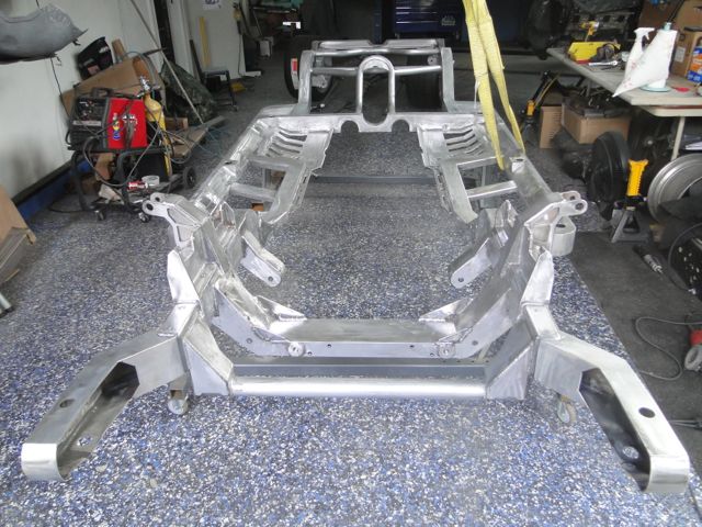

      Chassis Prep

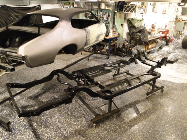

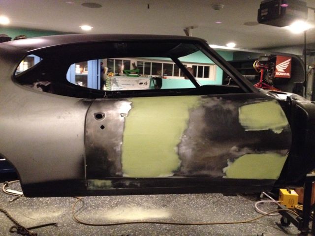

      Mike it looks and sounds great! Nice work! Cool that your Dad loved it, my Dad said he is first in line to go for a ride in mine too.

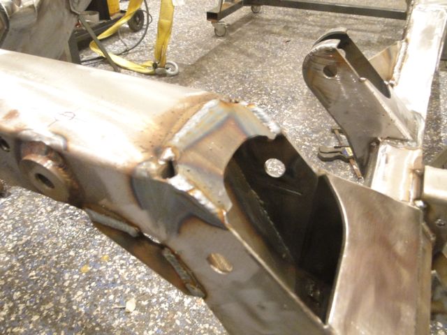

      I have been keeping busy getting the major bodywork straightened out and the frame ready for paint after a few gusset plates.
Size:  48.9 KBName:  DSC01082.jpg

      Andrew don't sell yourself short, I still hop over to your build thread to steal ideas from your GTO!

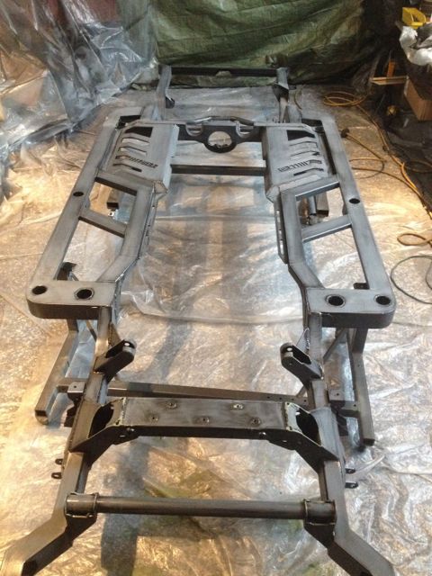

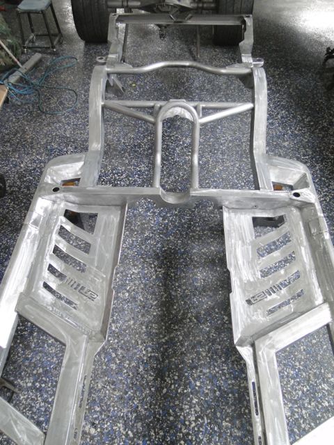

      Hey Mike, yeah the extra gussets are probably overkill but I can blame them on my Dad and his military philosophy to plan for the worst then expect the best. SO I plan on hitting a typical New England pothole once in a while, you might not have them in California but around here they can do some real damage!
      Frame was a full 12 hours to clean and get the primer on.
Size:  82.8 KBName:  DSC01188.jpg
      Now I need to hit all the suspension and rear end.
Size:  79.9 KBName:  DSC01190.jpg

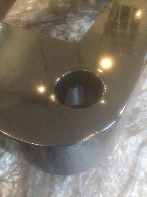

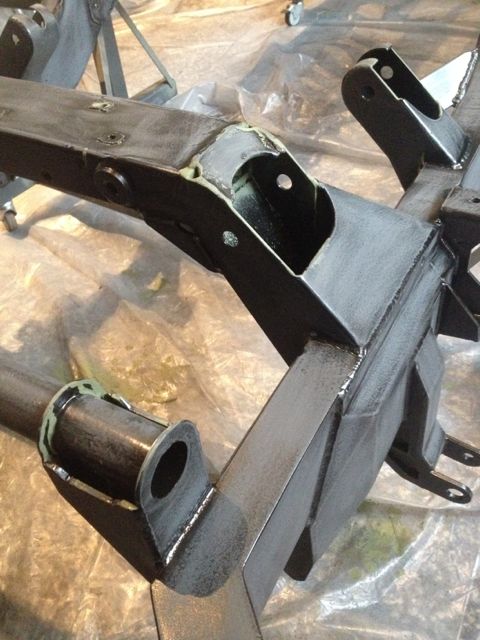

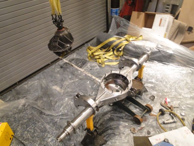

      Hey Gus, yeah a cheap gun is what I have used to get the SPI epoxy primer on and it worked fine, I am no expert painter but for the quality level I am after it looks ok.
      For the SEM Rust Shield frame paint (Gloss with Hardener) I struggled with finding a good spray pattern, it is a thicker paint and they recommend a 1.6 tip and I only had a 1.4 the stuff went on a lot different, very sticky and took a long time to lay flat. Maybe with the right equipment it would have been easier? Wondering if anyone else used this paint and if they had luck with adding reducer?
      Looks ok though, just don't get too close, haha!

      Internal Frame Coating, Sanded Primer
Size:  73.0 KBName:  IMG_1416.jpg

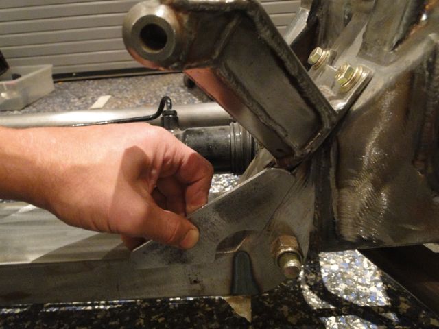

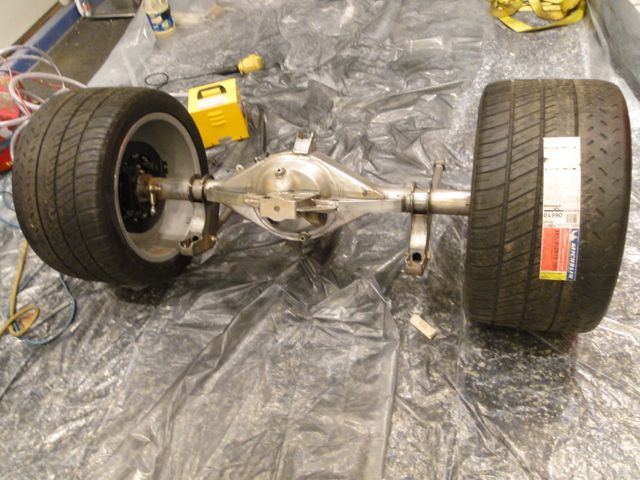

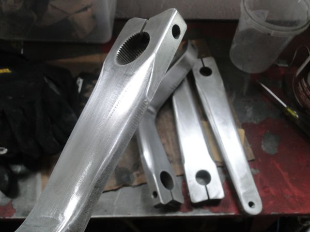

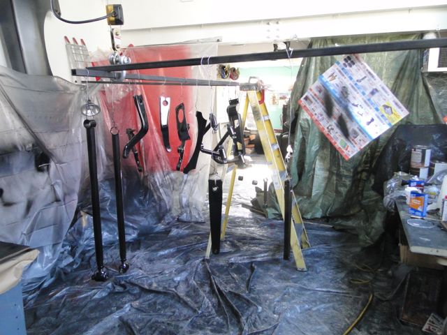

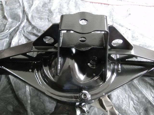

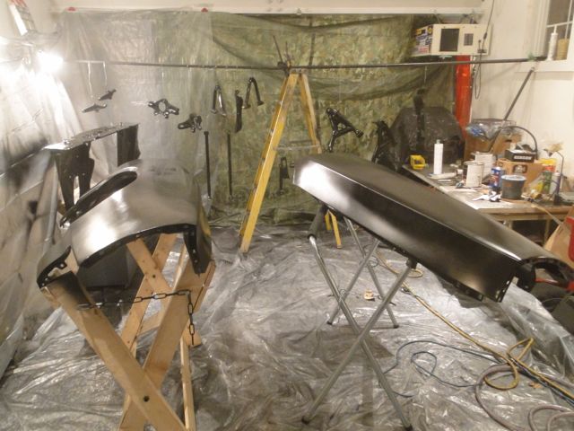

      Thanks Wayne, hows the Camaro coming along? I also have back troubles, so using the hoist and chain falls when I can really helps!
      So time consuming sanding and prepping all the suspension and rear end. Ground a radius on sway bar arms.
Size:  64.7 KBName:  DSC01213.jpg
Size:  64.0 KBName:  DSC01211.jpg

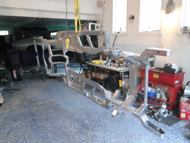

      Making some great progress Eric. Frame looks great. I'm sure the diff will look just as good. Yeah, I can see why it took 12 hours for cleaning and prep. Lots of metal to cover there.
      I'm Curious.....Did your RS chassis arrive disassembled or did you take it apart before prep and paint?

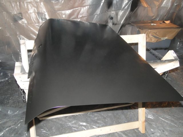

      Hi Gus, yeah it came assembled check out post #109

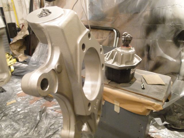

      Had good results reducing the Rust Shield with Xylene, adjusted the air at the gun up a little to make it easier to spray. 3 coats on all the suspension, rear end and underside of body.
      Went with a gallon of flat then added the hardener which brings it to a semi gloss.
      Tried the Eastwood 2K high temp cast gray on the spindles.
Size:  70.3 KBName:  DSC01232.jpg
Size:  56.3 KBName:  DSC01226.jpg
