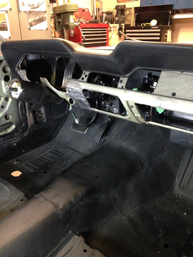

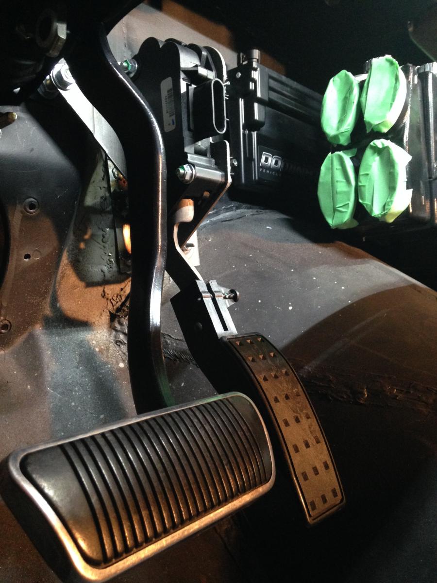

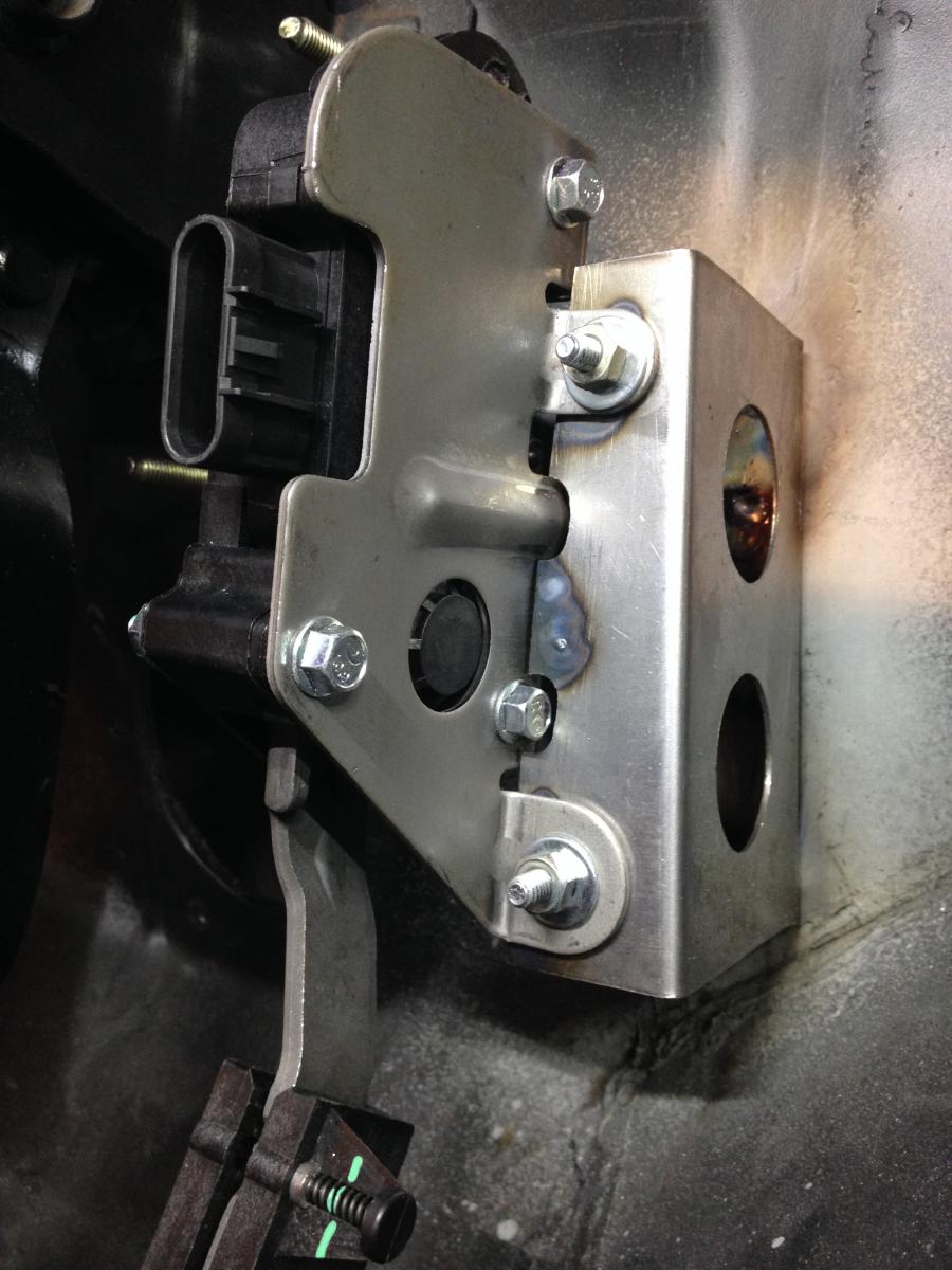

      I've been working under the dash lately installing the Vintage Air A/C unit and the Holley Dominator EFI ECM . Plus I fabed up a mount for the GM DBW pedal .
      Next up is mounting the American Autowire fuse panel .

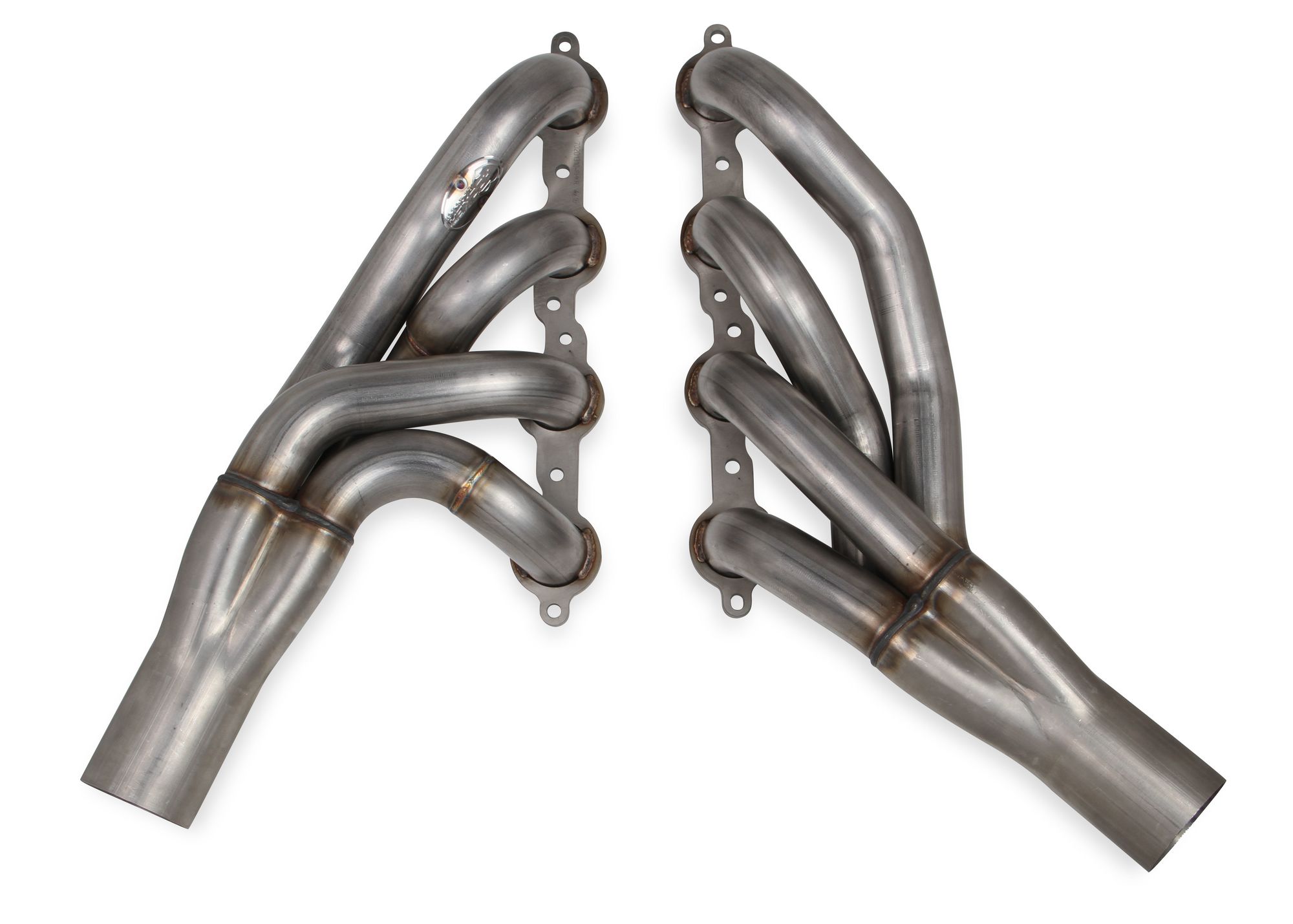

      I bolted the engine & trans back in this weekend so that I could figure out where to cut out two 2 1/4" holes in my smoothed firewall . One for the engine harness and one for the trans & DBW harnesses. I've also come to the realization that these Kooks headers hang to low for my liking . Even after I went to all the work of modifying them to clear the steering shaft , they're just not going to work . It was a gamble from the start that they would work , sometimes you just have to bite the bullet . At least they'll look good hanging on the shop wall , I'm looking at a pair of shorty/mid length units that should do the trick (fingers crossed .... again).
    20. #120
      16,129
      Hooker is coming out with some new stainless mid-length headers for 68-72 a-bodies. They may do the trick!
