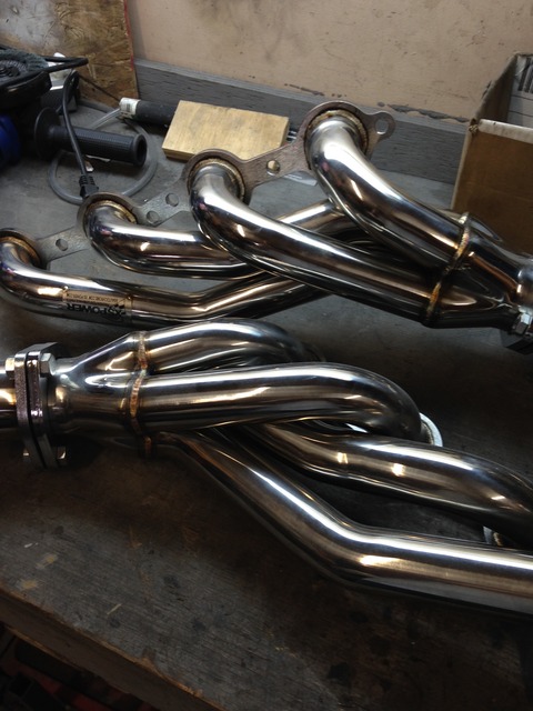

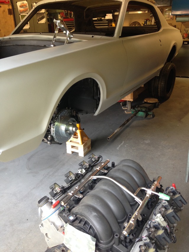

      Thanks Andrew , Since I took a high $$$$ bath on the Kooks header gamble . I decided to take a low $$$$ shot at a pair of Chinese ebay stainless 1 5/8 primary LS swap short tubes . I've got to say that I'm very happy with the quality and fit of these pipes . Sure , their not going to make the same power as the Kooks by far but they work for me . Ground clearance is not going to be a problem at all . I've purchased a pair of v-bands and 45 degree 2 1/2" stainless elbows which have worked out just great . Job done .

      Those look very similar to the headers I put on my Falcon. I was impressed with the fit and finish--they looked a lot more formidable than the last set of Hedmans I put on the last Ford engine. I've yet to heat them up, though . . .

      i have Chinese headers on my truck, they turn very ugly once you get a splash of water on them while hot so i'd recommend having them ceramic coated

      Sanding the poly-surfacer , built a bracket to hold the Alpine stereo & amp , planning the mounting bracket of a Lokar trunk release lever , and pulled the engine and trans , again ! . I shaved the trunk lock and installed an Electric-Life power trunk release , so I thought it would be a good idea to install a manual release inside . In case the battery goes dead , which will be in the trunk . I'm planning on using a Detroit Speed battery relocation kit . I decided to go with the B&M Quicksilver shifter . I don't plan on using it as is . I want to fab up some type of console . I think this will be a good project for the winter months . My plan for the summer will be to hopefully spray some primer sealer, basecoat & clearcoat on this thing . I'm still trying to decide on a final colour , It will be in the silver to grey field of colours .

      I will be installing the DSE Quadralink rear suspension . You pretty much have to go with a four link with this mini-tub kit . So far I've installed the DSE frame connectors , mini-tub and torque boxes .

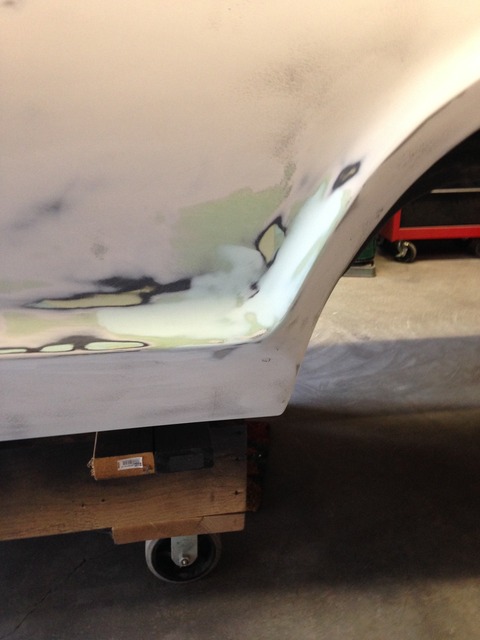

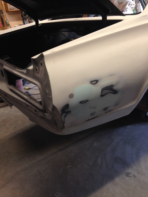

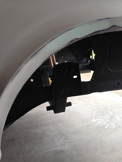

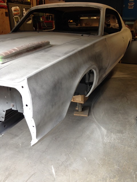

      I sanded the first coat of poly-surfacer after applying a guide coat and decided another coat was needed . I also noticed a couple of areas that needed a little more work . So I looked after them and sprayed on another coat , applied guide coat and I've sanded over half of the car . Looks good . Body work can drive a man crazy , I realize that I'm picky and I also realize that I'm not a bodyman by trade and that a lot of people wont notice the little spots that I do . So I've decided "good enough" or this machine will never get finished . Once I'm finished sanding the poly-surfacer (which will be very soon) , I'll spray on some 2K urethane primer surfacer , sand that nice and smooth , then spray on some paint . I just have to decide on a final colour (colour, yes I'm Canadian) . My plan has been to have it painted by the end of summer . Fingers crossed
