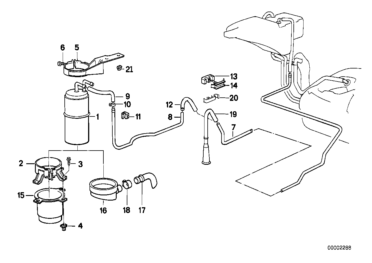

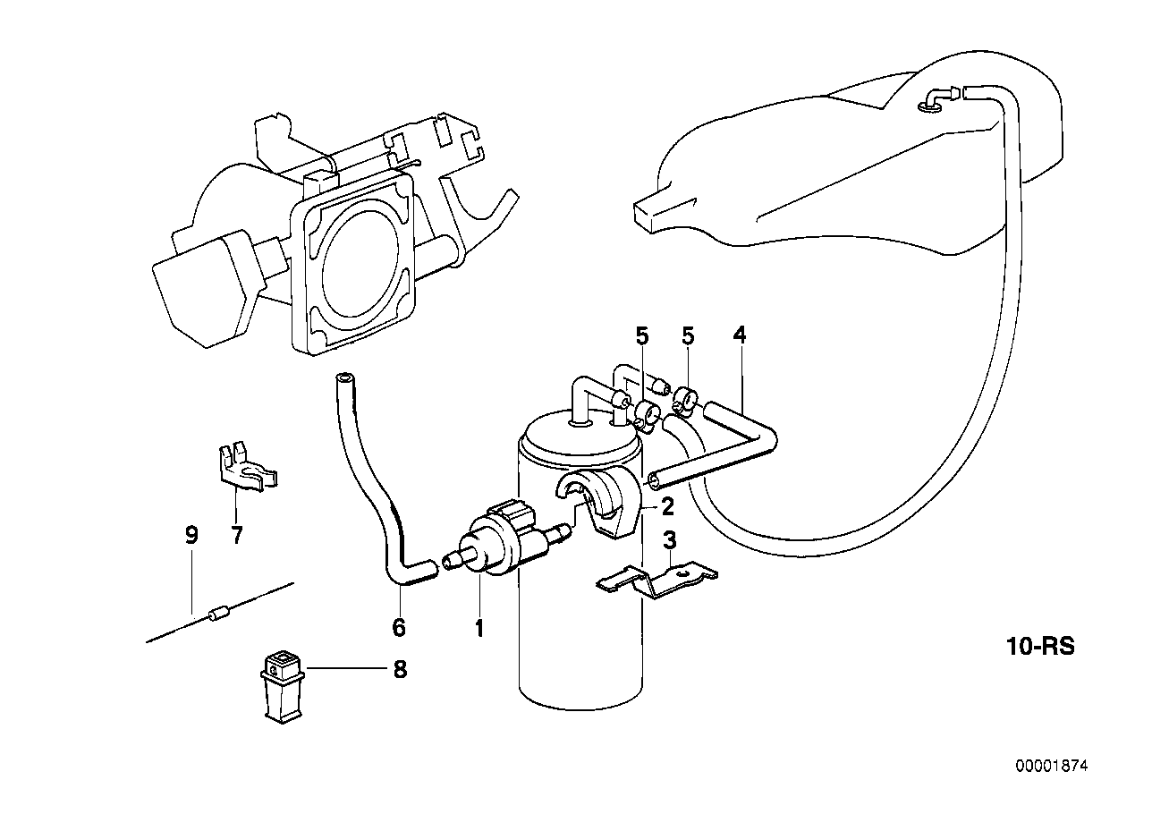

    7. #307
      16,129
      Looks like BMW has some sort of tank mounted above the gas tank, then a line goes to the charcoal canister.
      Another diagram showed said canister being purged into the intake via a purge solenoid.
      Looks like it is nearly $300 new...not happening on my junk.

      16,129
      By purging into the intake you draw fresh air through the bottom of the vapor canister. By doing that the charcoal is "cleaned" of the fuel vapor.
      The Tanks way of doing it is simple, but very stinky.
