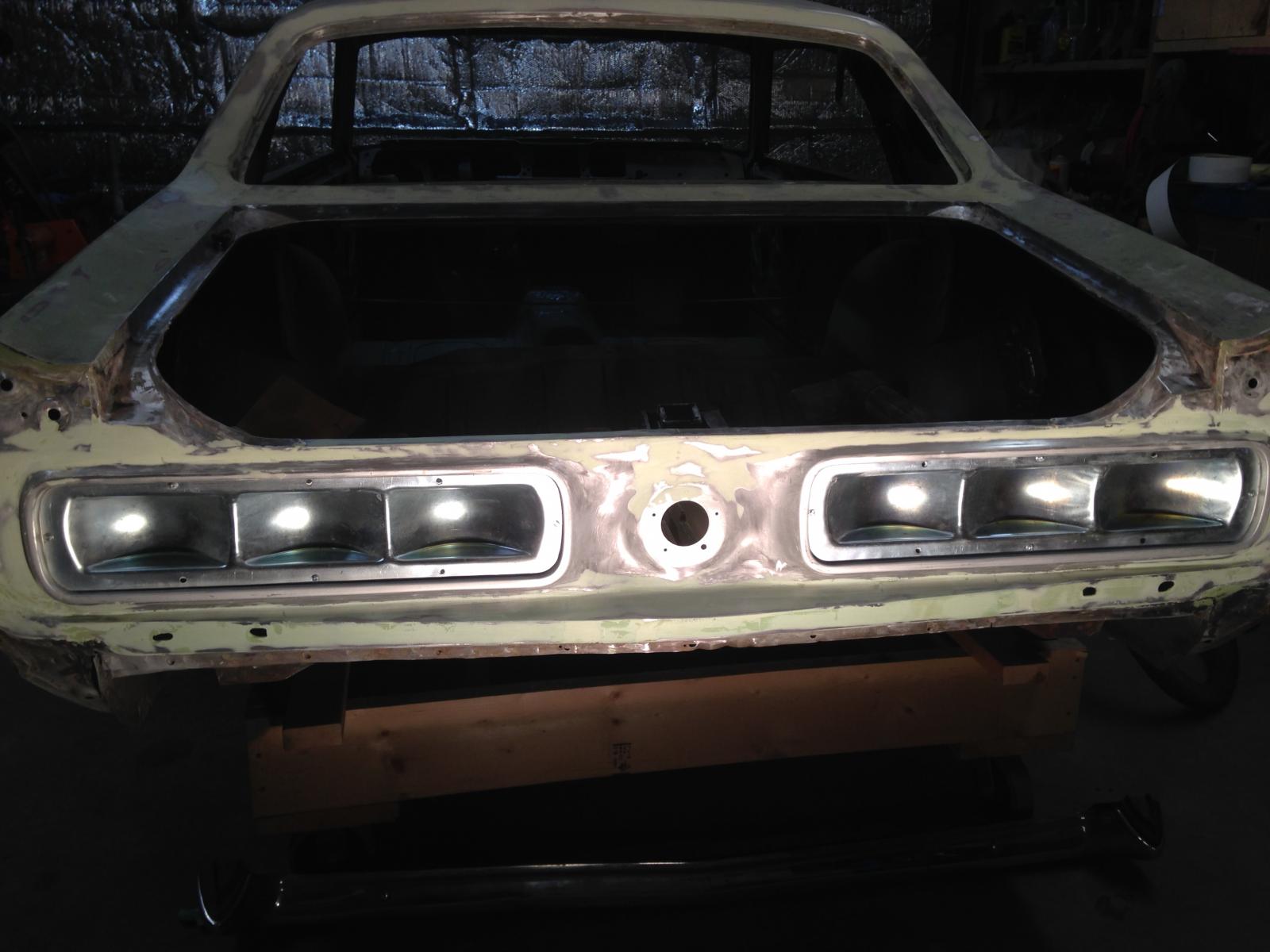

      I've just about finished grafting in the Shelby taillight panel , a little more sanding to do. Here you can see what I mean about the Cougar taillight assembly being heavy on the eye compared to the Shelby piece.

      Nice project. Looks like you have a quality car to start with. Why not a Ford engine? Looking forward to the build thread. Keep the pic's coming.

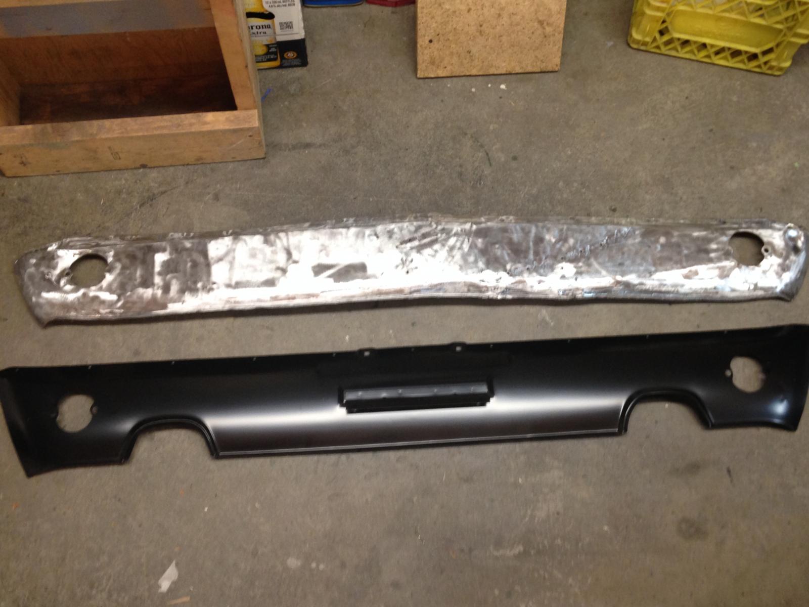

Size:  160.1 KBThanks Wayne . I thought that I'd start on the rear valance today . My plan is to combine the stock piece and again a 68 Shelby piece . Originally I was just going to graft in the exhaust cut outs but when I stripped down the original valance I found lots of filler . From the back side I could see that there was a crease and filler poking through a half dozen holes ( lazy body man ). I believe that I can get the Shelby piece to work , it's going to take some metalwork but hey I've got the time and material . Also by using the Shelby valance it has the license plate mount , the Cougar had the plate between the taillights which I lost by going to the Shelby taillight panel.

      Well I put the Shelby valance under the knife today and it looks like it's going to work out fine .

      I got the valance all figured out and I'm very happy with it . I installed the rear bumper , fender extensions and trunk lid just to get a look at things . Next job is to get the bumper to fit better , it's twisted and the top and bottom sides is in need of straightening out . Bumper jack damage I presume . The bumpers will be painted body color .
