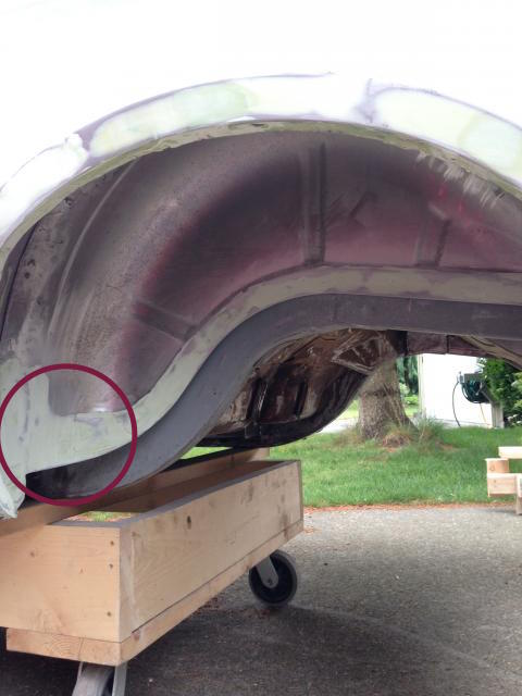

Size:  76.6 KBName:  IMG_5737.JPG
Size:  69.9 KBName:  IMG_5738.JPG
      Here is what he is referring too. There is also space being robbed towards the front of the wheel well where narrows up front away from the frame. See below as well
      I'm looking at increasing this more towards the frame to square it up allowing more room.
      Langleylad just curious do you know if that is something that should be looked into widening as well? What size wheel/tire combo are you looking to stuff into yours?
    17. #197
      May 2010
      British Columbia
      509
      That is a large gap . You also see the difference in contour that I was referring to . The DSE tubs are shaped differently compared to these ones , designed for more clearance . I'm running Michelin 295/35/18 in the rear and they do get close in the front of the wheelwell .

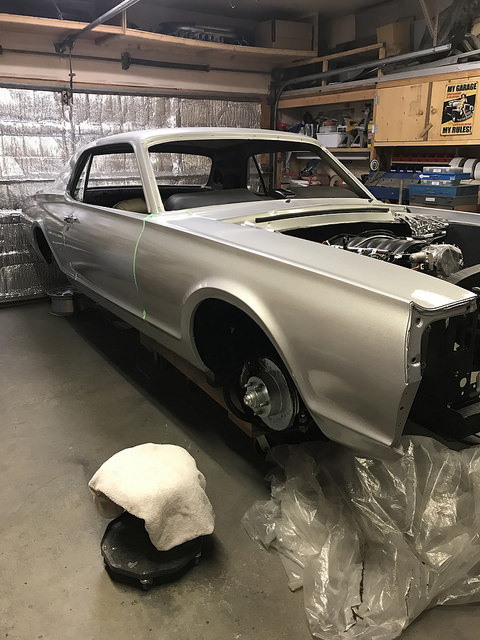

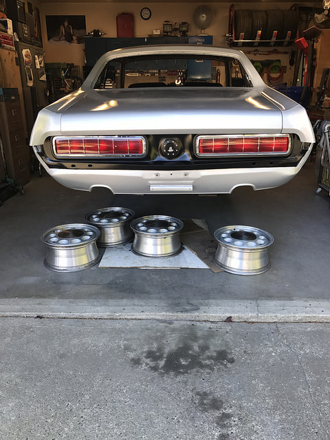

      Painting is done ! Considering that I painted it at home in the garage , I'm very happy with the outcome . Is it perfect ? No , but I didn't think it would be . I'm also very happy with how the Shelby tail lights turned out .
Size:  84.3 KBName:  36863474606_02735f442e_z.jpg
