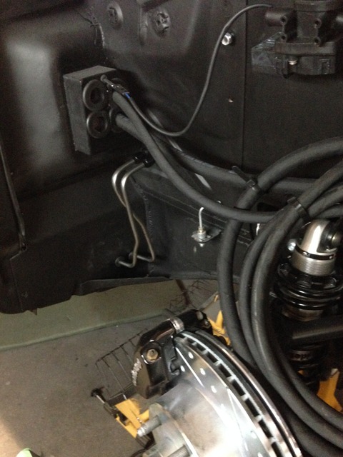

      I've been getting s##t done . I have installed 3/8 SS fuel lines from the passenger side front wheel well to just in front of the back tire where I've mounted a Holley EFI fuel filter. I'm also running a Areomotive regulator and Earl's line and fittings . Wiring is also an on going project . I'm also building a centre console ( early stages ).

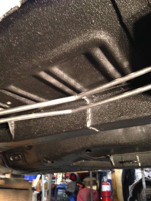

      This weekend I pulled the transmission so that I could spray most of the underside with POR 15 bed liner . I didn't spray the rear half as I have yet to install the rear suspension .

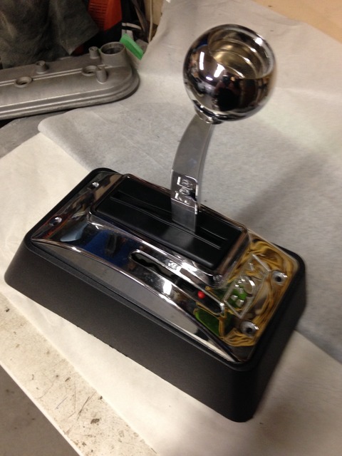

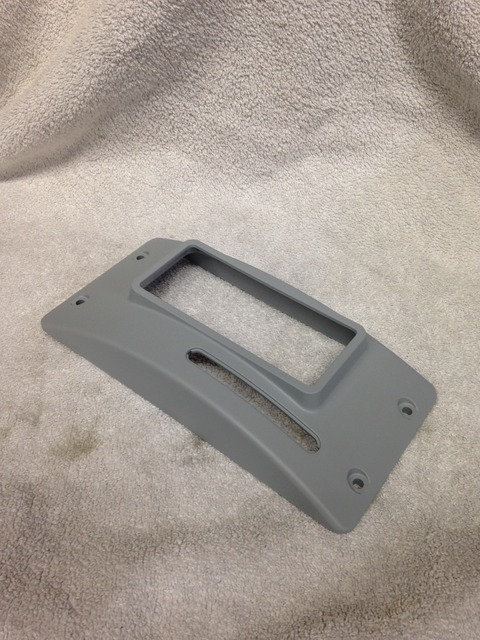

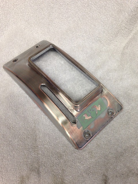

      Here's some mods I've done to my B&M Quicksilver shifter
Size:  117.7 KBName:  IMG_0977_zpsg3zshhh7.jpg
Size:  115.8 KBName:  IMG_0980_zpsrfpyr7nk.jpg
Size:  85.2 KBName:  IMG_0974_zpshzfo0pp8.jpg
Size:  118.1 KBName:  IMG_0979_zpsgwfduuqz.jpg

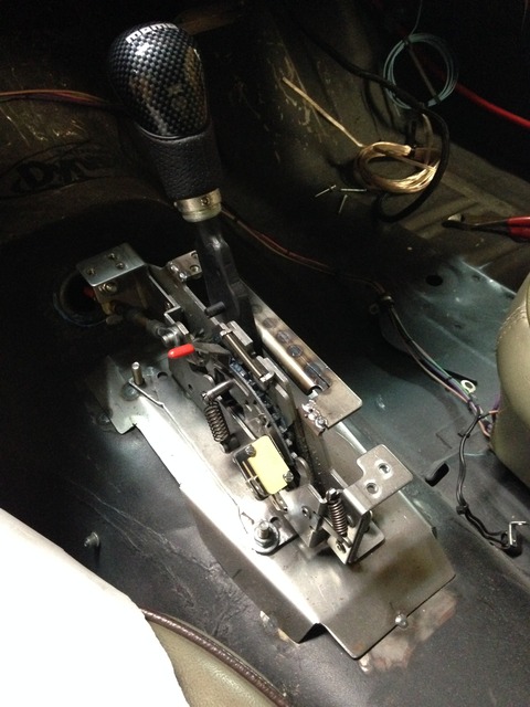

      Can you post some pictures of how the shifter is actually mounted to the trans tunnel?

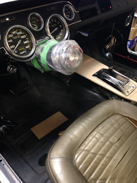

      *edit* I see in previous pictures you're going to have a nice console to hold the shifter...

      Thanks for the kind words Andrew , you're too kind .What I did here Andrew was fabricated a mounting plate and tacked it to the tunnel . This gave me a flatter surface to mount the shifter too plus it raised the shifter up just a bit .
Size:  84.4 KBName:  IMG_0987_zps8jjtx7eo.jpg

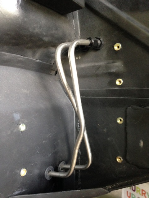

      This weekend I fabricated a rock guard for the fuel lines and continued on the centre console . I've mounted the Vintage Air A/C controls in the console and I plan to install two more A/C ducts in the front part of the console
      .Name:  IMG_0991_zpsg2kudza3.jpg
Size:  81.1 KBName:  IMG_0995_zpsvlqotbzu.jpg
Size:  105.6 KBName:  IMG_0997_zpscggzcbkb.jpg
