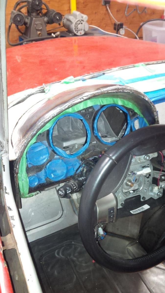

      Spent some time on the beater bag and the planishing hammer this morning.

      I just have a cheepo unit, similar to the Harbour Freight one. I did most of the work on the beater bag, then finished it up on the planishing hammer. I'm building a mid year vette dash because I don't want to pay the ridiculous prices that people want for a scruffy old used one. More photos to come.

      Another photo of the dash under construction.
