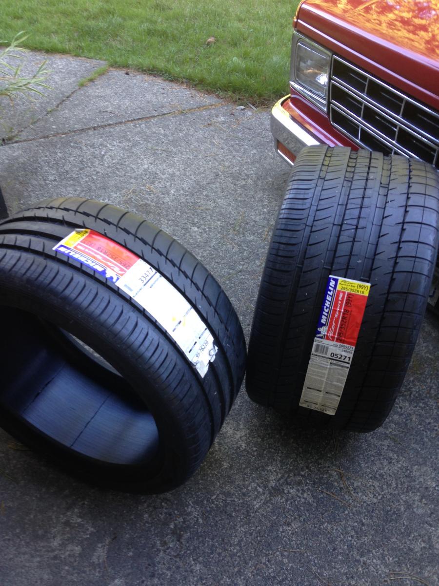

      Oh ya ! , these will do . I'm sure glad that I went with the 295's and not 315's in the back .

      There are "affordable" options out there, especially in the 5x4.5" pattern. My "track" wheels are aftermarket from Late Model Restoration. They are 18x9 front and 18x10 rear for 2 different year Mustangs. Cost $620 total for the set.

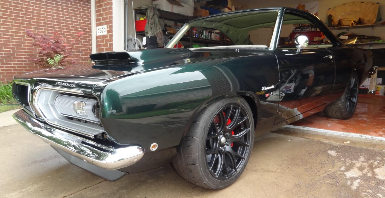

      Quote Originally Posted by langleylad View Post
      I'm leaning towards a dark silver/gray
      Black wheels would look good with that.

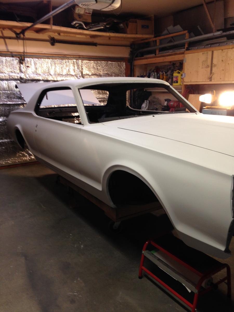

    20. #100
      May 2010
      British Columbia
      509
      Now in poly surfacer
