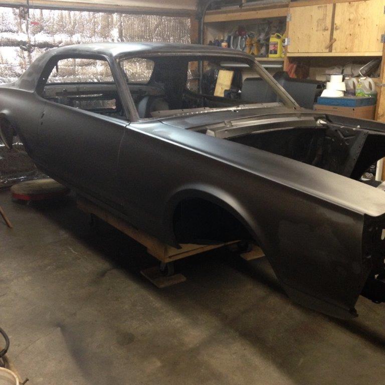

      I've put the tire decision to one side and I've bathed the Cougar in black epoxy primer . With the CDN dollar sitting at 75 cents American I think I'll be working with what I have at the moment . The DSE Quadralink rear suspension which sells for $3000 US is $4000 CDN , boo !
      Attachment 115945
      I'm so glad I'm done buying parts for my car, A 25% increase just plain hurts. Nice car btw!
