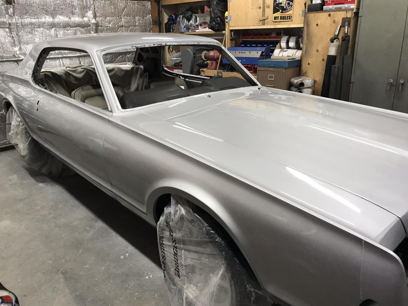

      Finally finished the color sanding and buffing !!! I've got to say that for my first DIY paint job in my small garage , that I'm very pleased with the outcome . Is it perfect ? hell no , any runs in the clear ? hell no , better than it was ? hell ya , going to win trophies in a show ? not going in any shows , proud of all my hard work ? hell ya ! is it hard work ? hell ya ! was it worth the hard work ? hell ya !!!

      Looks good from the pic on my 24" screen.
      I'd say something to be proud of

      Great job. I might be biased, but I think Cougars have way better design lines than a Mustang. The longer wheelbase really help the overall proportions.

      Paint looks phenomenal. If I were to paint any other color other than the current green or darker, I would be all about a silver just like that.

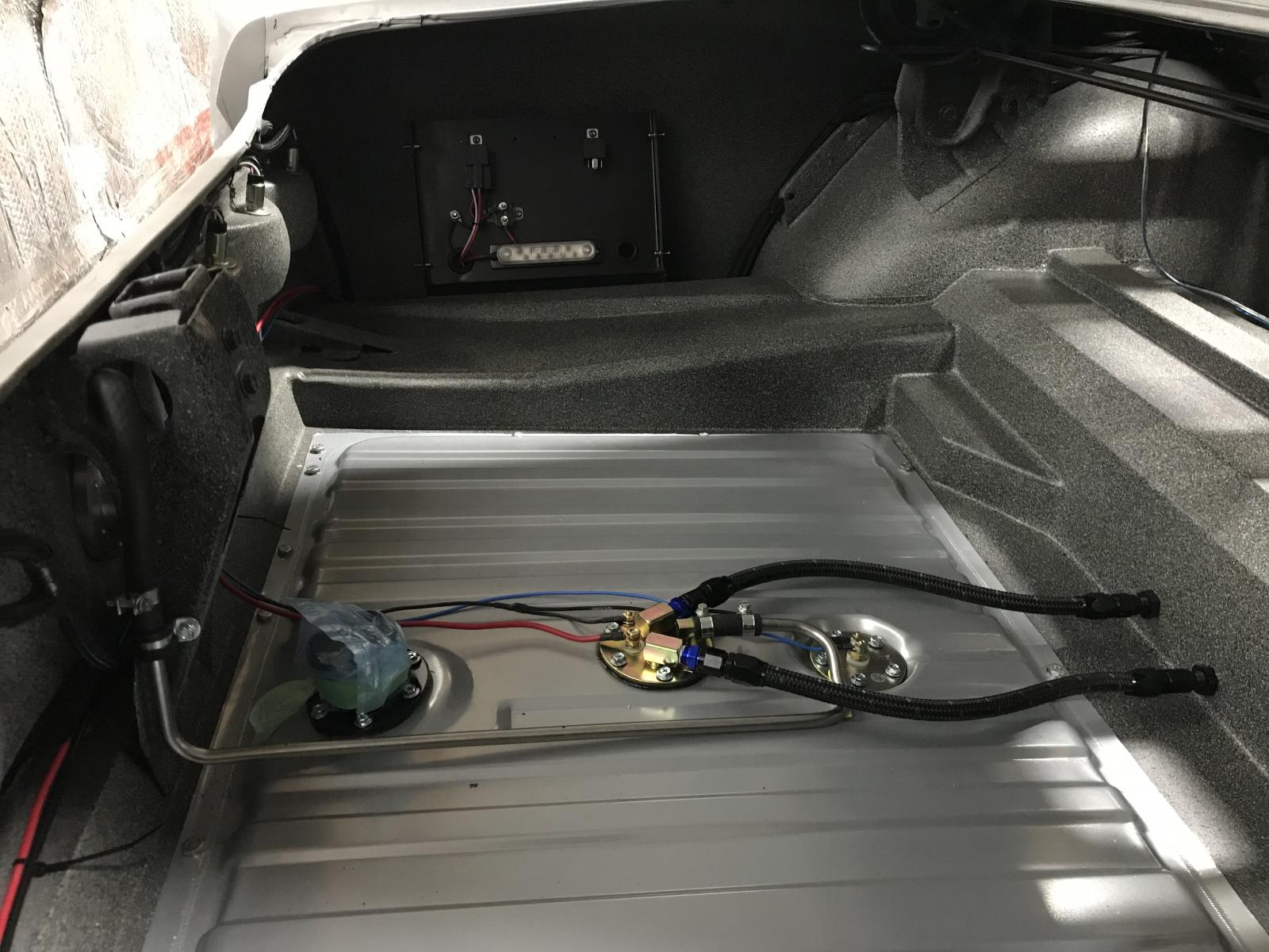

      Today I finished up the fuel pump/sender wiring . I built a electrical panel to mount the fuel pump relay and breaker plus whatever else that might need power . I'm sure it's overkill and not needed but who knows ?. I also plumbed in the fuel tank vent into the top of the filler tube with some 3/8 stainless tube ( leftover scrap ) . I bent up some trans cooler lines with the same tubing two days ago . Man ! that is one thing that will drive you crazy ! . You lay under the vehicle and measure and bend your tubing and try to fit it and bend again and refit and bend and straighten and rebend and through it away and start over and measure etc etc etc ...... It doesn't look as good as I want but this could drive me crazy as I said ! . I will cover all the wiring in Powerbraid .
      Attachment 155027
      Where is your vent going?

      Thanks guys !
      Because you asked Andrew and because I realize that you're one clever fella , you have me double guessing my set up . I have the vent tube plumbed into the top of the ridetech fuel filler , there is a port there to run a vent line too . Because you asked I'm thinking that this method is really not venting as the gas cap is sealed . I'm now thinking that I'm going to need to run a vent tube to the outside of the vehicle . The Tanks Inc fuel tank came with a vent fitting and instructions to mount it as high as possible . Your thoughts ....
      Well, ****. I was hoping you had a brilliant solution already implemented, hence my question! I believe you are correct in your assessment that your current configuration is not venting anything.
      My vent situation is not optimal. I have the vent going into the trunk and thus have a very stinky car. I was thinking about punching a hole behind the license plate and vent there, but I hate putting holes in perfectly good body panels. Obviously, this is not an option for you, because you have that fancy gas door and your plate is down on the valance.
      So....maybe someone else has some suggestion :-)
      Thanks for keeping me on the straight and narrow ... lol !
      Tanks Inc wants to see the vent as high as the filler neck but will be a PITA !
