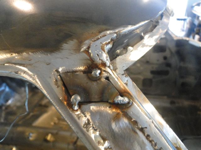

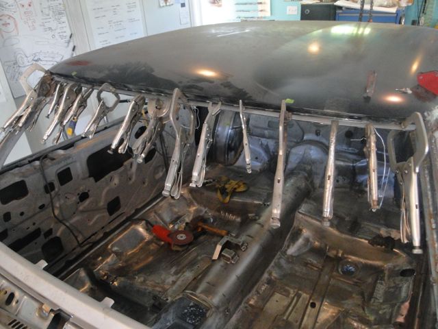

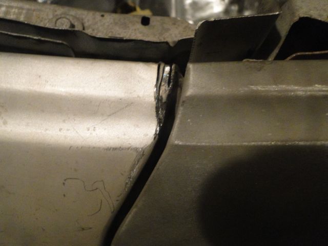

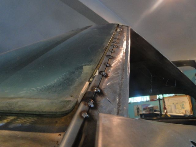

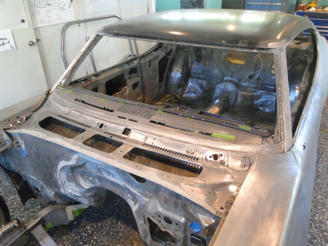

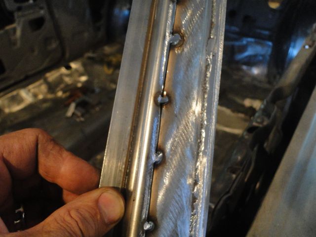

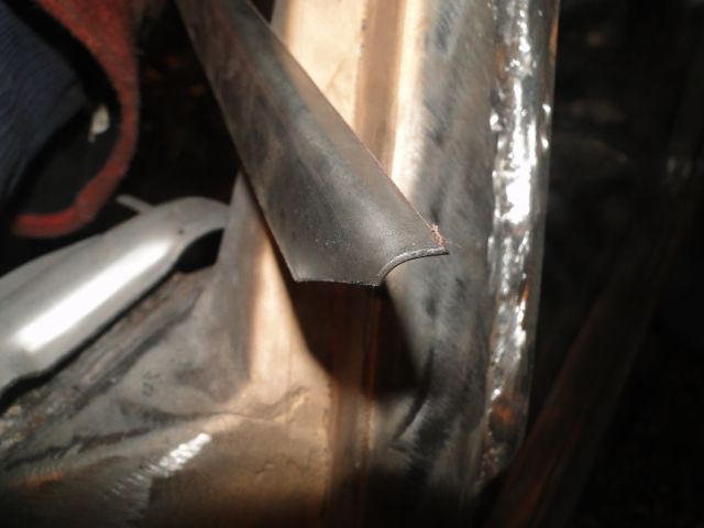

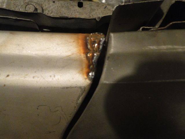

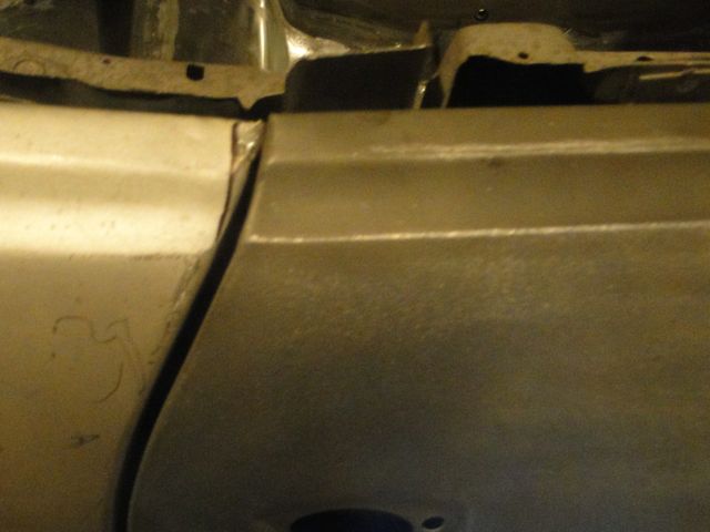

      Flush Glass
      Windshield brought up 1/8" and made up 3/8" x 1/2" strips for the sides.
      Pushed up bottom to match instead of adding anything on top.
      Also welded 1/8" x 1/4" strips to the outside of the A pillars to blend into the roof lines better.

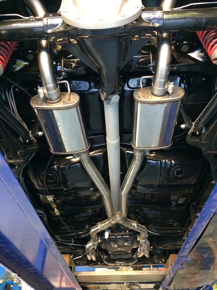

      Anyway, on to the news... I finished the interior! (Well, at least what you can see... still don't have a glove box, yet) Next step is bleeding the brakes so I can roll it into the sun and do a final QA on the paint.
      Talk soon...

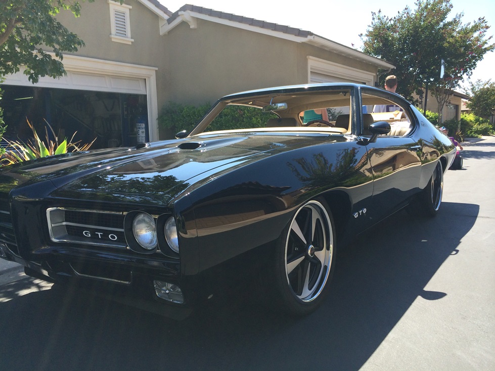

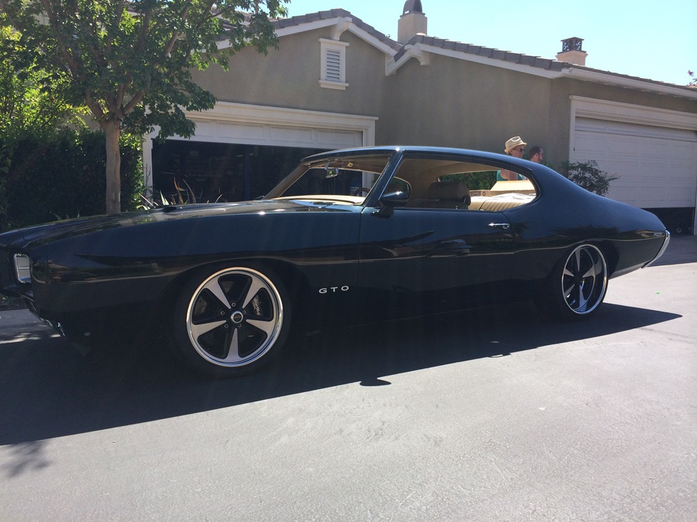

      Great work, as usual... I'm glad to see someone more Anal than me on here. (That's a compliment) Sooooo, you wanna see bare steel, huh?... here you go. As well as a teaser outside... Next time out, I'll get a better "sun" shot.
      Mike
      Attachment 103017Attachment 103020Attachment 103018Attachment 103019

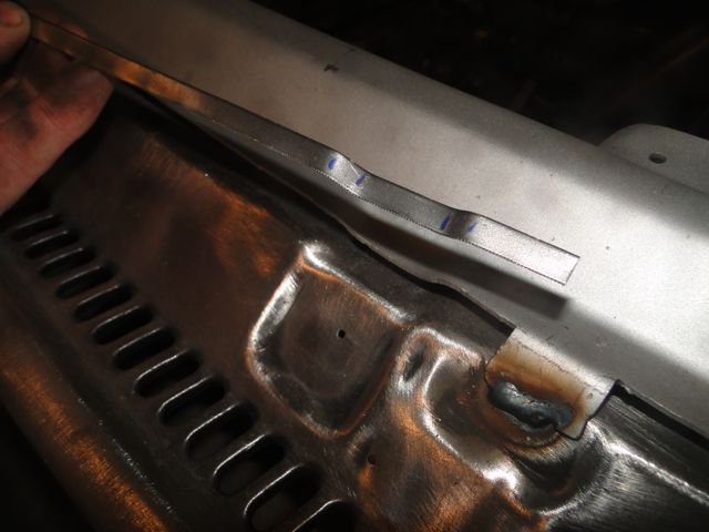

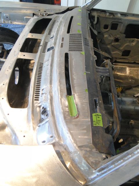

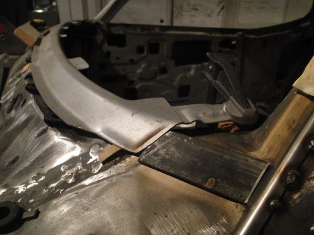

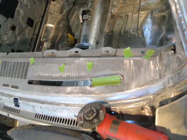

      dash
      More metal work off the list.

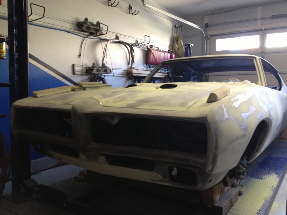

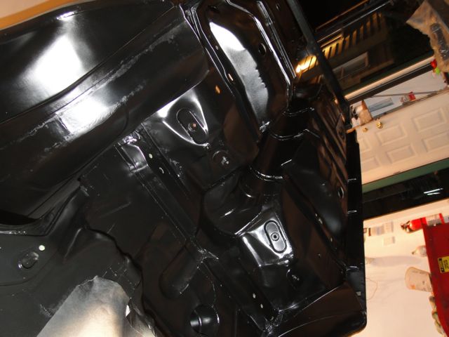

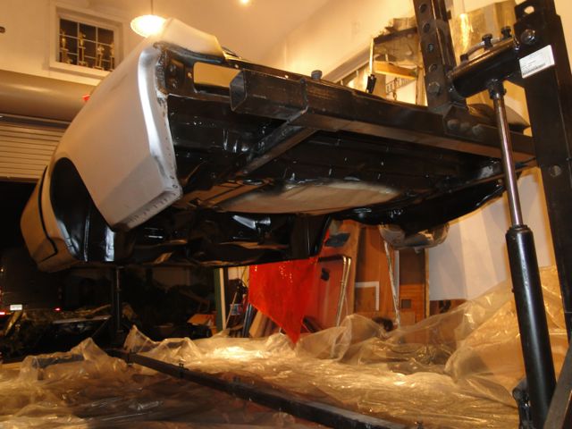

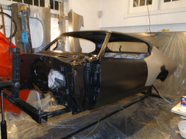

      Primer
      Thanks guys,

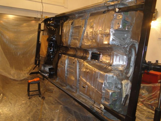

      Made some good progress and took advantage of the nice weather, was out there until 2 AM spraying the epoxy primer. So lucky I have nice neighbors!
Size:  60.3 KBName:  DSC01064.jpg
Size:  53.3 KBName:  DSC01068.jpg
      I still need to sand off the e-coat on the roof and the weld thru primer on the quarters the epoxy them too.
      Then the frame is next, I rolled it out into the driveway looked at the stars and then noticed it had rained on it a little later, had to re clean the whole thing again!
      Gus I like the new rendering, and the blue is cool.
