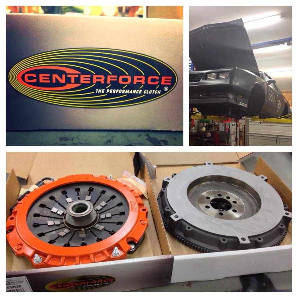

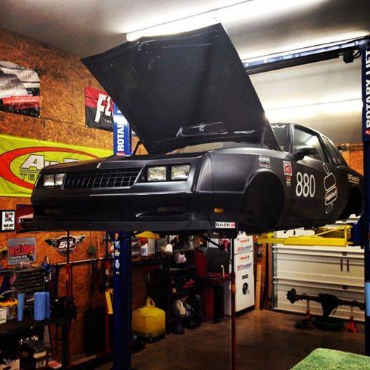

      Got my Centerforce Dual Friction clutch in and my balanced flywheel!!!
      Thanks to Centerforce for all their help with this project!!! This clutch is a piece of artwork!!!!
      Car is missing a lot of stuff now...time to get to work!!!!

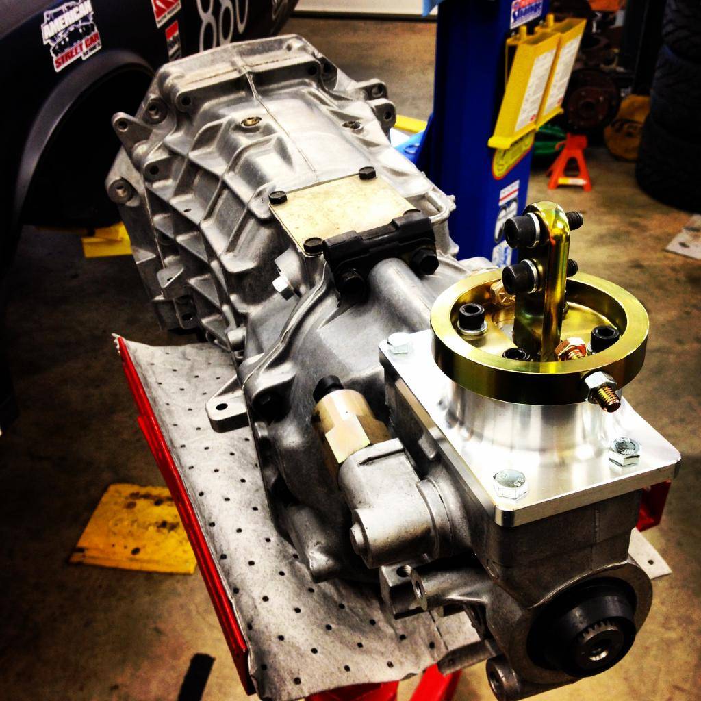

      Been a lil bit since I have updated the progress of the t56 install along with all my new suspension parts....that's bc not much has happened!
      here's the new shifter mocked up on the trans to see how it looks and fits.
