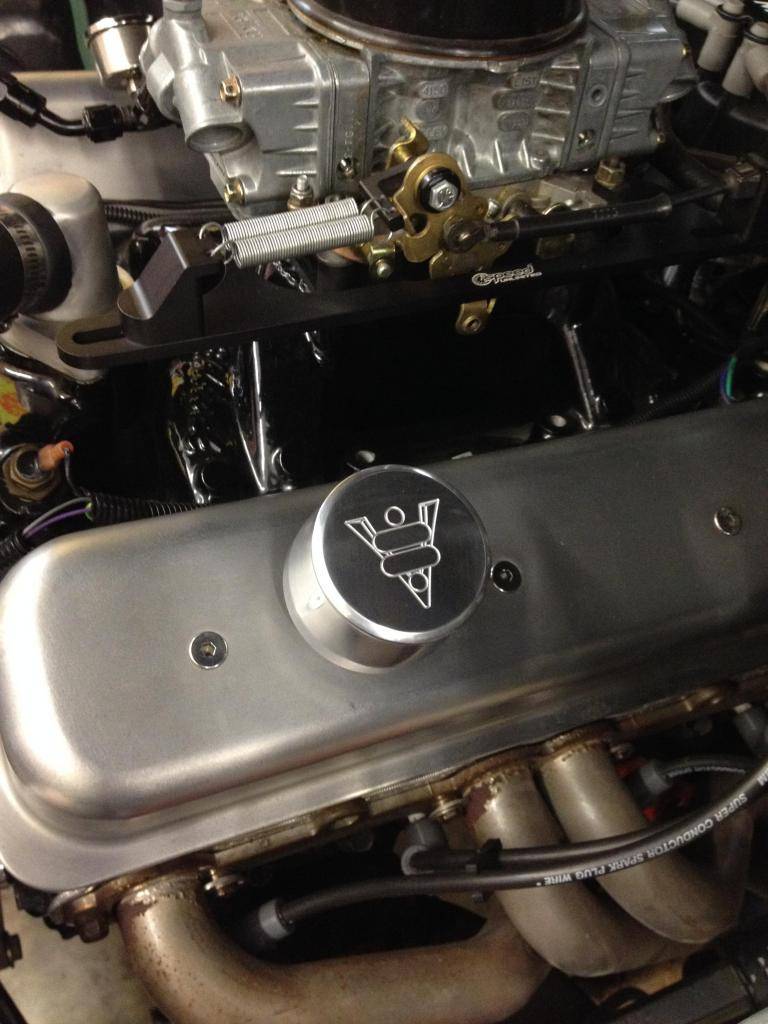

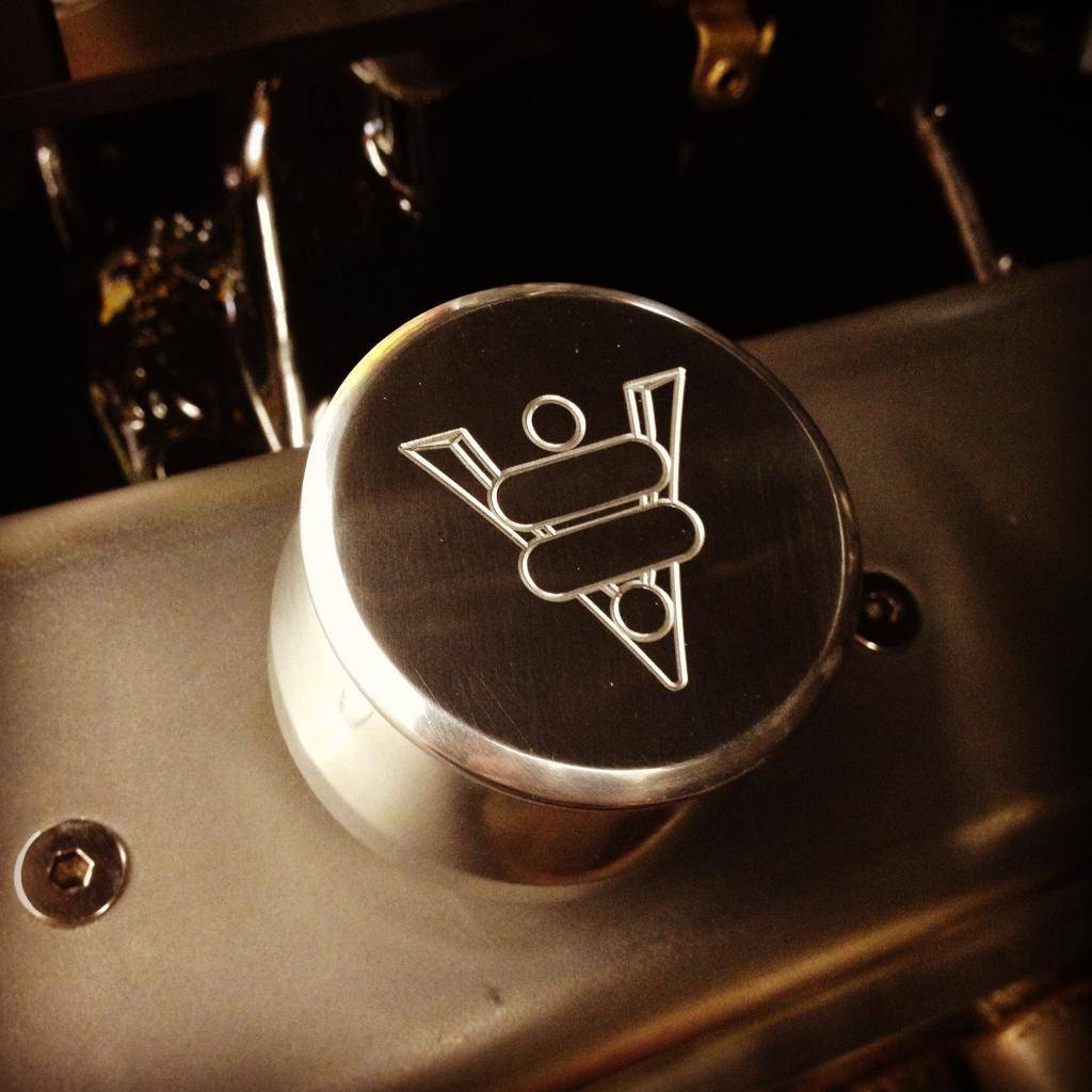

      The awesome guys and gals at ridetech custom machined their logo into this billet aluminum breather for me!! I just love the little custom touches!! Thanks again guys and gals...it's companies like you that keep us in this hobby!!!

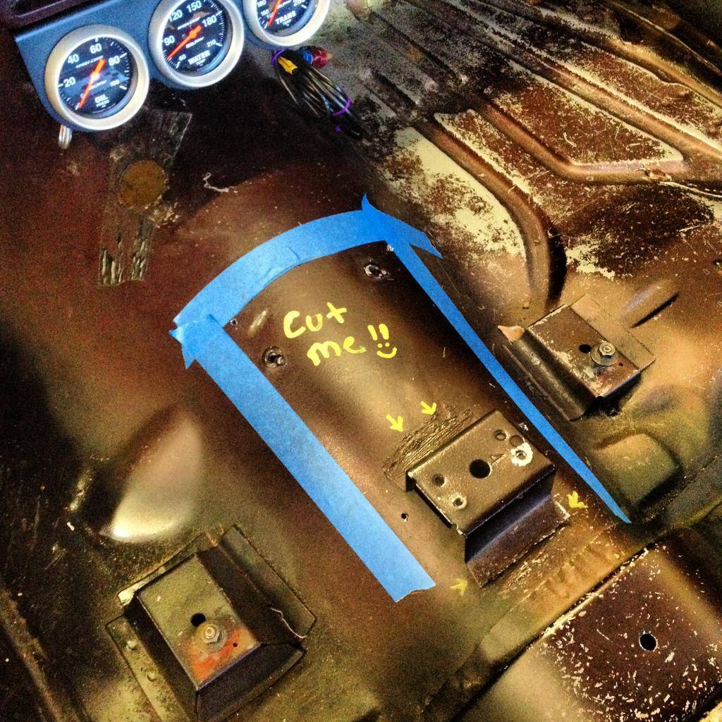

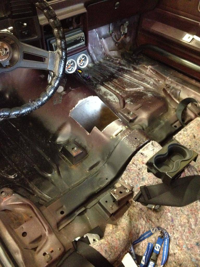

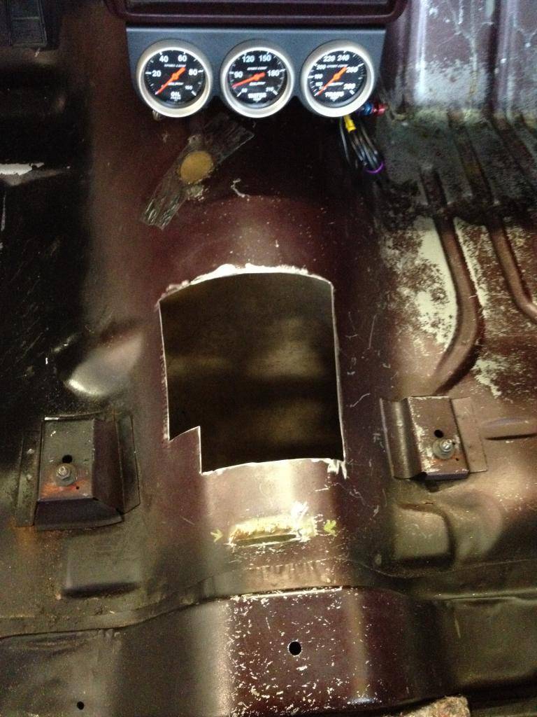

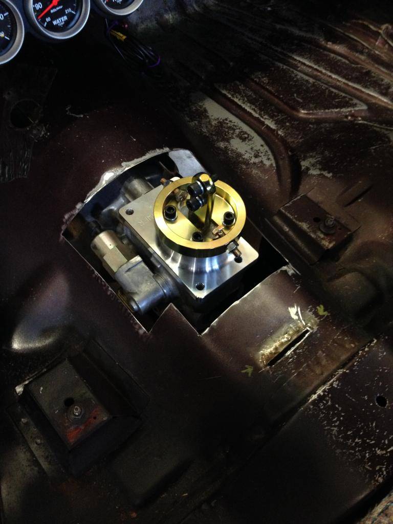

      Ok......finally getting some time to measure and cut the hole for the shifter.
      It's about time huh??
      Douglas Lutes
      1988 Monte Carlo SS
    5. #785
      Woodbine, MD
      2,770

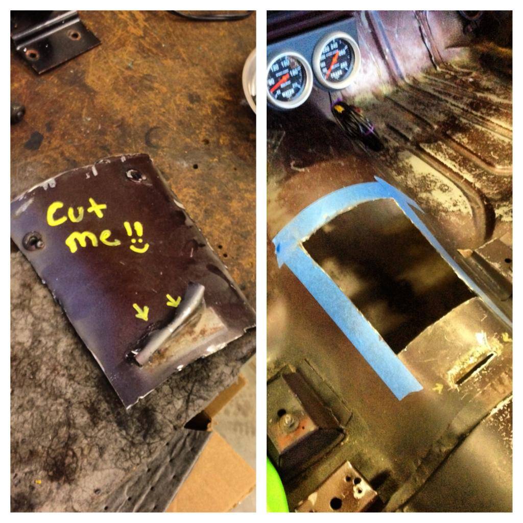

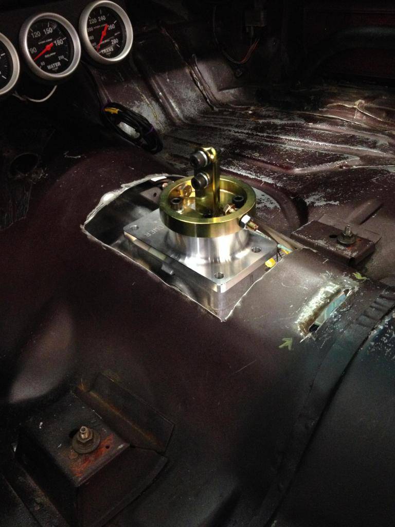

      The first "round" of cutting the floor.......
      Douglas Lutes
      1988 Monte Carlo SS

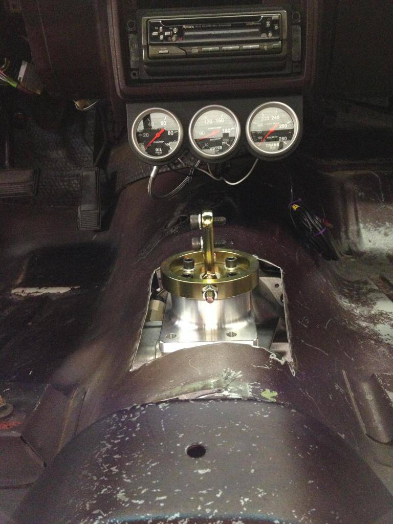

    6. #786
      Woodbine, MD
      2,770
      The reverse lockout thingy is very close and people have said to just use a hammer and beat the floor out of the way. I'm not doing that so we will have to trim some more and I will just make a sheet metal cover for it all once it's done.

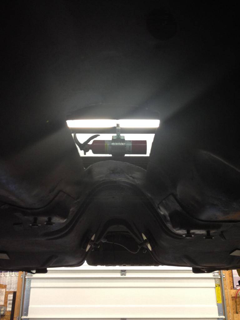

      Behold....the holy Fire Extinguisher!!!!!
      Douglas Lutes

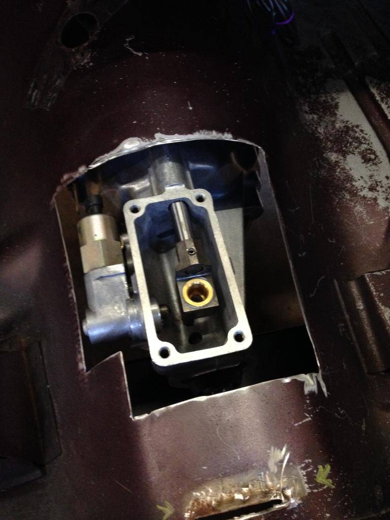

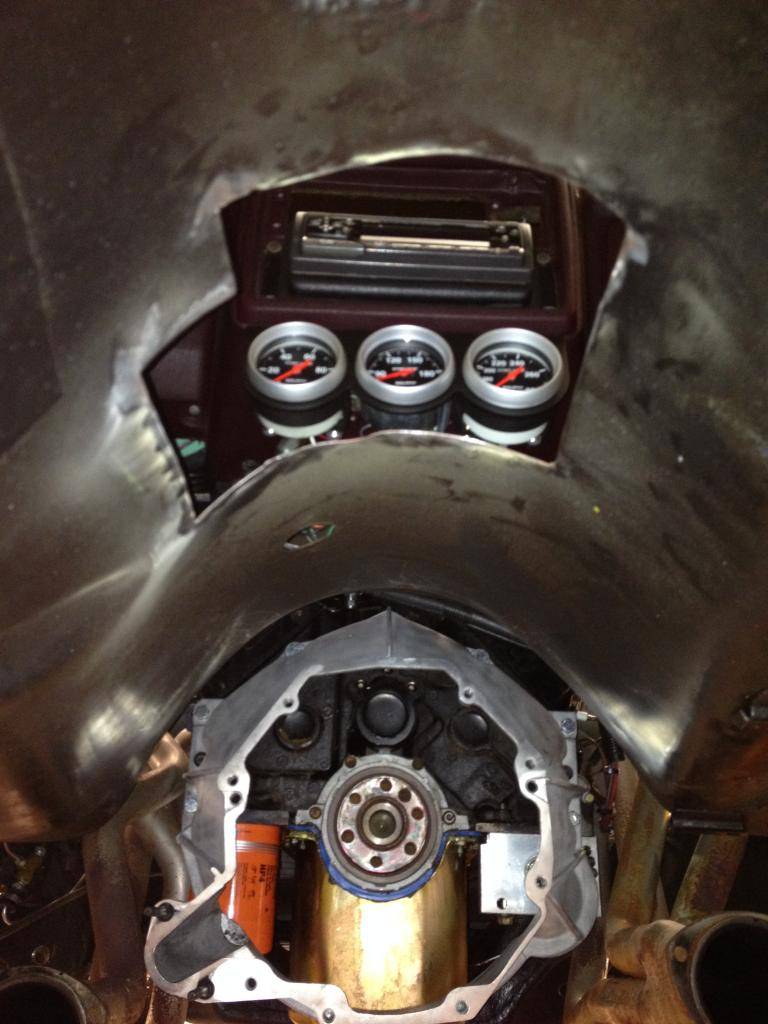

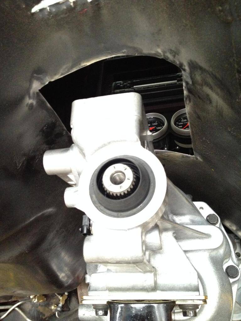

      So as stated above I needed to make a relief cut for the reverse lock out thingy (very technical term there).
      I used a Milwaukee 4" Sawzall blade in an air saw and it cut through the floor board/trans tunnel like butter!!
      Douglas Lutes

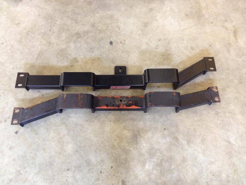

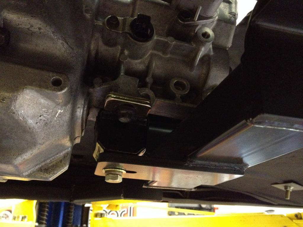

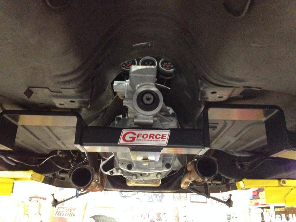

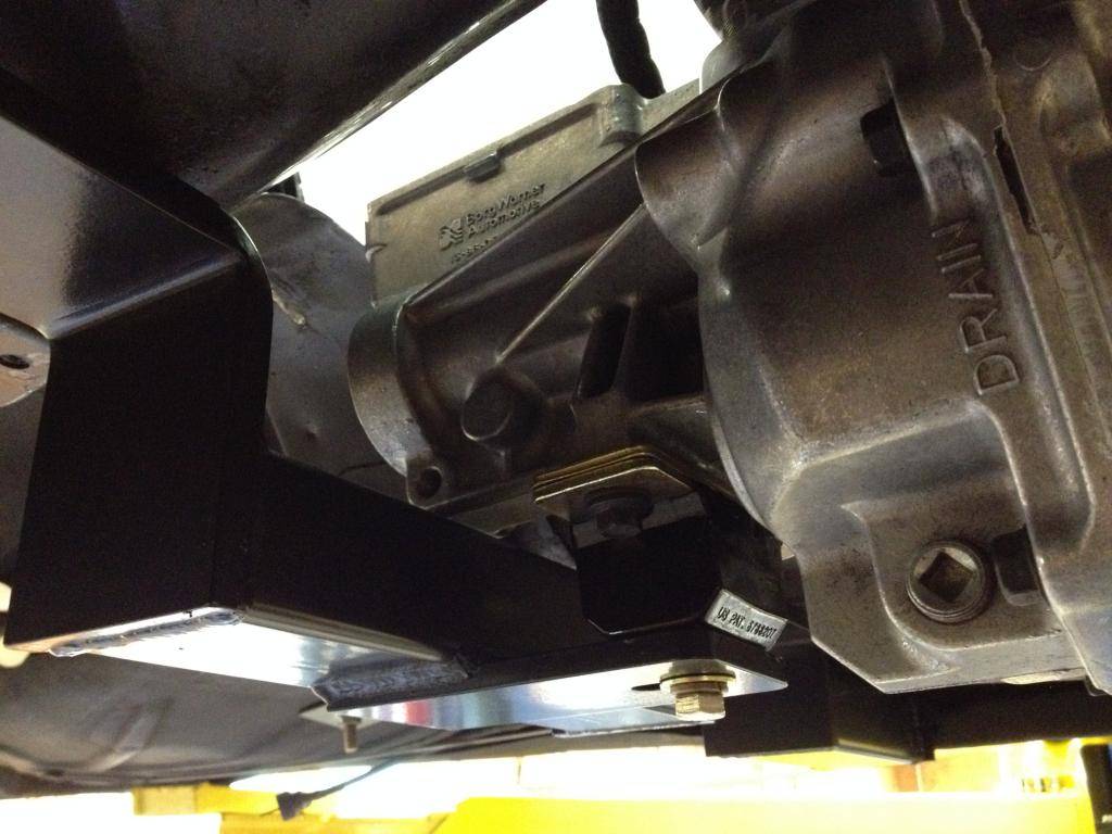

      Here's a comparison of the GForce ( www.crossmembers.com ) 200-4R and the T56 crossmembers. GForce states that the T56 crossmember was actually designed using an LT1 T56 and it fits differently with an LS style T56. Thankfully my T56 is the LT1 version. WIN!!
      T56 on top...200-4R on the bottom
      Douglas Lutes
      1988 Monte Carlo SS

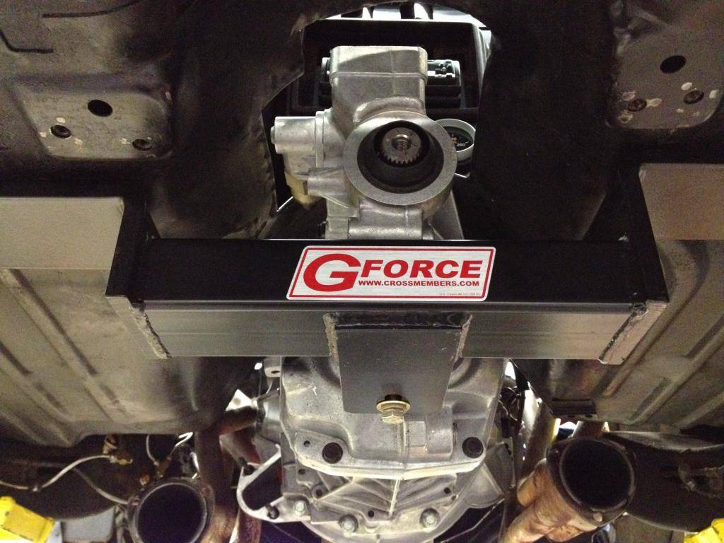

    12. #792
      Woodbine, MD
      2,770

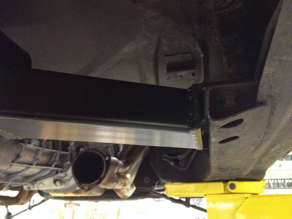

      And this is how it fits in an 88 Monte Carlo SS with a T56 out of a LT1 Camaro.
      Douglas Lutes
      1988 Monte Carlo SS
    13. #793
      Woodbine, MD
      2,770
      Plenty of room now!!!
      Douglas Lutes
      1988 Monte Carlo SS

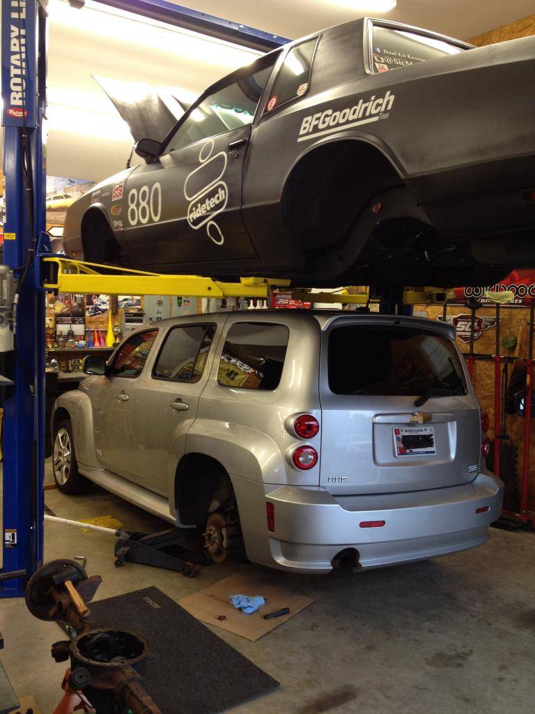

      This is why I haven't really worked on the car in the last couple weeks. Between traveling to events and getting other stuff done around the house and shop I haven't had any time to dedicate to the car. It's been a crazy summer!!

      1,758

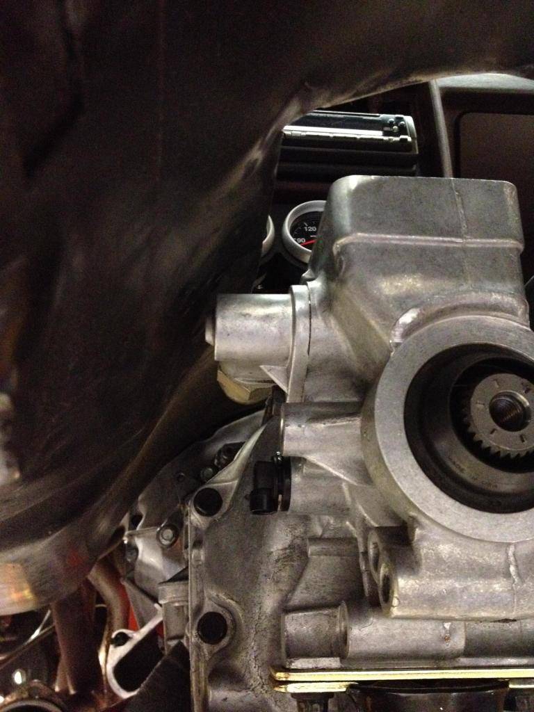

      Hey Doug, I really think you'll be happier with the results if you work on a way to raise the back of the trans at least an inch or so. You've got the room now, no reason not to do it. Go until the top of the trans where the rubber bumper is is just off the floor.
      Lance
    16. #796
      Woodbine, MD
      2,770
      Quote Originally Posted by SSLance View Post
      Lance,
      I did think that the trans was too low but the rubber bumpers on top are about a 1/16" away from hitting the trans tunnel. I remember from our conversations that this is where yours was at.
      I don't know why it is different but yes I agree that the trans does seem too low. If I raise it then I would need to do more cutting. We shall see.
      Douglas Lutes
      1988 Monte Carlo SS
    17. #797
      Aug 2012
      Peoria, AZ
      1,758
      How are your body bushings? Have you ever replaced them? Wondering if the body is sitting lower on the frame than mine?
      Lance
    18. #798
      Woodbine, MD
      2,770
      Body mounts are all new as of 2006.

    19. #799
      Charlotte
      1,295
      Are you going to be welding in some sheet metal to close out that hole at all?
      2014 Chevy SS LS3 / 4 Door
    20. #800
      Woodbine, MD
      2,770
      Quote Originally Posted by bonecrrusher View Post
      oh yeah for sure! Once everything is done I will make a nice shifter plate to mount the boot too.
      Douglas Lutes
