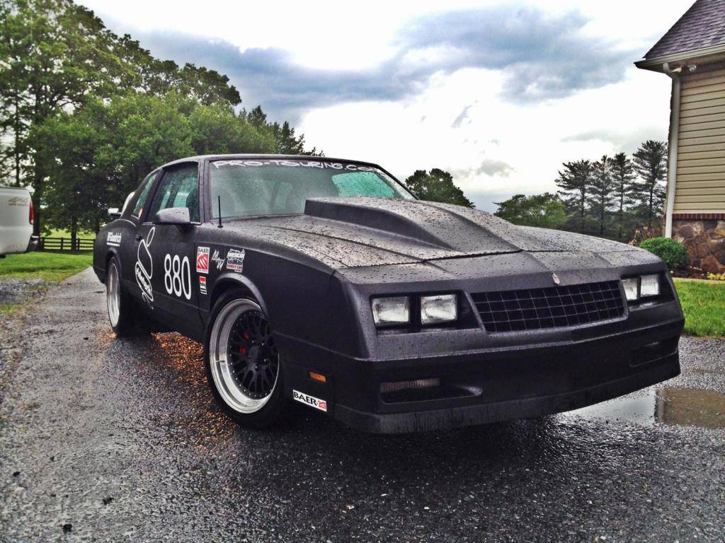

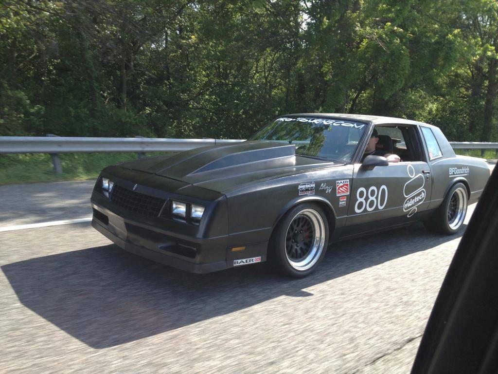

      On the way home from the trans shop I got caught in the rain......don't you just hate that????

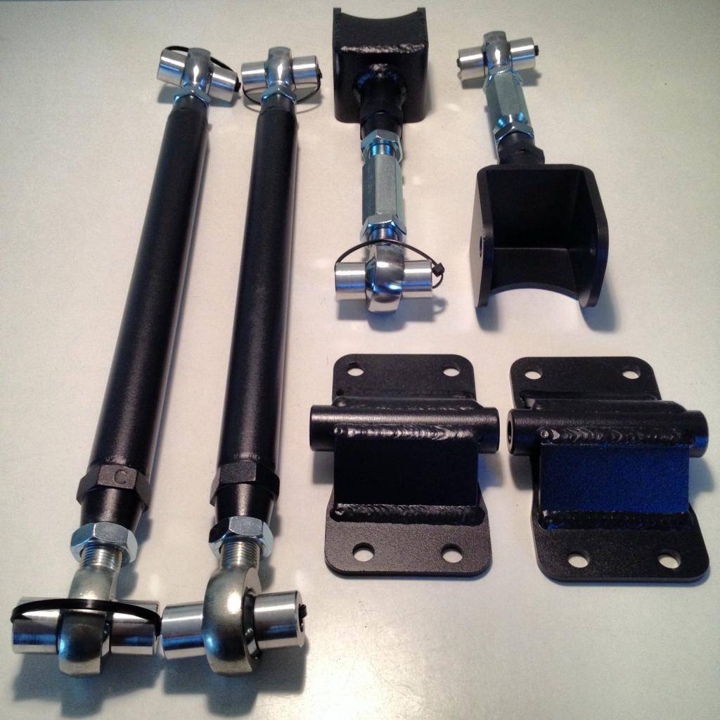

      I got a shipment from UMI the other day...full of goodies!
      Project SicMonte will now be running a front ridetech Tru Turn set up and a full rear UMI suspension and sway bars. I will also be running new ridetech TQ coilovers.
      The UMI suspension will be custom satin black powdercoated for my project and a couple other custom upgrades will be announced later. I can't wait to get this stuff on my car...and finally get my car back onto the track!!

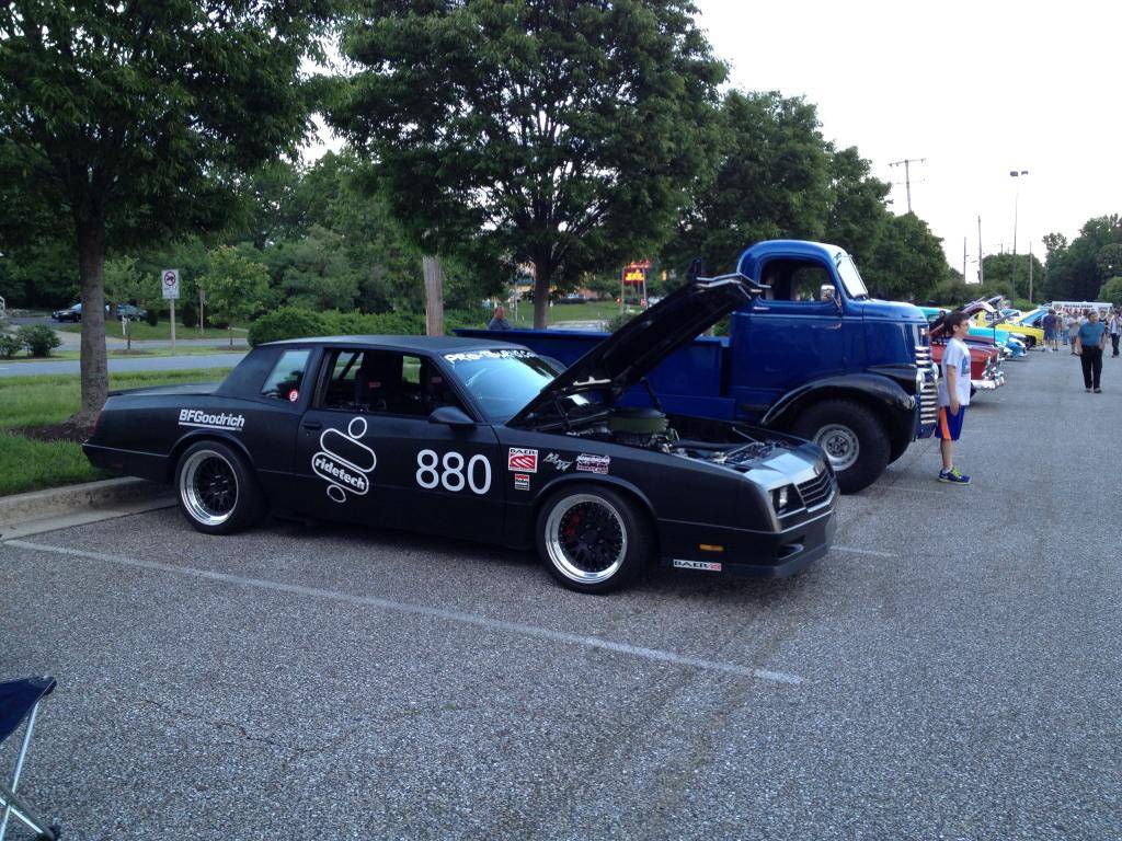

      So I drove my car one last time with the automatic to a local cruise in this past Saturday....good time and the car always gets attention. You don't see too many pro-touring autox cars in this area.

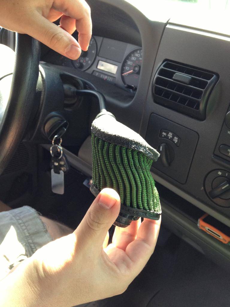

      and on the way home I hear this big thud...like something fell off the car. I pull into a gas station..pop the hood and notice that my darn breather fell off! My buddy behind me started to laugh bc he ran over it and thought it was an animal. Well I went back and found the darn thing...and it is now on my wall of shame!

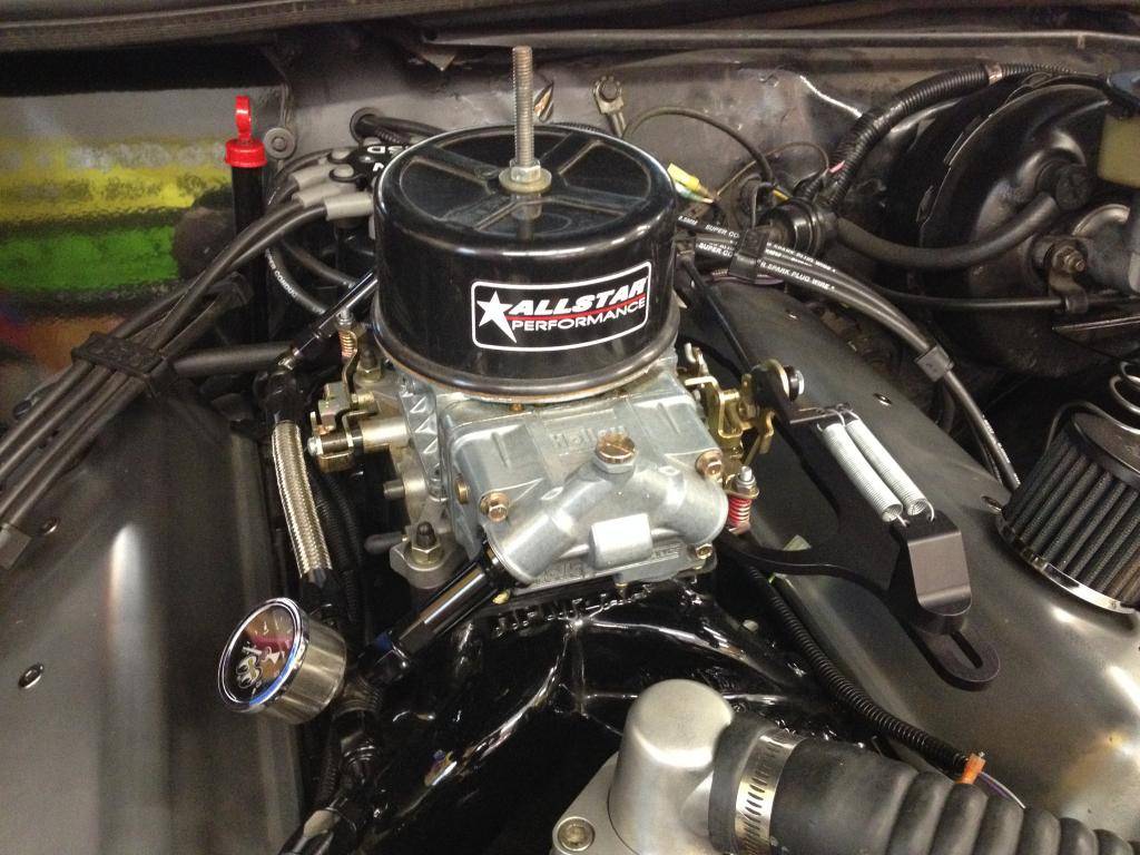

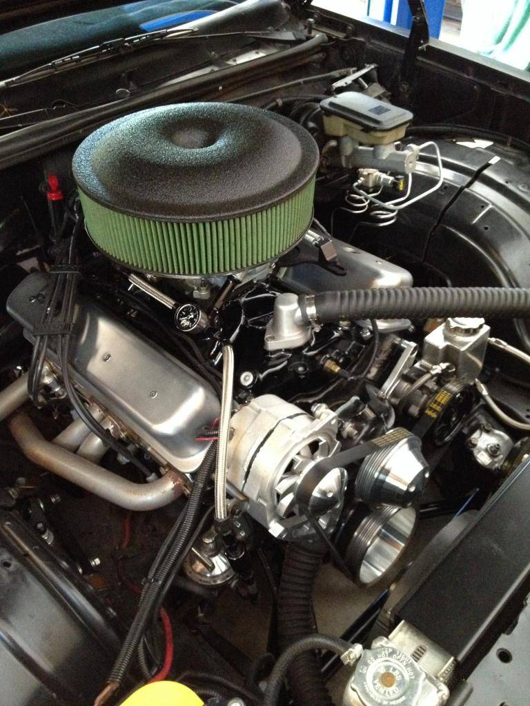

      Random shots of the engine before the work begins.....
      Now all the trans linkage is removed from the carb.

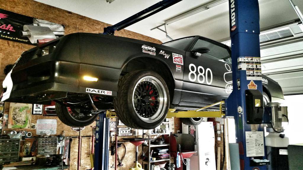

      Car is now officially off the road, on the lift and ready to be torn apart!!
      Here's the list of mods being performed:
      - t56 built by RKT Performance
      - Centerforce Clutch and balanced flywheel
      - Canton Road Race Oil Pan
      - 8.5 10 bolt rear with 30 spline axles, Detroit Tru Trac and SS4 Bear Brakes
      - Aluminum Drive shaft by ??........currently accepting offers.
      - ridetech front Tru Turn suspension
      - ridetech TQ coil-overs on all four corners
      - UMI Performance rear suspension, motor mounts and sway bars
      - BFG Rival Tires or Falkens.....that is still to be determined!
      Douglas Lutes
      1988 Monte Carlo SS

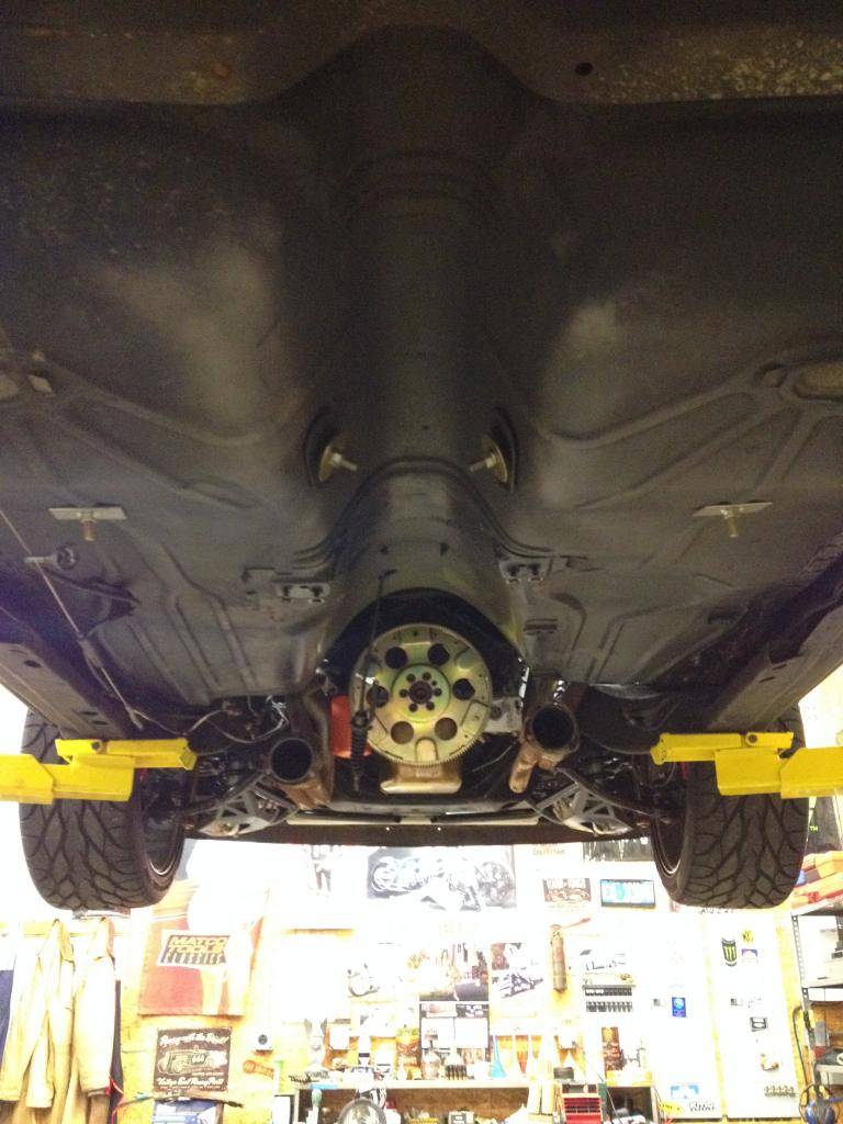

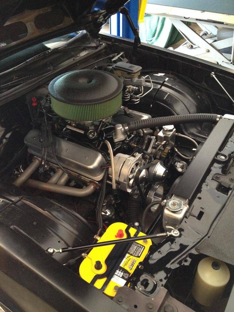

      Trans is out now all that's left to do is...everything!!!!

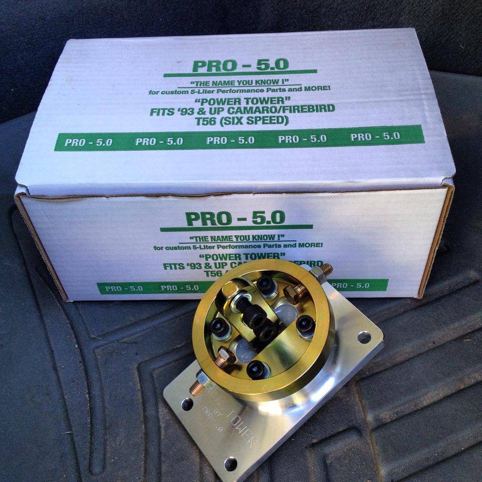

      Another piece to the t56 puzzle......
      Does anyone know what to use as a cover to the actual shifter linkage? Not a shifter boot but like an inner boot to cover the open area??
