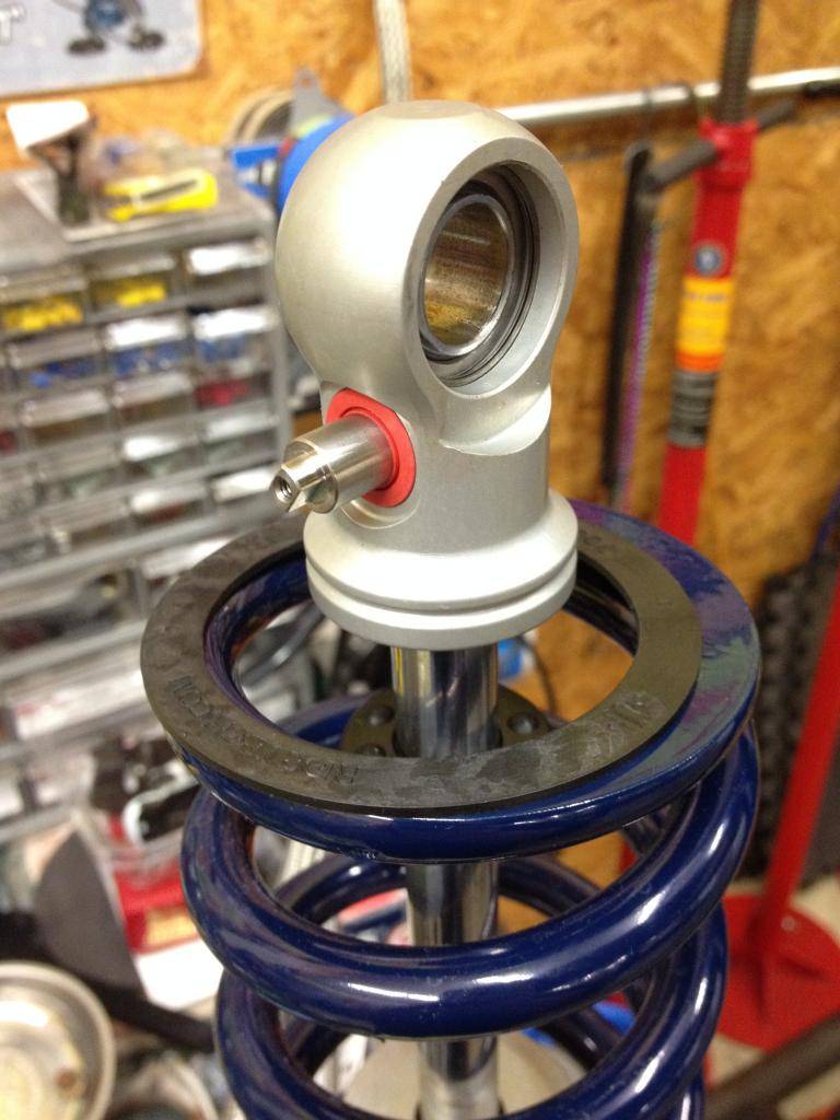

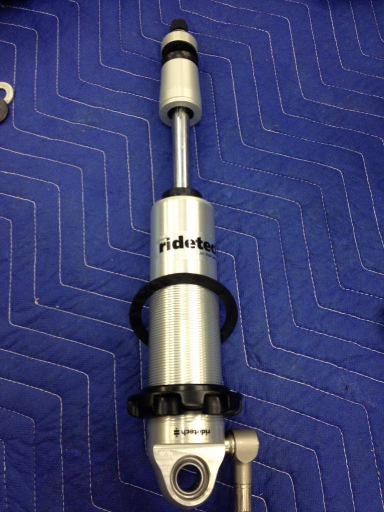

      Next step is to install the lower Delrin washers....
      Then put on the spring....
      Then the upper Delrin washer....

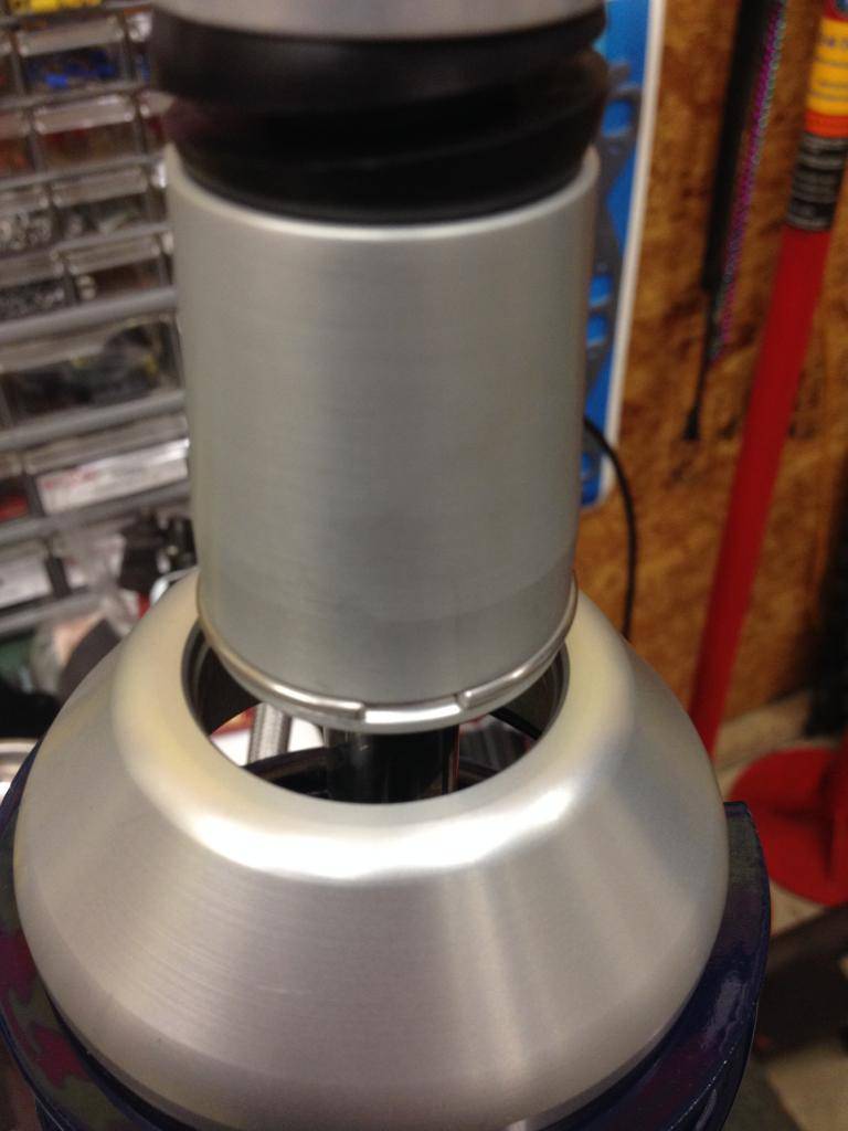

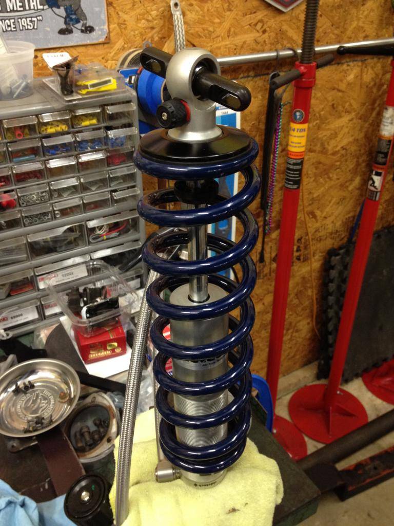

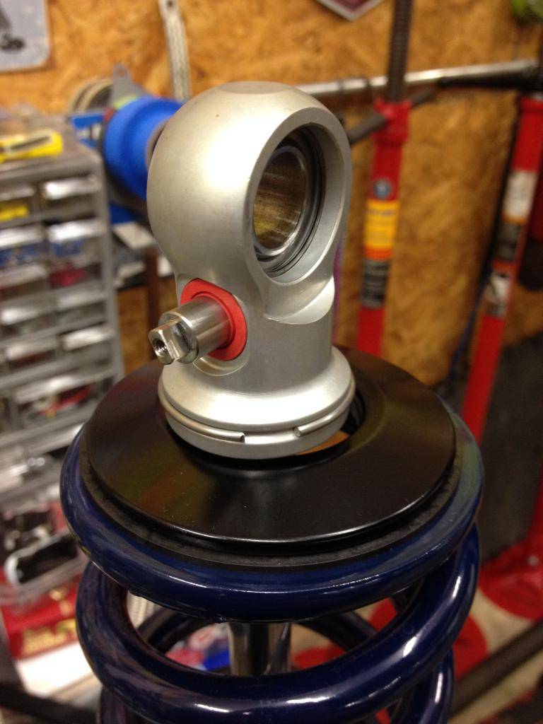

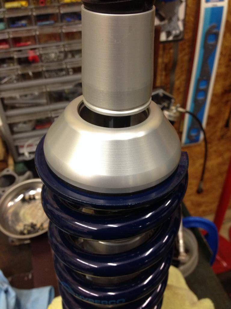

      Next you install the upper spring retainer. ridetech offers two different retainer...the low and tall...and on a gbody you need to use the tall one due to the factory spring pocket clearance issues.
      Here's a pic of the two different upper spring retainers.
      So I used the new one that ridetech sent to me which was brushed aluminum (maybe clear anodized) instead of the old anodized black one.

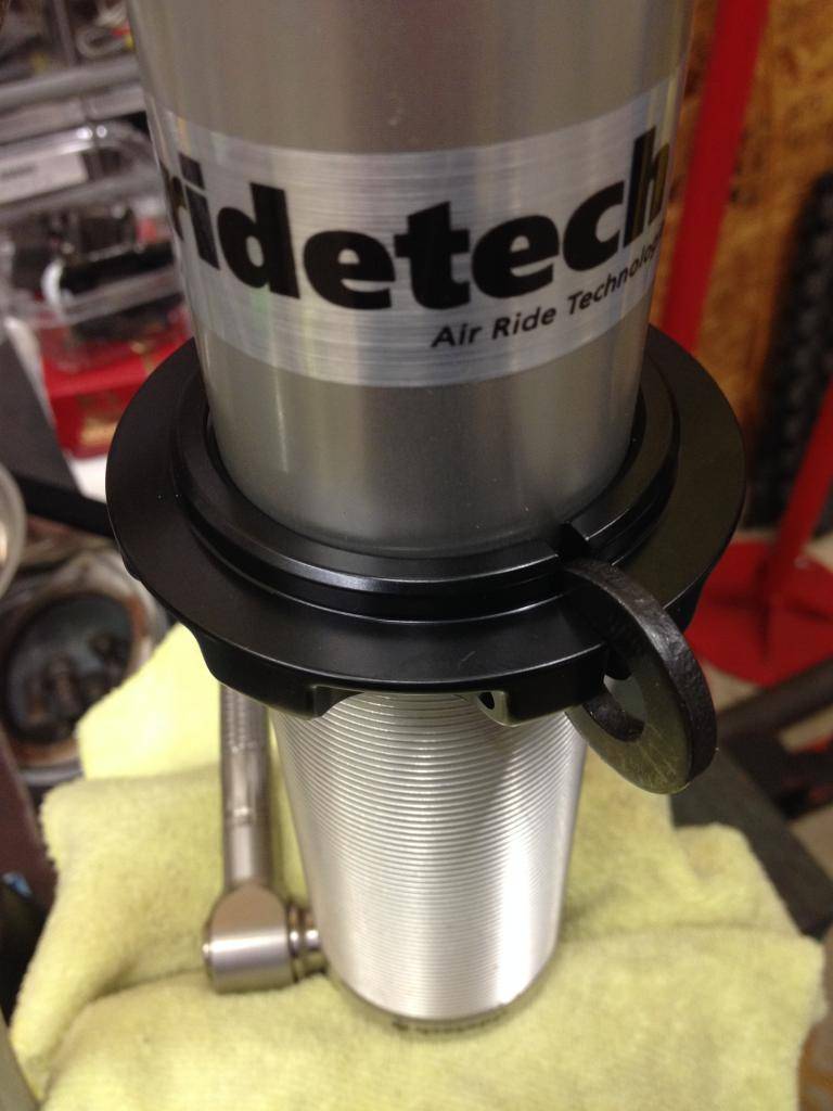

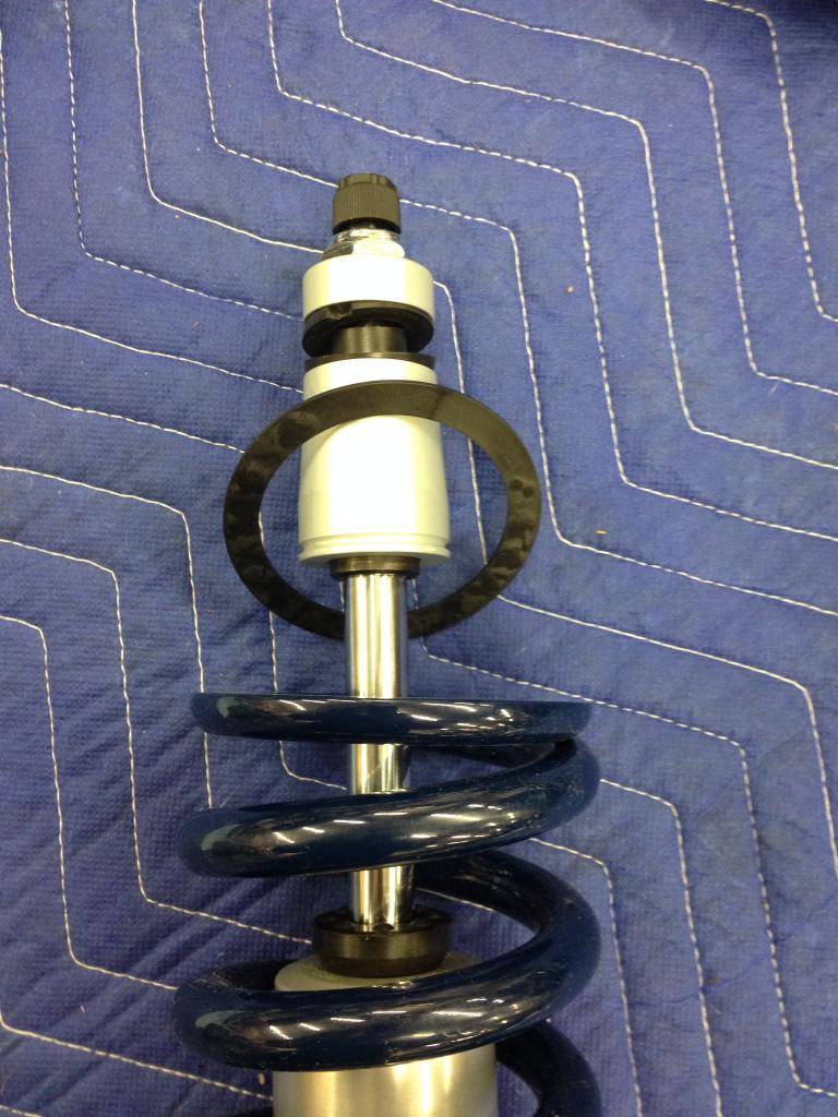

      Next install the small metal clip that will actually hold the upper spring retainer in place once tension from the coil spring is applied.
      Screw up the spring to apply tension....
      Last thing to do is tighten up the screw in the lower spring mount/adjuster so that it doesn't back out.

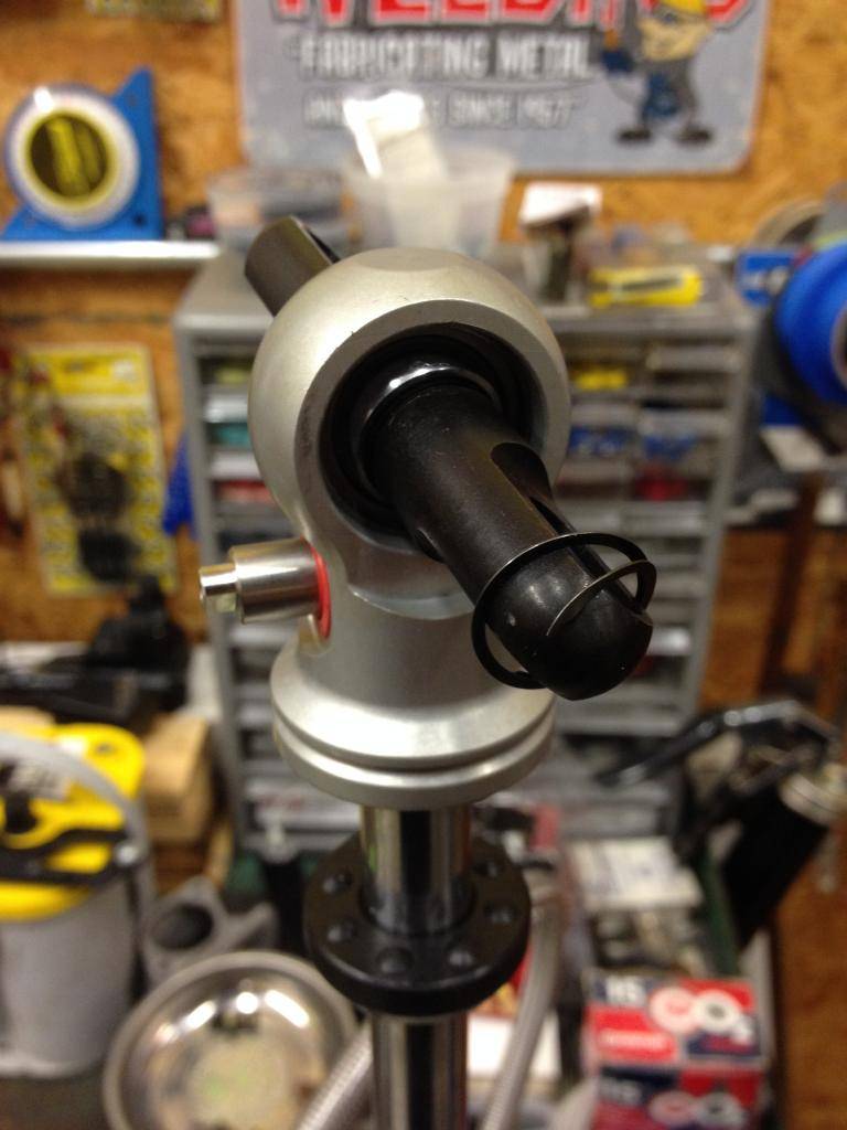

      Now on to the rear coilover.....here it is!!!
      First step is to take out this lil clip that holds in the trunnion bar.

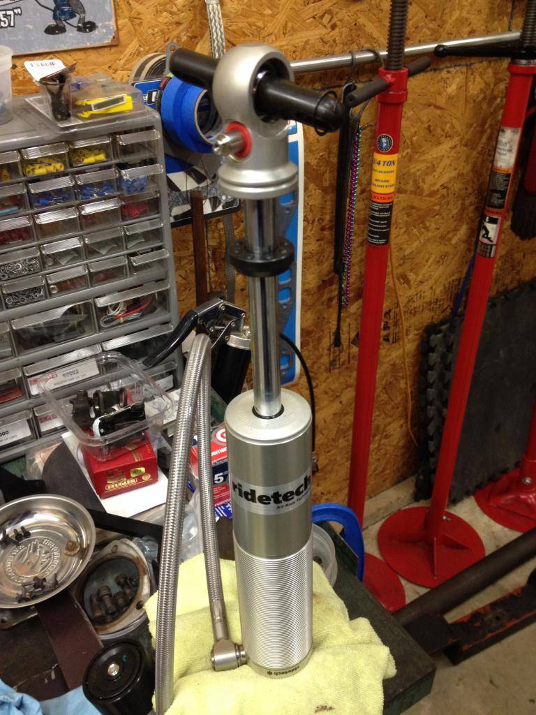

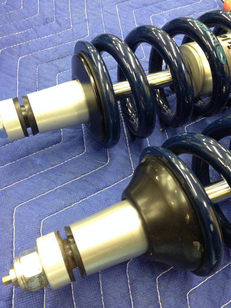

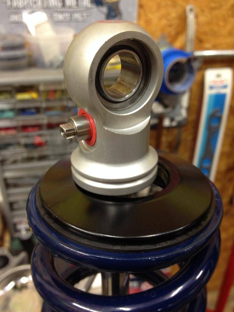

      Next install the lower Delrin washer...spring...then the upper Delrin washer.
      Next step is to install the upper spring retainer (flat one). In order to get the spring retainer on you will need to screw in the adjustment knob all the way in and take off the knob. The lil screw that holds on the knob is a T10...a torx bit.

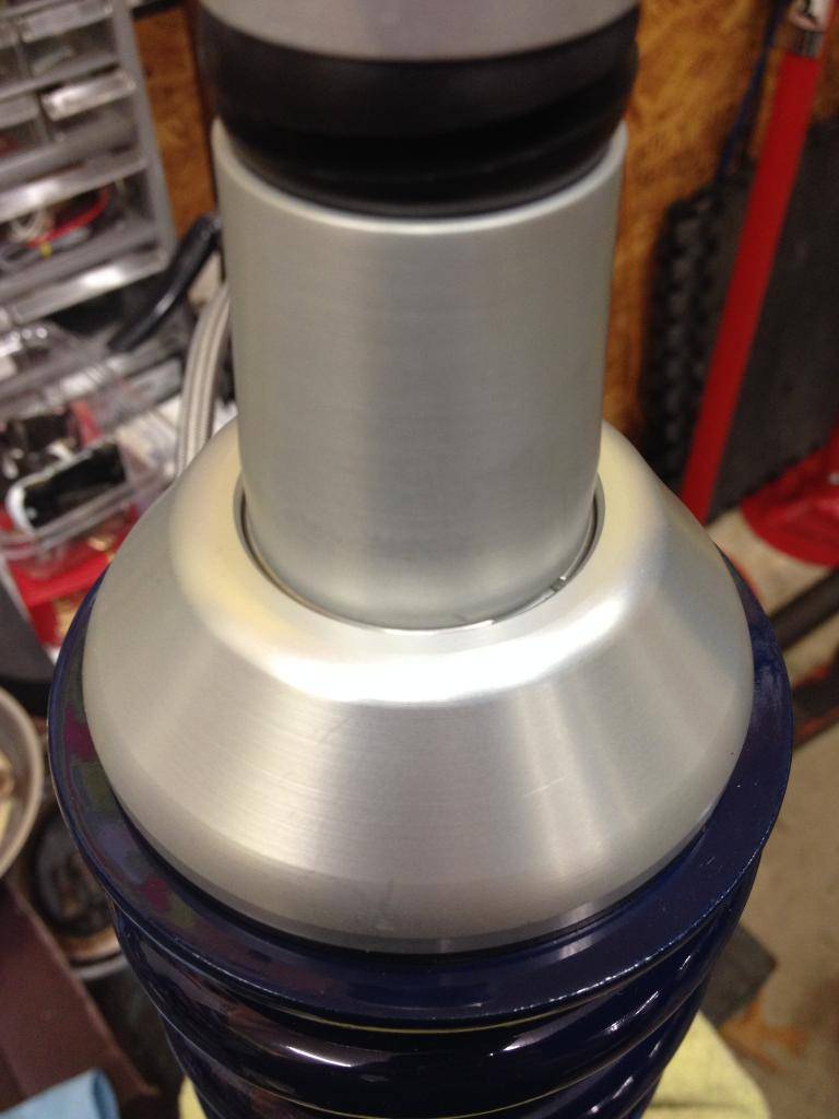

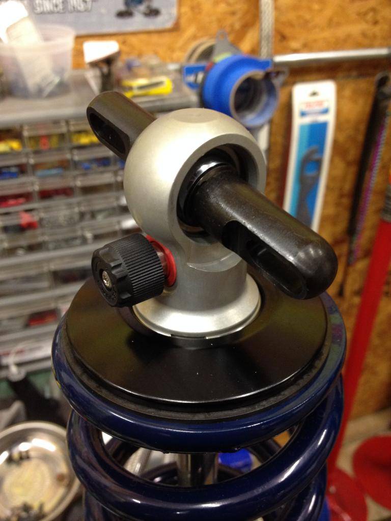

      Next you need to put on the upper spring mount retainer clip.
      Put the adjustment knob back on...add some spring tension to the upper mount...re install the Trunion bar and press on the metal clip and Boom...it's done!!!

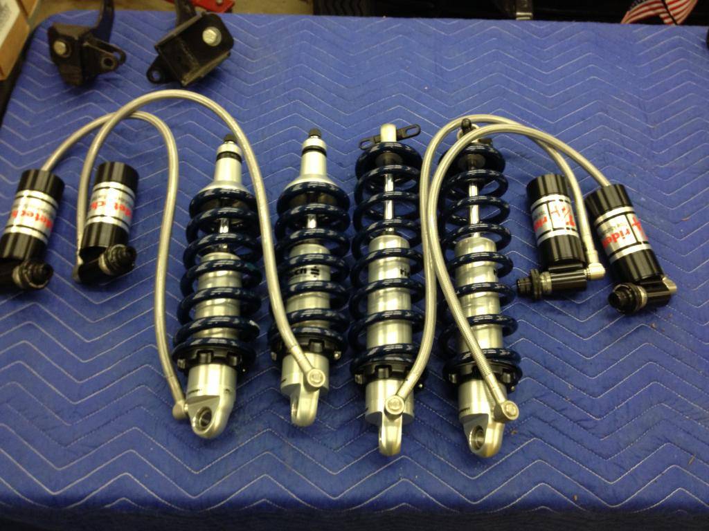

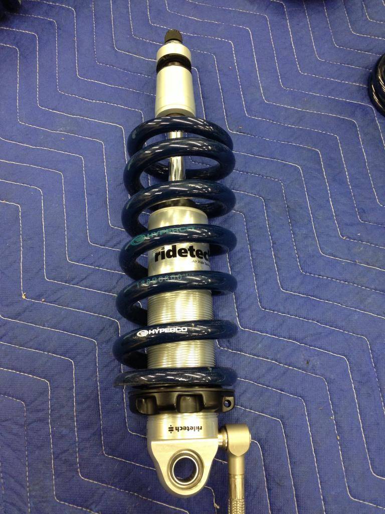

      And there ya have it....ridetech TQ Coilovers assembled and ready to be installed...tuned...and thrashed!!!
      Now I did receive some insider tips on these coilovers from two people who have been running these for a couple years now. They actually mounted them upside down in order to have the reservoir hose closer to the trunk to make installing the reservoir easier and to bring the adjustment knob within better reach. I will be taking the coilovers apart soon...switching the Trunnion bar to the opposite side...and re-assembling the coilovers so that this is the way it will be in my car. MAKES SENSE RIGHT??!!

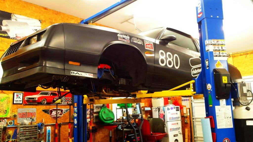

      I've been getting a lot of crap recently about my car not being done. Here is the current state of my car: Trans "mocked" up, no suspension, no rear, old oil pan still on.
      Tonight I will start the process of pulling out the motor to install the new Canton Road Race oil pan. I have to remove the motor b/c the T56 will not allow me to raise the motor enough to install the pan so the motor is coming out. I hope that this does not lead to more projects b/c I am sick of projects and tired of spending money on this car.
      After the oil pan is installed and the motor is back in I will finish up with the T56 install by bolting up my Centerforce® Clutches Dual Friction clutch, installing the Rick Kim Performance T56 and GForce cross-member and the final step is getting the Bernie Duplan SICKSPEED pedal assembly sorted out.
