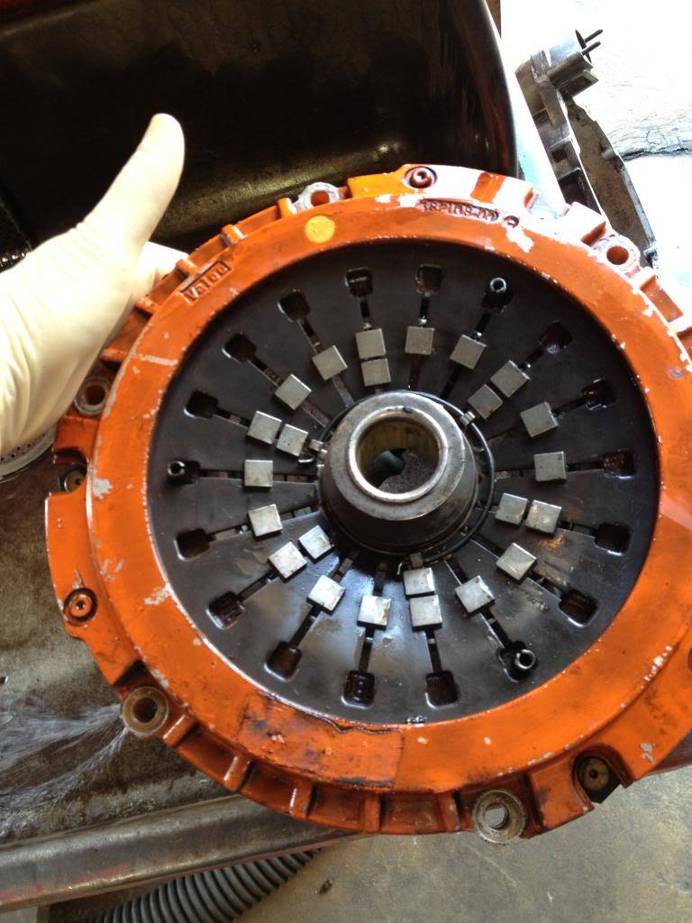

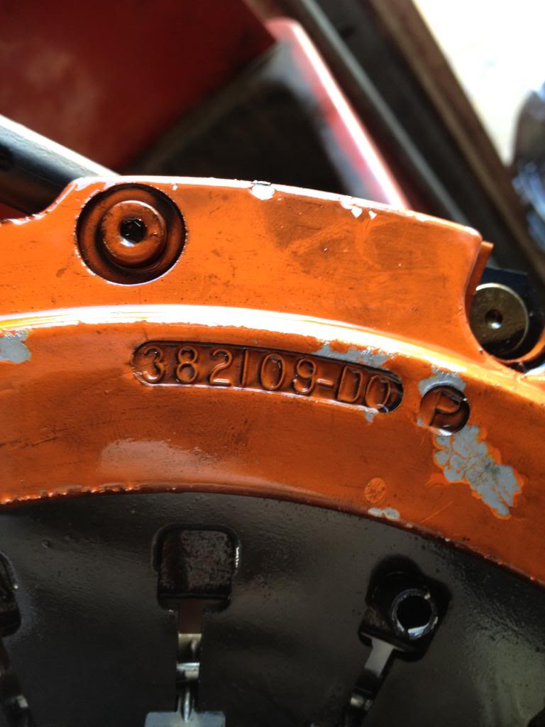

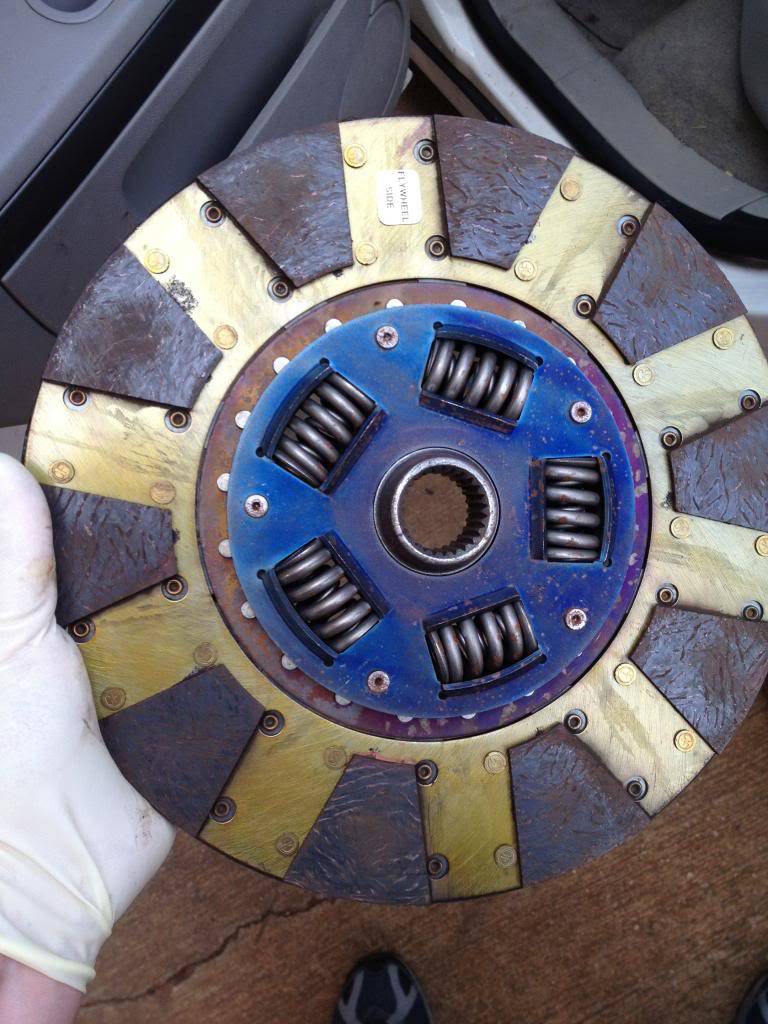

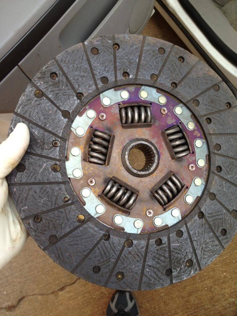

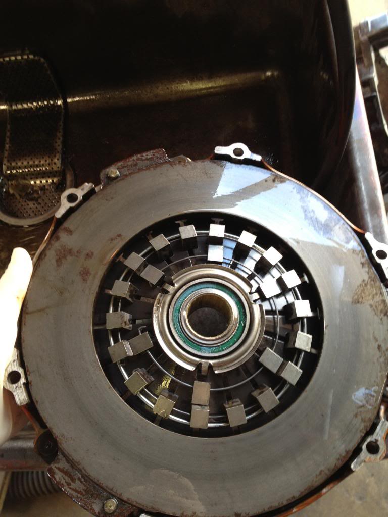

      Here's what I got in the "kit".....
      The clutch, pressure plate and flywheel are all going to be serviced, inspected, and balanced by a very very very good clutch company. I will sing their praises once I actually send the parts out! Hint: They are the CENTER of attention in the clutch world and are a FORCE to be reckoned with.
