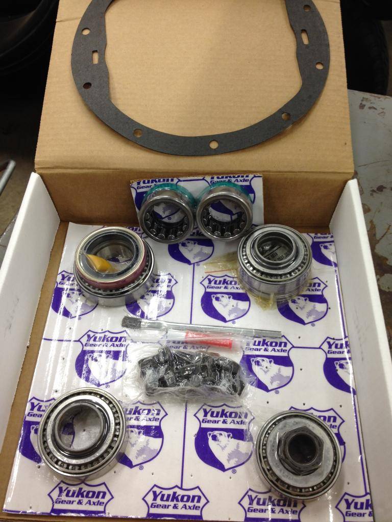

      Yukon rear end assembly kit.

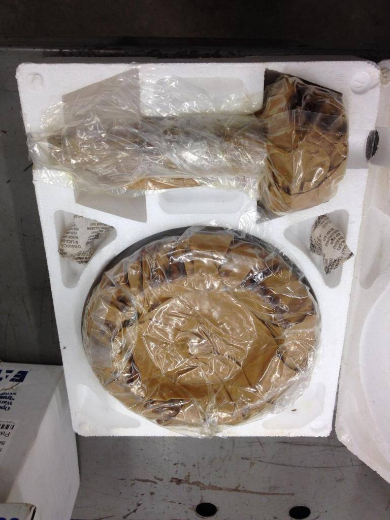

      Yukon 3.73 Ring Gear...still in the packaging lol.
      Douglas Lutes

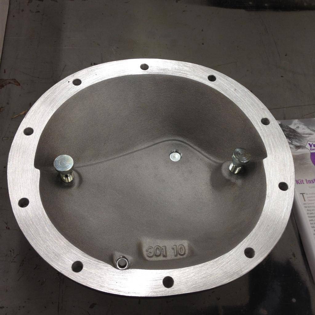

      LPW Aluminum Diff Cover.

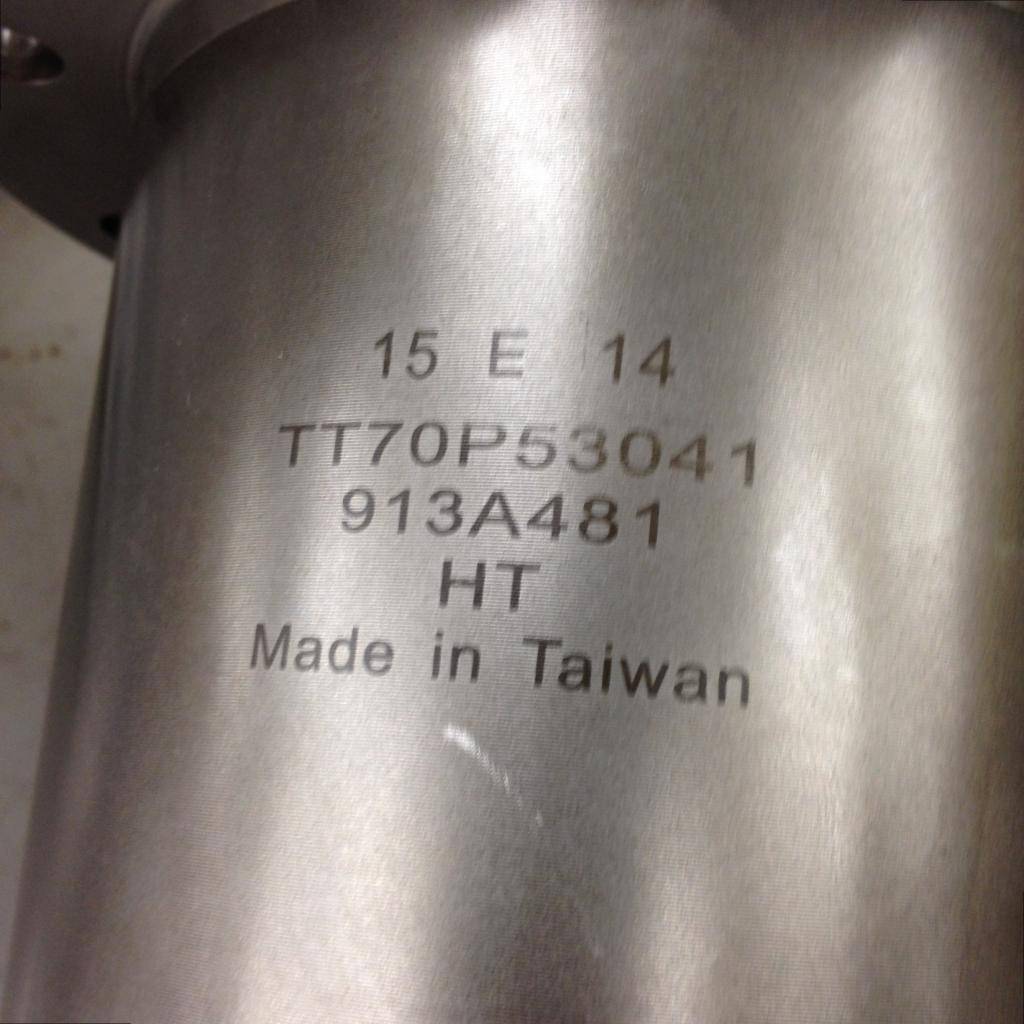

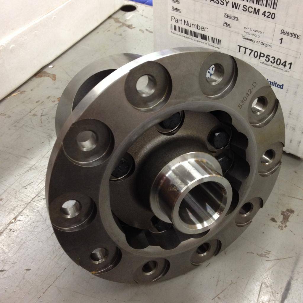

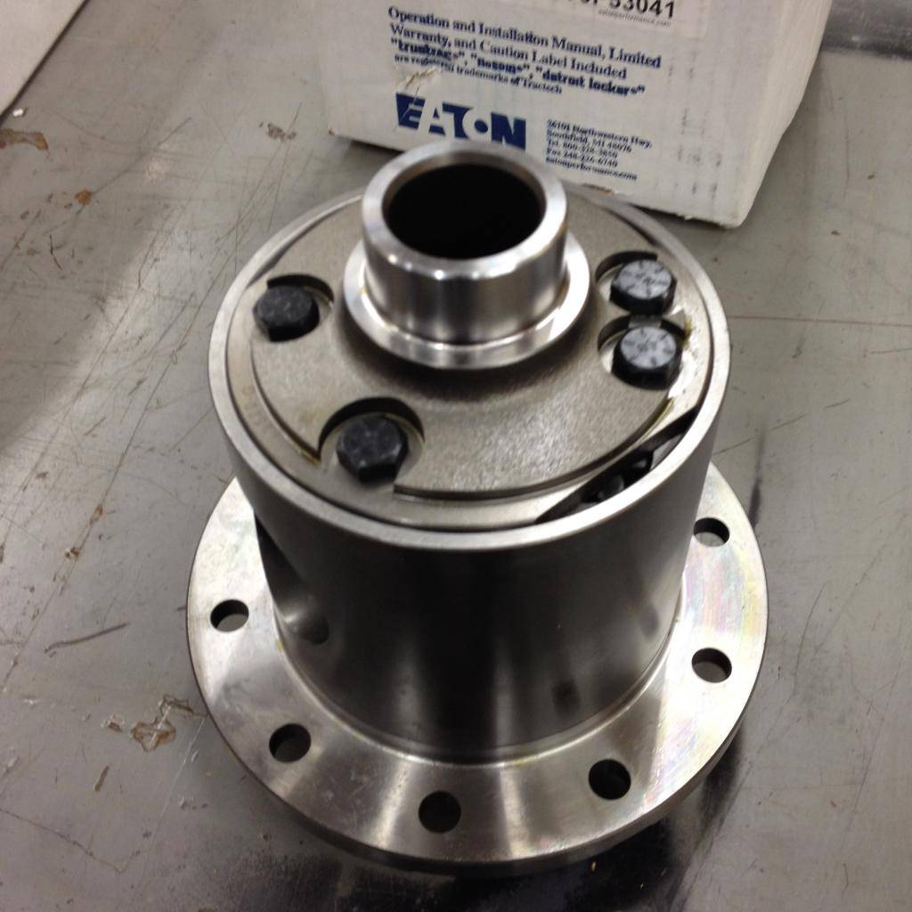

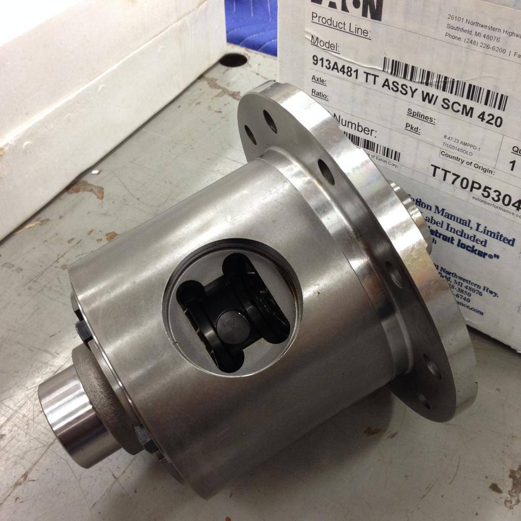

      Eaton TruTrac.....I can't tell you how long I have wanted one of these!!!!!

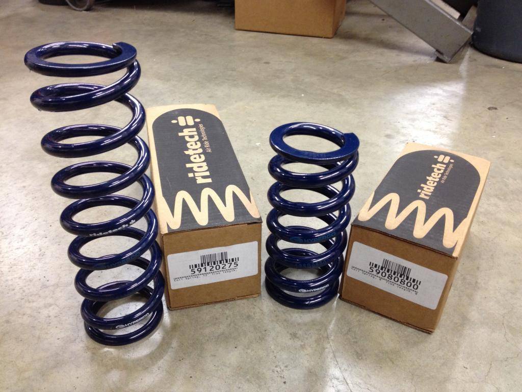

      Soooo while the rear is out getting built I have started the suspension parts swap.
      First step was to assemble my new ridetech TQ series coilovers.
      Here are the springs. Fronts are now 800# (used to be 900# on the single adjustable coilovers) and the rear springs are 275# (up from 250# on my singles).

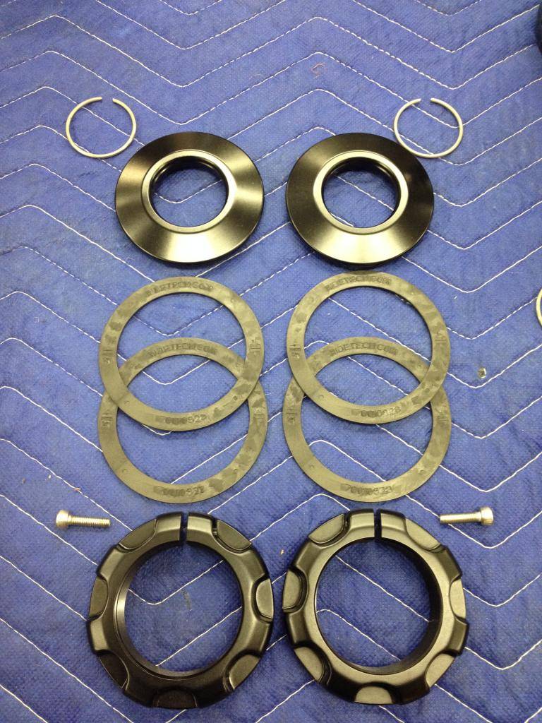

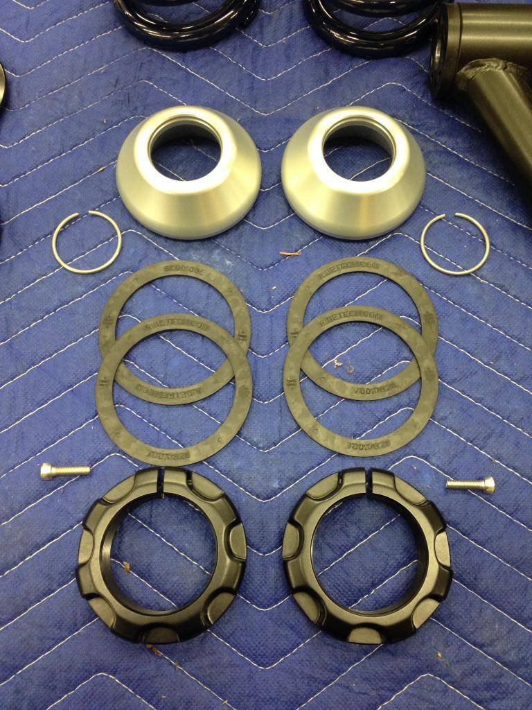

      Here is all the hardware for the front coilovers.
      and here's what's included with the rear coilovers.

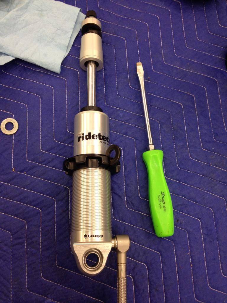

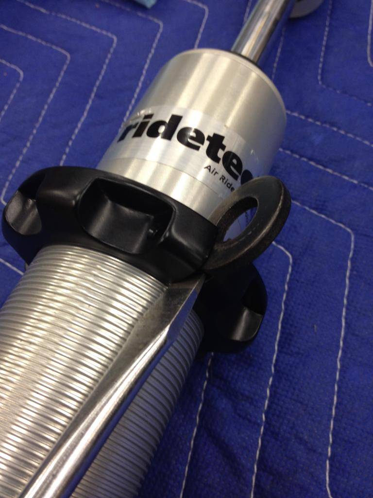

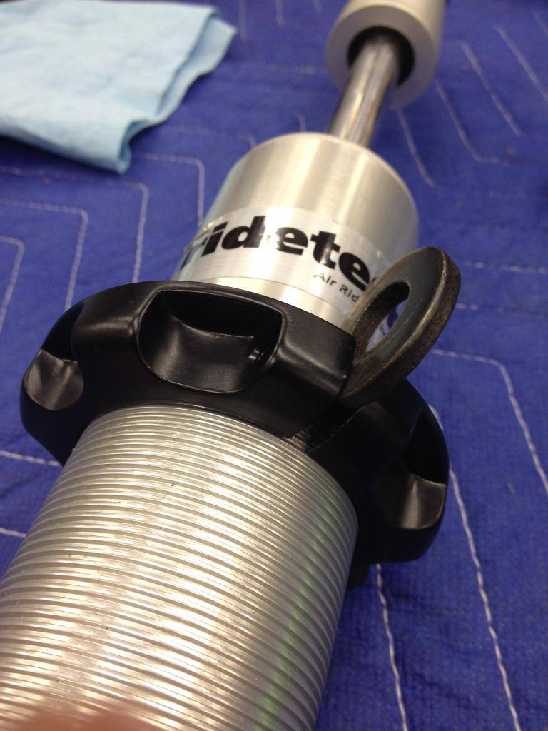

      And here we have a ridetech TQ Coilover for the front of a G Body...when using the ridetech lower control arms.
      The first step in assembling these coilovers is to put on the lower spring mount/adjuster. This is usually done from the bottom of the shock but this is not possible on the TQ series due to the reservoir hose...so the lower spring mount needs to go on from the top. This is a seriously tight fit so the guys at Ridetech gave me a lil trick of the trade.......put a thick washer in the open space on the spring mount to widen the inner diameter and the mount will slide right over the shock body to the threads. BINGO!!!!!!!!!
