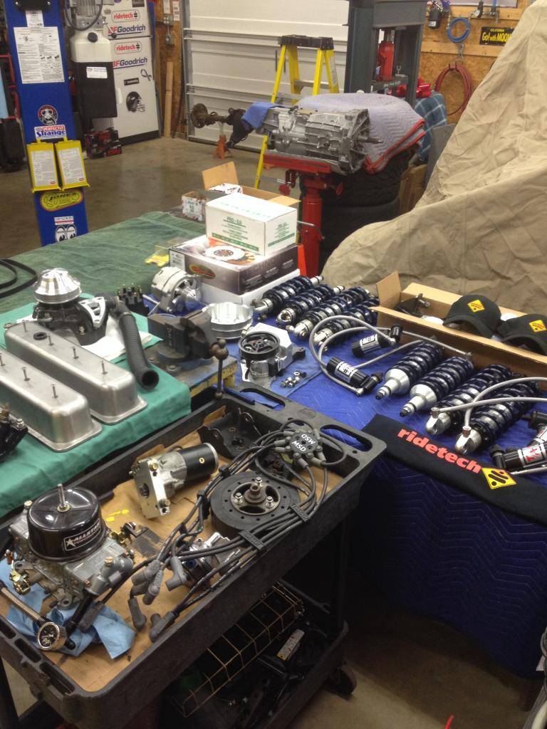

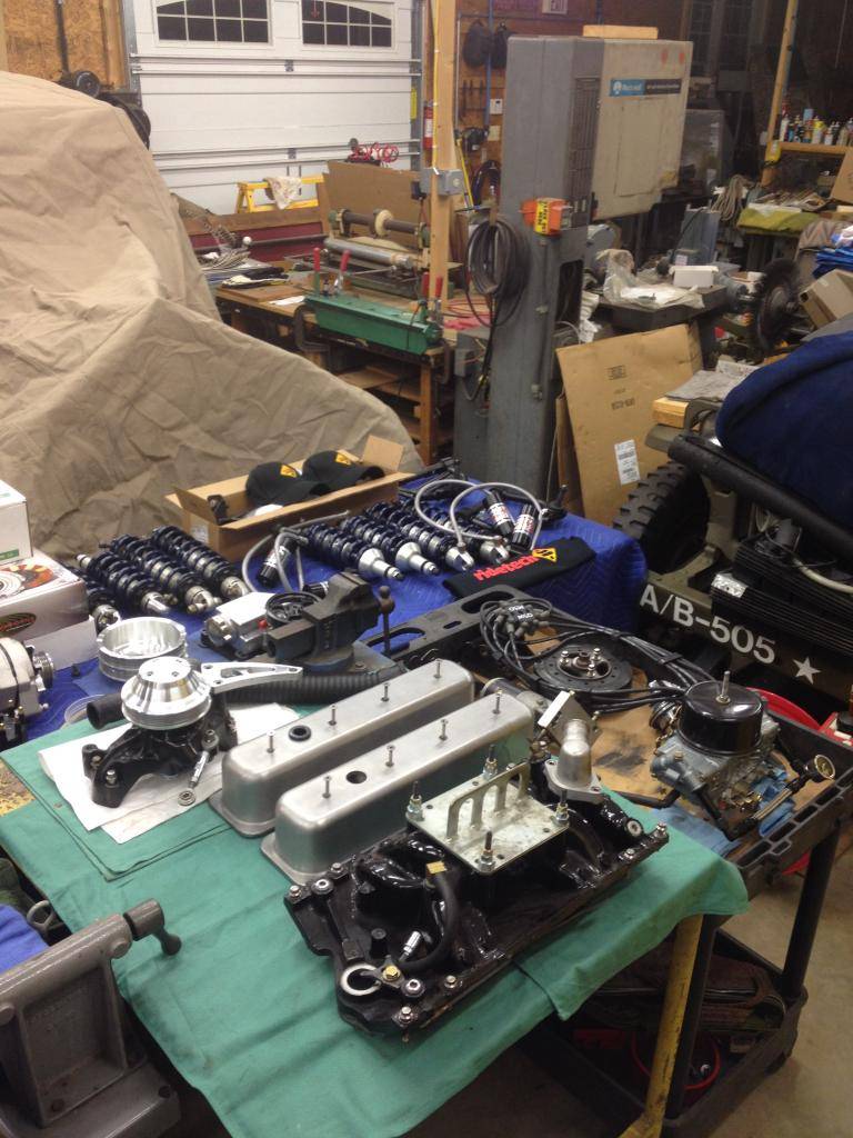

      So here are all my parts for the SBC and some suspension pieces...I really wish I had my shop back!!! My car has taken over!!!

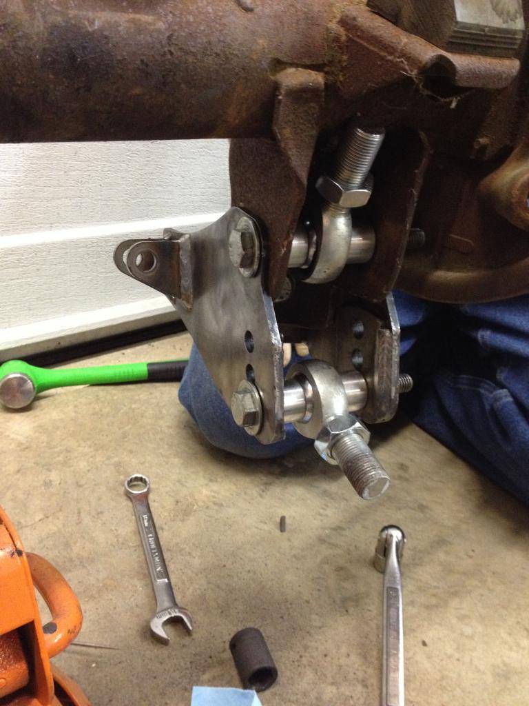

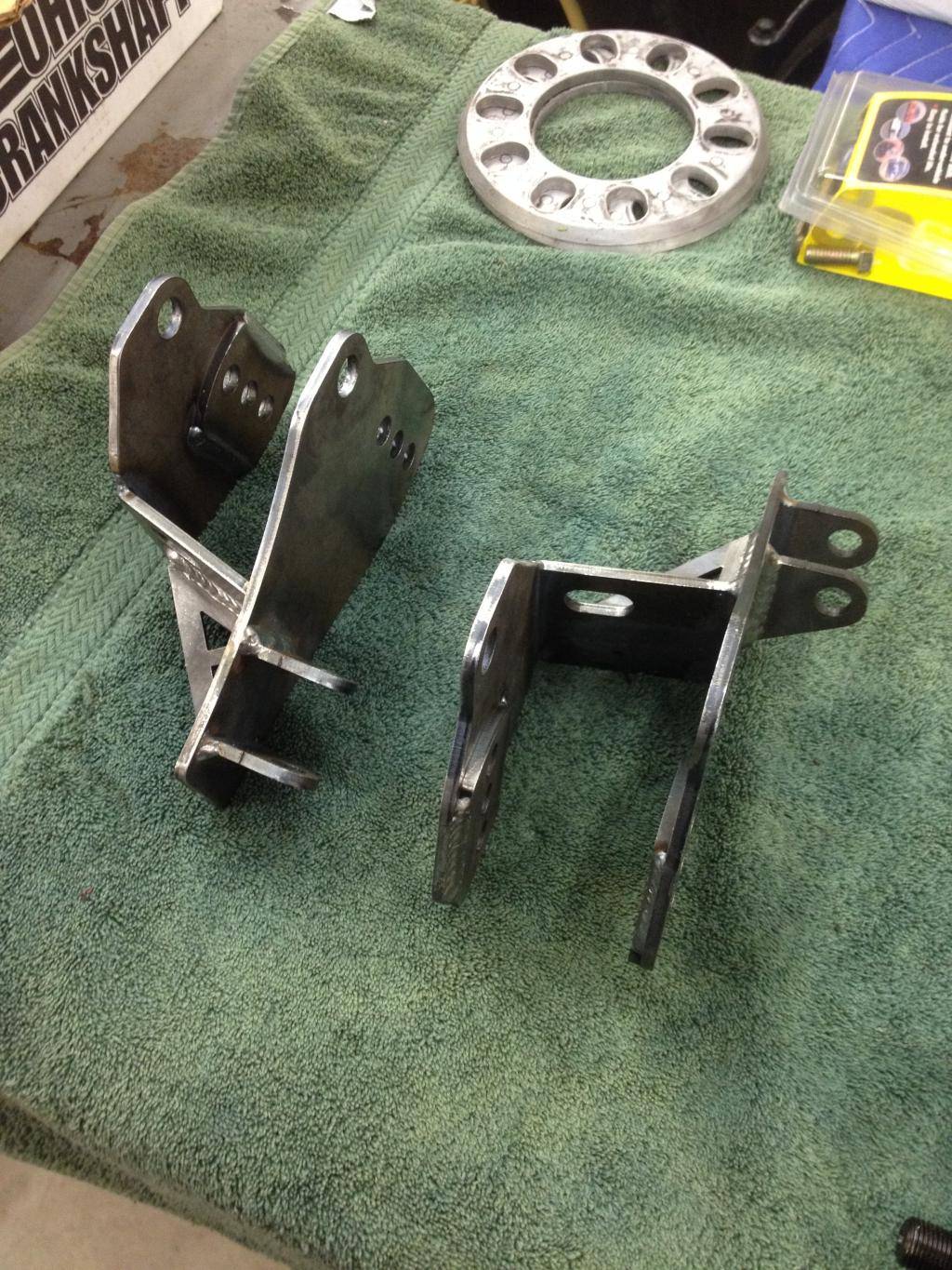

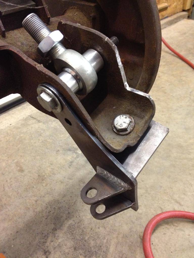

      So I have been working with UMI Performance for a while bit now to help them prototype some suspension pieces.
      These are their new rear coilover brackets with and without lower control arm relocation...pretty slick stuff here!!!
      Here's a close up of the LCA Relocation brackets with the coilover mount.

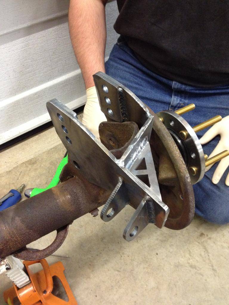

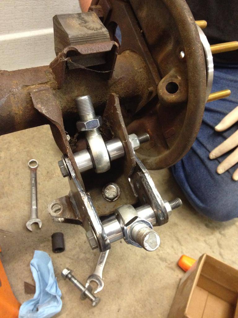

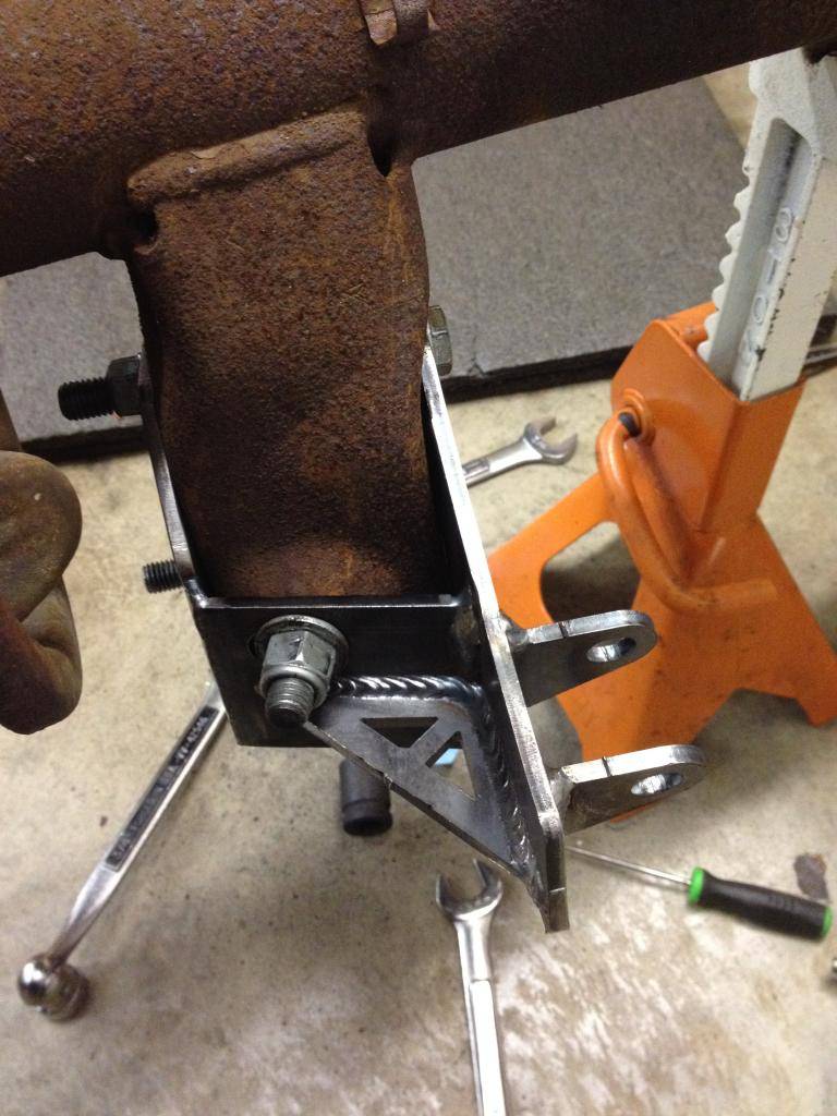

      Here is the UMI Performance rear coilover bracket installed on my 8.5 housing.
      Douglas Lutes

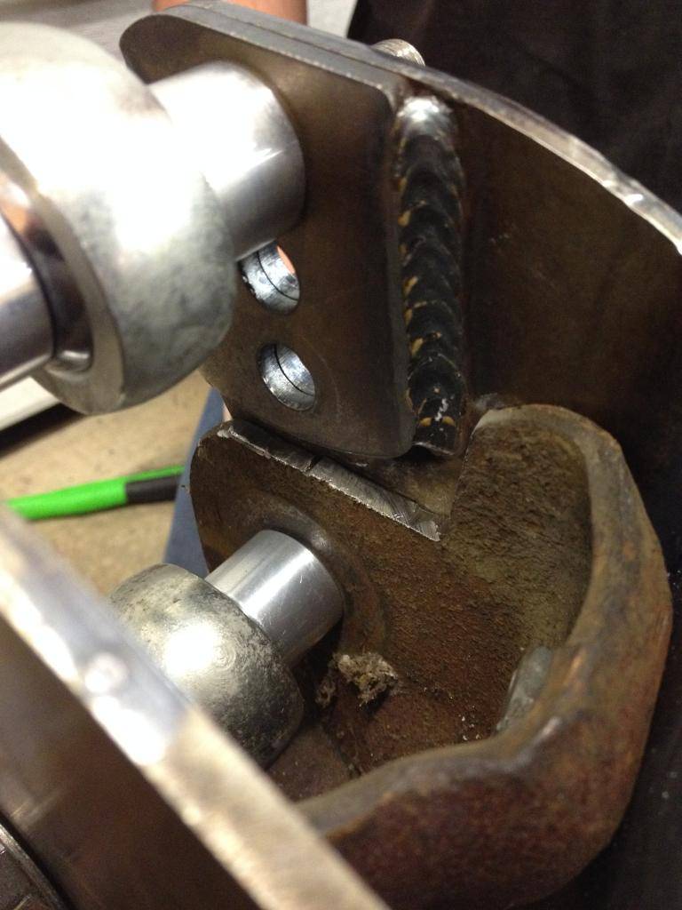

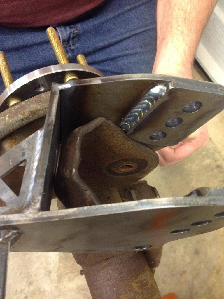

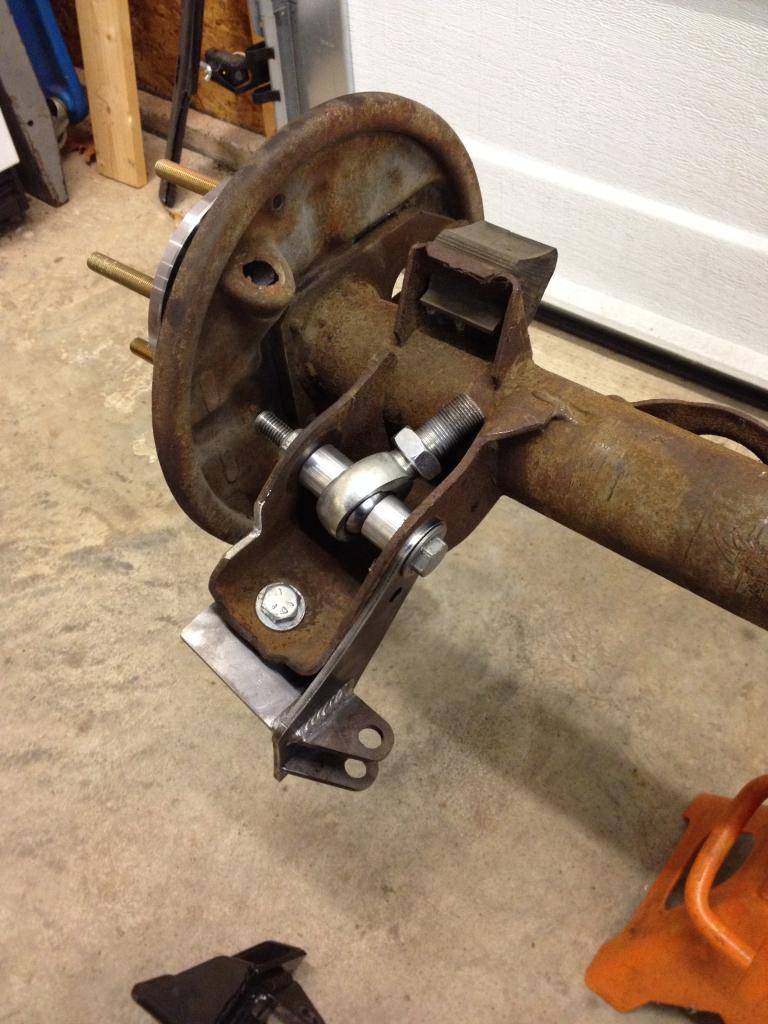

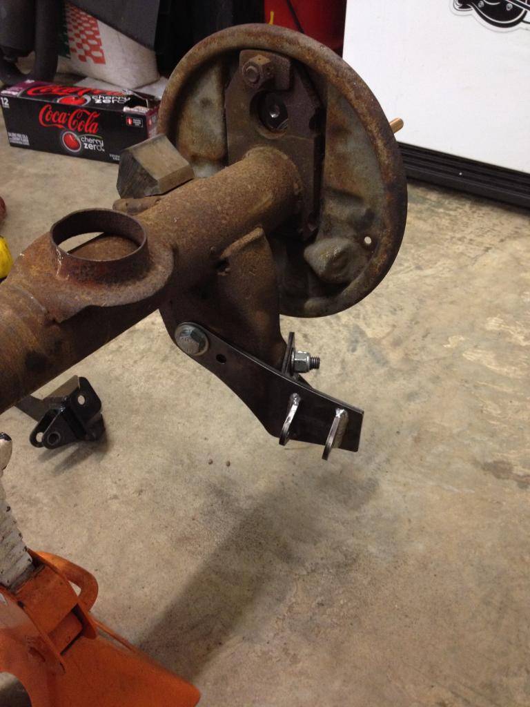

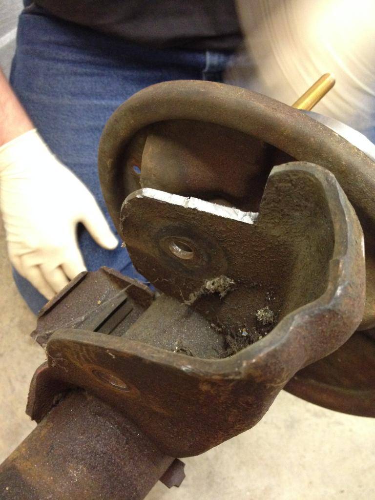

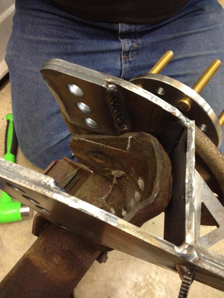

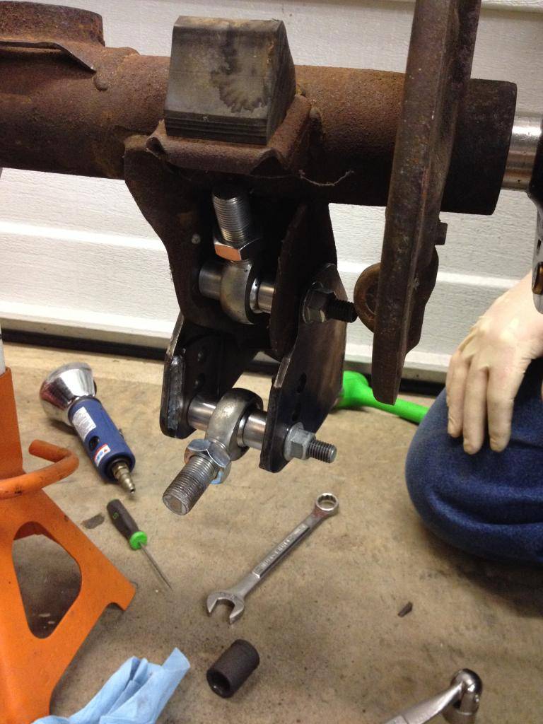

      The rear Lower Control Arm brackets with the coilover mount fit very well but I had to trim the housing a little bit. You can see in the pics below how the support plate is hitting the actual housing.
      Douglas Lutes
      1988 Monte Carlo SS
    15. #875
      Woodbine, MD
      2,770

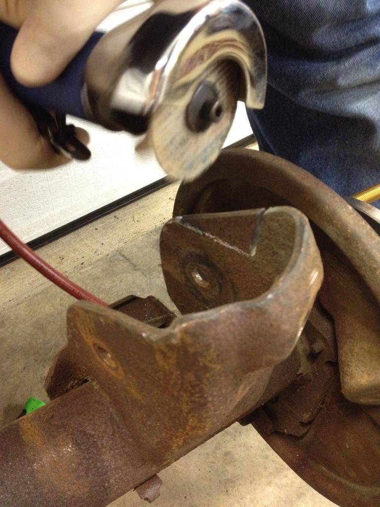

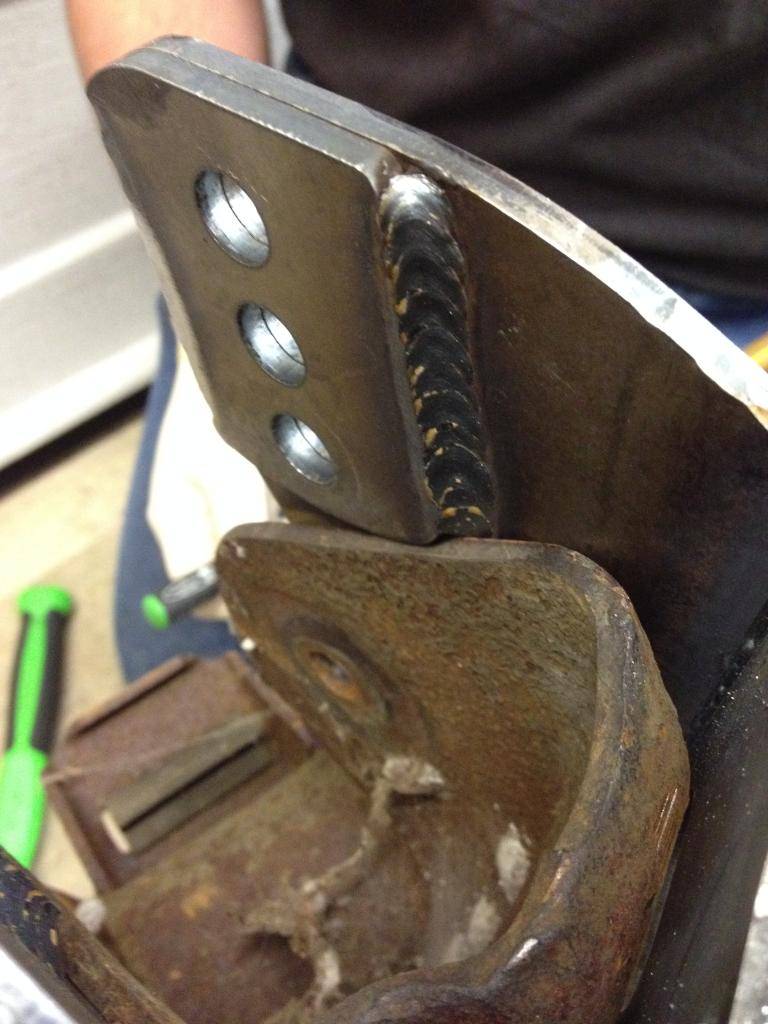

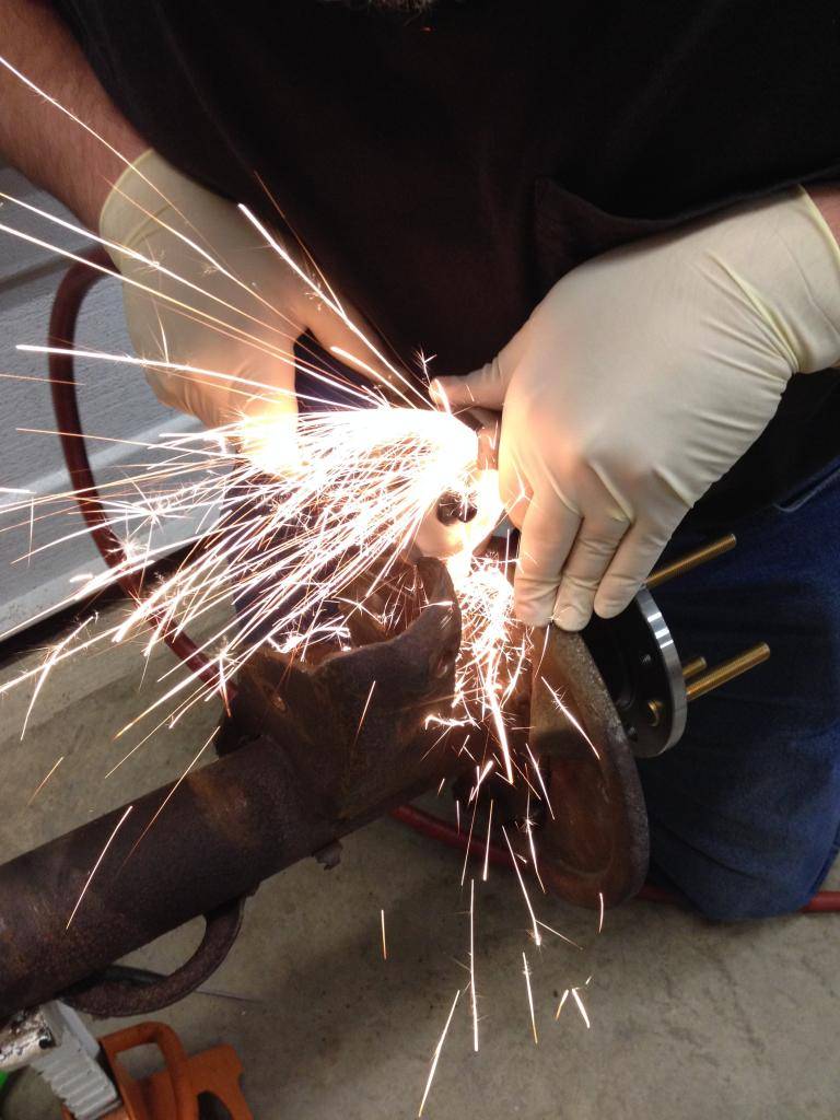

      So we measured, marked and cut!!
      Douglas Lutes
      1988 Monte Carlo SS
    16. #876
      Woodbine, MD
      2,770

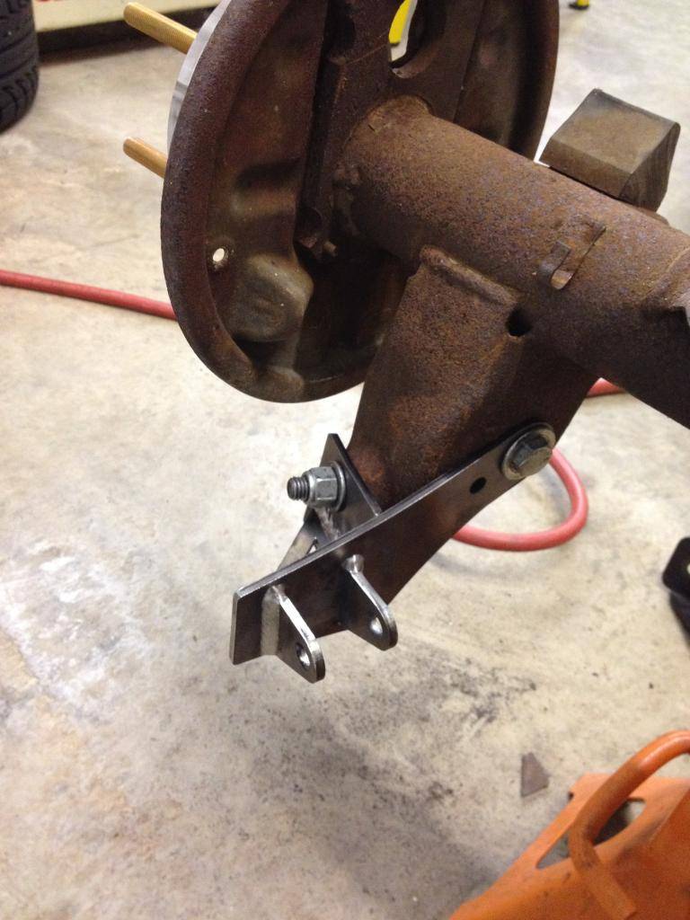

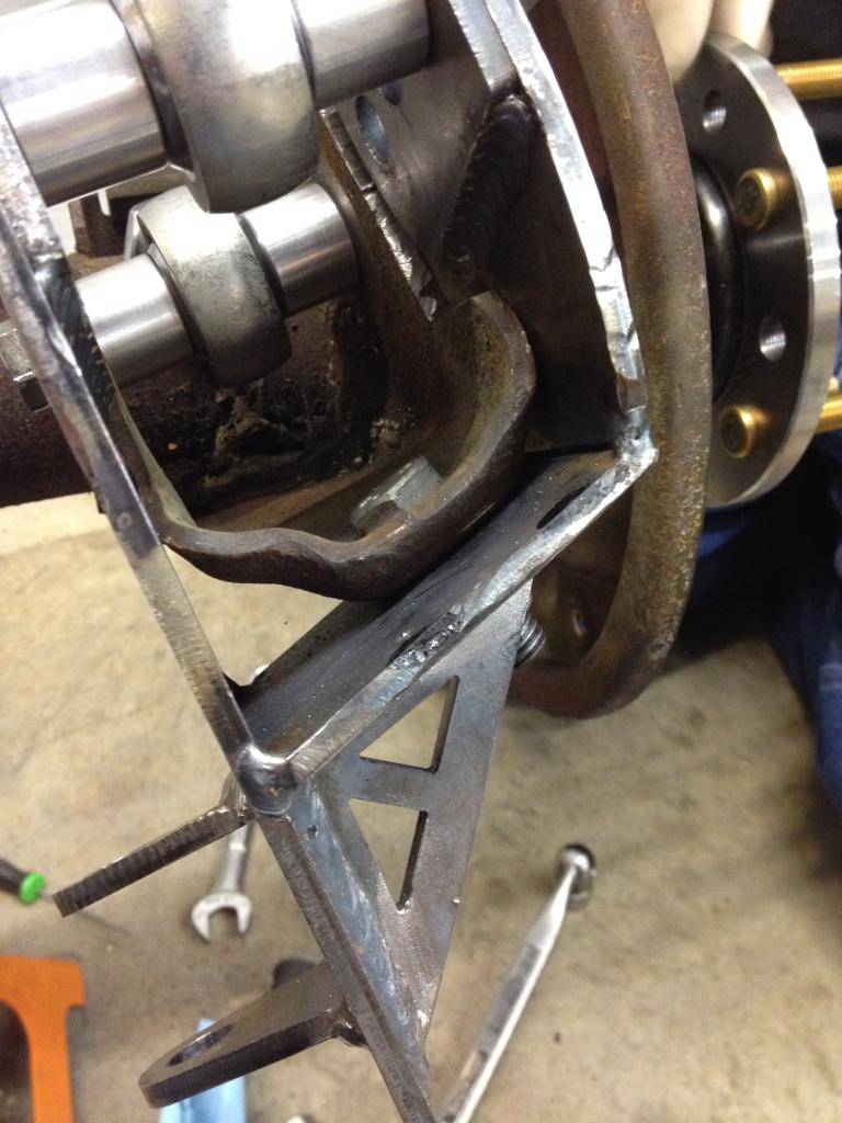

      Test fit.....
      Douglas Lutes
      1988 Monte Carlo SS

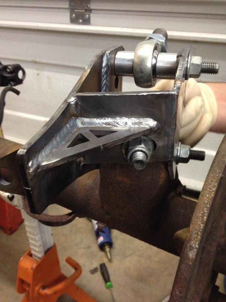

    17. #877
      Woodbine, MD
      2,770

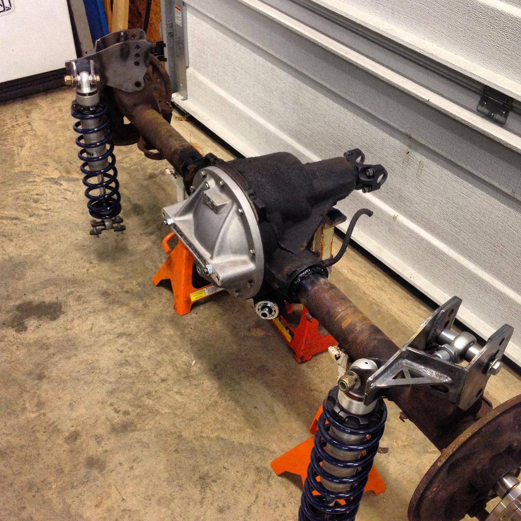

      Final test fit with the coilovers.....these brackets are really nice, very strong, well thought out and most importantly....MADE IN THE USA!!!!!!!
