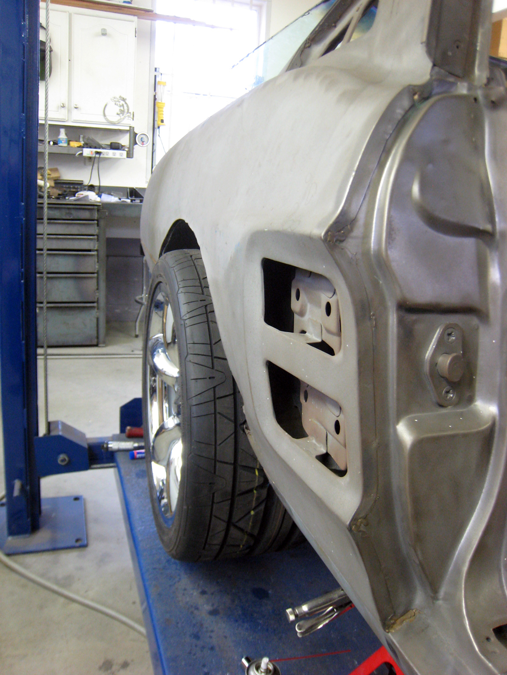

      We're going to widen the rear quarter.
      this car will have a low stance.

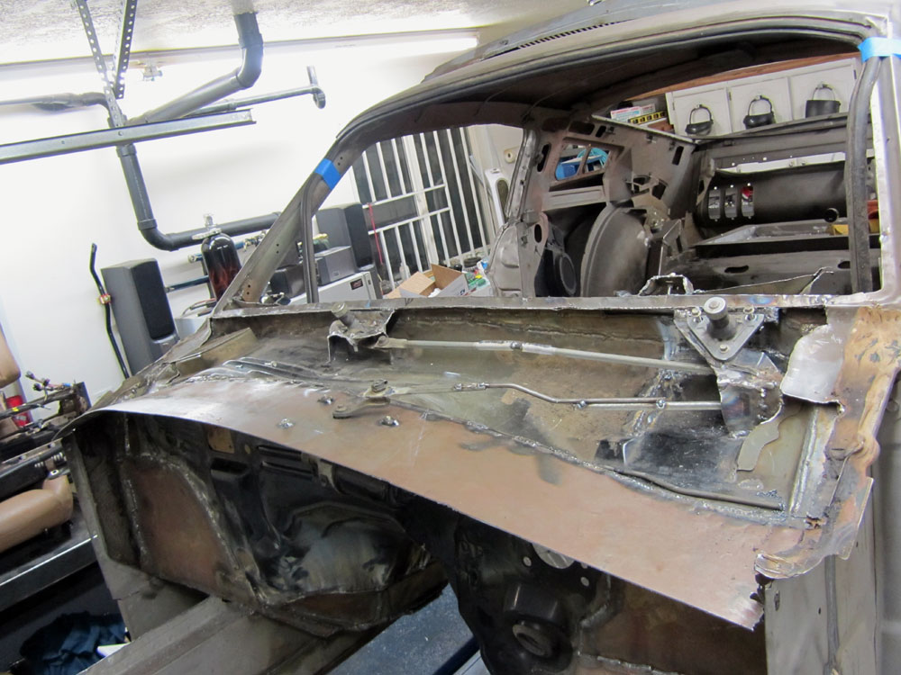

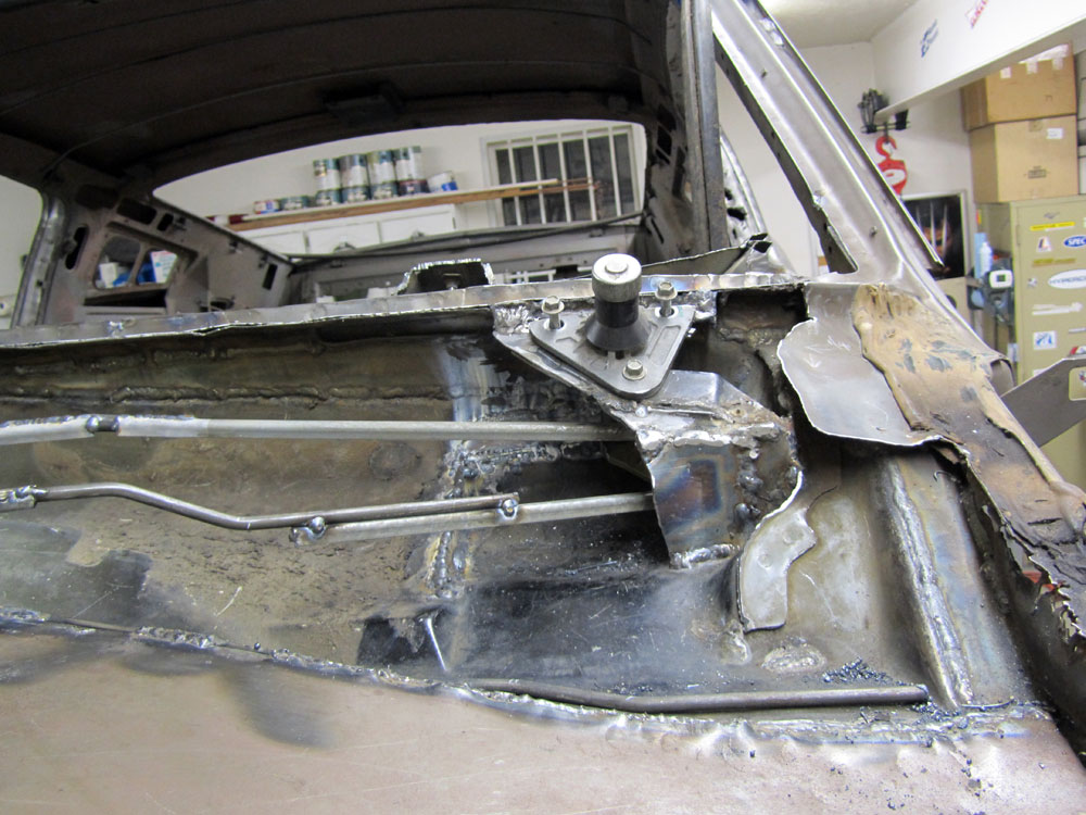

      it is about time for an update, and about time we worked on this project for that matter.

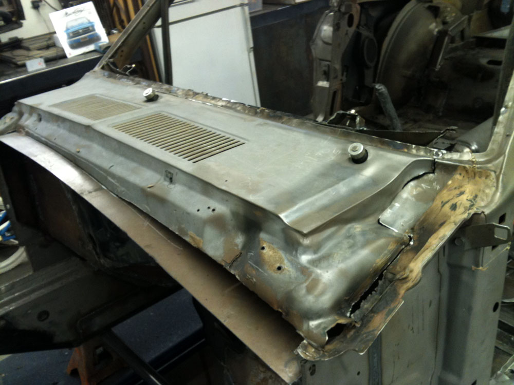

      What we did over the weekend.
      Wiper linkage. mounting the motor and linkage from the 97 doner car.
      here's some pics.
      The motor is accessable from the bay, and the rest will be welded back under the cowel sheet metal!

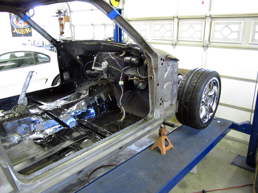

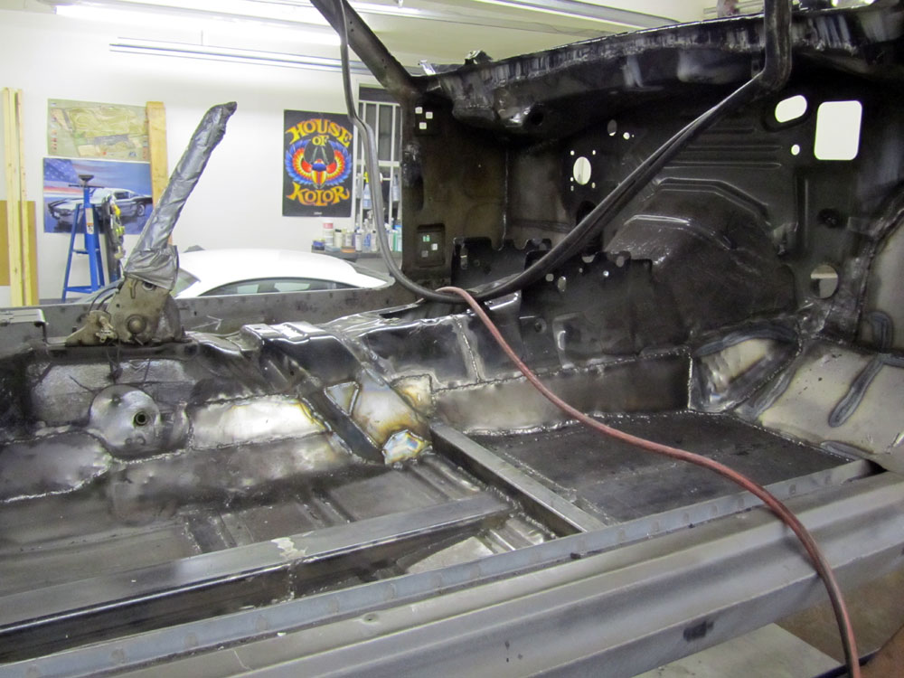

      pieced in the tunnel brace and tied it into the seat crossbrace
      got it up in the air to weld all the joints on the bottom side.
      I still think the bottom of this car is more interesting :P
      Jeff -- 96 Mustang - 2V Stroked Modular Turbo // 13 RAPTOR // 67 Mustang Fastback build - Coyote 5.0

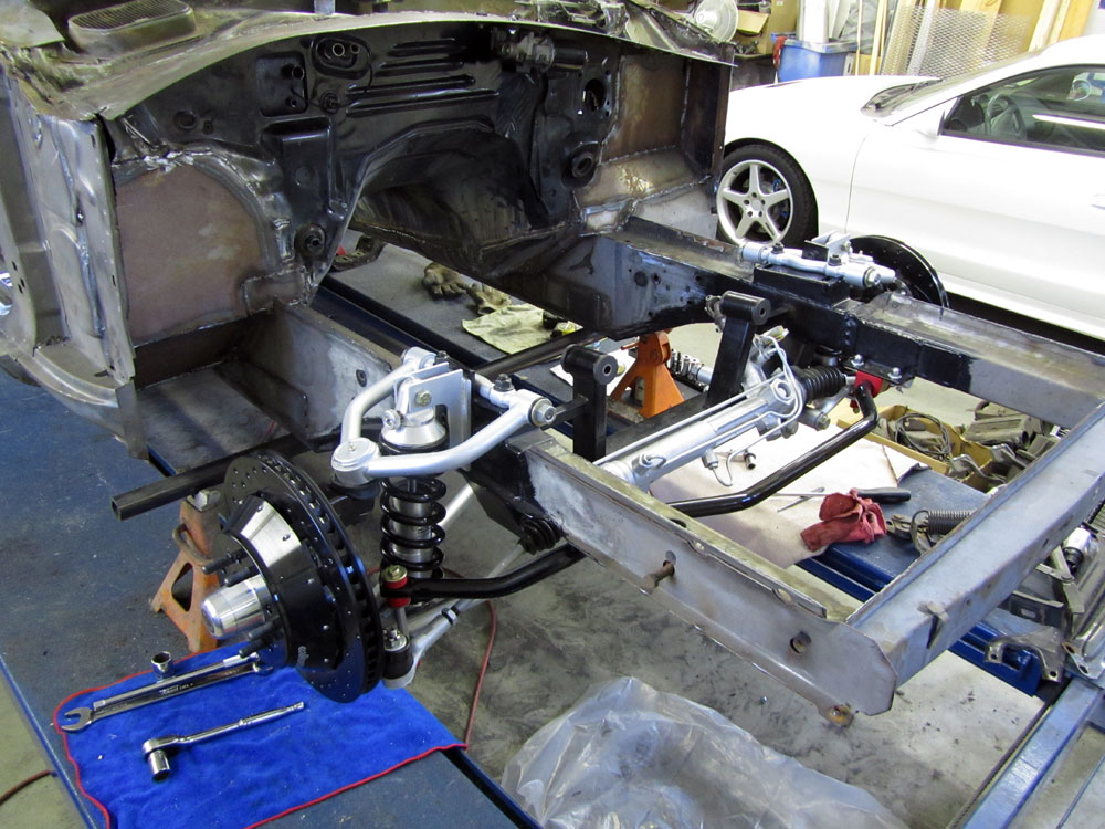

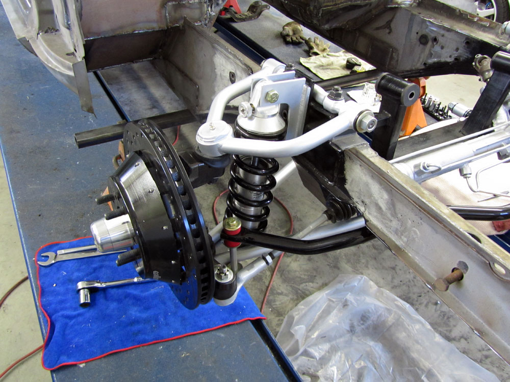

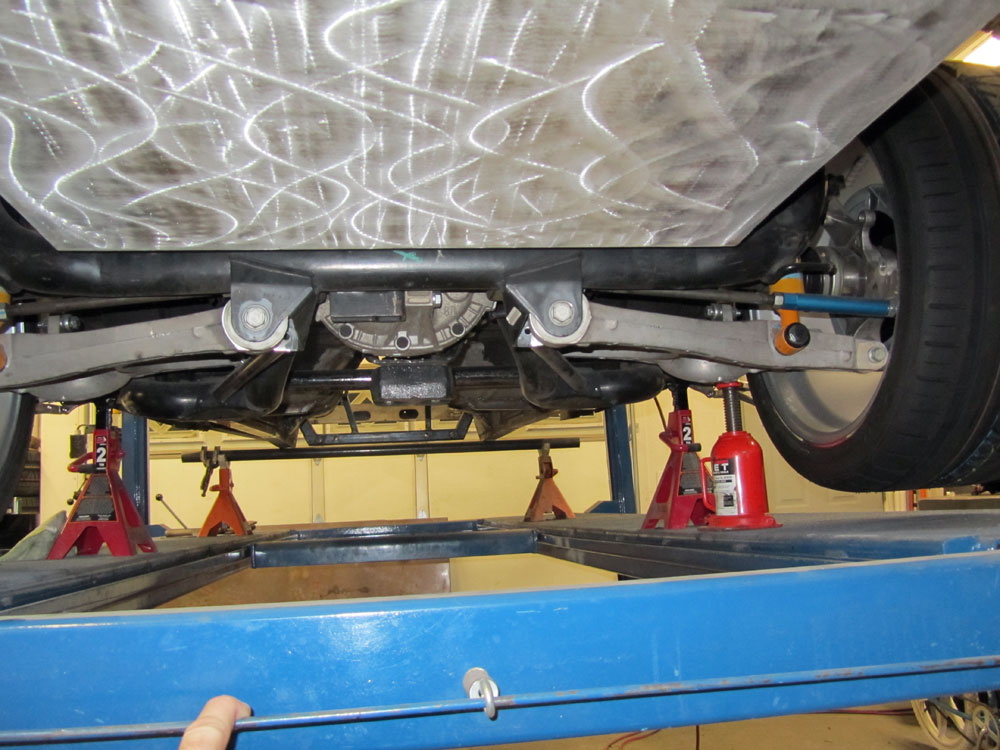

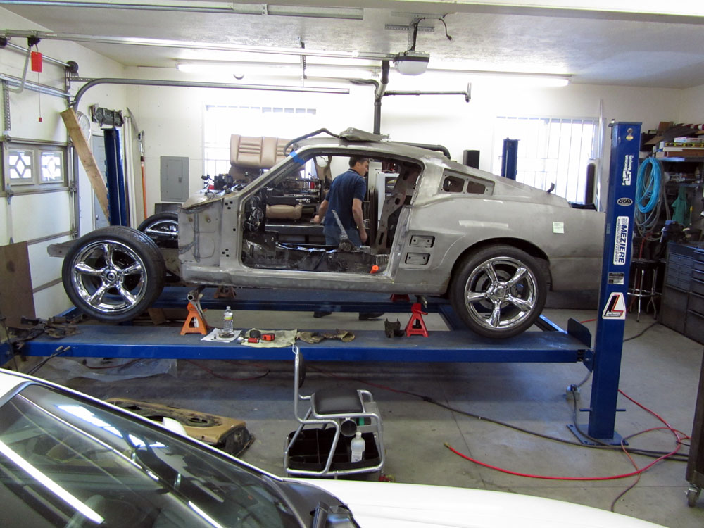

      last weekend's damage:
      Metal prep'd & Pour15 the front inside
      Put the front suspension back on:
      heater core bolts right in!
      Front tires on
      Check out the Hotness:

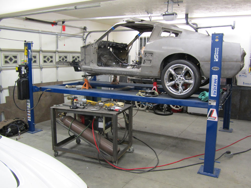

      Whats the height of your garage ceiling?
      Car is looking awesome...
      2014 Chevy SS LS3 / 4 Door
    15. #195
      Jan 2010
      SLC. UT
      368
      Thanks Cobraguy.
      Bonecrusher, it's 10'
      would have loved to go higher, but couldn't.

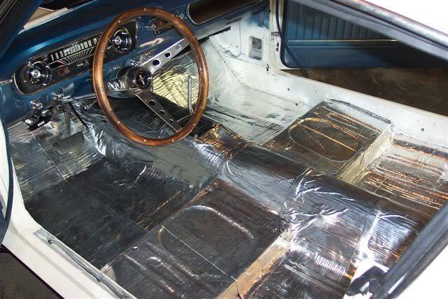

      Looking at some Dampifier to put down on the interior to make it nice and quiet inside.
      has anyone used that stuff?

      Quote Originally Posted by Dalamar View Post
      I used Dynamat on the '65. Every easy to install, and works pretty good as well.

      Like all the custom fab. should be an awsome car. Just a heads up, I had the same front end on my '70 and had some issues with the coilover mounts. The adjustable pieces would never stay in place and I eventually had to tack them to keep them where I wanted them. and over time the vertical piece that holds the coilover mount began to bend inward, so you may want to reinforce that if possible.
      I also had a little trouble keeping the Rod and Customs supplied U-joints tight on the sterring shaft. nothing ever came apart, but it was a neusance since it frequently caused there to be a little play in the wheel. I had the manual rack so I'm sure there was a lot of force put on the steering shaft at times. Hopefully you will have better luck with the power rack.
      Zach
    18. #198
      333
      I've had the same problem with Borgeson steering joints. Even with loc-tite those little set screws seem to back off after a while. I've thought of using normal bolts and safety wiring them, but always worry the wire could somehow bind on the joint at a bad time, although its hard to imagine safety wire being strong enough to bind the steering. Just keep an eye on them and if you're steering feels sloppy check there first.
