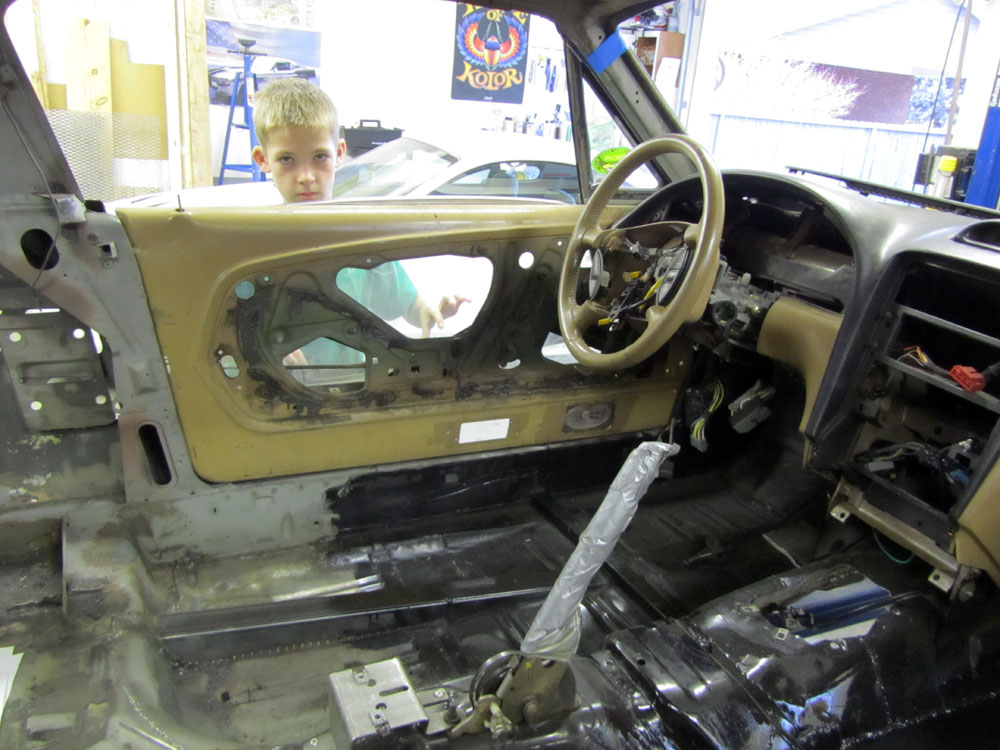

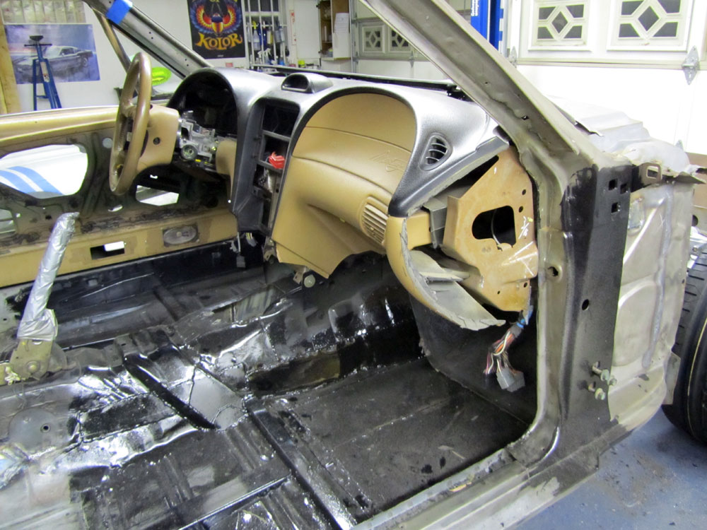

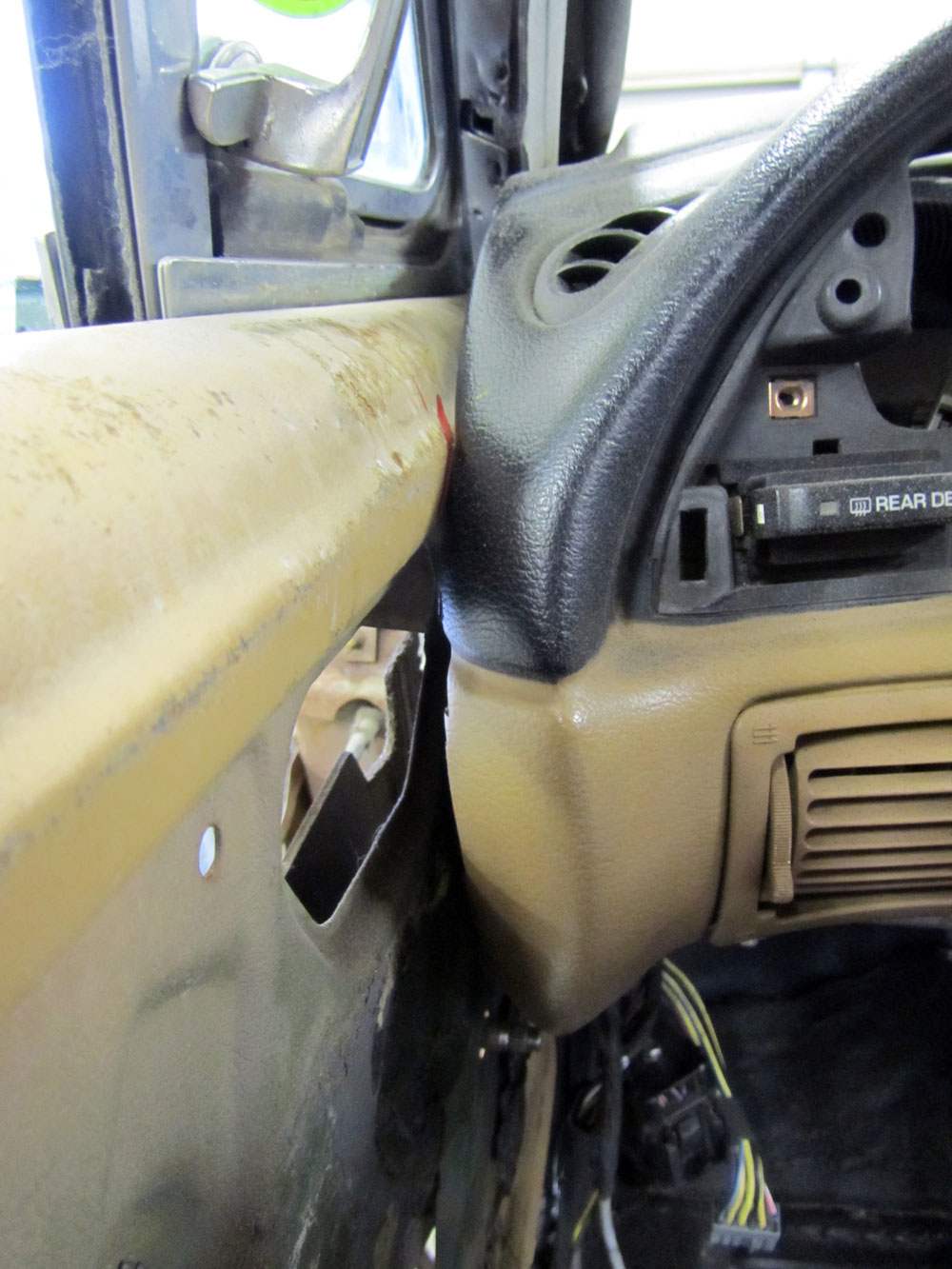

      Todays damage:
      dash back in. see that red line - chopity chop!
      put the steering in - ordered a solid steering shaft from Maximum Motorsports to replace the stock cush-rag.
      will probably have to swap out/chop the end that goes on the rack.
      Cut the dash ends off for door clearance, hung drivers door and checked
      my son Ren.
      Fits better than I thought it would!

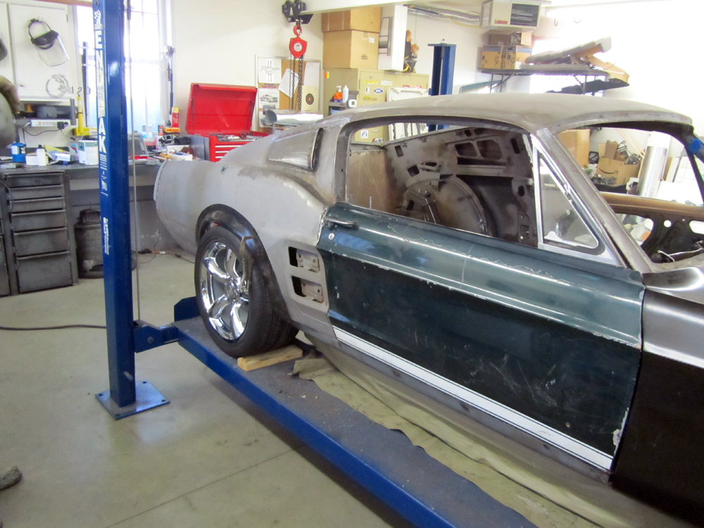

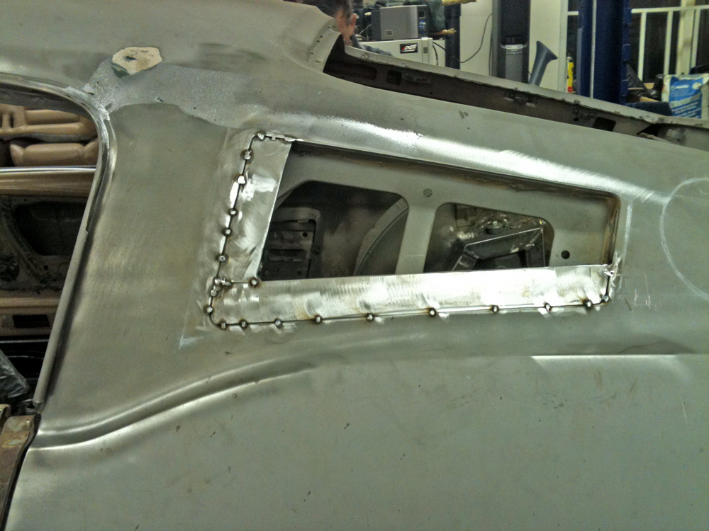

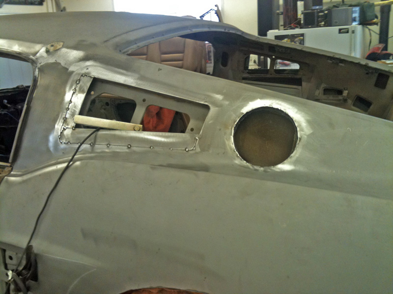

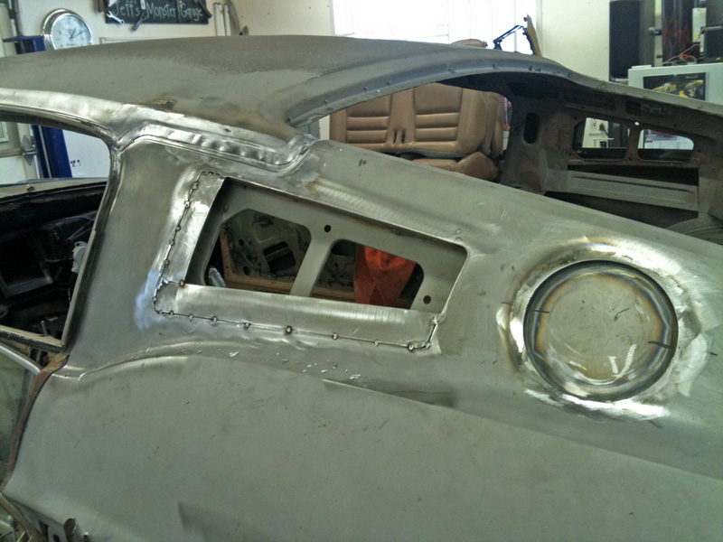

      Not sure if these doors are recoverable? anyone with experience with this sort of thing agree/disagree?
      BTW, Happy 2011! let's get some work done this year.

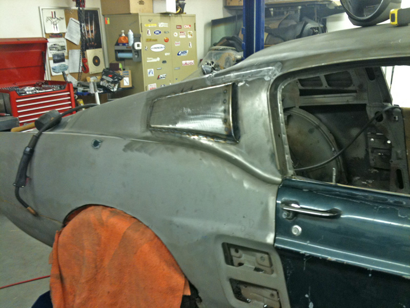

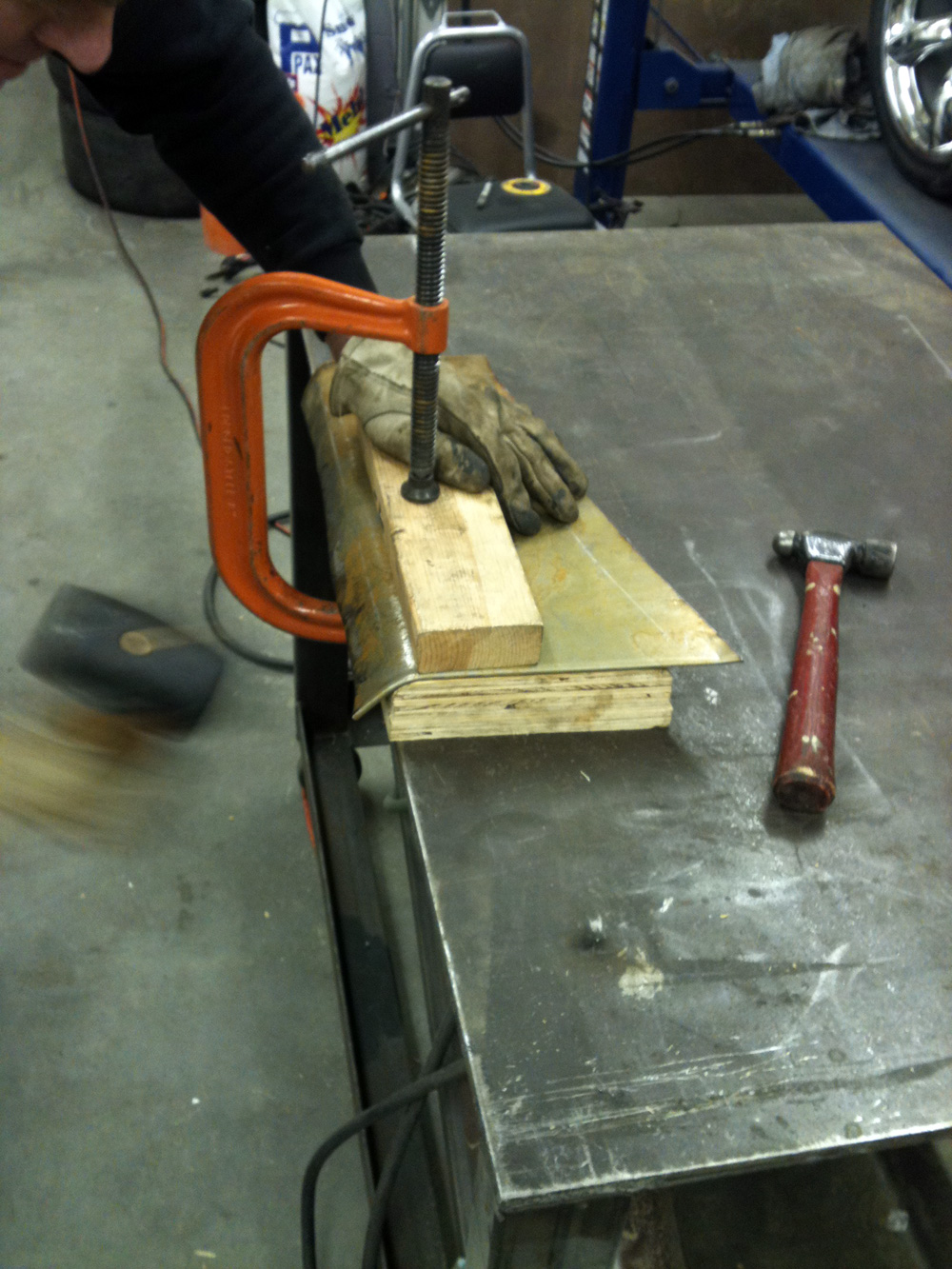

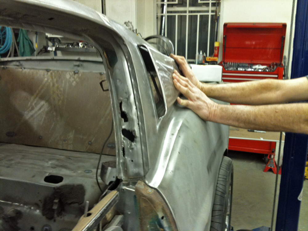

      Still deciding what to do on the doors.... so we did mess with some sheet metal over the last week. *Pillar vent/scoops
      we want a scoop, but more low profile than the shelby scoop.
      look at this picture:
      IMO it's a bit much.

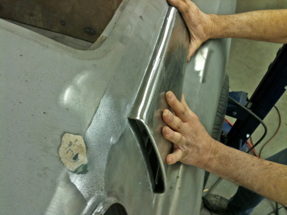

      we want one that doesn't stick out so far and isn't so close to the body line...

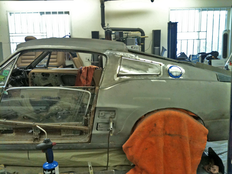

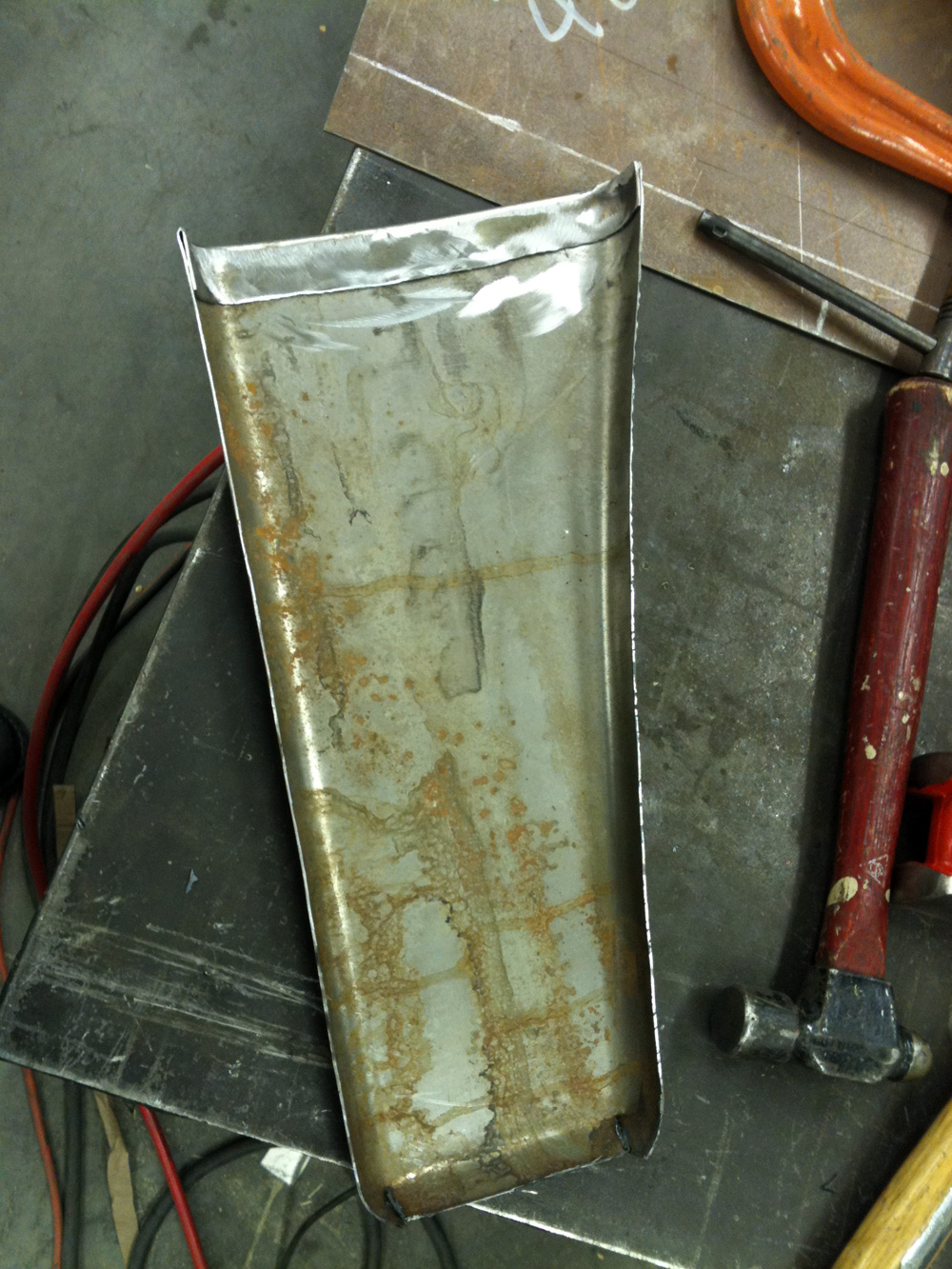

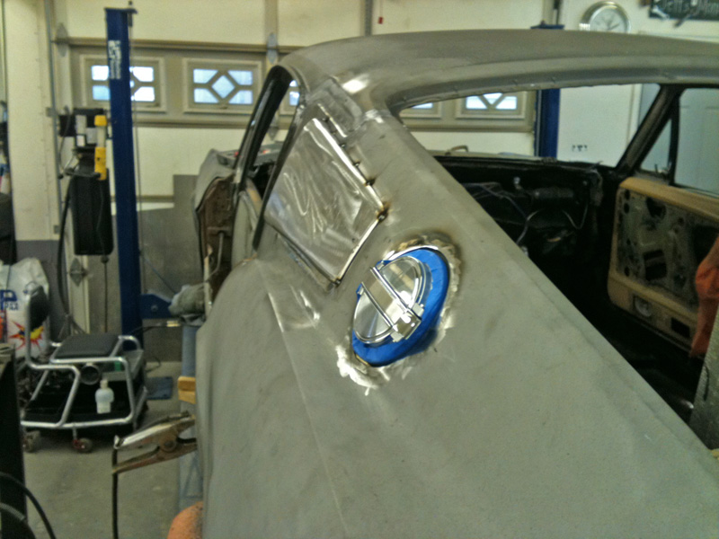

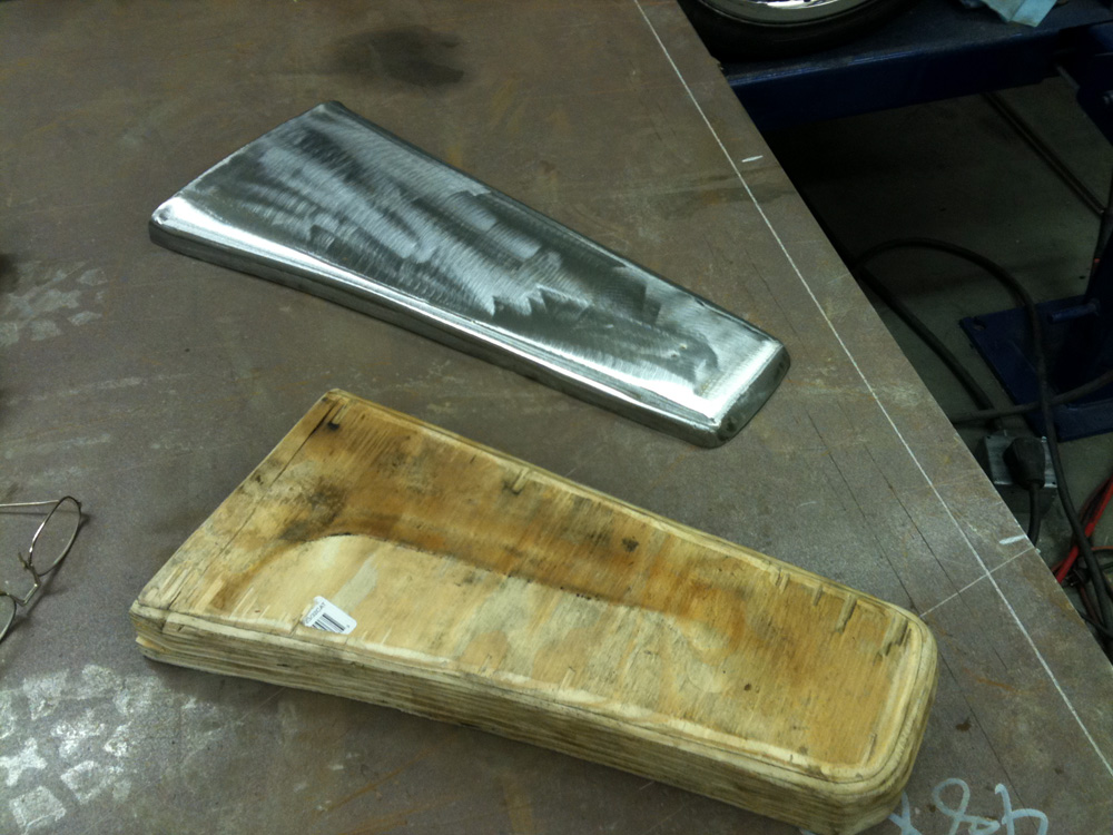

      So we decided to try our had at making one! *
      Made a wooden insert and messed around.
      progress:
      filled in the front and bottom of the hole a bit, the scoop sits a little higher and is a bit narrower.
      Tac'd it into place to stare at it.
      I like the front, but think the back needs to taper down more, maybe flush with the panel.
      Opinions?

      Looks good but yeah bring the back in a little and put a naca duct in there to let some air out. Scott
    10. #210
      Jan 2010
      SLC. UT
      368
      Scott: thinking of having the duct be dammed off about 1" in.
      Jeff -- 96 Mustang - 2V Stroked Modular Turbo // 13 RAPTOR // 67 Mustang Fastback build - Coyote 5.0

      Nice! In my opinion it might look a bit better if you made it follow the fender contour a little but more.. such as make the bottom front drop down a bit more or raise the back part of it a bit more. or am I not explaining myself well?

      Nice fab work! I agree wit hyou it looks better with the back tucked in closer.

      Excellent! The scoops look great! Ive always liked the Shelby scoops but the idea of smaller ones never even occured to me. Awesome! Keep it up!

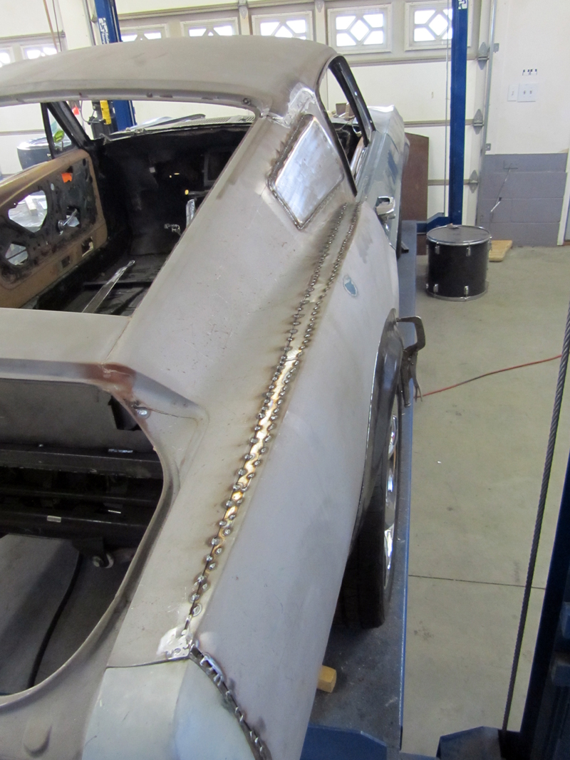

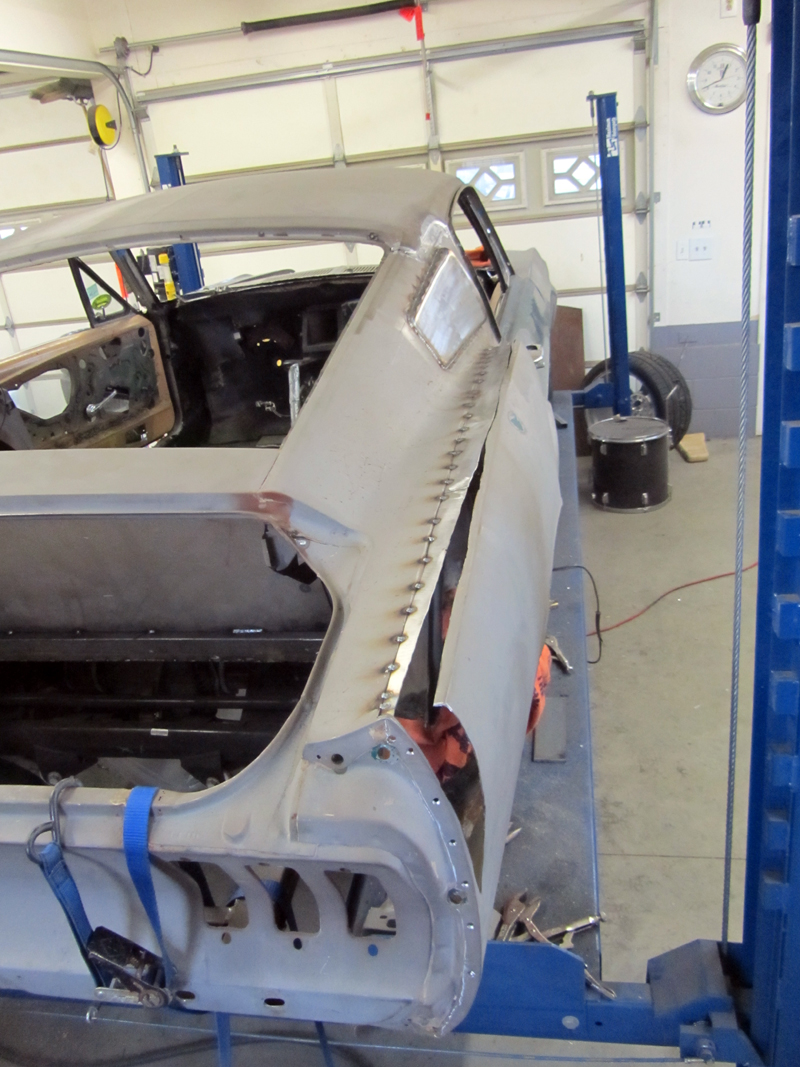

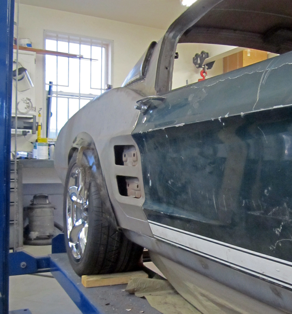

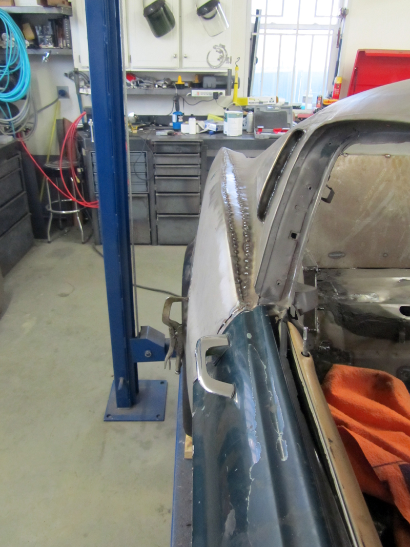

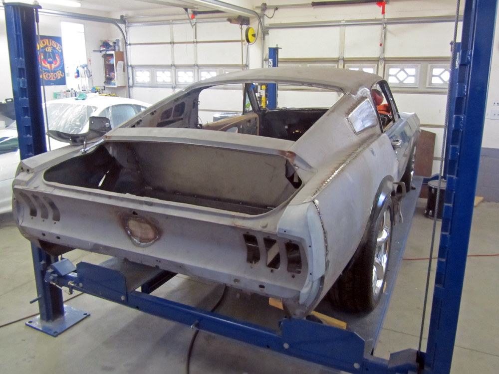

      In order to accommodate the wider IRS and 10" wheels/tires, we wanted to wide body the rear fender and keep the stock flair vs putting on a huge flair.
      moved the fender out 1 7/8" in the center, radius tapered out to the ends.
      Progress pix:
      (like my dad's nice straight cut!)
      3 tedious check, tac, check hammer, check..... hours later:
      stock flair clamped up
      Still have to do the other side, tie in the bottoms, and extend the inner fender wells & weld all that stuff off.
      Also want to extend the side skirt to make it taller and flair it out in the back a little.

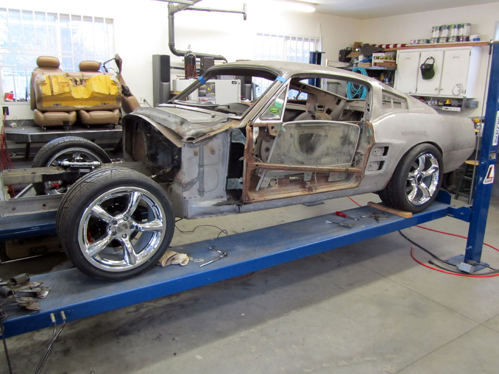

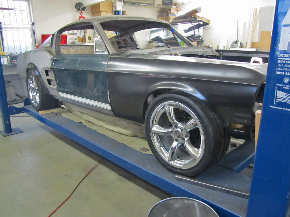

      Few more fun Pix:
      this shot got me excited!
