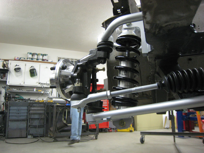

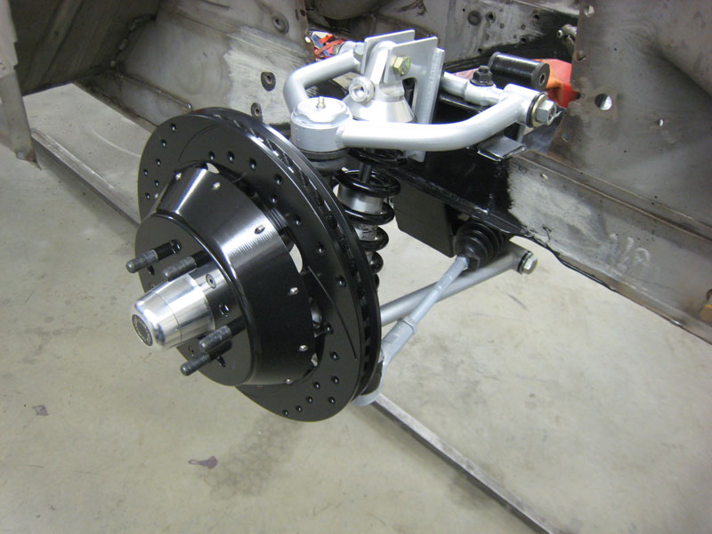

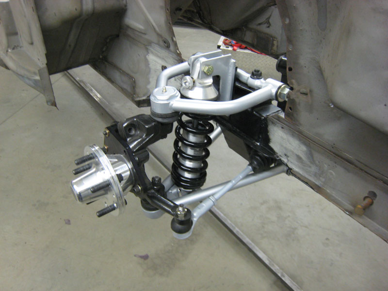

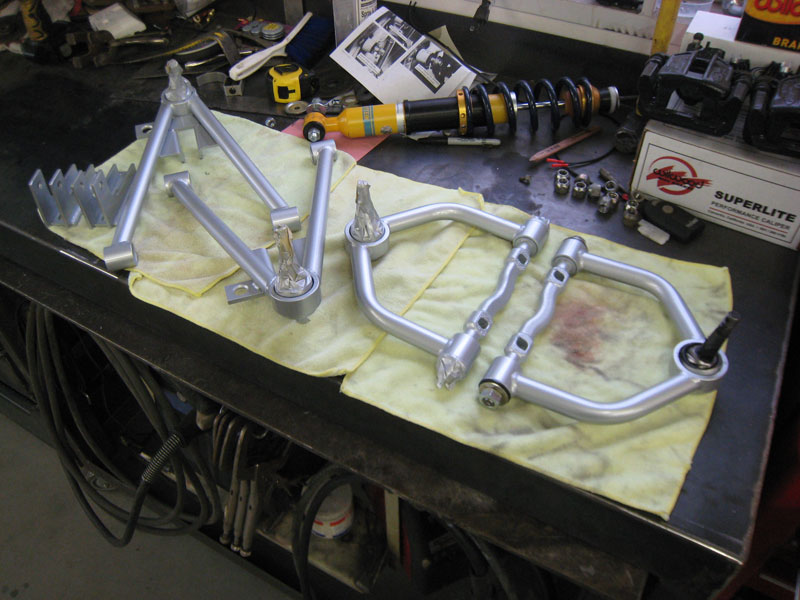

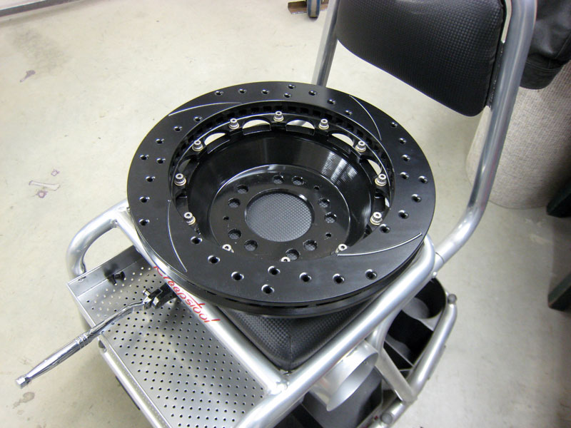

      Had the front suspension parts painted:
      Looks AWSOME assembled!

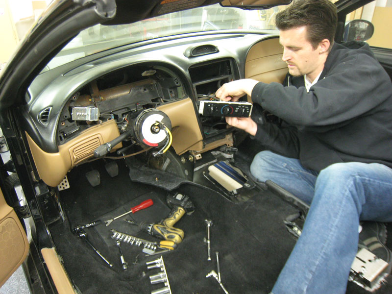

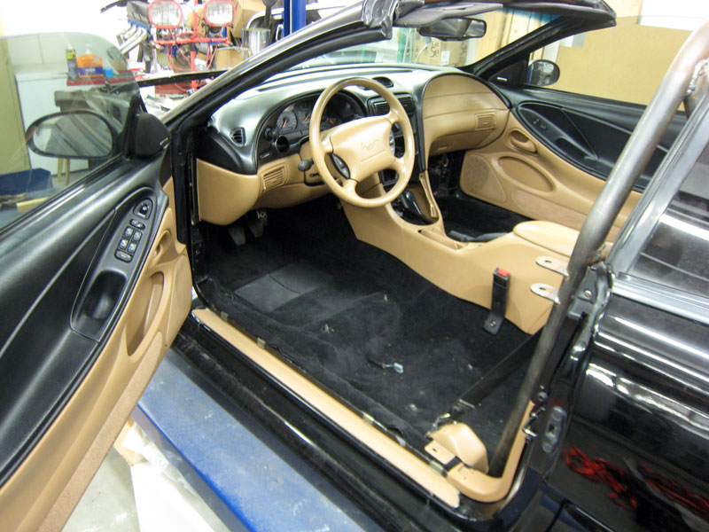

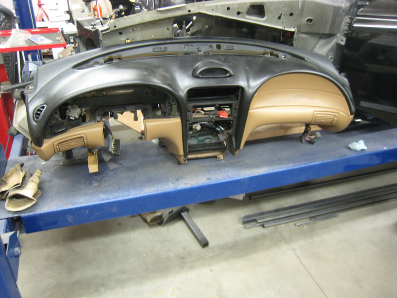

      Now for the interior....
      picked up this about a month ago.
      the plan is: Putting all this..... in there.
      (don't think the door panles will fit)
      Jeff -- 96 Mustang - 2V Stroked Modular Turbo // 13 RAPTOR // 67 Mustang Fastback build - Coyote 5.0

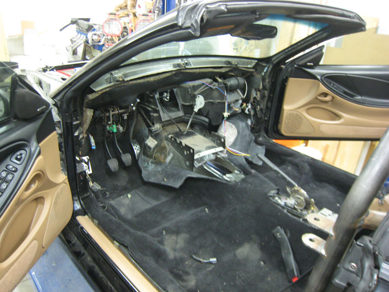

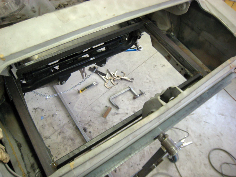

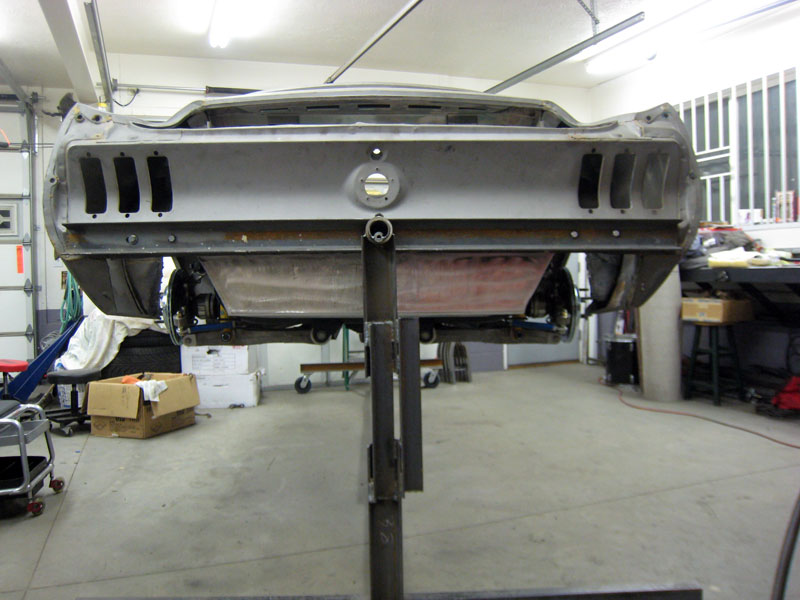

      here's what we did last night:

      I would add the passenger side torque box. It will strengthen the body greatly. I did so on my 67 coupe and I can now pick it up like its a nascar.
      Thomas Markus
    11. #91
      Jan 2010
      SLC. UT
      368
      Quote Originally Posted by SamHatco View Post
      Reminds me of when I put my 04 GTO dash in my 69 firebird. Good luck with the install. I know it will look cool.
      Sam
      Thank you, I saw your build, the interior turned out awsome. nice work
      Thanks Garner
      Quote Originally Posted by hivewax View Post
      I see something wrong here... a perfectly good late-model Mustang being torn apart!
      The shell of a mustang, the car's been parted out.
      or were you being funny?
      Quote Originally Posted by mustangmanic67 View Post
      Thanks for the fedback.
      Somebody else recommended that, I looked at it and don't realy see how it's necessary. is your rear suspension riding on leaf springs?
      This car basically has a frame from the K member to the back, and the IRS has that pipe frame tying the sides together.
      I could see a brace between the coilover mounts...
      I know on the Fox and SN95 mustangs "torque box" reinfocements are mainly due to bind in the 4-link suspension
      and or the wrong part or bushings that don't allow the upper arms to twist. Not really necessary if your suspension articulates as it's supposed to on those cars.
      I do appreciate the feedback.
      What do you all think?

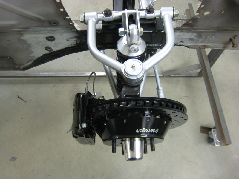

      Nice build. What are the part numbers for the Wilwood brakes in front? Would 17" wheels work with the brake set up?
      Not sure the part numbers, I linked where I got them from earlier in this thread - from Rod and Custom Motorsports. you would need to get the correct brake brackets for your application.
      I would think so, measureing from the center of the hub to the outside of the Calipers is 7"

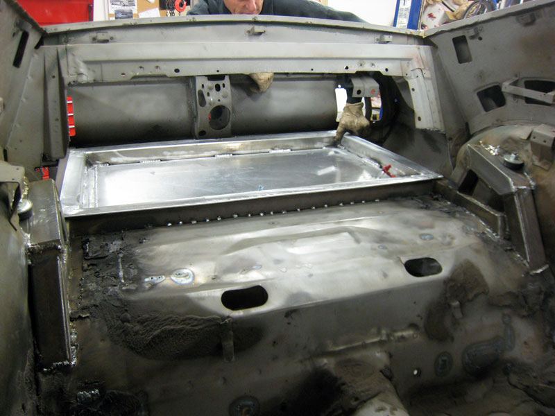

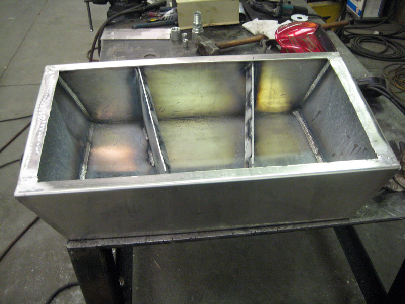

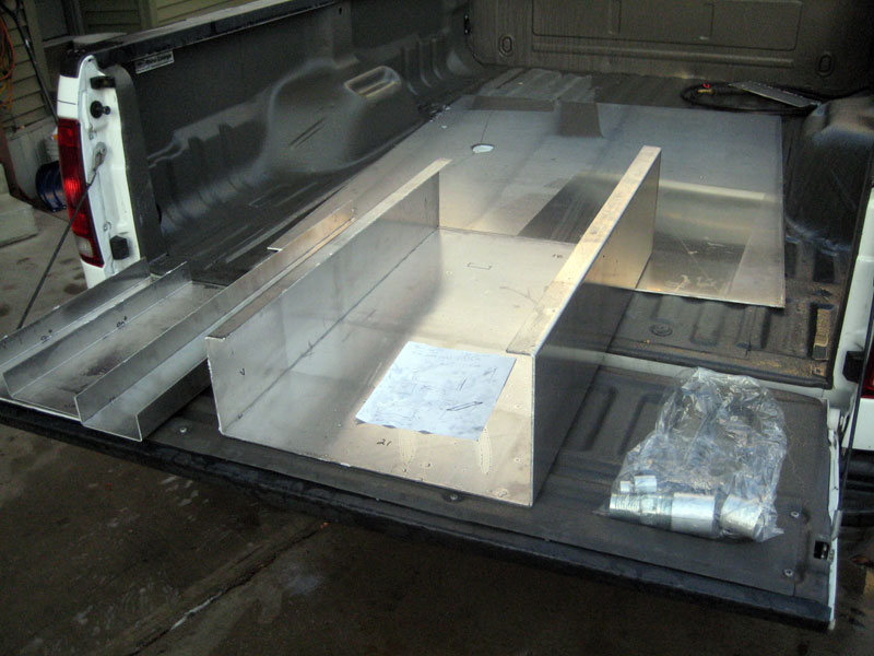

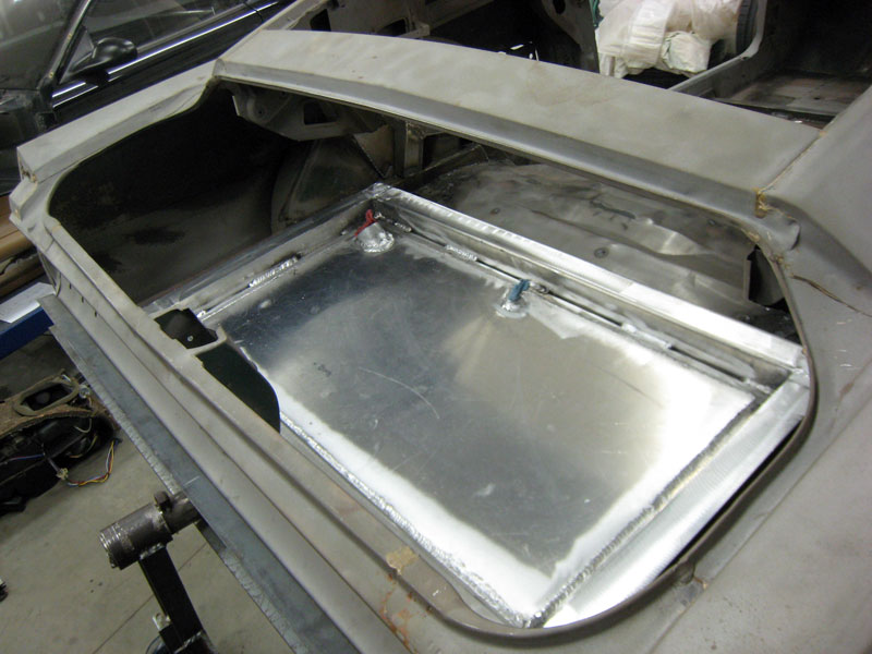

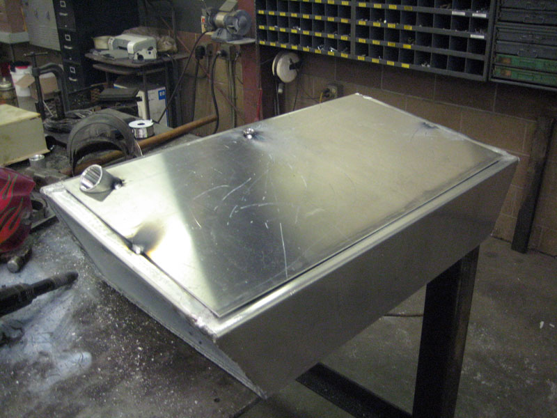

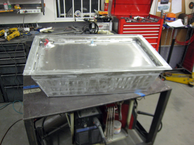

      We Fab'd up the aluminum fuel tank over the weekend.
      Not to worry, my dad was ASME certified, and knows how to build stuff like this.
      It's 24 gallons.
      Here's some progress pics:
      Test Fit
      It will be out of sight, behind the body panels
