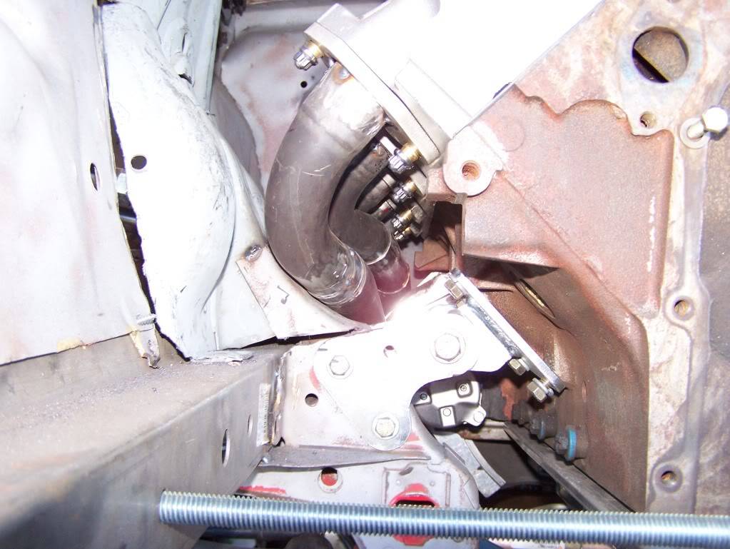

      I don't think changing the pan and mounts would gain enough to give us the clearance. the K member is centered with the tires, so we can't really move that back.
      Better weight distribution would be nice! know of a good rear mount transmission?
      After swapping the fire walls, there's even more space behind the motor, that's true. We're looking to make up a cover for the back and sides once all the accessories are installed so the bay is nice and clean.

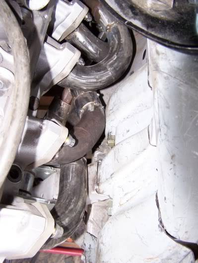

      I called R&C and there's really no other rack option, so it looks like i'll have to piece together 3 of the 4 tubes on that side.
      Hey chunger, yea baby, love the C!
      your right on that. the headers are Hooker's. I had them hot jet coated inside and out. Guess I could have them coated again after surgery.

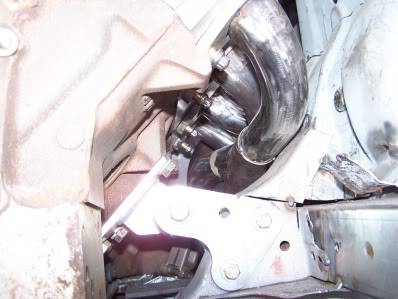

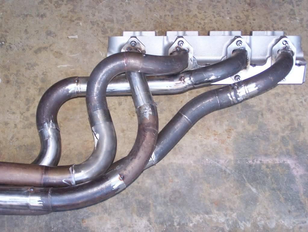

      Thanks for the pictures GT500KR. Nice to see i'm not the only one with this "headache"

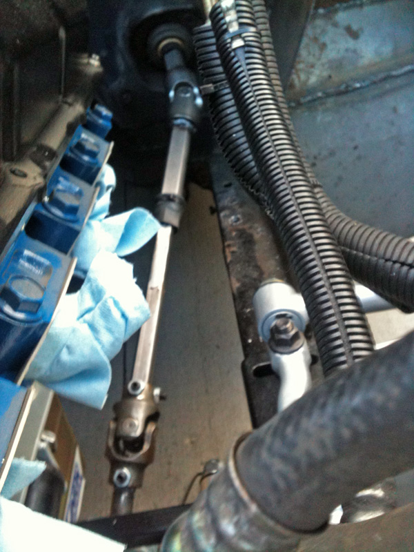

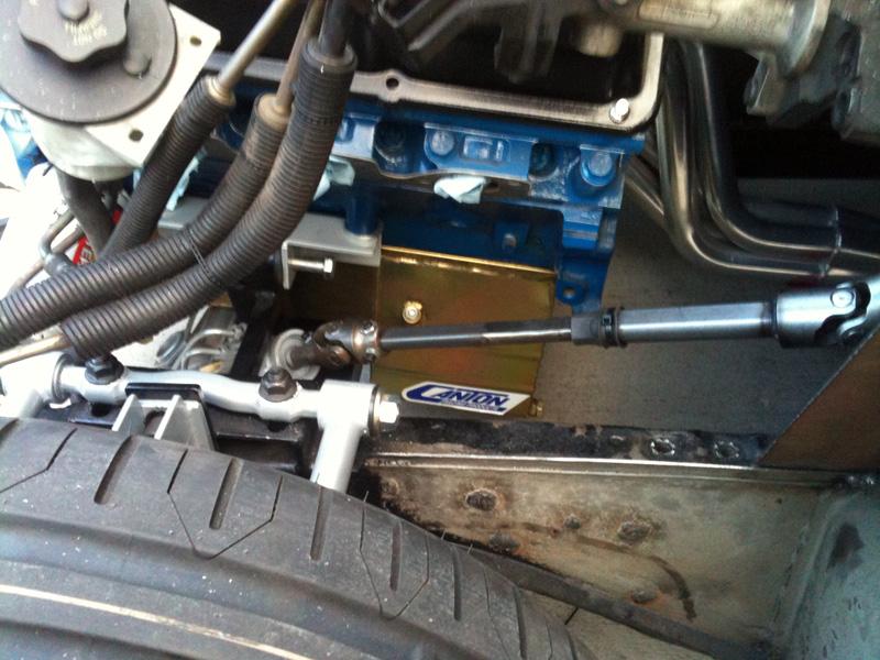

      This steering shaft from the 97 firewall is a bit unusual.
      Looks like i'll be trying my hand at piecing a header together!!

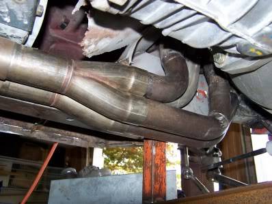

      Jeff if you are going to rework the headers maybe start with something like these http://cgi.ebay.com/ebaymotors/C3-ya...Q5fCarQ5fParts I bought a few sets and reworked them for my mustang with a 427 Scott

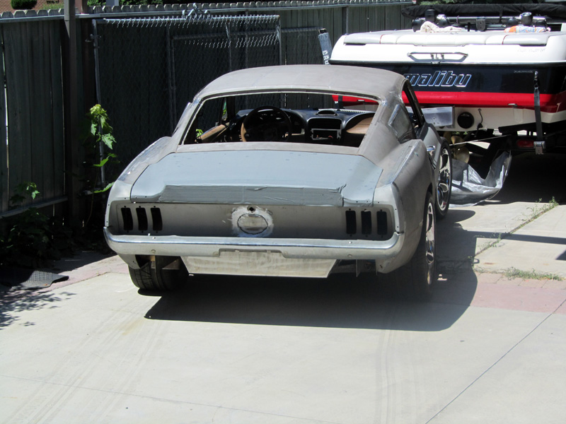

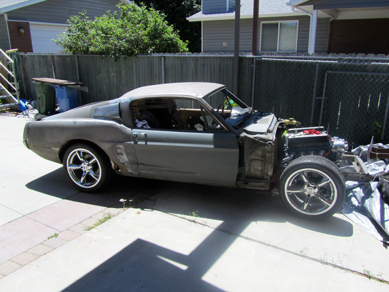

      Few fun pics
      Jeff -- 96 Mustang - 2V Stroked Modular Turbo // 13 RAPTOR // 67 Mustang Fastback build - Coyote 5.0

      Thanks for that Scott! I'll check that out.

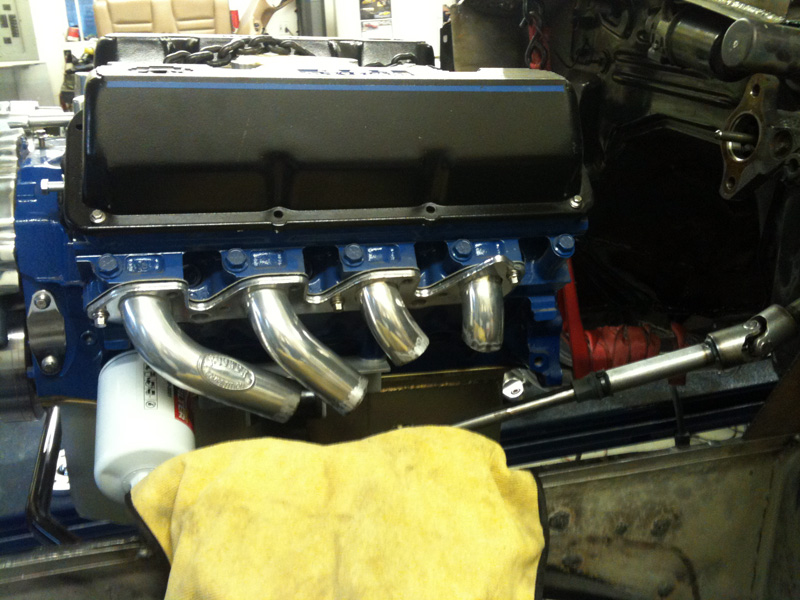

      we extended the MM steering shaft - "V"d the joings, hot stick welded and ground smooth.

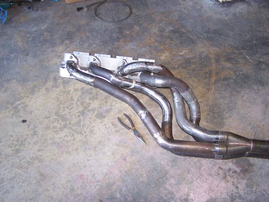

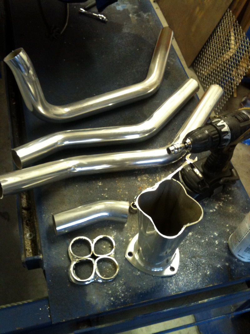

      working on the header mod , it's a few weeks out.
      those Nascar used pieces were a little spendy. my aim is to rework these, same collector then get them re-hot jet coated.
      [insert header here!]

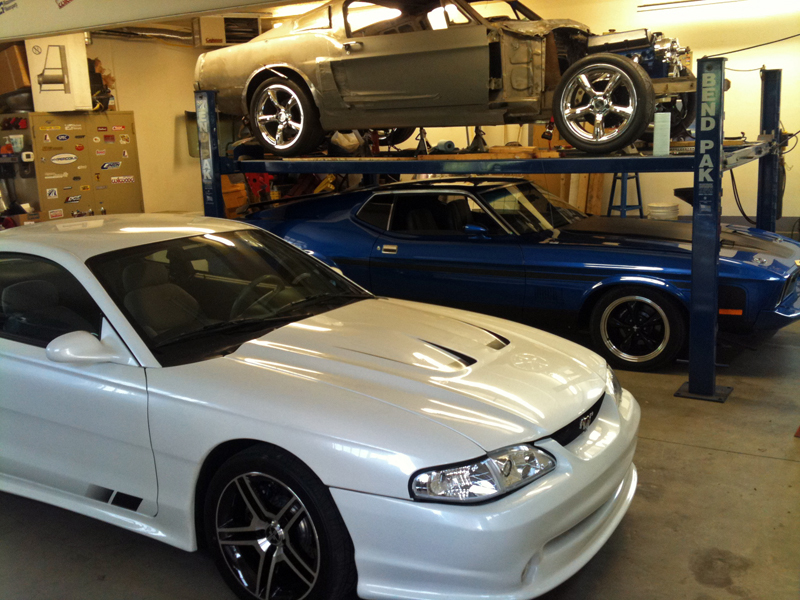

      Few other fun shots.

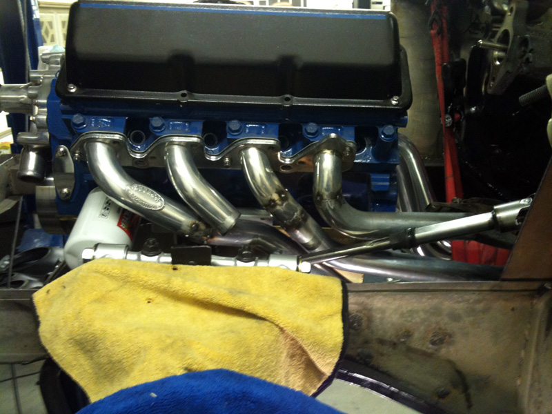

      Man, my summer has been way to busy!
      "cut" into it tonight
      This is as far as I got tonight using the pipes I cut off it

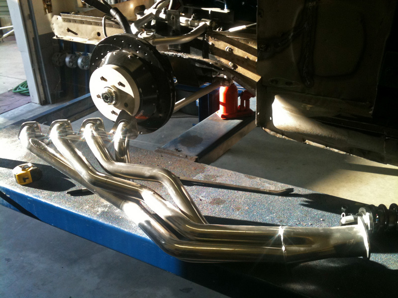

      picking up some pre bent tubes to finish up the header tomorrow :D
