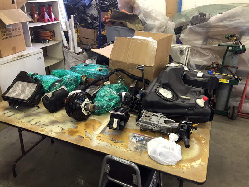

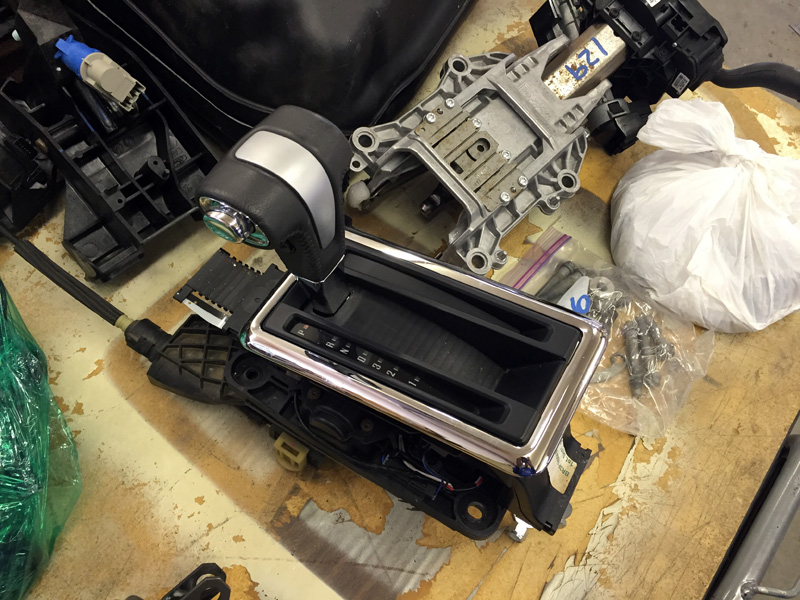

      It came with all this Cool stuff!
      Thanks for the suggestion GTOtzel, if I had a manual, that looks to be a good addition.

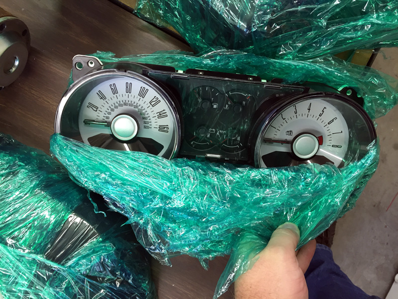

      Good sign...
      Like the cluster.

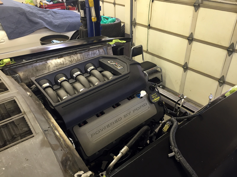

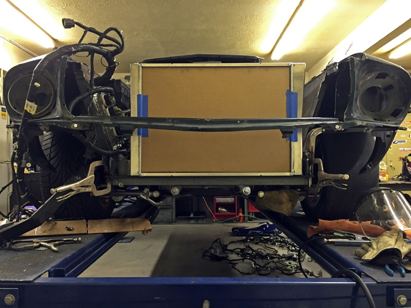

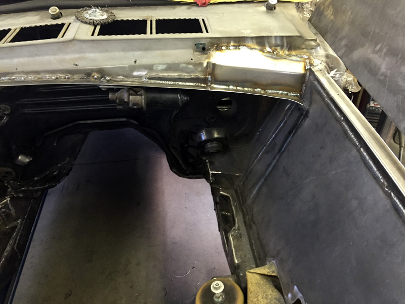

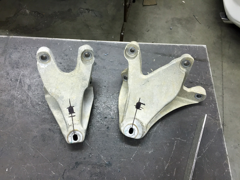

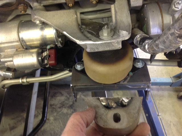

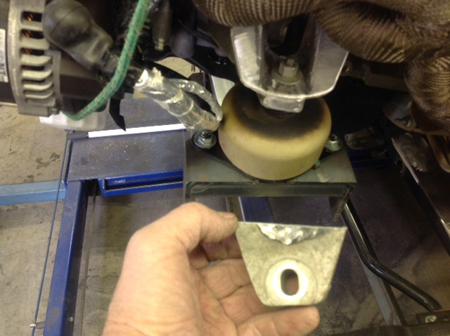

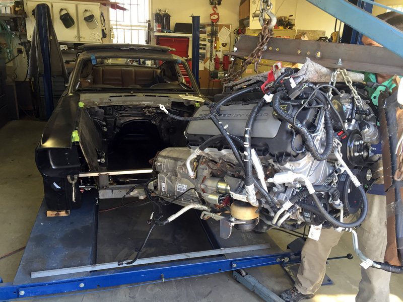

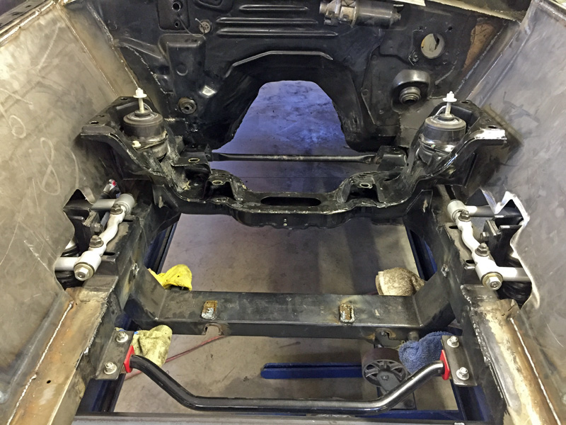

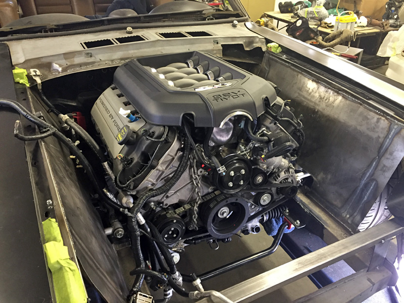

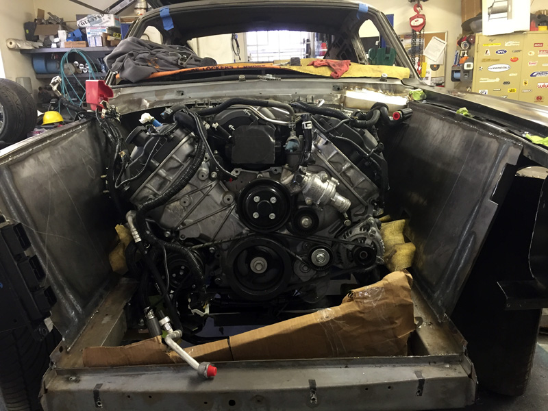

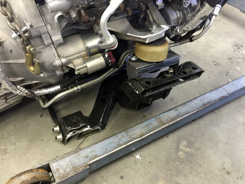

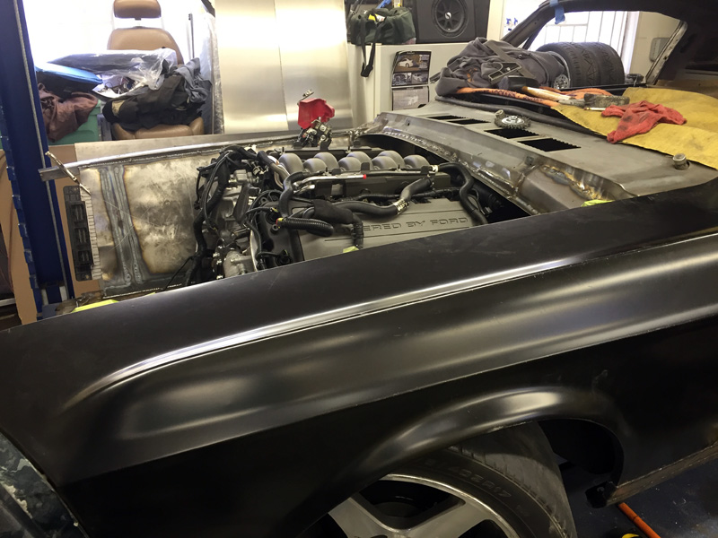

      So we got this thing in the car.

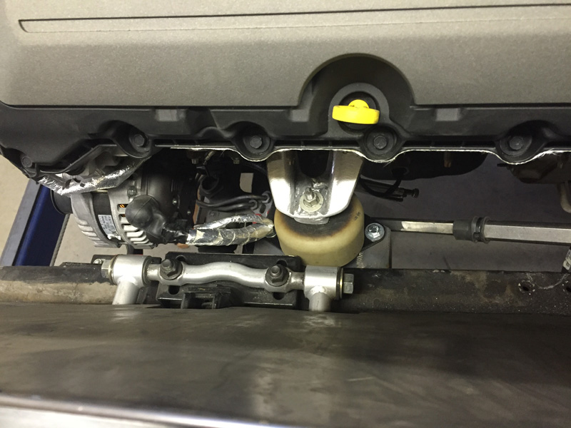

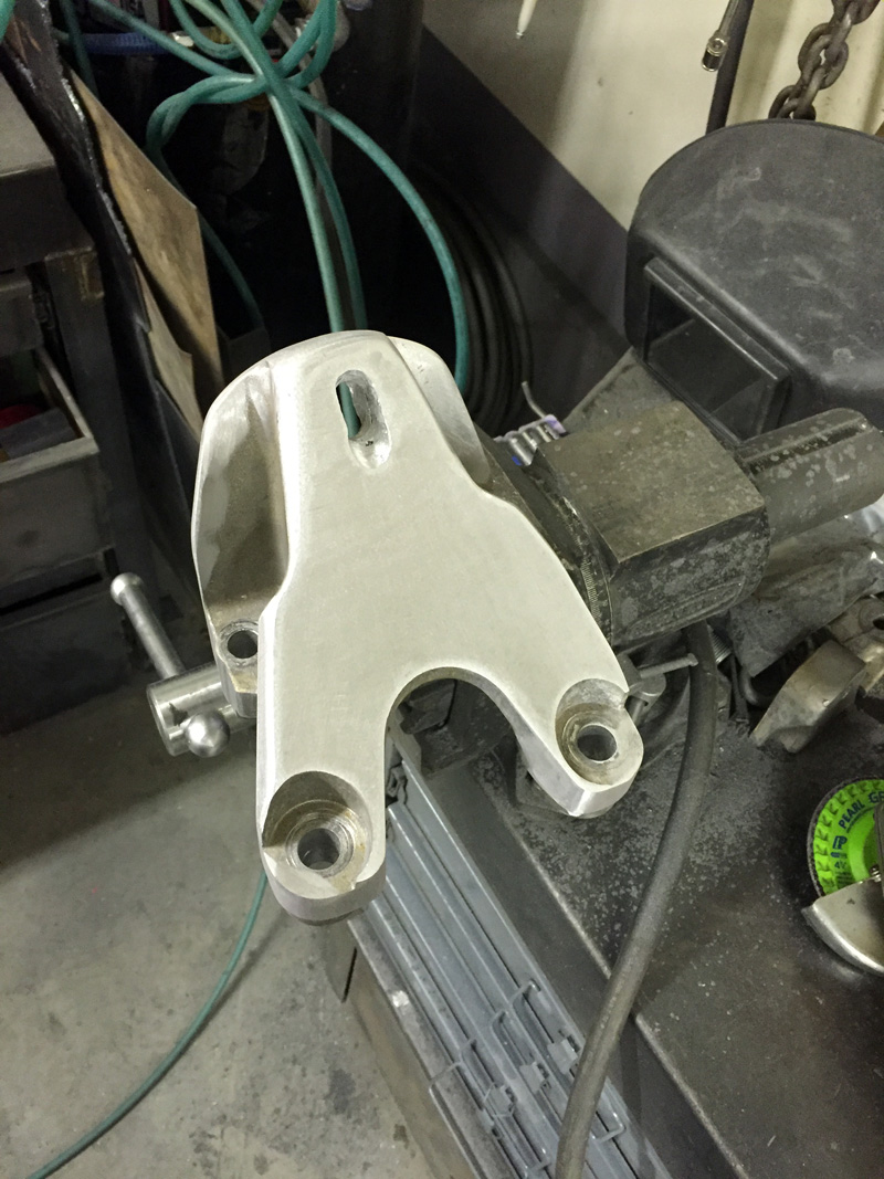

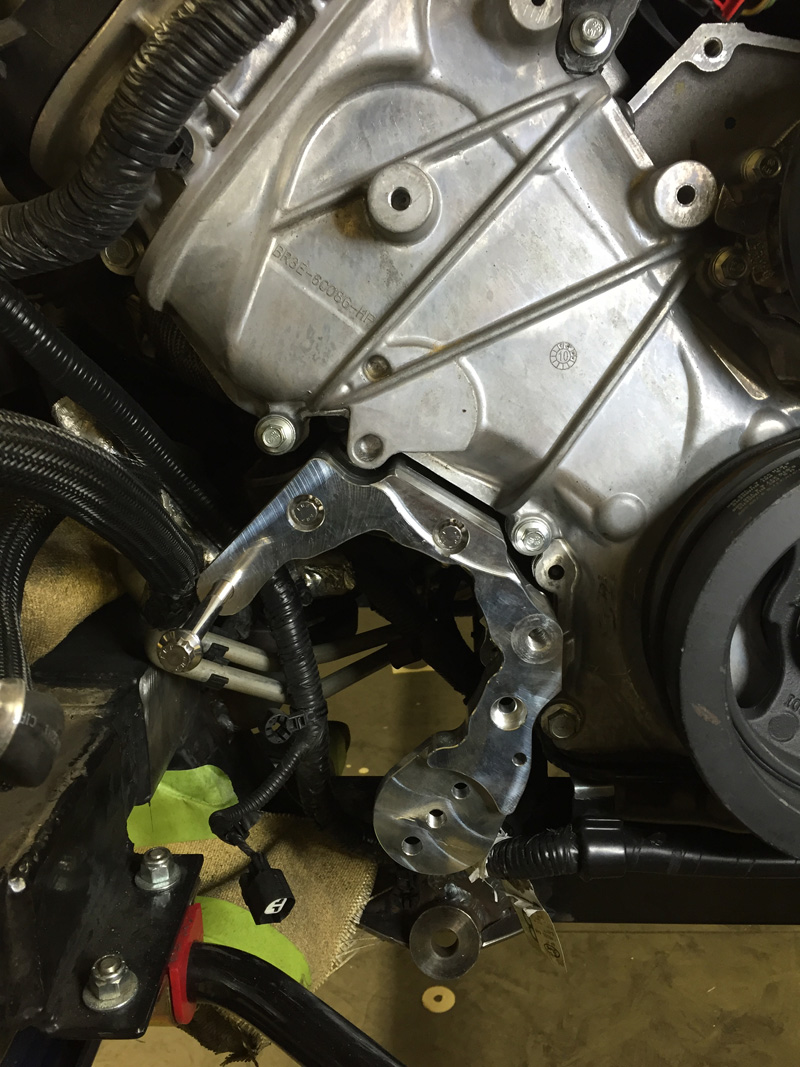

      Here you can see the motor mounts are right where the suspension and Kmember brace are mounted, width wise.
      We looked at it a few ways and filled out and cut back the motor mounts about 2" to fit inside the frame.
      this puts the mounts (fluid filled) in about this far compared to the stock mounting position. I love how the headers are above and very easy to get to.
      Jeff -- 96 Mustang - 2V Stroked Modular Turbo // 13 RAPTOR // 67 Mustang Fastback build - Coyote 5.0

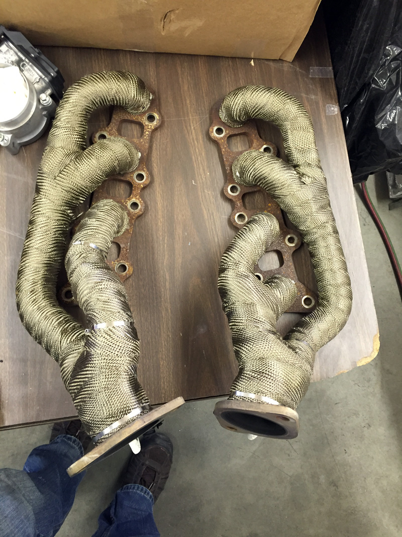

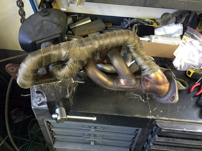

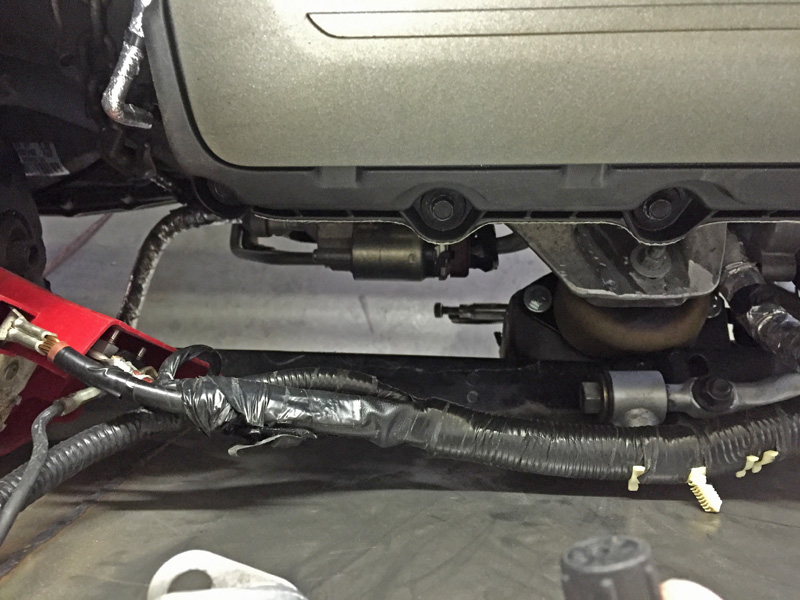

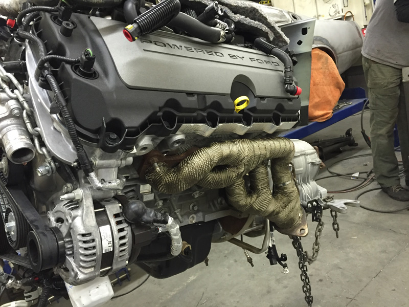

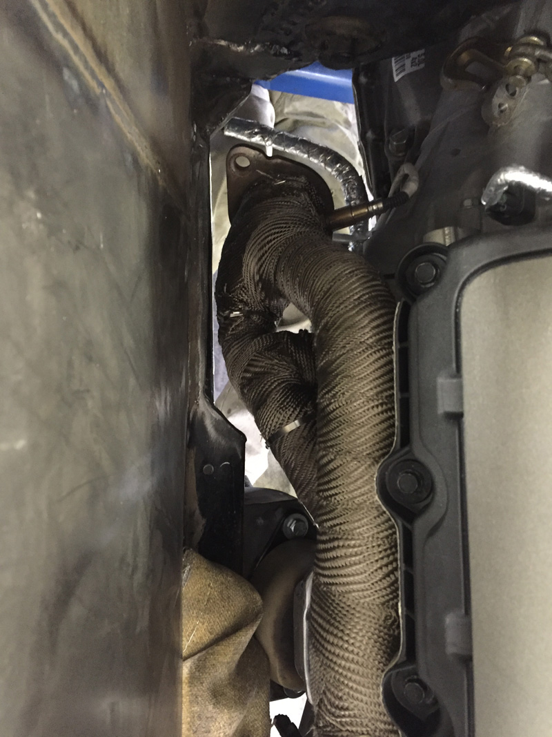

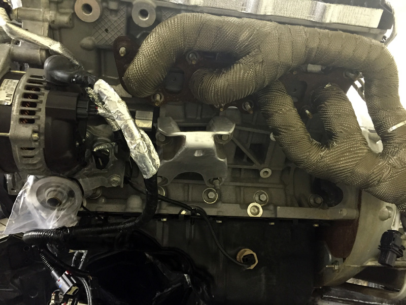

      Also wrapped the headers while they were off with DEI's Titanium mesh.
      It goes on easy and turned out nice.

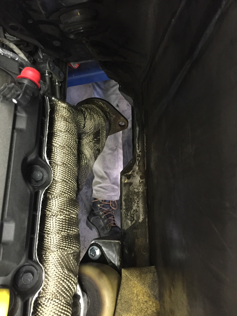

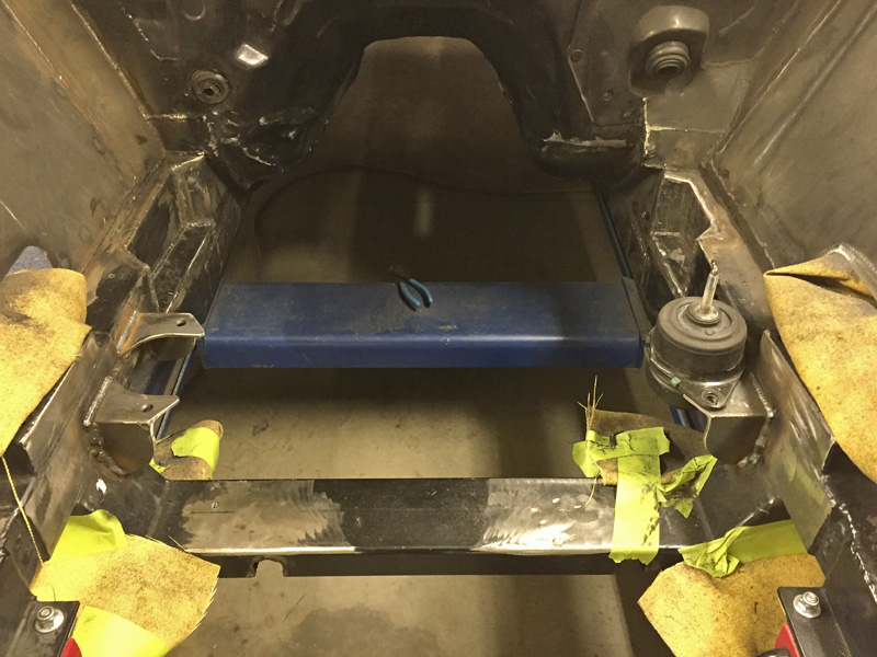

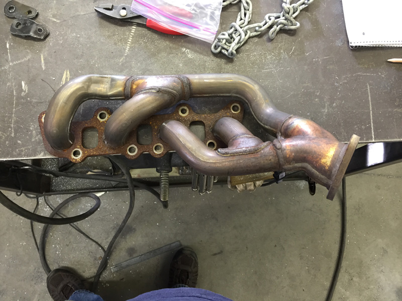

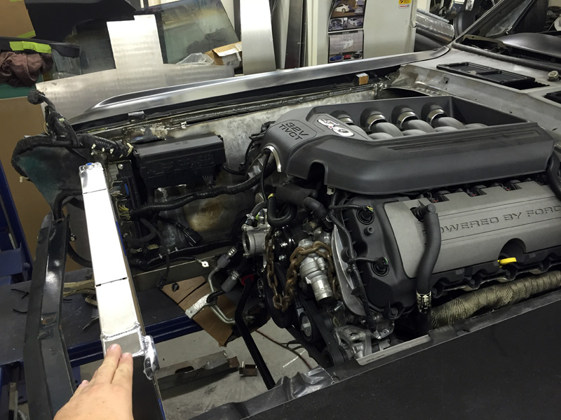

      fitment was all good except the collectors were a bit wide, pulled to motor to notch the frame and do a lil welding.
      Motor Mount modified
      And back in. Fitment is great!

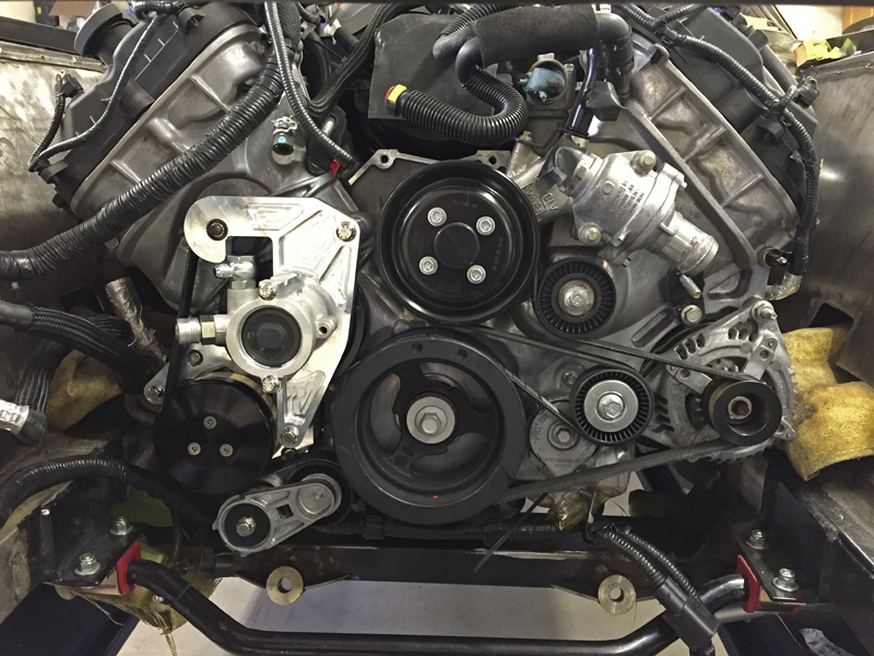

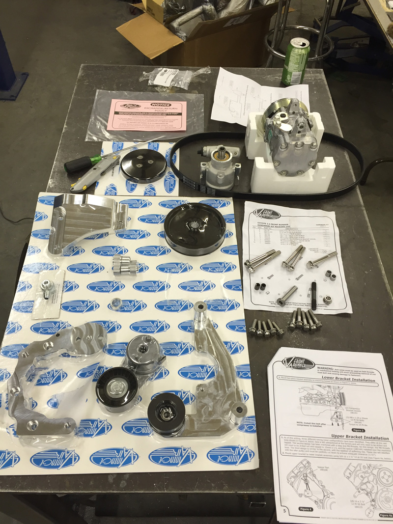

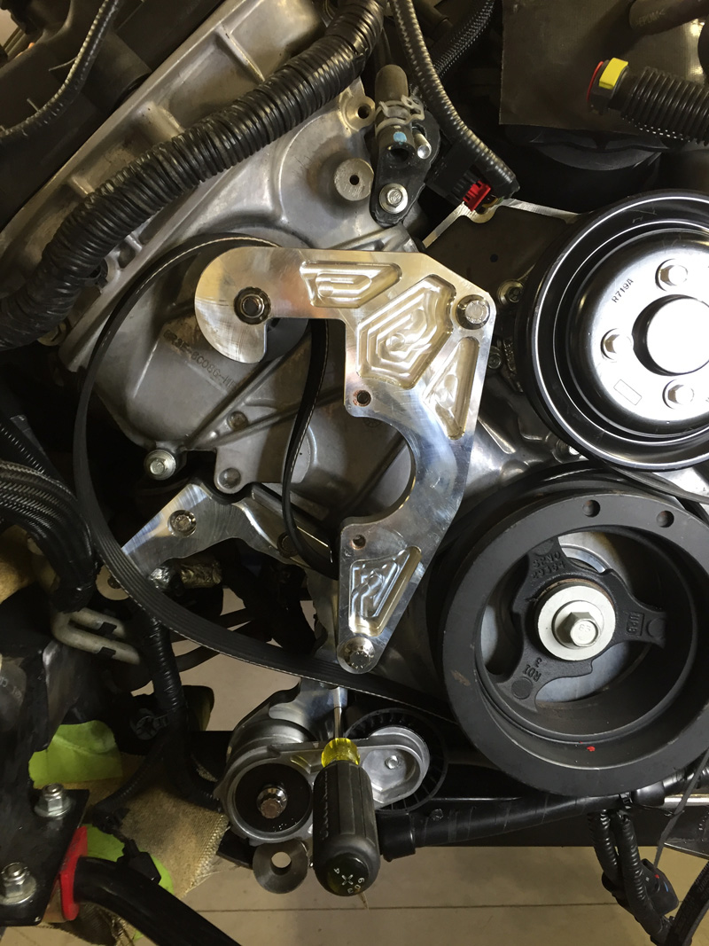

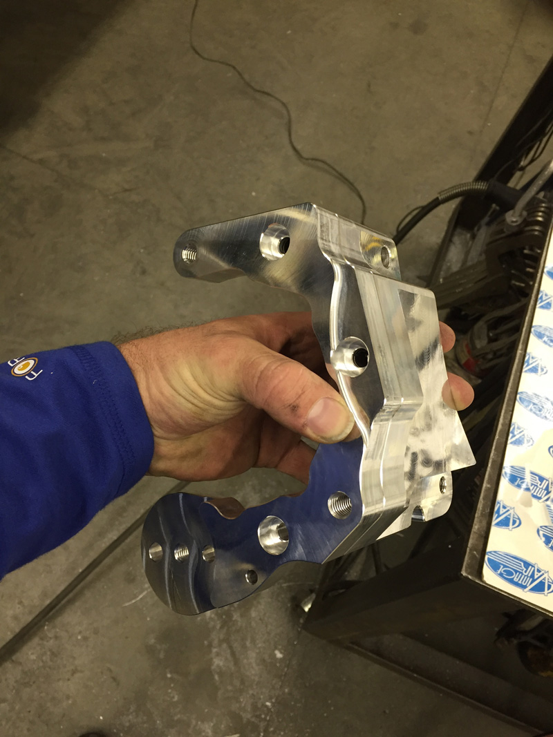

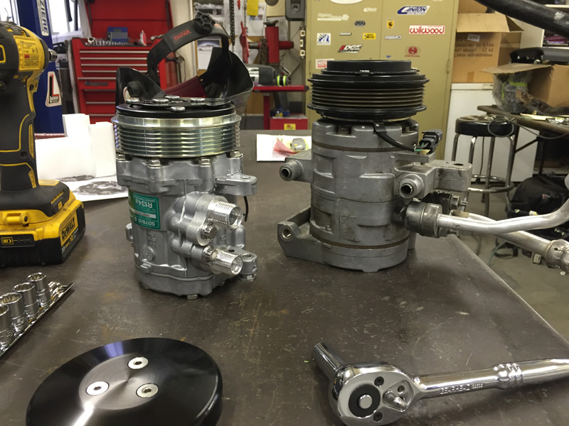

      I picked up this power steering accessory kit for the Coyote.
      Installation wasn't too bad. getting the pulley on the pump shaft was the biggest pain.

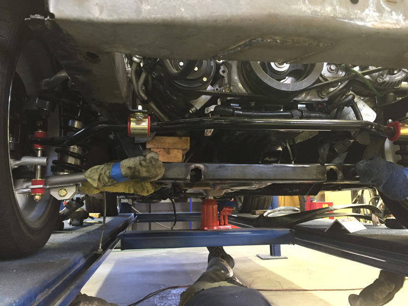

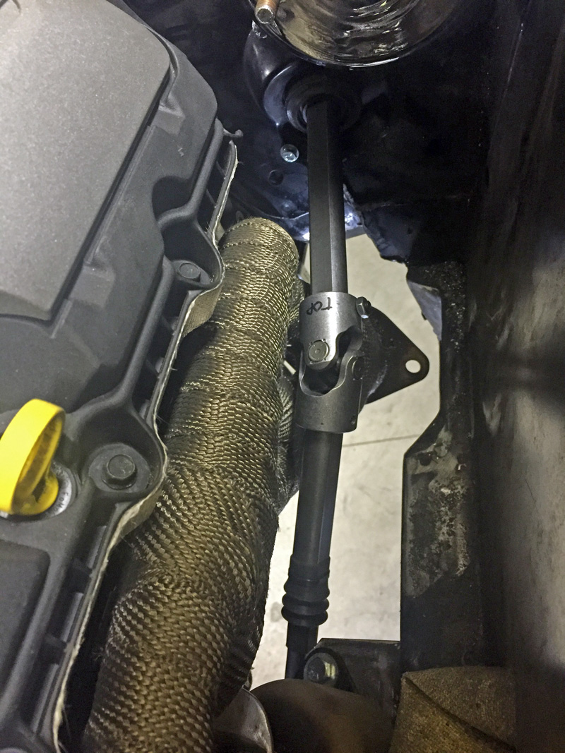

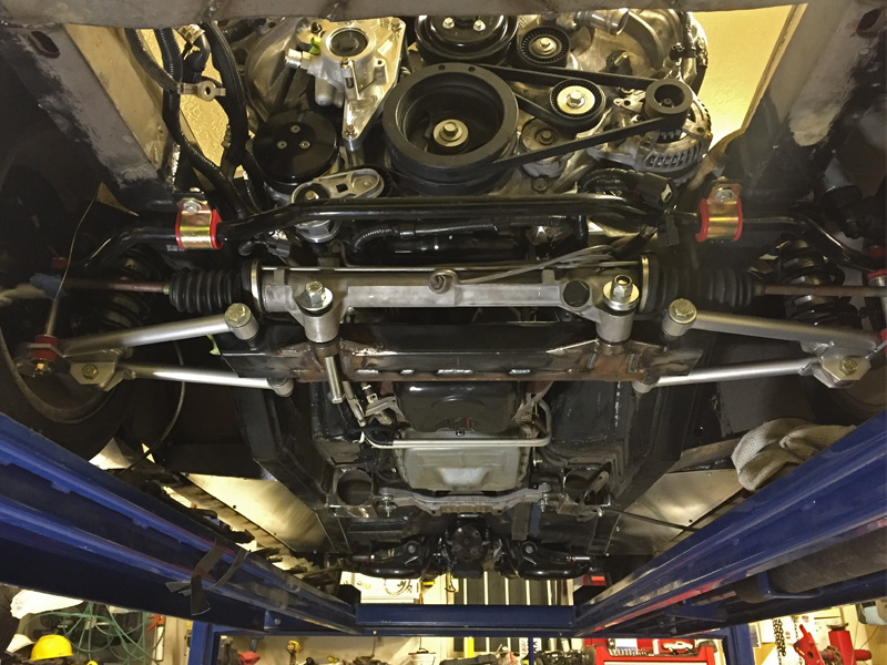

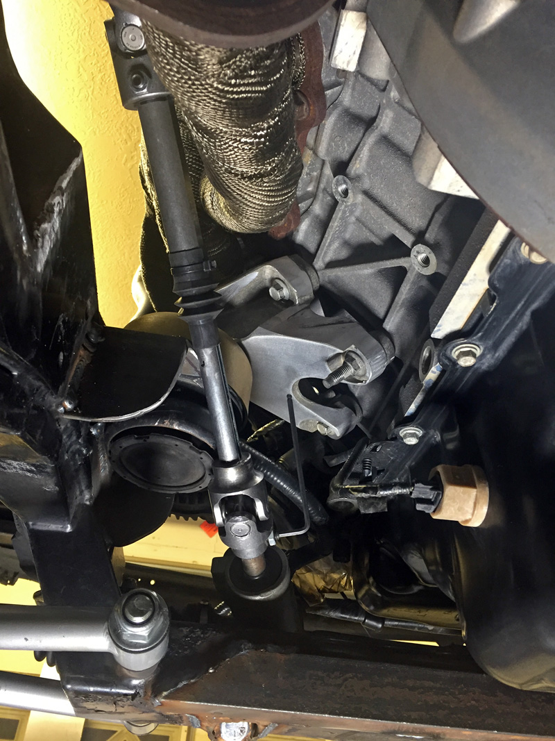

      Finally got to the steering.
      It's a tight fit but it turned out pretty good.
      On the rack we had to move it to the right to clear the mounts, and rotated it on the same axis to aim the input shaft back a bit.
      Turned out like so:

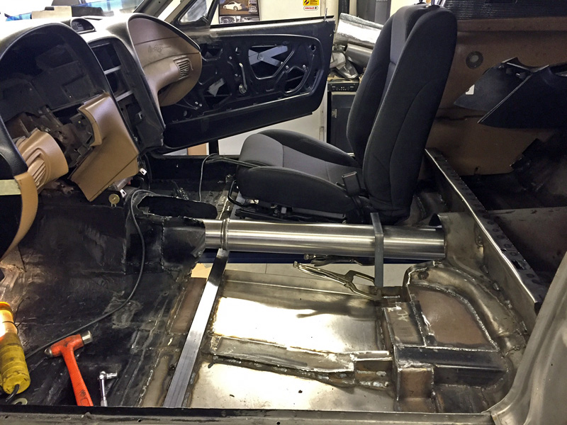

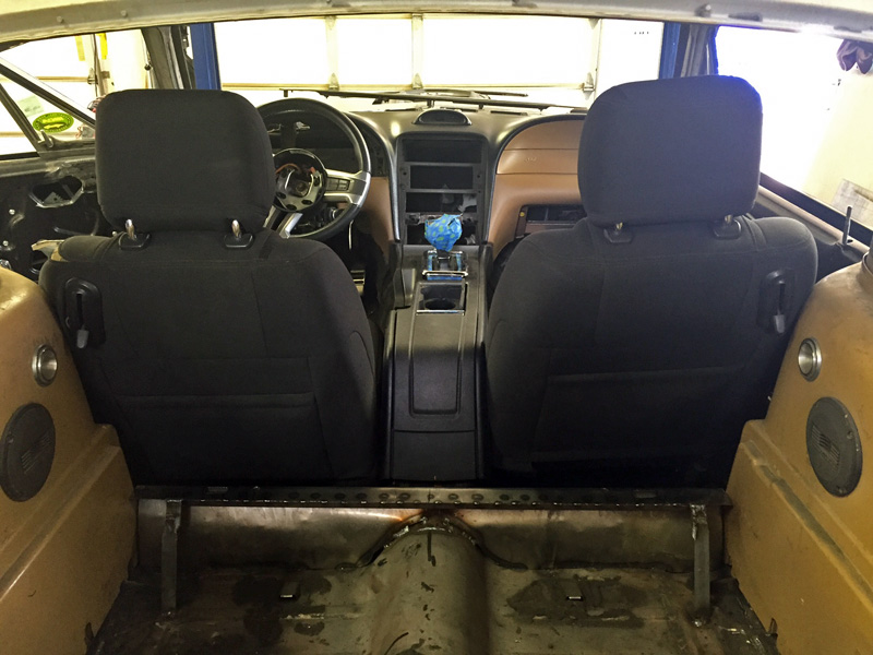

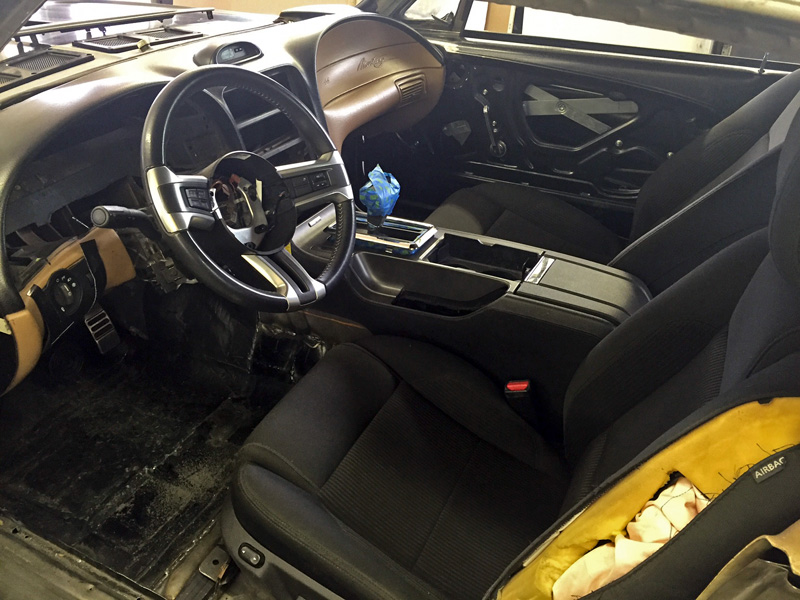

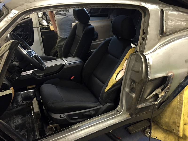

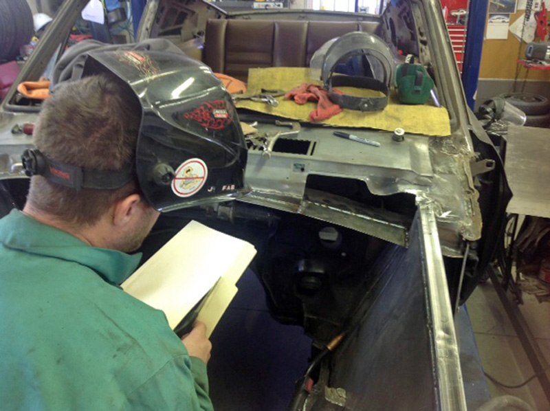

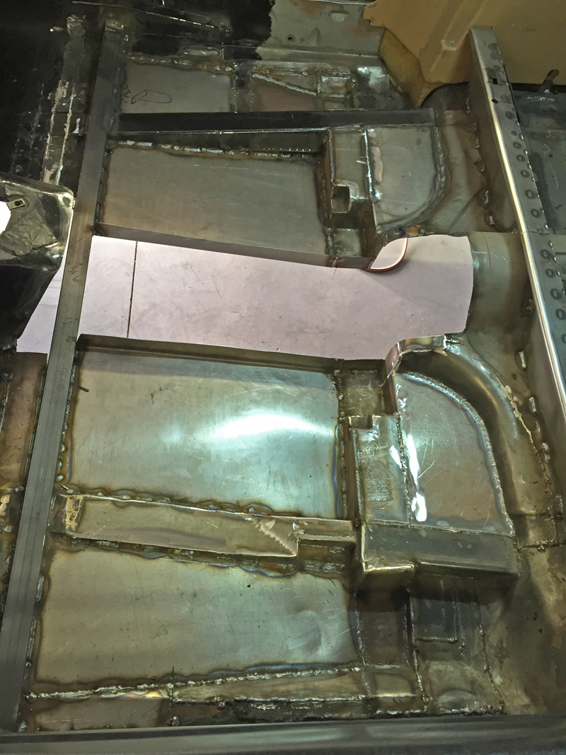

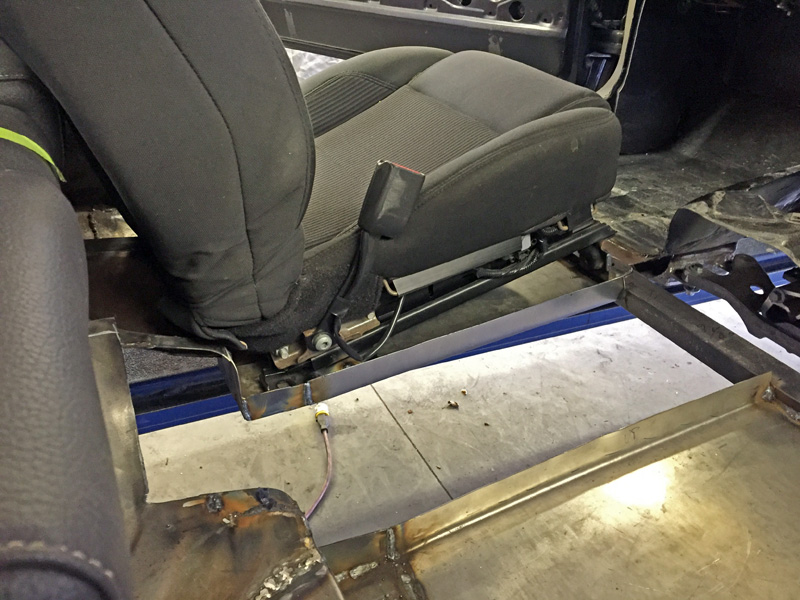

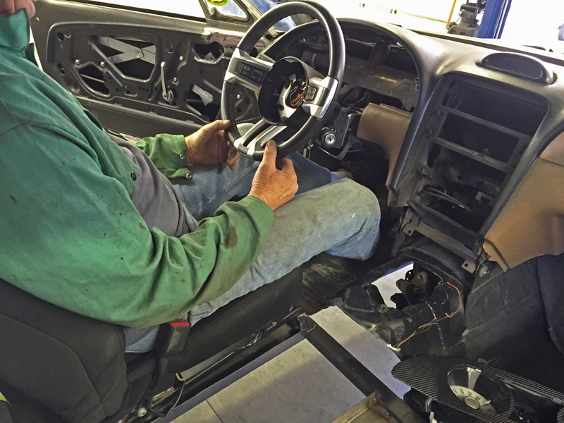

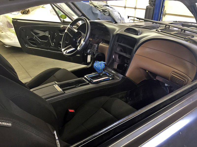

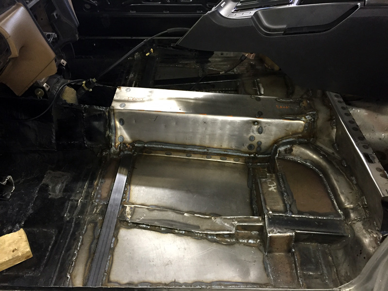

      My dad and I are both 6' - 6" tall, we raised up the dash in this car for clearance.
      The last few weekends i reworked the floor pan to get the seats as low and far back as possible.
      These are the 2012 mustang seats. Going to recover the fronts after the body work is done.
      Here's where I'm at to date:

      Nice welding ground spot you have there lol. this is looking good, nice work.

      5,560
      Nice job getting the motor in, it looks good.

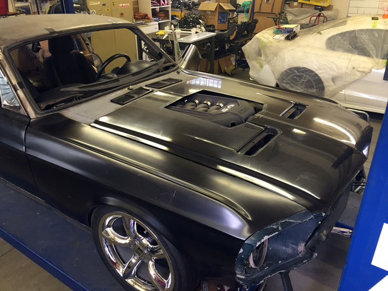

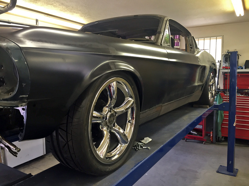

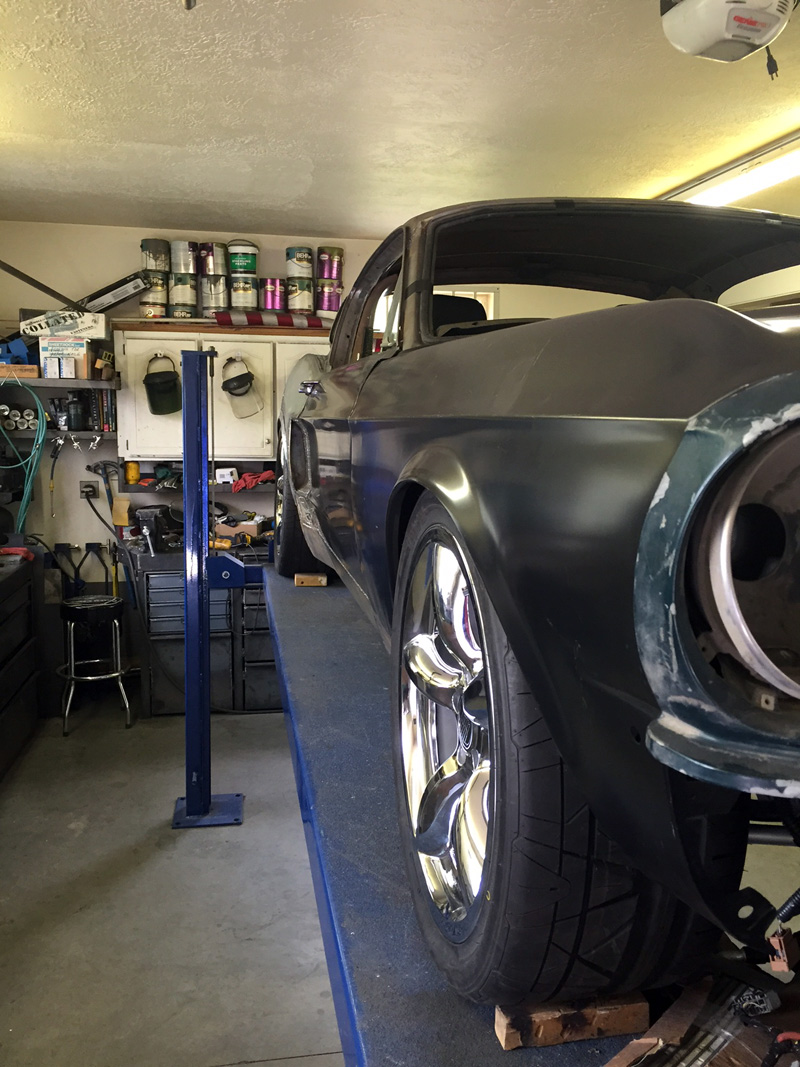

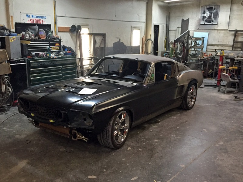

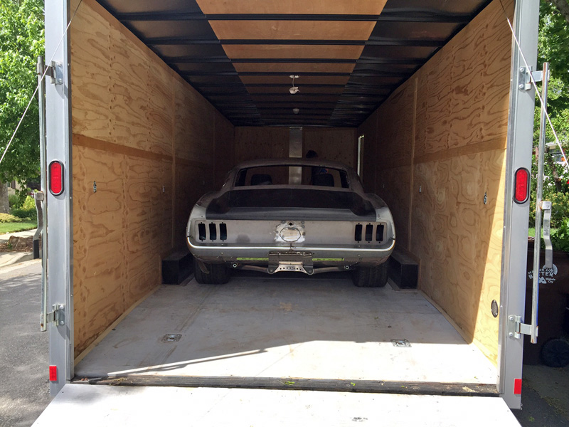

      She's at the body shop!
      I think the '05 grill will look great on the car. :D
