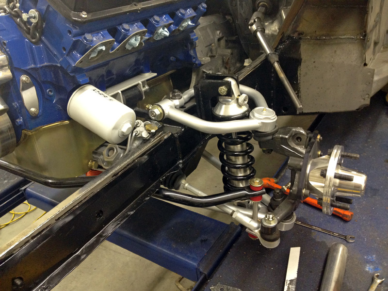

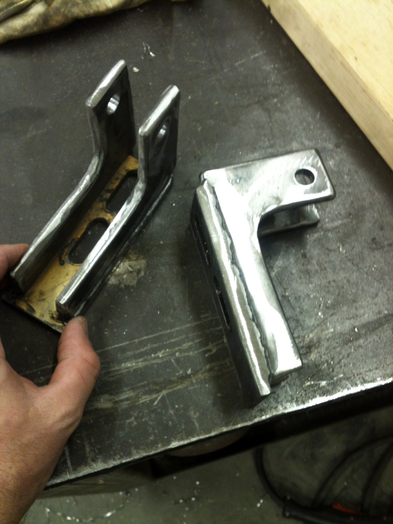

      First off, THANK YOU to the member that mentioned the upper coilover mounts on the R&C kit were prone to bend.
      We beefed them up. basically plated the outside and welded off the perimeter.

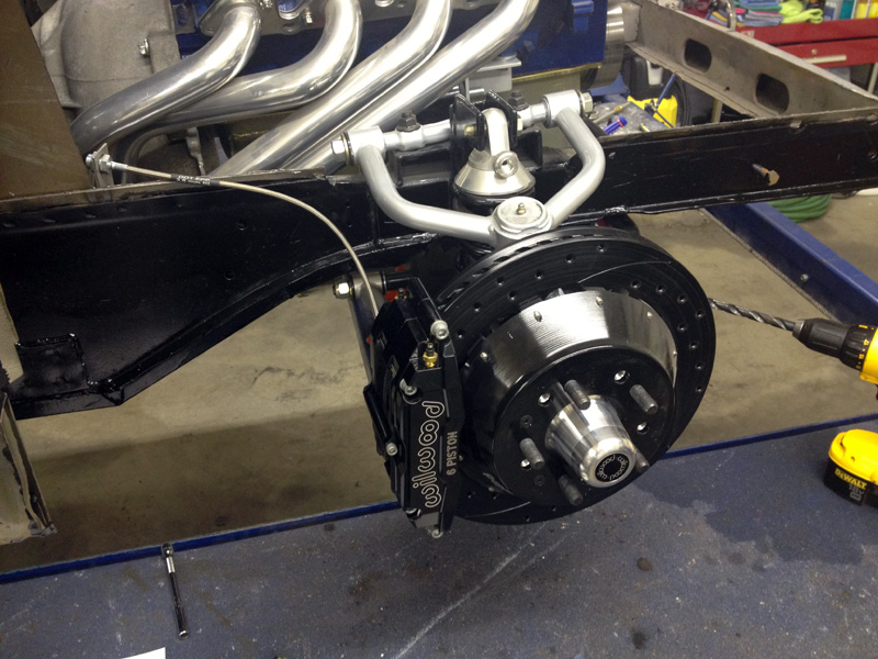

      Mounted up the brakes for fun:

      Quote Originally Posted by Dalamar View Post
      I found that the weakpont on mine was the tab that the coil over bracket mounted to. If you can find room to gusset the top that should also help.
      Zach

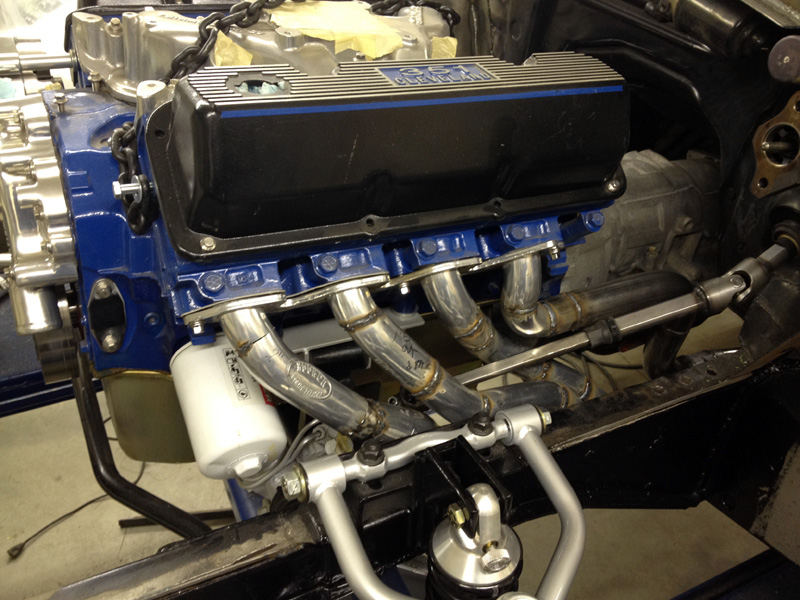

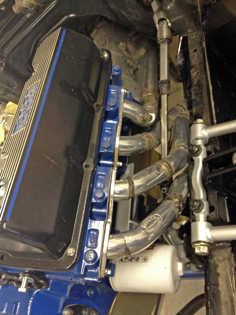

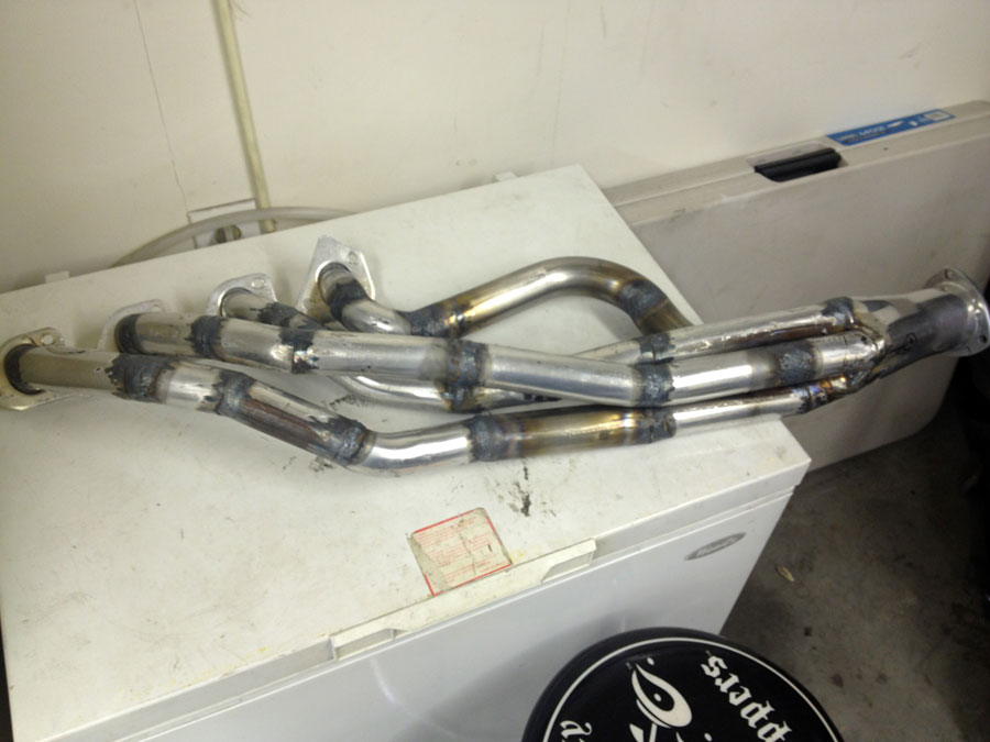

      Here's how far we got on the DS hedder:
      Jeff -- 96 Mustang - 2V Stroked Modular Turbo // 13 RAPTOR // 67 Mustang Fastback build - Coyote 5.0

      How does the knuckle not hit the sway bar link when turned?

      Quote Originally Posted by CFster View Post
      I can see what your looking at, i'll have to turn it and snap a pic.

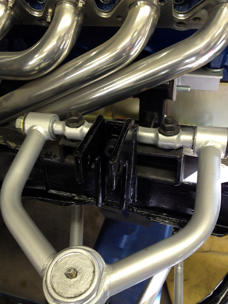

      thanks for that Zach, it's 2x as thick now

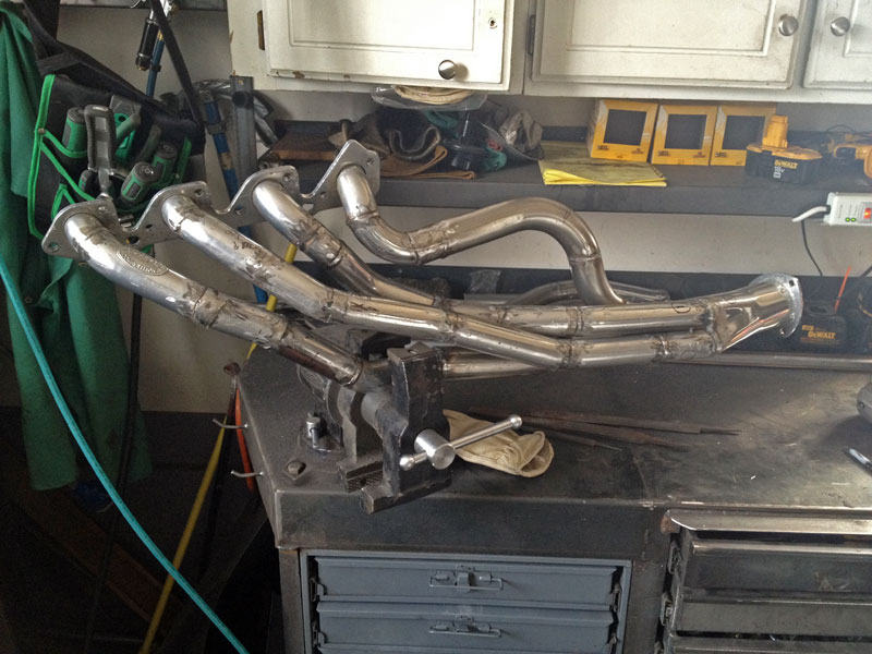

      getting closer on this hedder

      Man, that Cleveland looks awesome in there, but onto your headers... Nice job with all the slicing to get them to fit. Since you had to cut them up, would it have helped anything to make them Tri-Y's? Looks like you'll need to pull the steering shaft once they're all welded up. How is the ground clearance? From the pic it looks fine, but you know how pics can be...

      looks close to the rails

      Thanks for the interest and Inquires guys.
      The ground clearance isn't bad, the pan is lower, thinking I might wanna build a skid plate for it?? The hedders are about paralell with the Sub frames.
      It's been sitting for about 2 months, crazy busy on my end with work and family stuff.
      got the DS hedder pieced together and clears everything fine. Yes we'll have to pull the steering shaft to remove it, no biggie.
      here's a few update pics.
      My dad went crazy and finished it by himself while I was out of town. It needs some more fill welding and clean up, then off to HTP coatings.

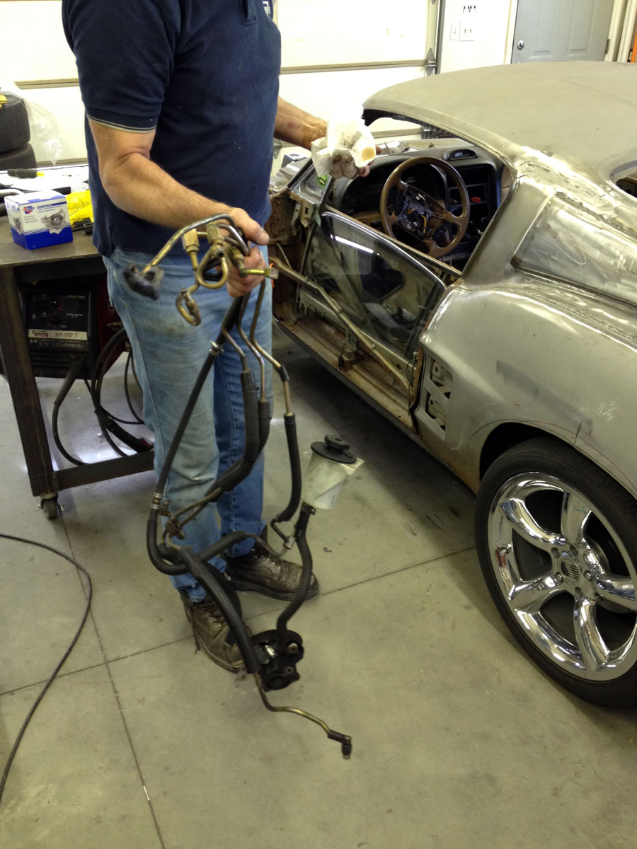

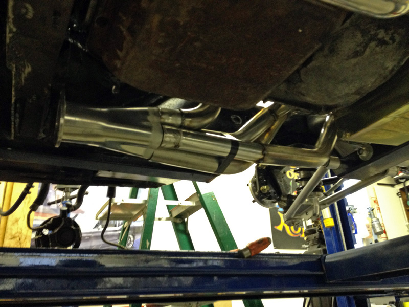

      After being gone for about a month, I got to work on the car for about 1 hour!!
      spent all day working on my wifes car...
      There were some pits on the hedder welds, so we gas welded all the joints, test fit, and started grinding it down.
      Going to re plumb this thing:

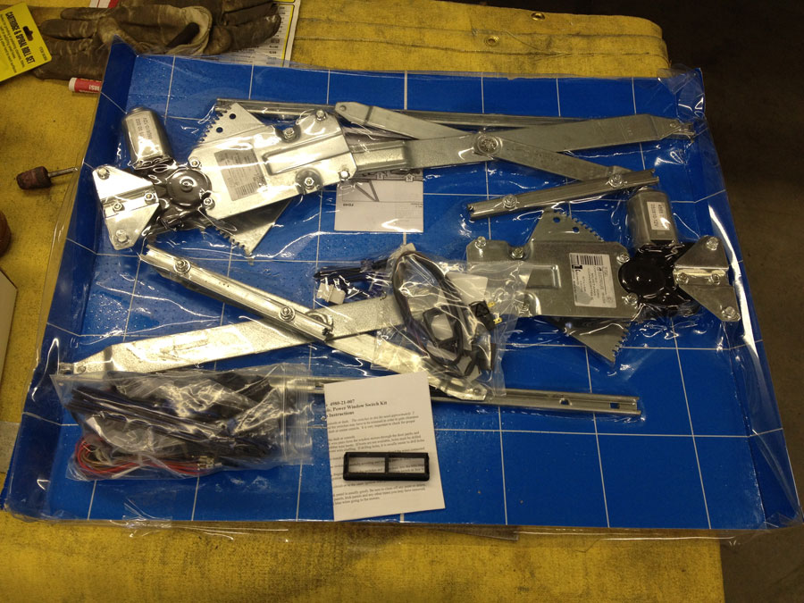

      Ordered some parts last few weeks.
      here's a peek at the first few to arrive:

      looks killer, but I think you voided the header warranty
