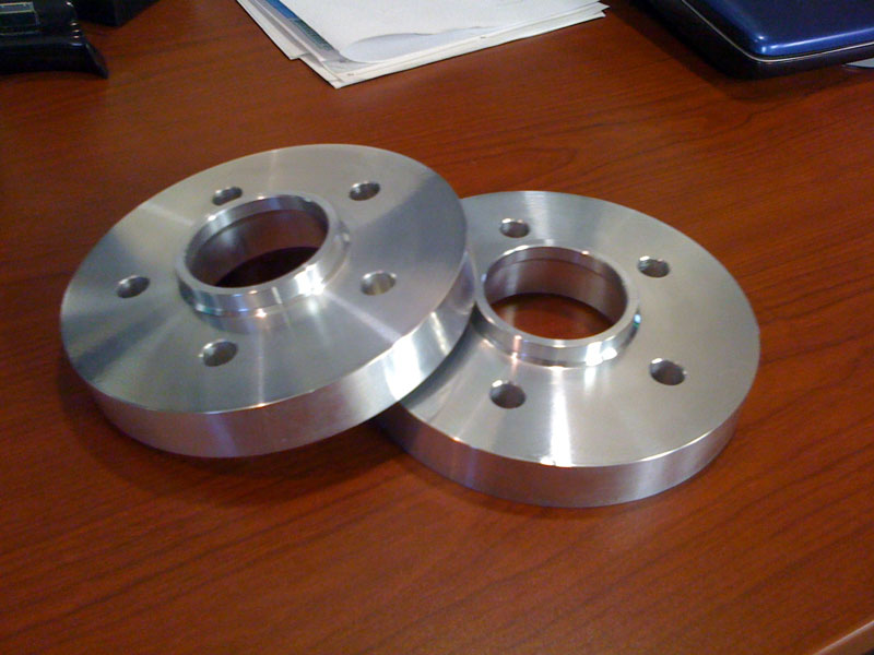

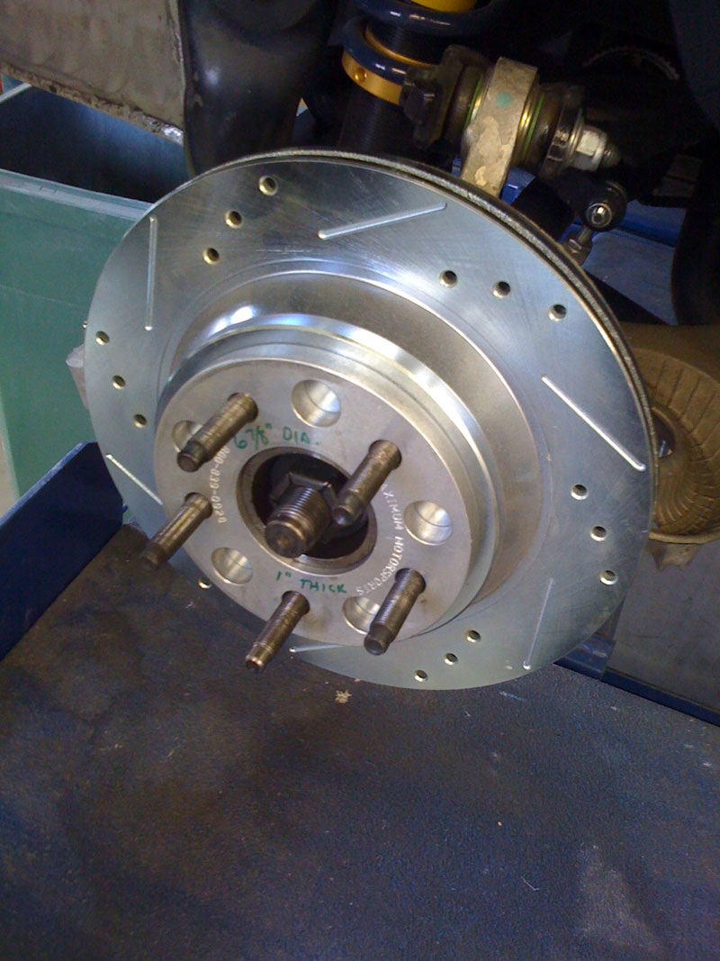

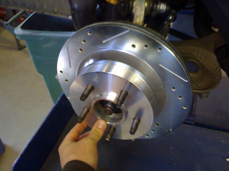

      thanks for the compliments.
      I had some spacers made for the rear, they match the rotor hat diameter and are hub-centric.
      Jeff -- 96 Mustang - 2V Stroked Modular Turbo // 13 RAPTOR // 67 Mustang Fastback build - Coyote 5.0

      Well after doing some reading....after I got these spacers, there appears to be an issue with spacers over 1/2" thick,
      shearing force and expansion/contraction can cause the lugs to loosen.
      I'm not totally conviced, but I'd rather error on the side of caution, so I ordered another set of these in Adapter form, with offset studs.
      good feedback on this thread:
      http://www.gt40s.com/forum/gt40-tech...dangerous.html
      live and learn
