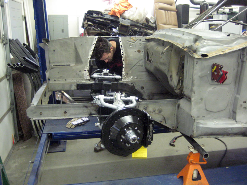

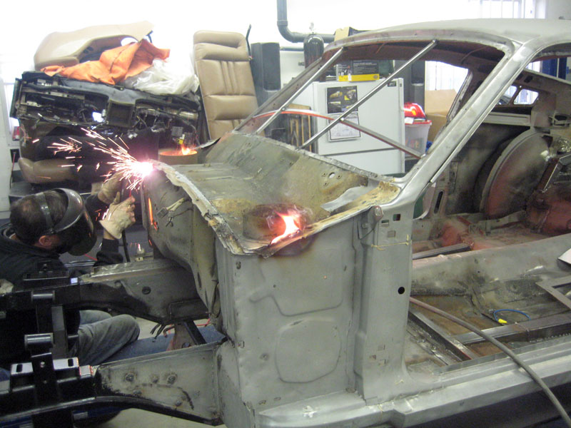

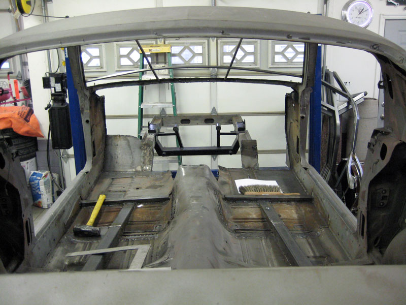

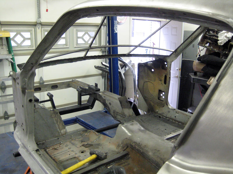

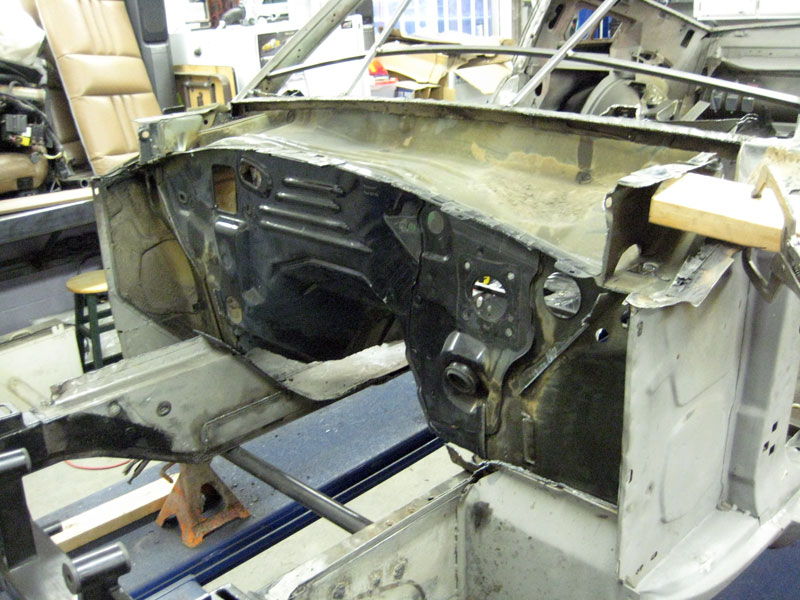

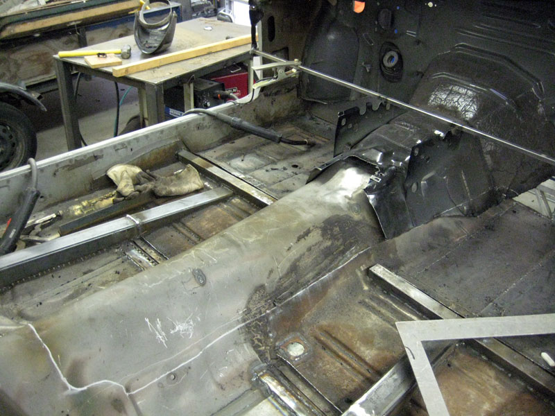

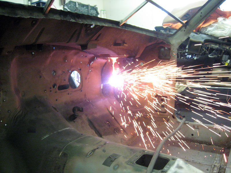

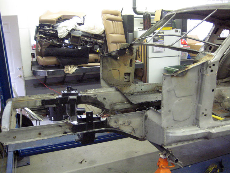

      Removing the firewall wasn't as hard as we thought it would be.
      We worked on it for about 6 hrs today.
      Here's some pictures.

      makes me want to start a build..lol.. good looking work from a fellow hellion guy!
    4. #144
      Charlotte
      1,295
      Damn... talking about cutting 2 cars apart to make one... looks awesome!!

      awesome progress!
      the burning seam sealer is a familiar sight... ;)

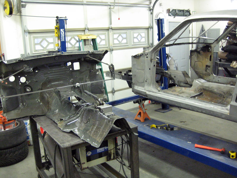

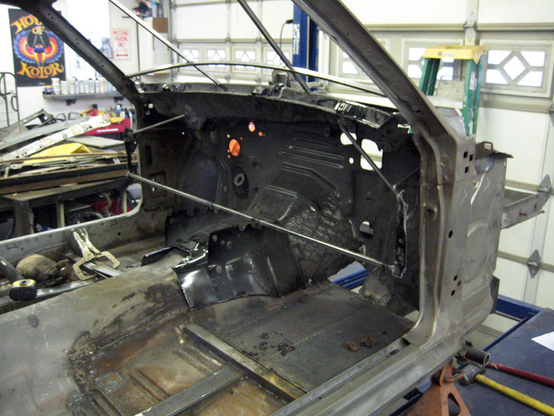

      The tunnel from the SN is offset towards the passanger side, and is a lil wider.
      The drivers side lined up pretty good, and I got it frenched in last night.
      reworked the right side corner piece to fit.
      removed the outside hump from the SN, will fab it straighter with a lil more room.
      The other side will take some massaging
      (that beutel tape/tar stuff is tough stuff)
