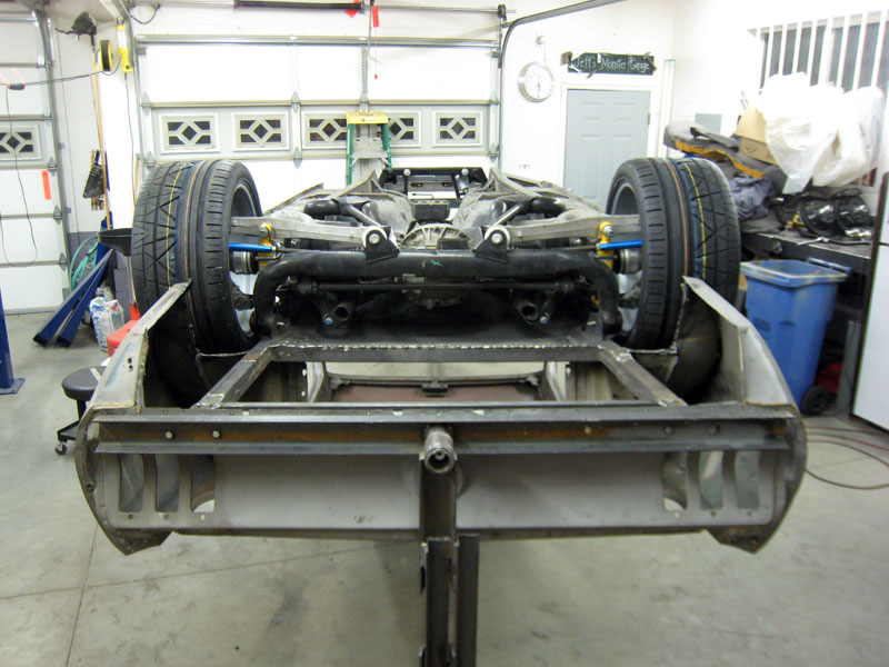

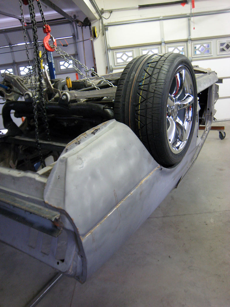

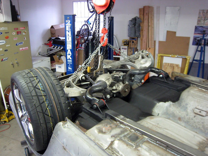

      Put the IRS back on, and got all the bits installed.
      Checked the clearance for the wheel/tire. here's some pix.
      I like these wheels/tires!
      we're going to have to do something with the stock flair

    2. #62
      Oct 2009
      Copperas Cove, TX
      325
      Thats an awesome way to mock things up. Looks good man.

      That clears it up. Not the way I think I would have done it but it works and looks good. Good job!

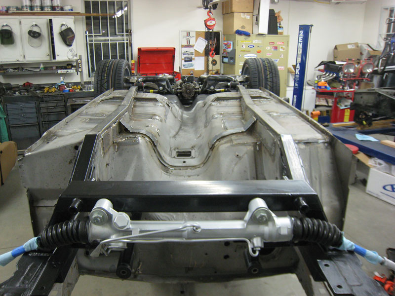

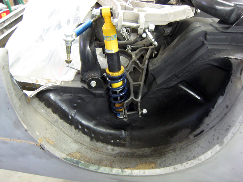

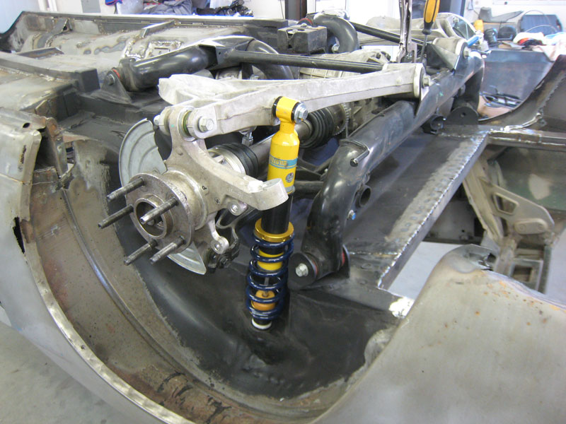

      Here's a few more shots of the IRS
      Other side:
      Jeff -- 96 Mustang - 2V Stroked Modular Turbo // 13 RAPTOR // 67 Mustang Fastback build - Coyote 5.0

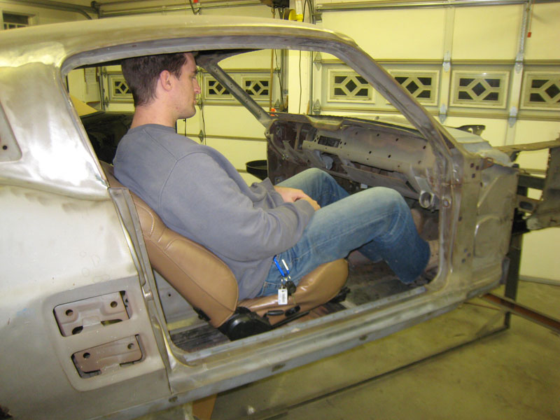

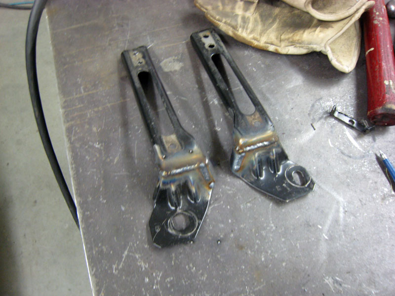

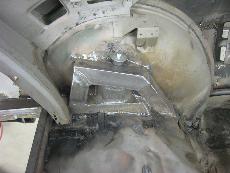

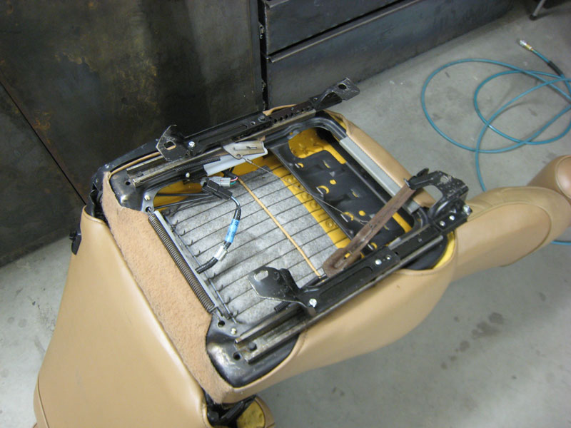

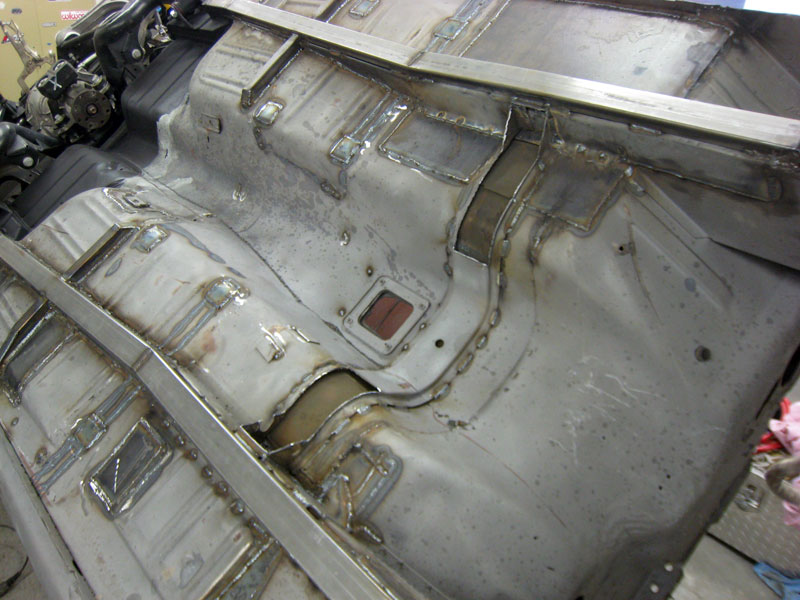

      Next we stated figuring out the seat mounts.
      Got these from a 97 Mustang, we will most likely be getting some nice after market seats,
      but these will work for setting the mounts etc.
      Cut out the stock risers and set them it to check the clearance of my head!
      Head clearance was a lil tight for a 6' 5" guy like me.
      Decided to lower the back and tip it a little.
      tipping it is actually much more comfortable for me to sit in. Daddy likes

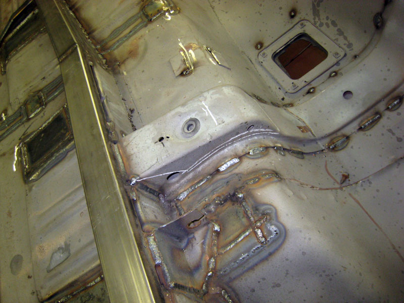

      We set the front 1" above the floor, and the rear 3/8" below the stock floorpan lvl.
      They're welded hot into the sub fram rails, and welded solid to the floorpan.

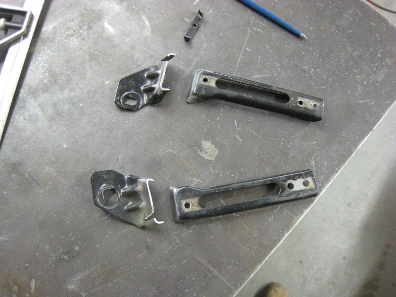

      Here's the bottom:
      also chopped 1/2" out of the rear seat mounting bracket

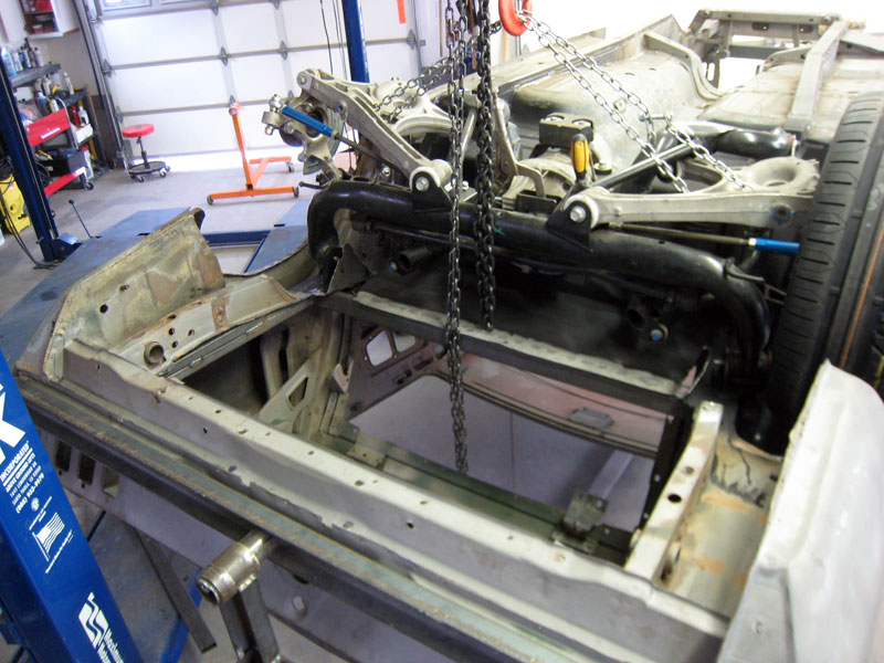

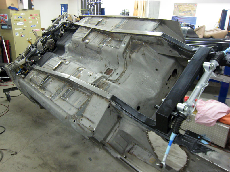

      We got the seat rails done, and were looking at the trans crossmember.
      Measured out the headders, and the collector flange is right there, so we cut them down.

      And, here's what we did last week.
      Pressed longer studs into the rear hubs.
      Picked up a few needed bolts, and got the IRS all assembled with the exception of 2 that needed to be ordered from Ford...
      The axle shafts are 31 spline, and the Dif ring is 373.
