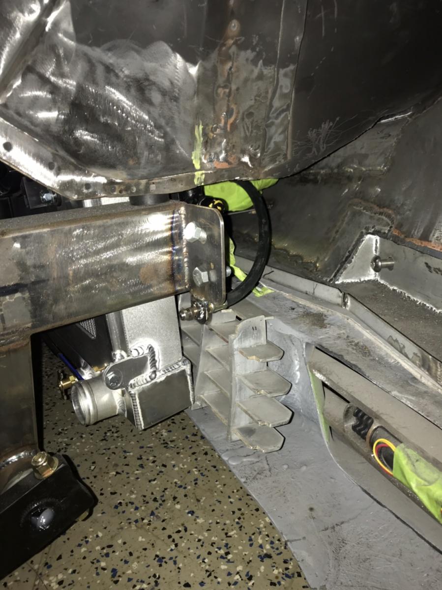

      I was able to make some progress this weekend on a couple items. I had to remake a transmission cooler bracket. There wasn’t sufficient space to hook up the lines to it. Retry boring stuff so no pictures there.
      I was able to work out my emergency brake mount. I will be using an Estopp electric setup. I mounted it to the driveshaft tunnel and routed the cables from the rear end. The big benefit to doing it now was access to the rear end. It helps not having all the sheet metal there. LOL!

      I also started to fabricate a bracket to hold the Bosch ABS setup. It will be mounted behind the front drivers wheel. It will be bolted into the wheel well in two pieces. Rivnuts make the job pretty clean. I will post some pictures of that at it progresses.
      I also was able to layout the brake and cooler lines. The little things are starting to come together but there is a ton of work to do before it goes in for paint.

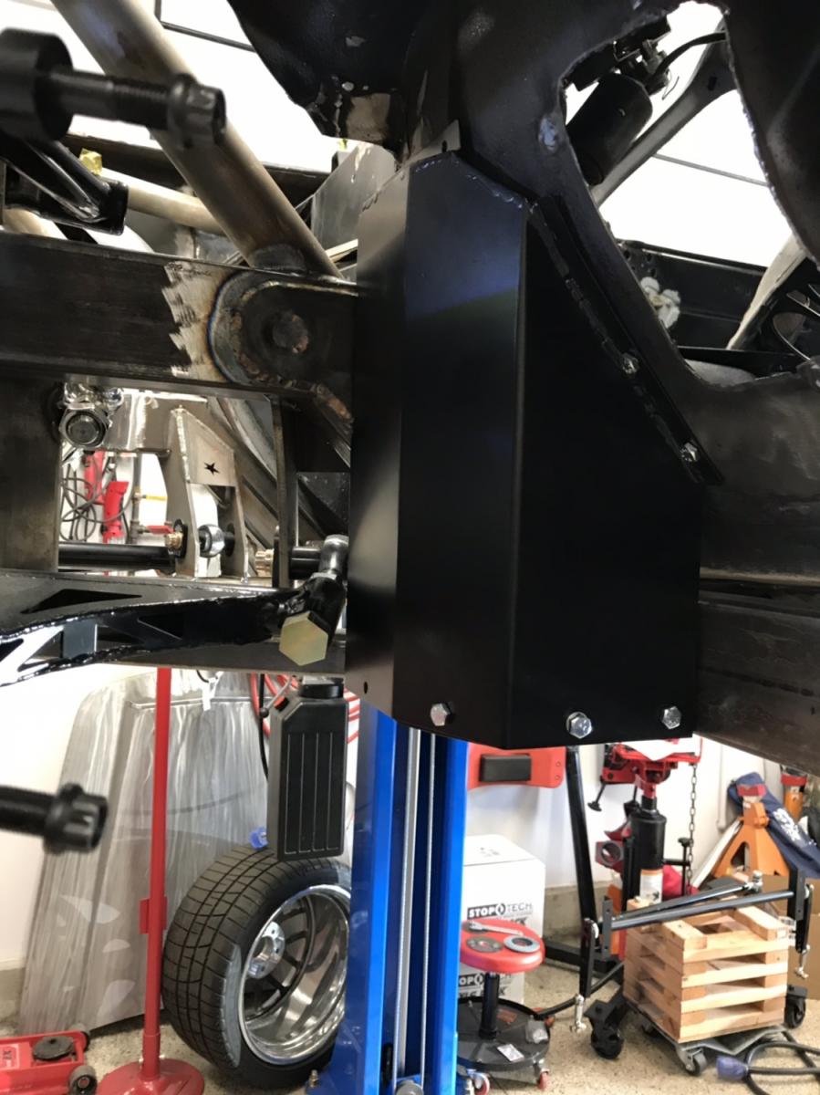

      I built the bracket for the ABS and now need to fabricate a shield to protect it. Now to spend the rest of the evening with my family.

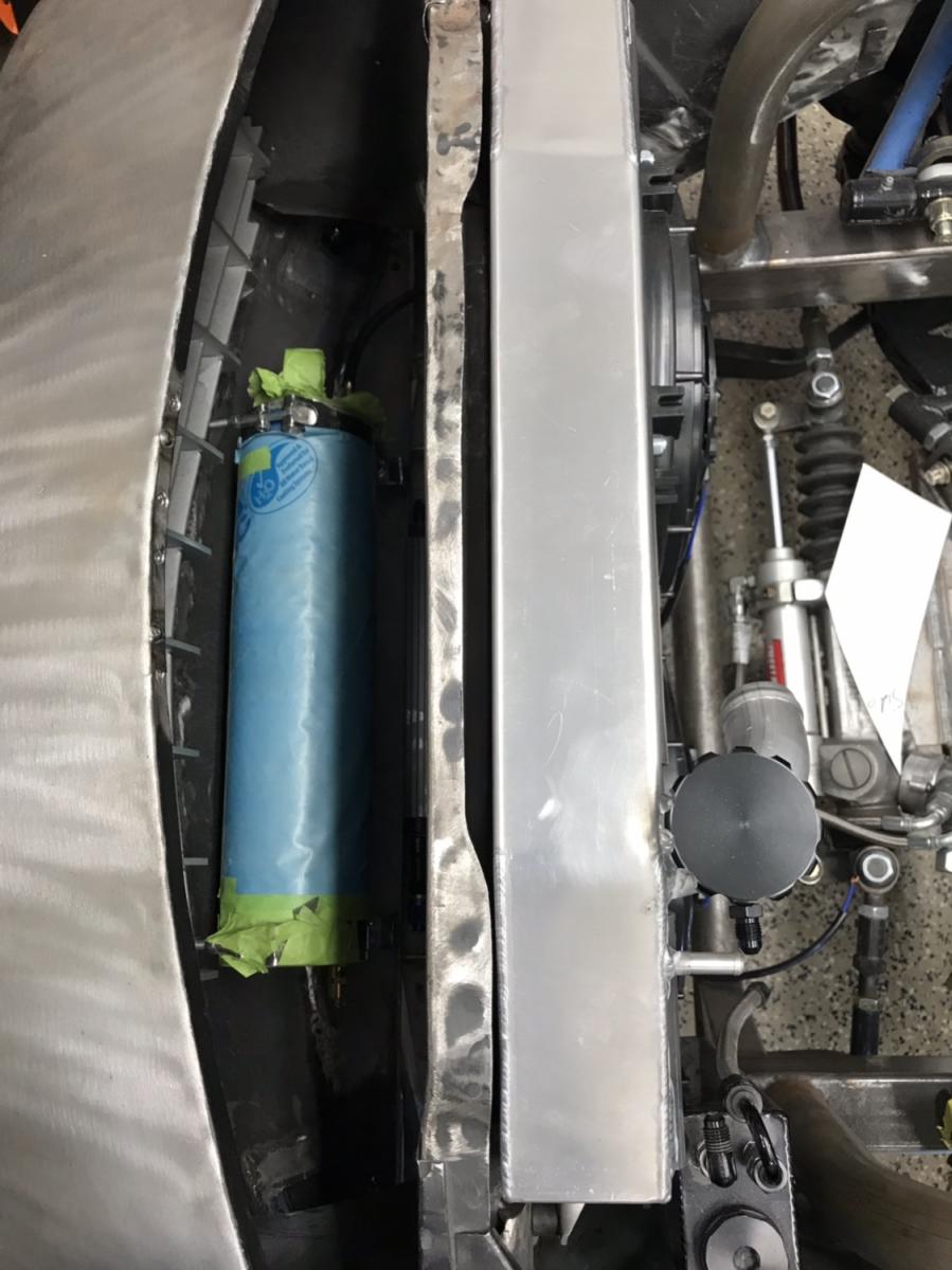

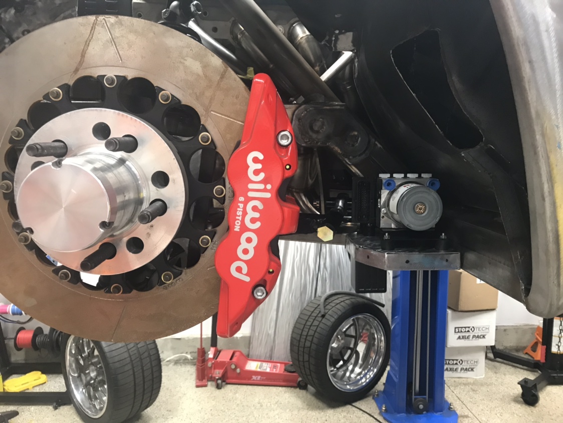

      In the meantime, I have been working on some small items. I have the Restomod heater box mounted, Accusump mounted in front of the radiator, ABS mounted under the fender, modified the firewall for more u-joint and header clearance and mounted the nozzles for the fire suppression system.
      I also have the wiring layer out. There was a lot of items there. I have a Haltech ECU that needs to talk with the Bosch ABS, traction control, Compushift transmission controller and the AIM data logger. It also has to talk with the shifter and paddle shifter. Seems like a lot of moving parts and communicating parts to deal with.

      Accusump mounted along with the condenser and power steering cooler.

      Bosch ABS mounted

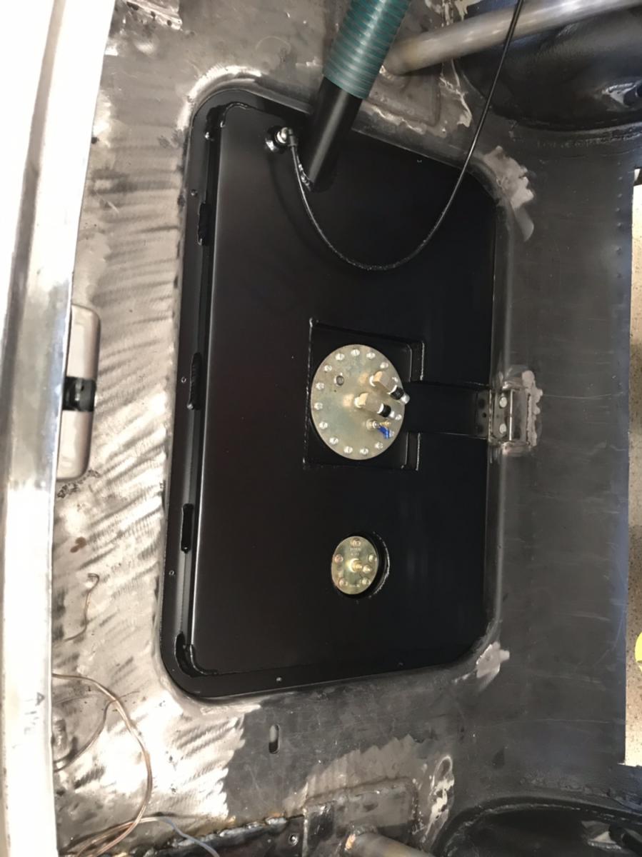

      The powder coated fuel tank is back in.

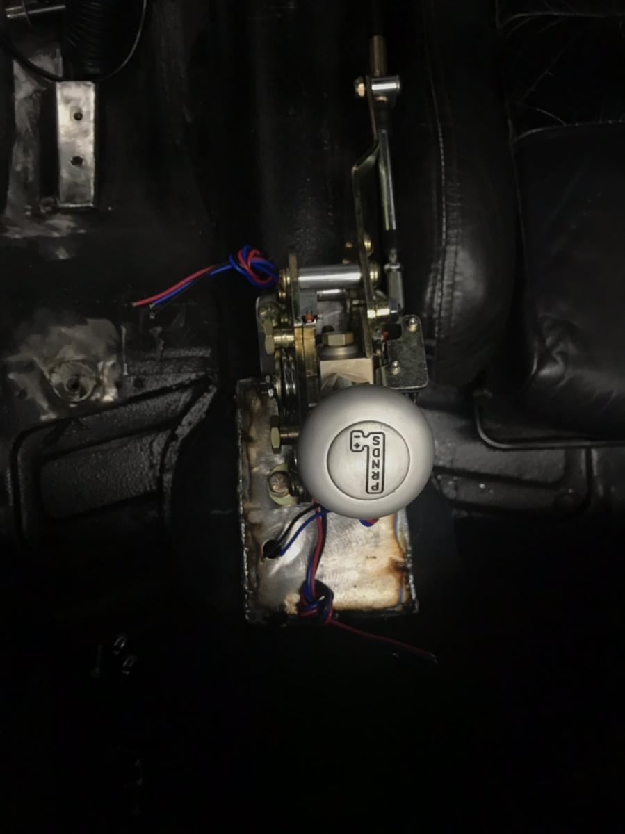

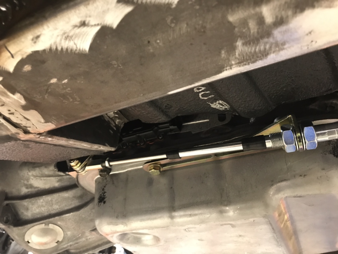

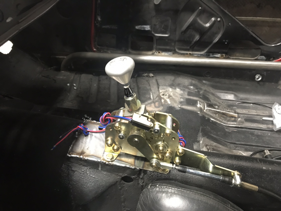

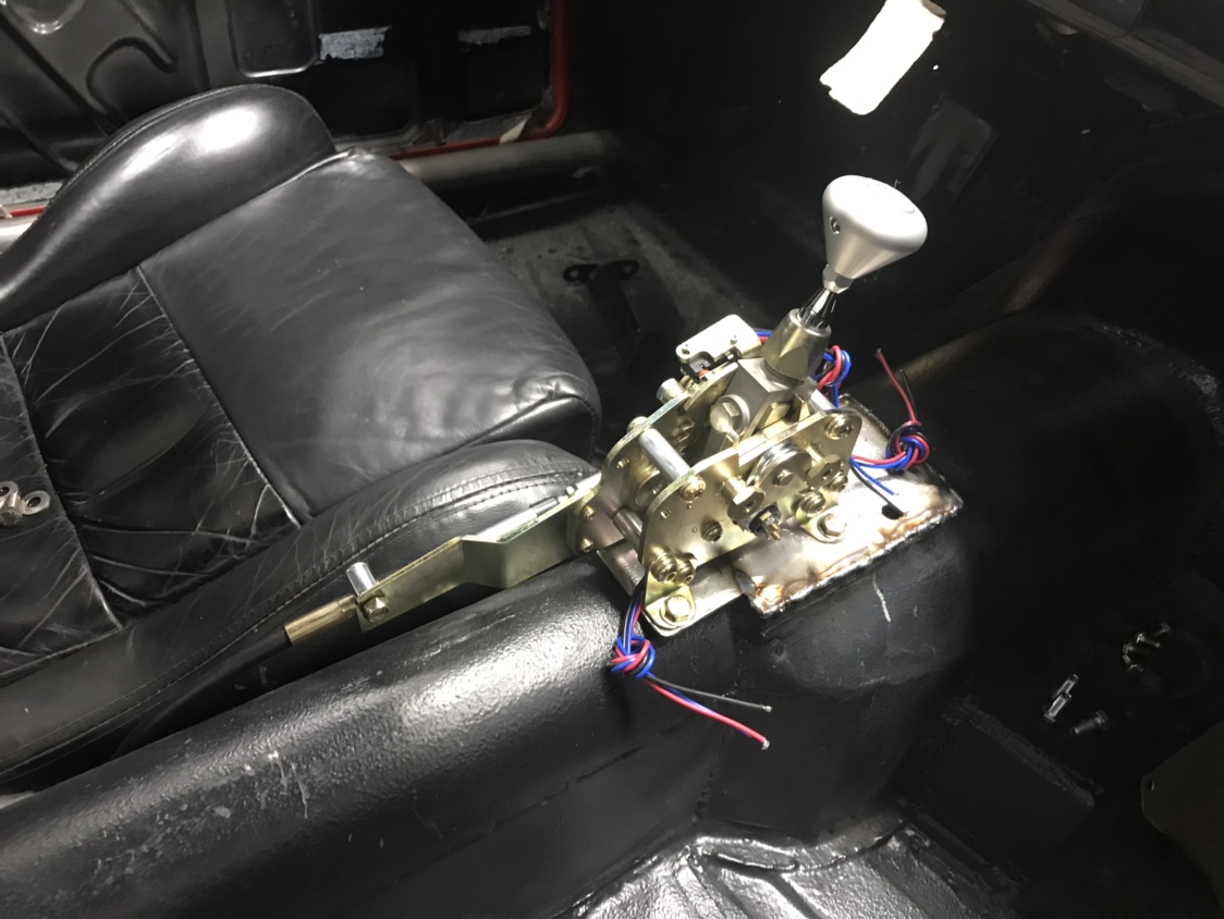

      I was having a very hard time finding a shifter that would work. There really isn’t much space between the transmission and the transmission tunnel so I had to use a cable operated shifter. Lokar has a really neat Electronic Sport shifter that will work great with my Twist Machine paddle shifter.
      https://youtu.be/cyRDrQX-lGk

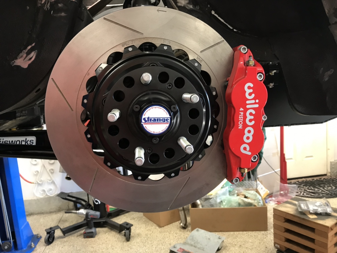

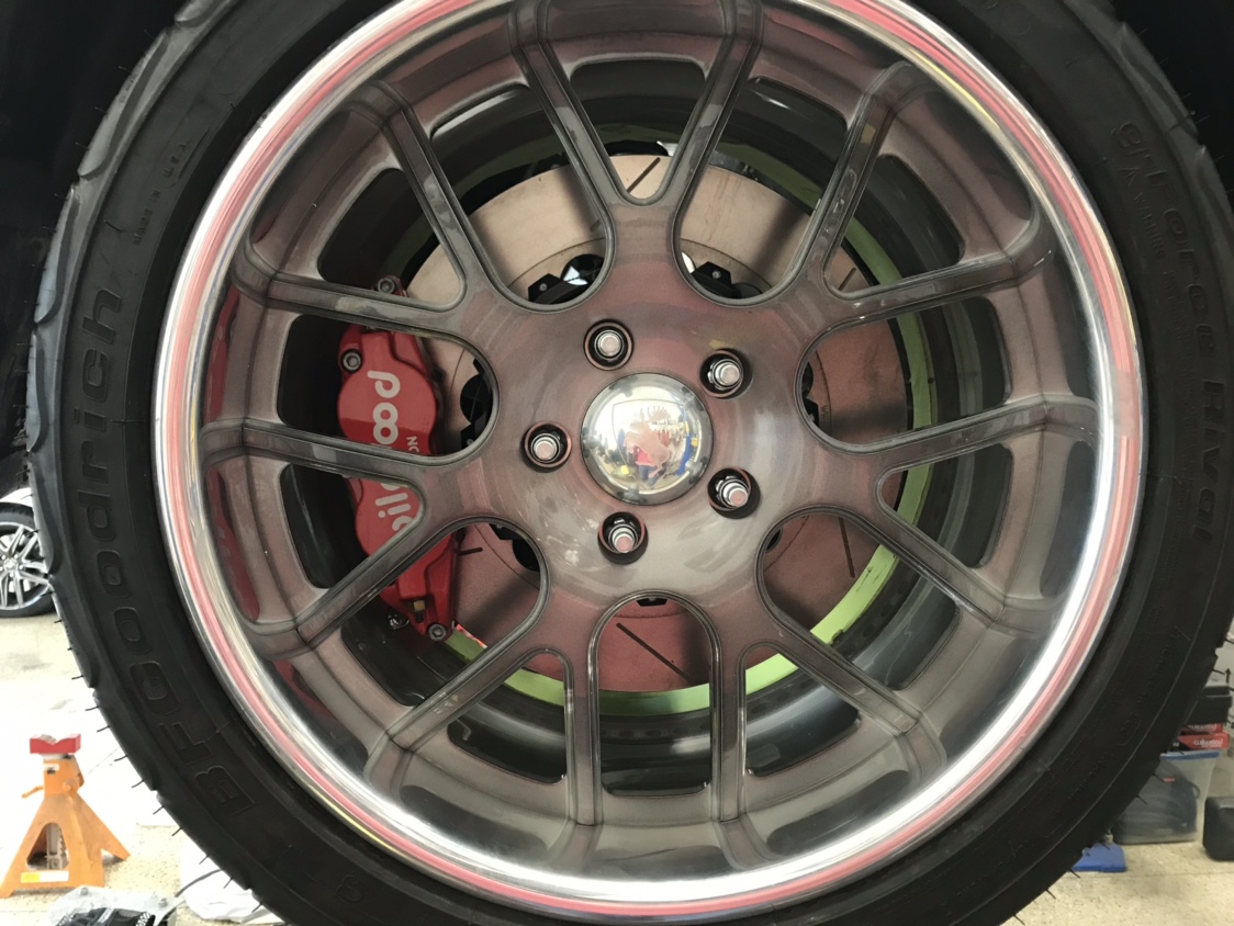

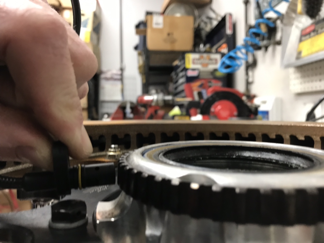

      I have been working for a few years now on my Volvo 1800 project. It has been so long my rotors have surface rust. LOL! I am getting really close to paint but I wanted to add a couple items to my car before that happens. I will be using a Haltech ECU that will allow me to have traction control and a Bosch ABS setup. Both of those require me to run wheel speed sensors.
      My biggest problem was to figure out a way to put on tone rings. The rear setup was easy enough. I called up Strange Engineering and ordered their Pro-Touring Floater hub kit with the optional tone rings that would allow me to run 2005-2010 Mustang sensors. I will be using the sensors from the Bosch kit instead of the ford sensors so I will have to fabricate some mounts. That shouldn’t be too bad.
      The more challenging part was the front hubs. There were no provisions or options for tone rings and there isn’t much info out there with measurements for the rings. Well it turns out that the same rings from the Strange kit are almost a perfect fit. The hubs had to be machined slightly and we left a .002” pressure fit. Another mod I did was to change the hardware on the bolts for the hat to hub. Wilwood had a good alternative. I still need to safety wire the bolts but clearance is good. The wires will have to be low and tight though.

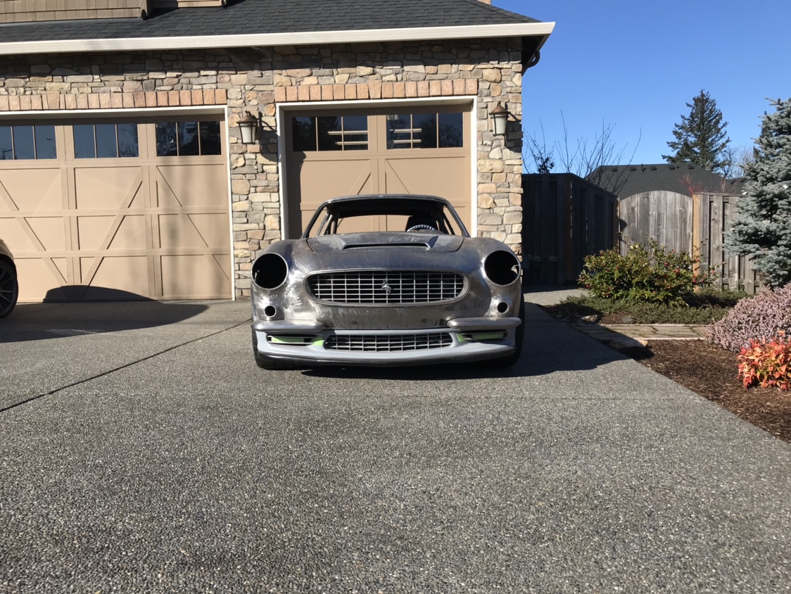

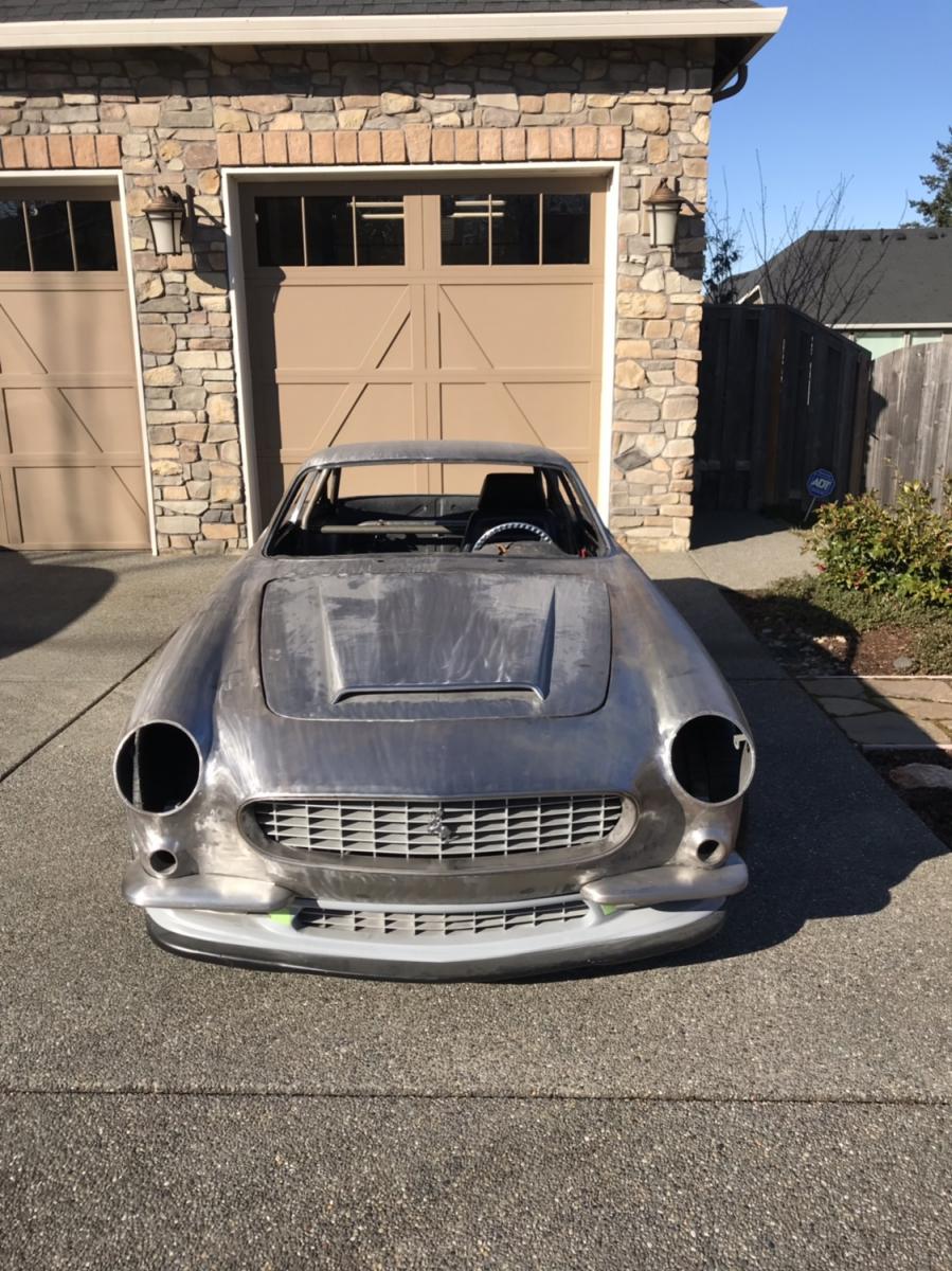

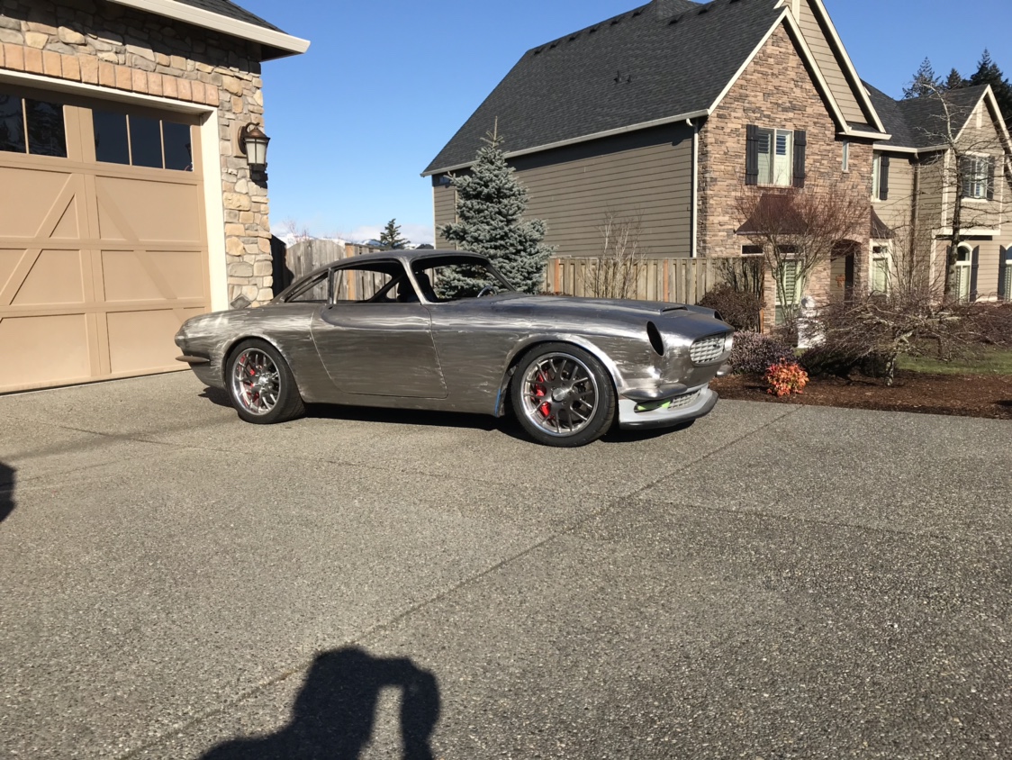

      640
      1968 Volvo project Pure Volvocity
      I finished up the Strange Engineering floater hub conversion this morning. It turned out great and now it is ready to go back in for paint. Hope to have some color on it this summer.

      Quote Originally Posted by 68EFIvert View Post
      Soooo, what would it take to drive it right now?
      You know, just around the block........ a few times.

      It would be fun to semi assemble the car and take it for a quick spin! I am not sure I want to invest the time to finalize some of the systems now. I want to get this thing in color so that I can get it done. It sure would get a lot of attention driving around with no windows though!
