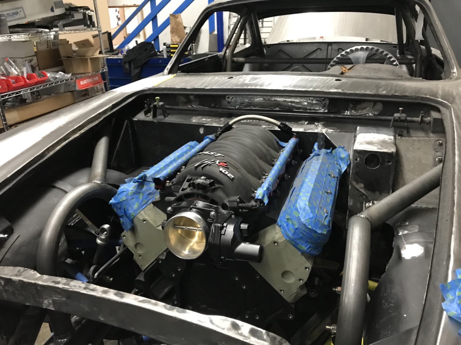

      The mock up engine is back in the car. It looks like I will also have to modify my oil pan to clear the steering rack. The good news is I think the accessory drive setup will work just fine. The AC lines will be a bit of a challenge but doable.

      Any particular reason why you put the throttle body on upside down?
    16. #456
      May 2013
      Colton Ca.
      623
      Hey Darrell,
      I think he's using a mock up motor so the throttle body upside wrong wont hurt anything. Read first line of post #447

      LOL! I was wondering if anyone would catch that. I just bolted it on there that keep crap out of my intake and the shop wanted it to check hood clearances. It has been driving me crazy every time I see the picture. I am going to have to fix it the next time I am over there. I guess I am a little OCD, like most guys in here. ��
