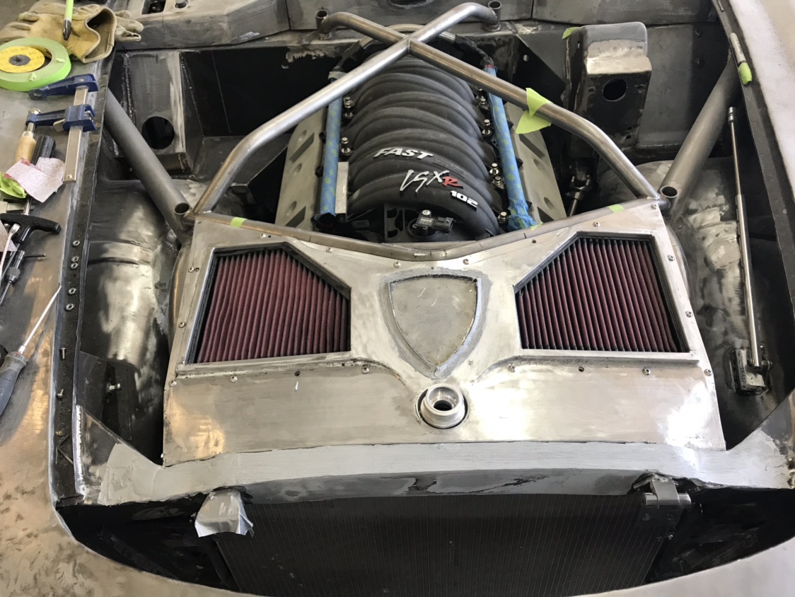

      The air intake is just about done. I am waiting on a chromed 3D printed prancing moose like the one in the grill. Greening Auto Company is working on that now. The one in the picture is the grill emblem. The radiator cap needs to be dropped down about 1/2”.

      I am happy with how it is turning out. I have also decided to put a radar detector and laser jamming setup on the car. There will be minor metal modifications made to make it work. We plan on using a license plate frame in the rear that will hide the sensors. Working with Musicar Northwest in Portland, OR for that. We will be using an Escort Max CI paired up with AntiLaser Priority jammers.

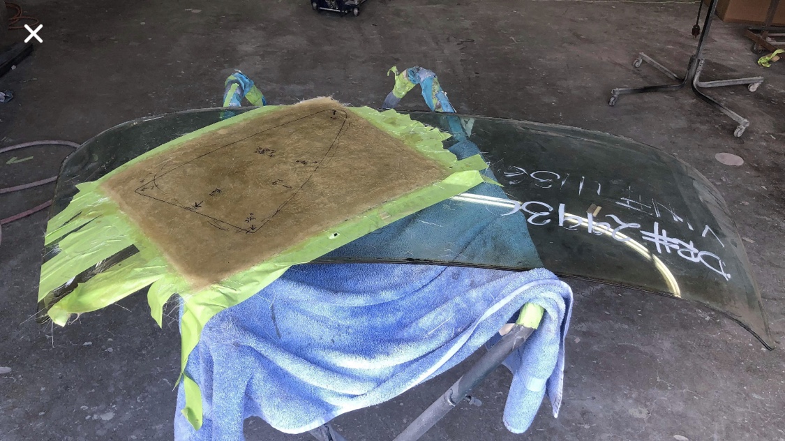

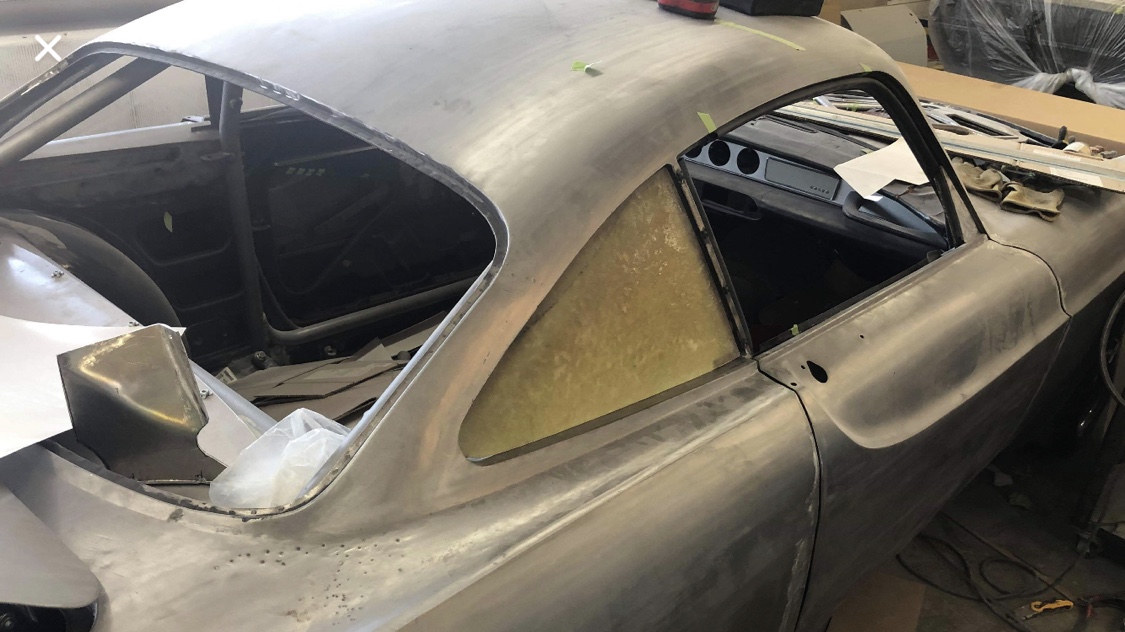

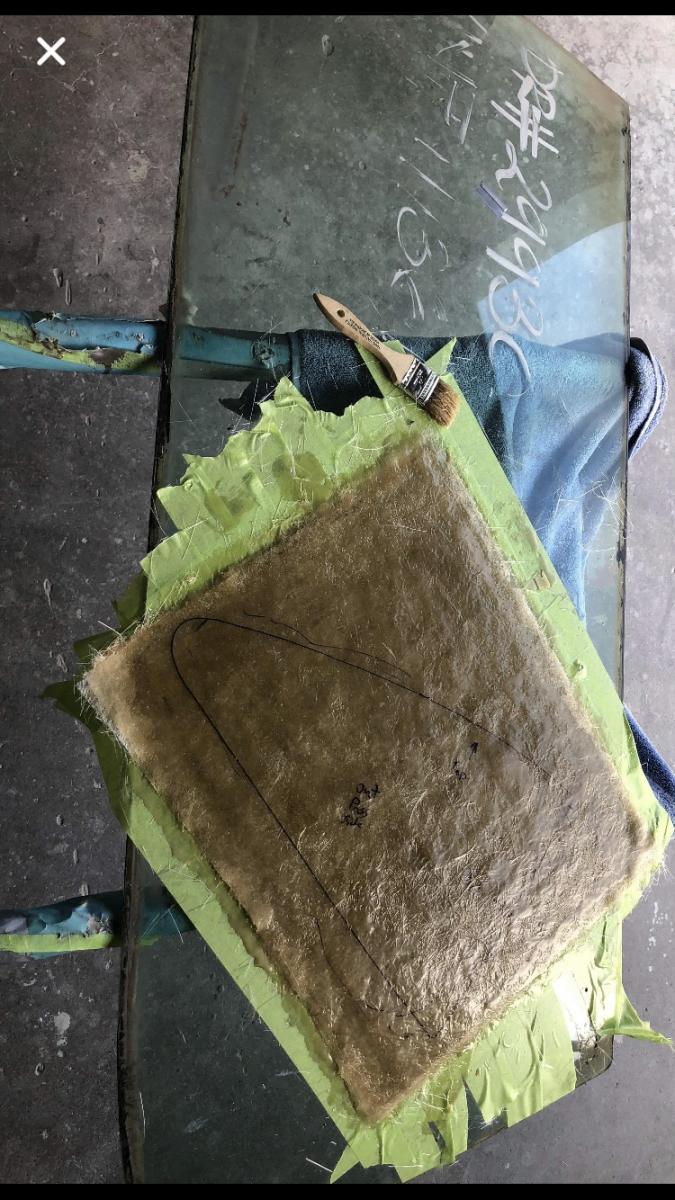

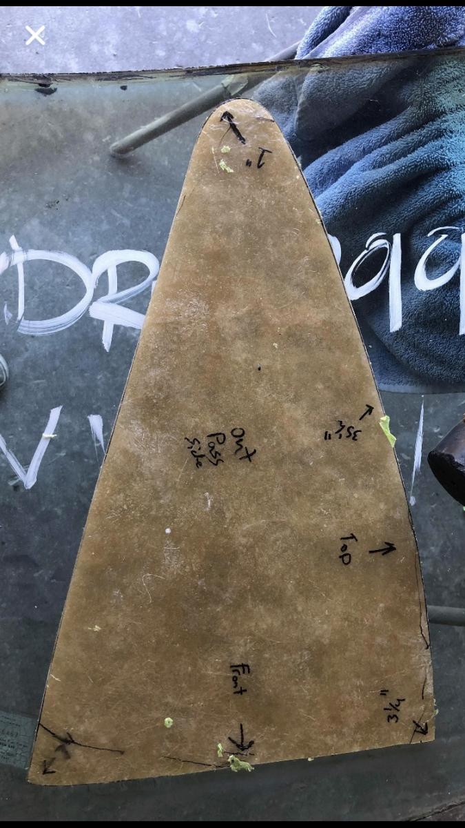

      The rear quarter windows are progressing nicely. The body shop made mold of the windshield that we will be cutting down. It should look pretty good when it is done.

      Just to clarify.... you're using a (cut down) windshield as the new quarter glass?
    11. #591
      Oct 2007
      Camas, WA
      640
      Quote Originally Posted by Bob in St. Louis View Post
      Yep. Took a little searching to find the right contour for the match.

    12. #592
      Feb 2014
      779
      Wow, that's pretty cool, I never would have thought that was possible.
      Just curious, what vehicle did it come from?
    13. #593
      Oct 2007
      Camas, WA
      640
      It was a GTX.
    14. #594
      Feb 2014
      779
      Plymouth?
    15. #595
      Oct 2007
      Camas, WA
      640
    16. #596
      Feb 2014
      779
      Wow. Such an odd "find"... of all the available front windshields.
      Seems like that would have been a needle in a haystack.
    17. #597
      Oct 2007
      Camas, WA
      640
      My glass guy will take a mold of what is needed and go to junk yards to find a car that will work. He is really good and I believe he did the glass for the 2017 Riddler winner that was built by Steve’s here is Portland.
      The door glass will be a cut down Ford SUV front door glass. All the glass will be safety glass since tempered glass can’t be cut down.

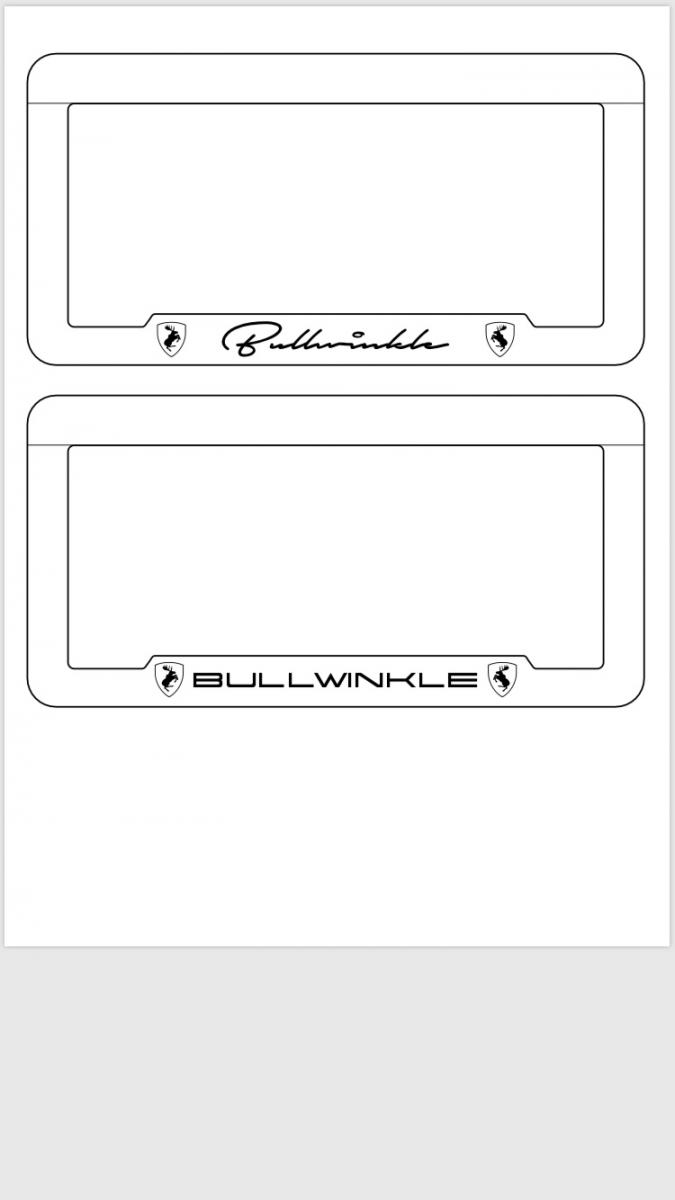

      I want to get some opinions about the rear license plate frame. What font style do you prefer. I plan on naming the car Bullwinkle.

    19. #599
      Feb 2014
      779
      The current Volvo font, would be cool.

      I like the script, but would use the block text so it is easier to read.
