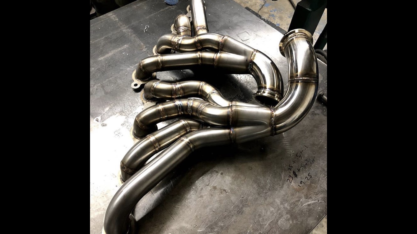

      How about some header porn. Such a tight fit but pretty close to equal length.

      Feb 2014
      779
      I follow a page on Facebook called "Weld porn".
      This would fit there, quite well!!!

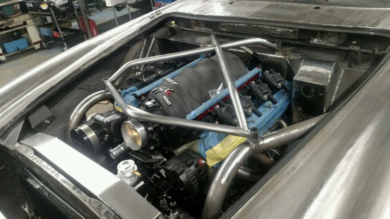

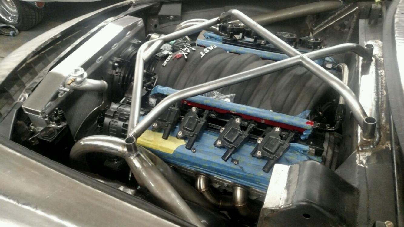

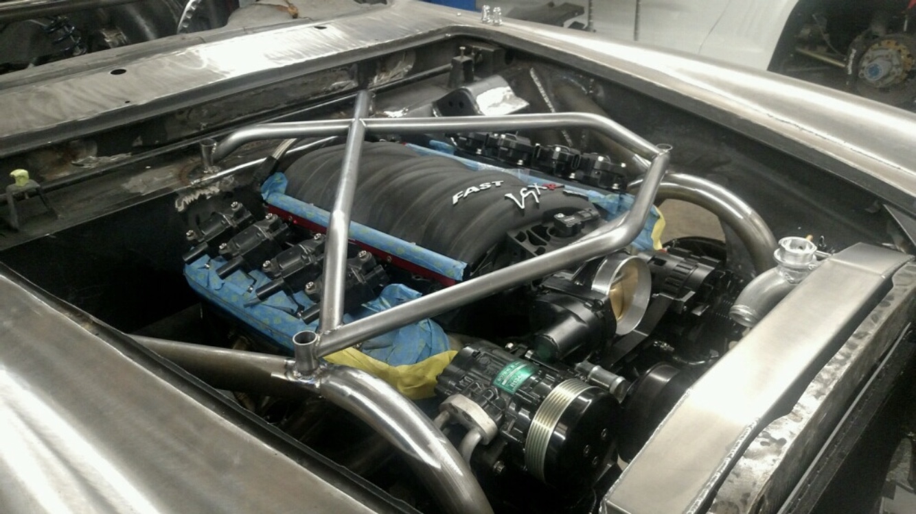

      The shock tower bracing is done. Pretty much ready to come home for me to work on it. I can’t wait to get my hands dirty again.
