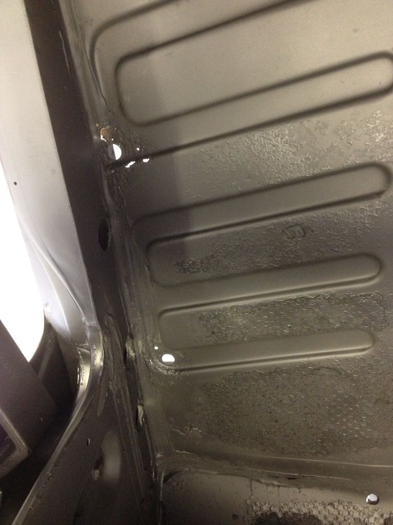

      I decided to have the car blasted per the suggestion of my body man. It came back with a bit more damage than I originally thought it would. I got a call from the blaster that he was done. It took a day and a half longer than anticipated. It looks like the last body man did not know the difference between a body hammer and ice pick. The front fender repair was terrible. It warped both panels of the overlap joint. I wonder if it is useable at this point. Pretty frustrated right now.
Size:  89.2 KBName:  body2.jpg
Size:  94.4 KBName:  body3.jpg
      Rust really wasn't bad. A couple places in the passenger front floor. One on the DS floor and some small spots in the wheel wells which will be removed for the mini tub. The trunk only had one small area on the curved area that leads to the gas tank. All of those are pretty easy fixes. I will take care of those repairs.

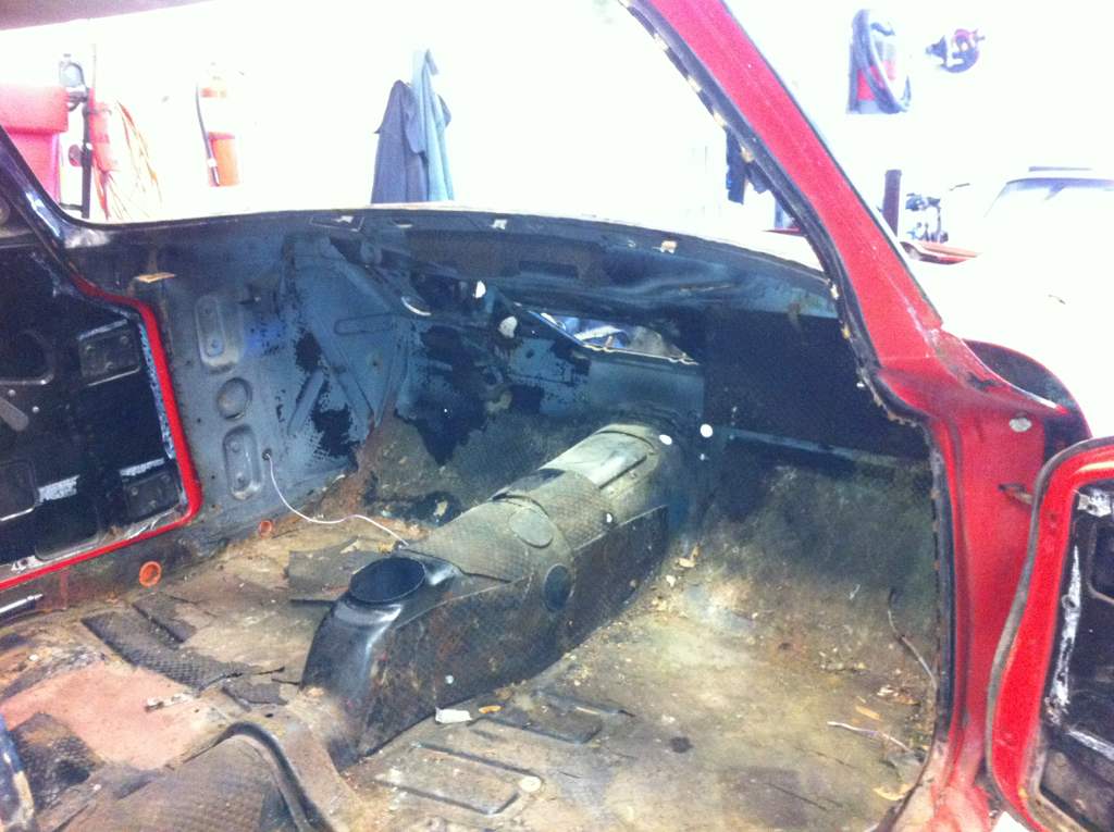

      5 minutes after the tow truck dropped her off at my house i had the grinder and plasma cutter out. i started taking out the inner wheel well to prepare for the mini-tub. I hope to gain about an inch to the inside and about the same or perhaps a little more on the outside. I really don't want large flares on the car. I want to look close to stock but with slightly more bulge to the fender. Here are a few pictures of her.
