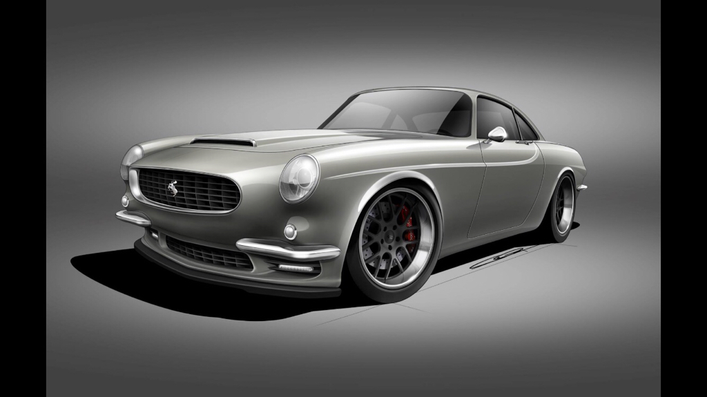

      I have also started working with Chris over at The Roadster Shop with some renderings. I want to get a better view of colors, mirror options and smaller details. He is pretty close the finishing up the front rendering and will also do a 3/4 view of the rear. It is looking pretty good I think. I will post more pictures when he has them available for me. This was a sneak peek!

      Nice rendering. This is a really creative build. I can't wait to see the finished product.

      I met a guy that does design work at The Roadster Shop and he is helping me with some final decisions. He took the photos of my car and did a fantastic rendering of the end result. This will allow me to change the color or details before it is finalized. It will look killer when done!
      I want to get some input on my mirror selection though. I have 3 choices I am mulling over right now.
      1 is the classic chrome bullet
      2 is a 2nd generation Camaro mirror that would be body color
      3 is a chrome rectangular one like the original.
      What do you think?
